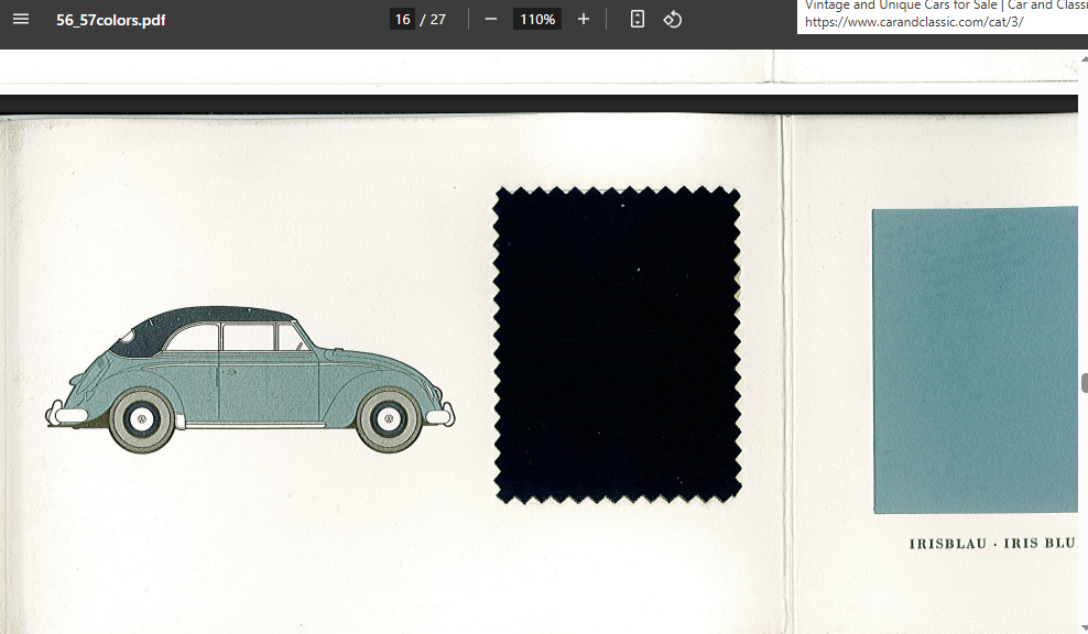

I thought the original color was pretty dark
more info here, but there are conflicts between the color cards one saying disk while the other says rim
https://www.thesamba.com/vw/forum/viewtopic.php?t=784242

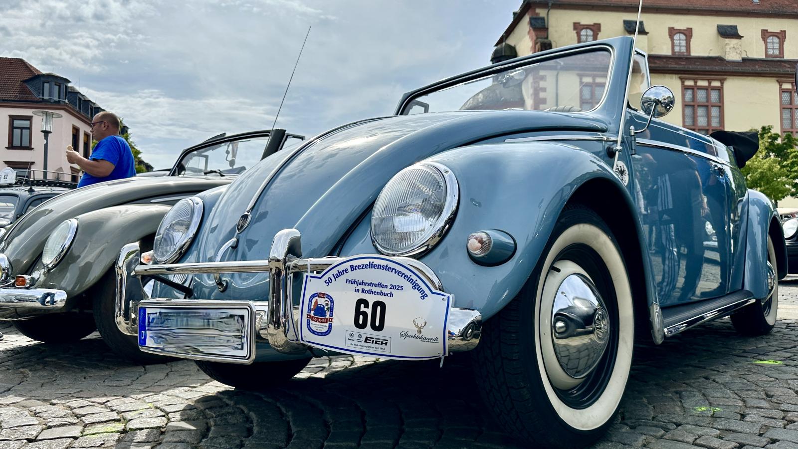

Here is a pic of what i think are iris blue verts on the top, see the wheels are all dark so not sure what to think

^ disc and rim all dark blue matches the illustration in the paint/interior book, the other body colours have 2 tone wheels illustrated...

trouble is VW seems to say L233 for both rim and, elsewhere, disc. the oval era wheels had a white based disc (centre) and a rim colour based on a dark body tone. so if L233 was just the rim then it would look like this

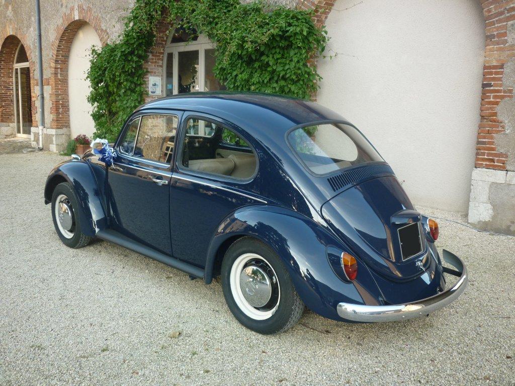

not sure where the ral5009 azur link is from but, to me, it's the wrong shade completely. it is not a dark blue and has too much green in it. the colour swatches show what I would call an inky blue which is more of a dark cobalt or prussian blue. this photo of a cobalt blue beetle has the right look in the darker tones

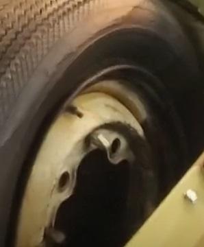

The center always was a light cream/beige. This color is nowadays also called L233.
The color of the rim can be found in the paint book, as mentioned - L233.

looking close to the wheels, it looks as if the wheel rim and disc are different colours: rim black, disc dark blue. obviously consistent with the color scheme from 1955 onwards
perhaps due to the vehicle's equipment with Lemmerz beauty rings?
up to 1955, color scheme was apparenty different,with a dark blue rim, as altewagen had pointed out.
furthermore it is interesting to note that, prior to 1955, colour descriptions often referred to contrasting colours for either the wheel rim or the disc, raising the question of what colour the other part of the wheel was – the same as the car?

I think the change in wheel color layout was related to the beauty rings for sure, 55 up the rings came as standard equipment where 54 and earlier they were an extra accessory. The different paint layout will tell you if the rings were from the factory or dealer install. 54 and earlier kabrios seem to have color matched wheels and caps
Everything Ive seen and read it seems Karmann kept things simple from 55 up as the wheels came in black from wolfsburg so only added the color listed for the disk/rim. Cost and time savings similar to their body painting methods (painting everything under the hood including bumper supports and such). The only body color match on the wheel was the VW logo on the hub cap.
