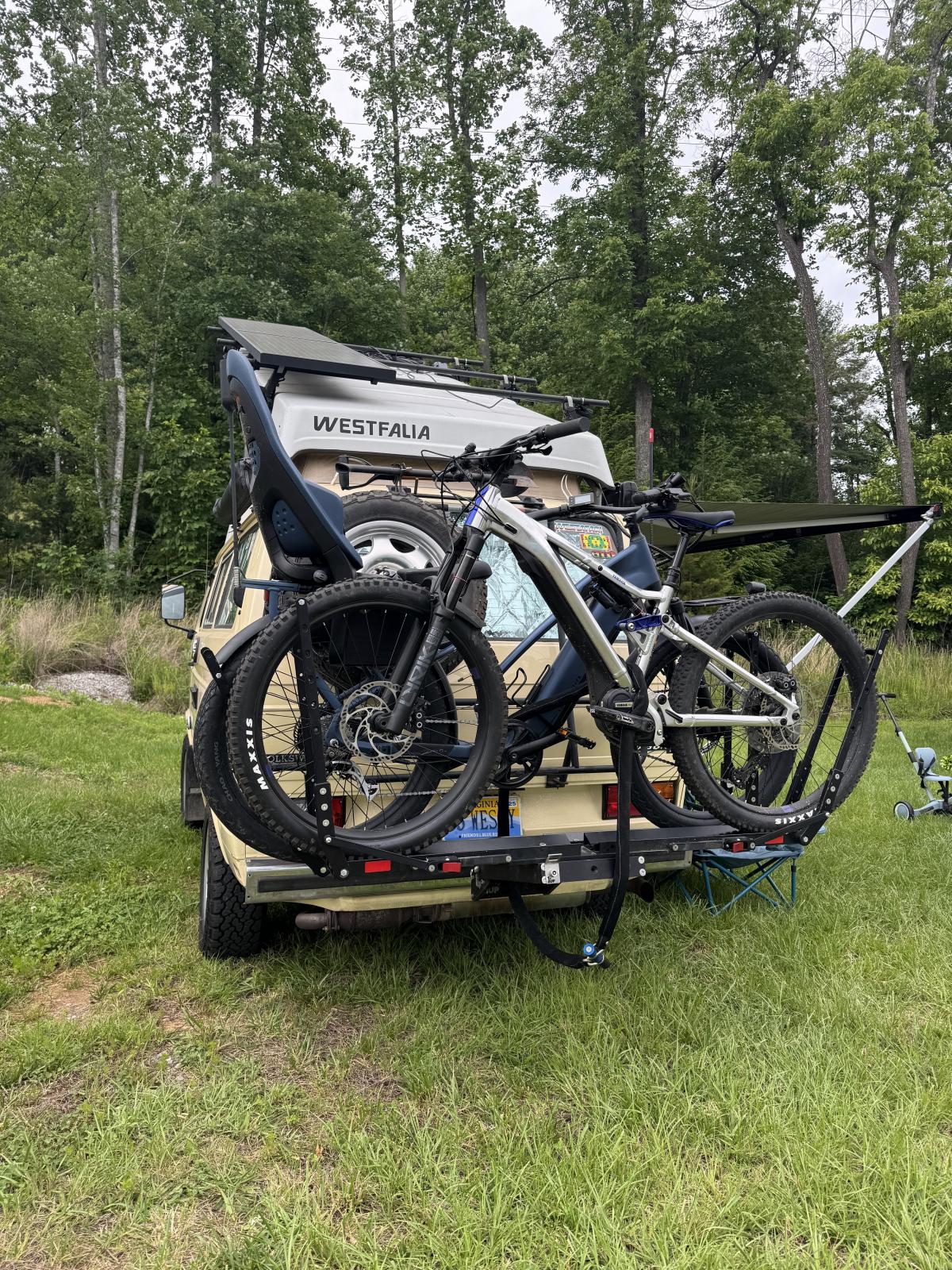

Fiamma hatch mounted rack Pros: taillights are fully visible; rack does not interfere with access to the hatch, esp. if the hatch has heavy duty struts; lowest cost; lightweight. Cons: can be difficult to open the hatch with bikes on it w/out heavy duty gas springs (Before I added heavy duty struts I raised the hatch with two bikes on it and put a stick under the hatch to hold it up.).*
Hitch mounted rack, Pros: easier to put bikes on the rack; no added weight on the hatch; usually very sturdy. Cons: Heavy; very much in the way of the hatch unless mounted on a swing out**; usually 2 - 4x the cost of the Fiamma, esp. if adding a swing-out; often block the taillights.
I've used Kuat and Yakima hitch mounted racks, 1Up tray racks and the Fiamma. I loved the Fiamma but only used it with two bikes so I can't speak to adding a third bike.
* This thread describes Heavy Duty gas springs (struts) that hold the hatch up even with bikes on the Fiamma rack:
https://www.thesamba.com/vw/forum/viewtopic.php?t=687800
** A hitch mounted rack with a swing-out is a pretty sweet setup but it's another $500 and 40 lbs of weight on the back.
https://kuat.com/products/pivot-v2?variant=47404133056810

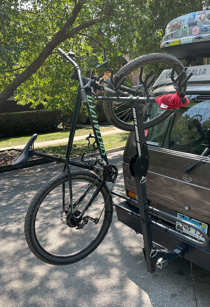

The Fiamma was my favorite rack until I went to 1UP racks on an RMW swing-out.

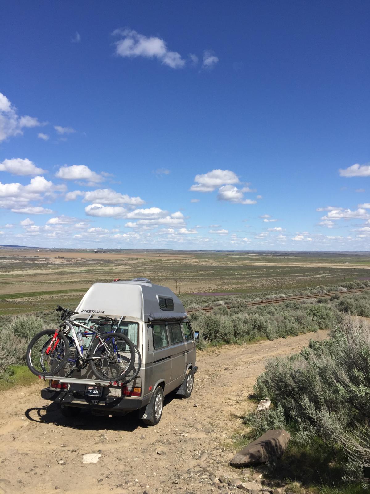

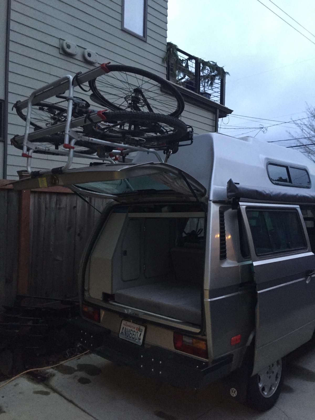

What’s the approximate weight of the bikes? I have used Fiamma racks with two bikes on the 72 bus. This is only 50lbs of weight. Fiamma designed a fantastic rack for Type 2 and T3s.
I have a Fiamma 3 tray rack for the 85 weekender I have yet to install. I think for traditional bikes I’d have no worries loading 3 bikes. I wouldn’t be comfortable with 2 E-bikes. Fiamma knows what they are doing. It would make my butt pucker loading up three E-bikes. So I will be following this thread. Or perhaps a call/email to Fiamma US Popcorn

We have 2 ebikes with a total weight of about 100 lbs and we have gone through 2 Fiamma bike racks. We finally went to a hitch rack.

That rear hatch is very strong and can take a lot of weight. I would not worry about it as a limiting factor.
I have had a Gary Lee rack on mine with a spare tire, 5 gallons of gas, and other stuff. The hatch didn't care, even off road.

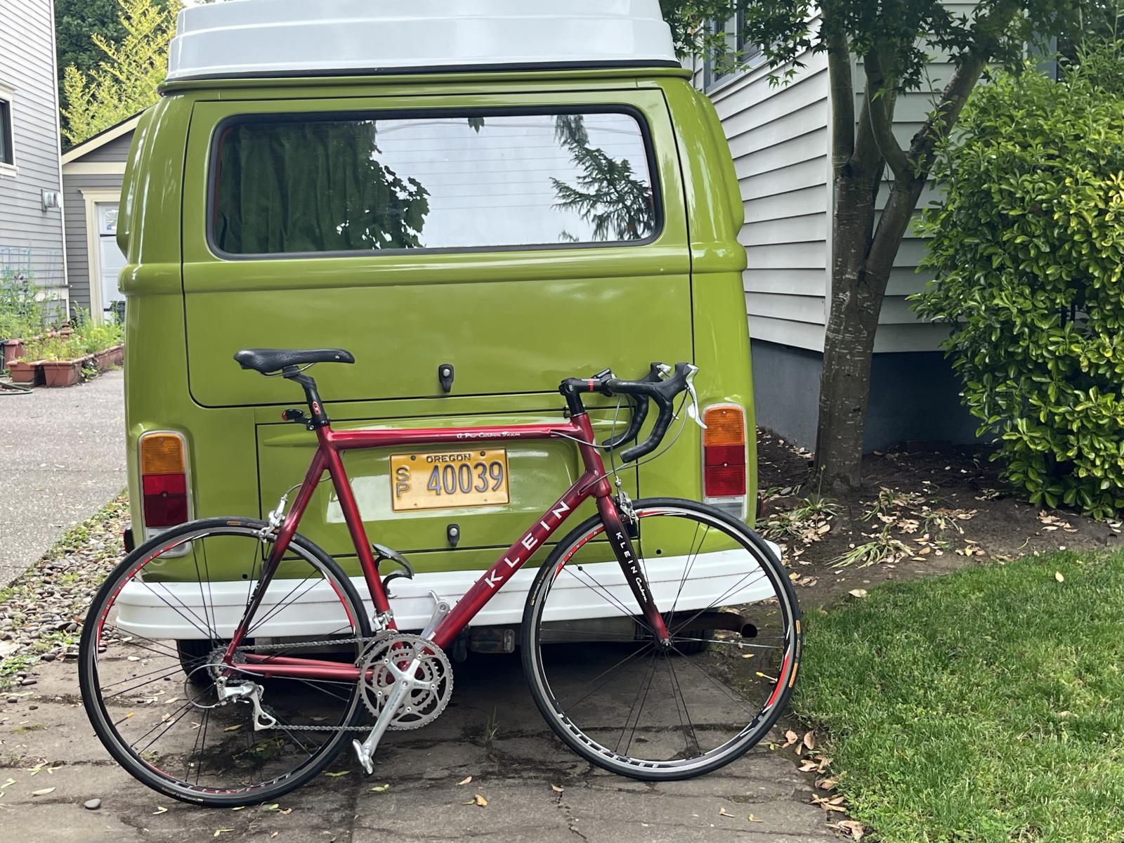

those Rolf (Bontrager) wheels, had them on my Klein Quantum Race... i'd be more worried about those than the weight of a 3rd bike on the FIAMMA
Nah, it’s a fitness rider these days. Probably too fatigue for anything serious. Still the most comfortable bike I’ve ever ridden.

We still like ours after over 3 years of use. It is well made, easy to use and has held up well to unpaved road vibrations.
I agree that one should budget in the cost of heavy duty tailgate shocks (they weren't expensive when we bought ours). The set I went with are too strong for my wife to be able to close the tailgate Embarassed and so I'll be replacing them soon.

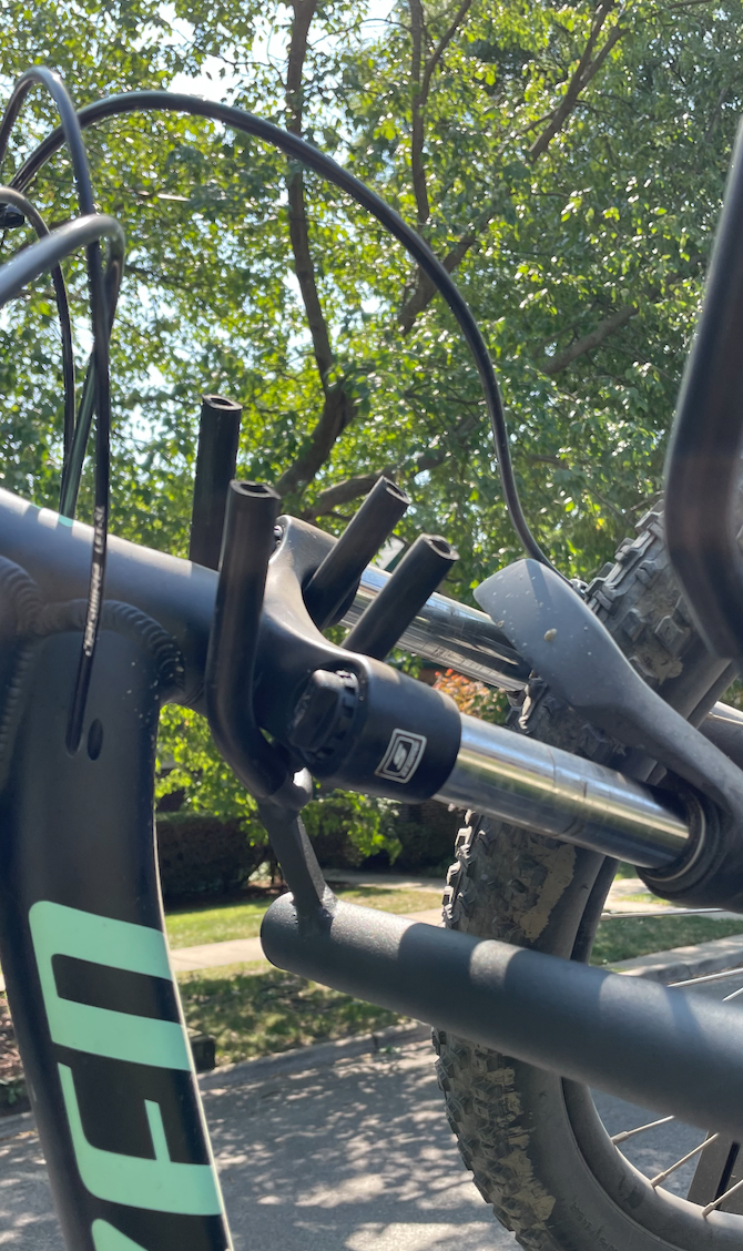

If you're only bringing mountain bike style forks (can be with or without suspension, but the crown width needs to be pretty consistent) North Shore Racks NSR 4 is a good option. Super easy to load. I can put 4 mountain bikes on in 3-4 minutes. Very stable with a 2" hitch. and drops down to the back tires of the bikes to open the tailgate. Velocirax is a similar solve, but with a basket for the front wheels instead of "fingers" that interface with the fork crown.

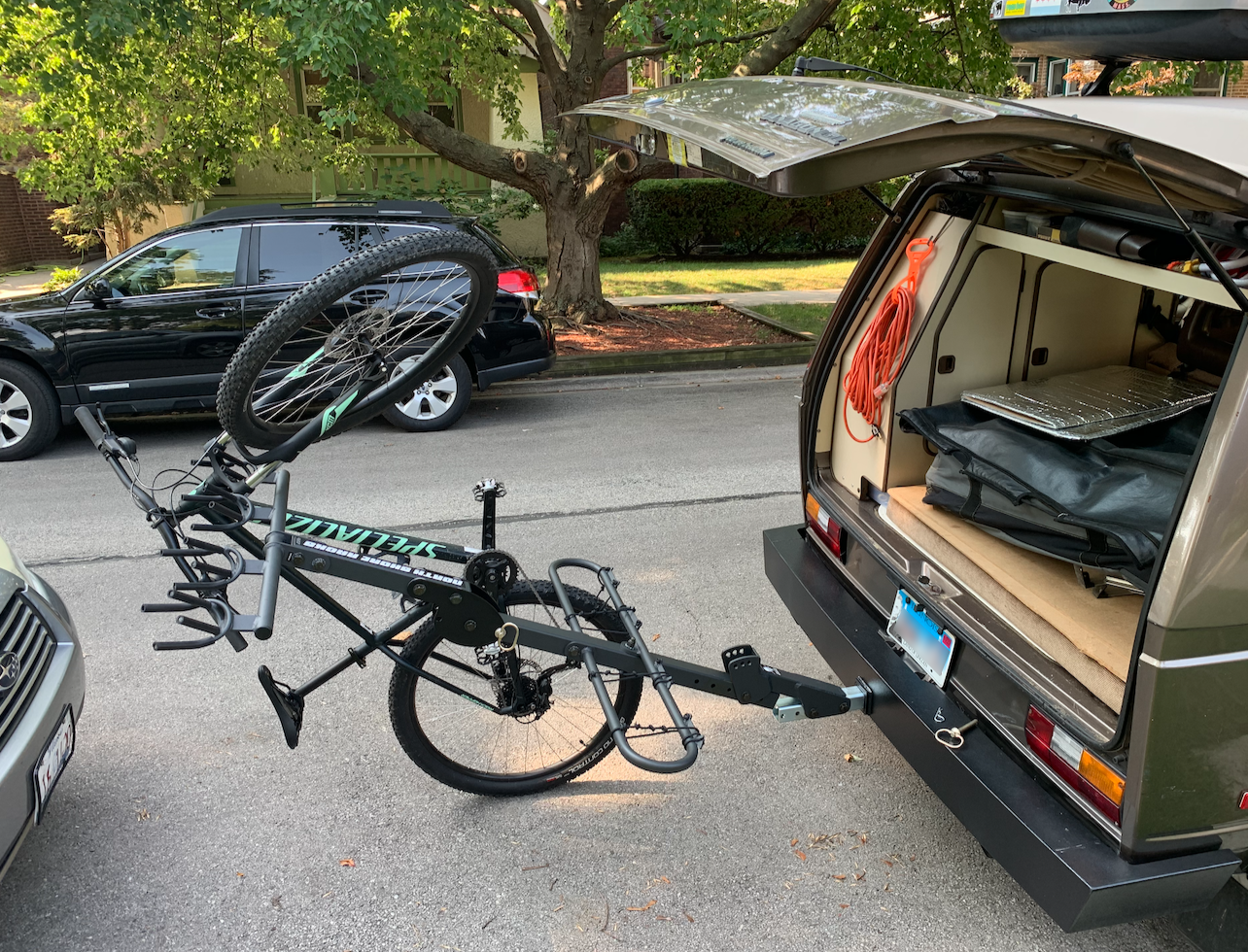

Would putting a 2" hitch on the Van with my Kuat 4-bike rack to be too much? That's what I have on other vehicle and the rack itself is very heavy. I assumed it would be too much for the Van so I researched the Fiamma.
