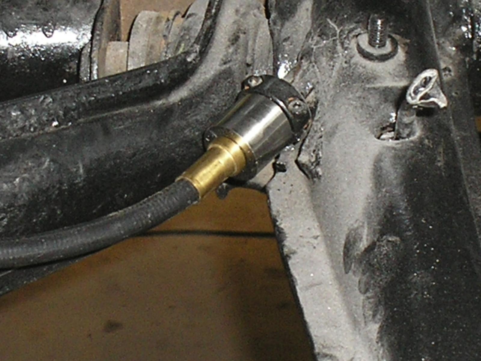

PostPosted: Tue Dec 02, 2025 6:31 pm    Post subject: Re: E Brake Cables Reply with quote
I made this so the brake cables would work on the disc brakes installed on a '72 Ghia. Fits where the pipe comes out by the transaxle and the cable. Might work for your issue
