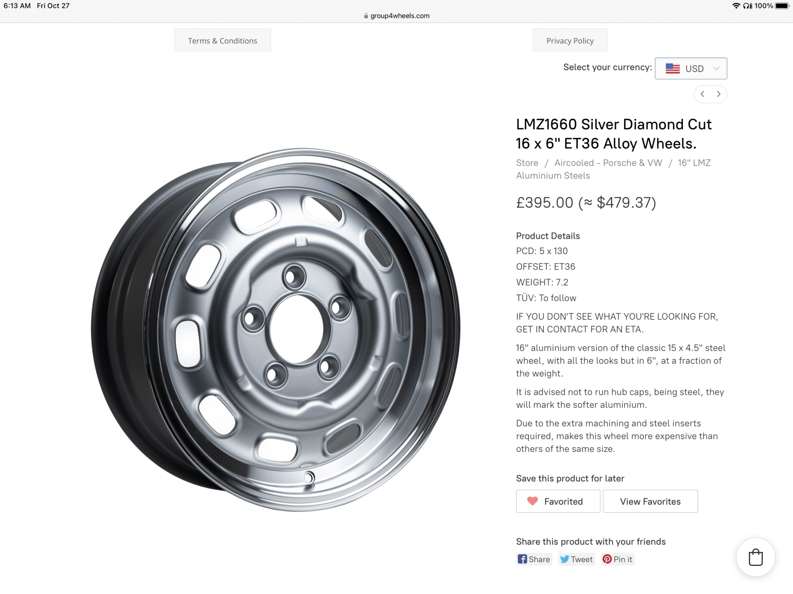

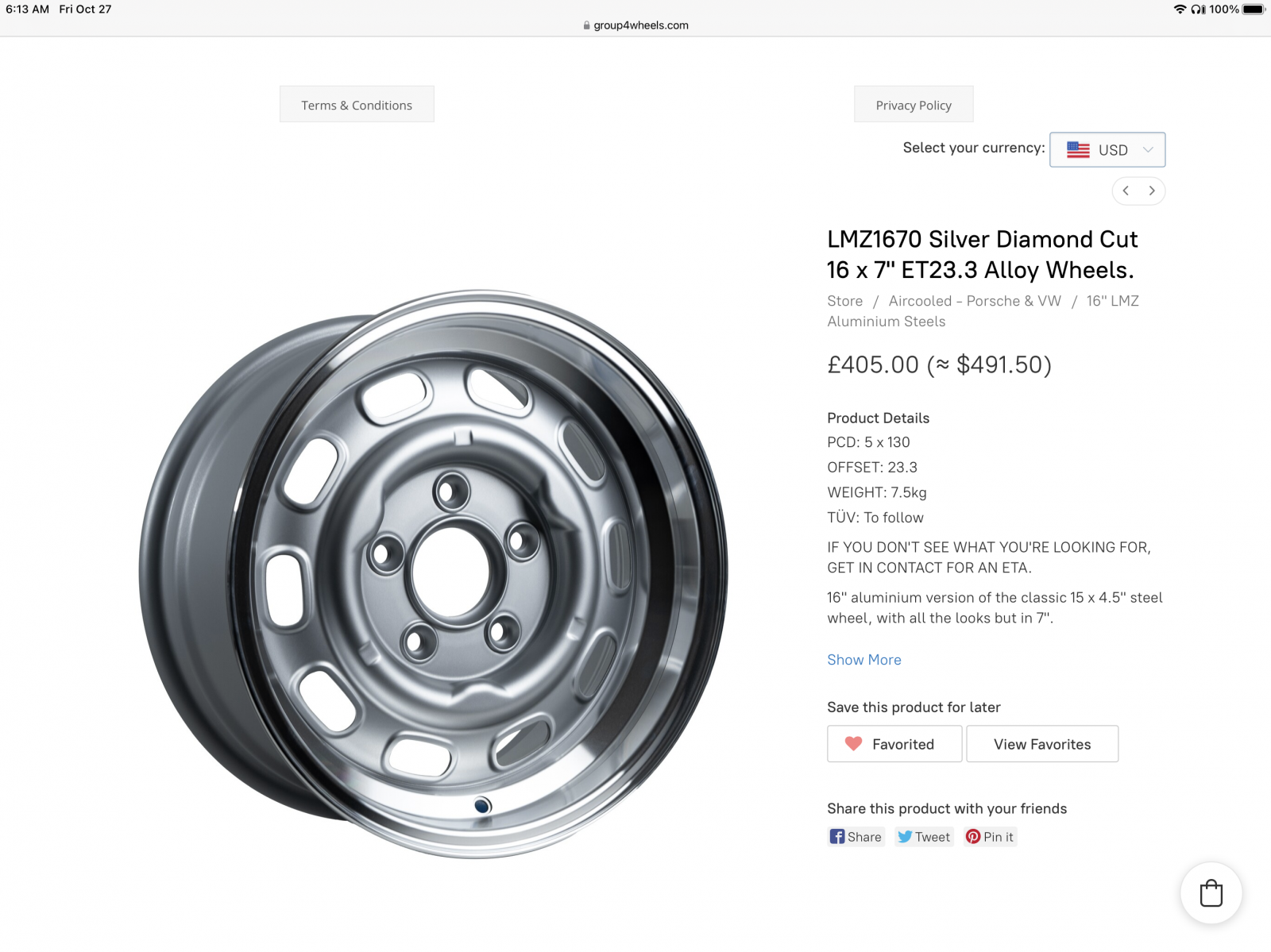

Funny you should mention the vintage Porsche steelies…the old 15x4.5” wheels…I also like those (the Fuchs are just overplayed currently imo). I was watching a Magnus Walker OPP video on a restomod 912 using 356 styling cues and details. The car had what looked like the 911 steelies…turns out they are reproductions done in light weight aluminum alloy! And they were 16’s! Magnus was equally curious about them and asked the owner what kind they were. They are Group4Wheels out of the UK. I went on their website: https://www.group4wheels.com/store/16-LMZ-Aluminium-Steels-c127677601 and ordered a set of 16x6 and 7’s! ETA is December!
I talked to Jon Chabot owner of TopLine Parts about whether he thought the wheels would fit a ‘72 SB under the stock fenders and he said they would…using 205/55-16 tires on the 6’s and 225/50-16 on the 7’s rear. Cool thing about those wheels and tire sizes are…1) they are very close to the same rolling dia as the OEM SB wheel/tires, 2) their rolling diameters and sidewall heights are the same front and back (24.9” with 4.4” sidewalls), and 3) they are the same size wheels/tires that Porsche offered on the ‘80’s 911 Carreras! So they’re still plenty of performance tires in those sizes to choose from! It’s win, win, win! Very Happy
I’m not sure if these would fit a beam front end of a standard. Someone on Samba probably knows. Yea, I’m not a fan of the narrowed beam look…doesn’t look right to me.

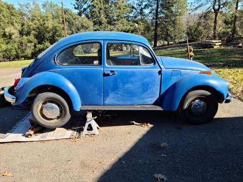

PostPosted: Thu Nov 09, 2023 6:23 am    Post subject: Re: The DUNGBTL Build Reply with quote
Thumbs Up Love me a Gentian Blue '72 Super Save!
Popcorn
'75 Super Le Grande...we hardly knew ye. Sold 2025 for peanuts.
Click to view image
Save the Supers!!

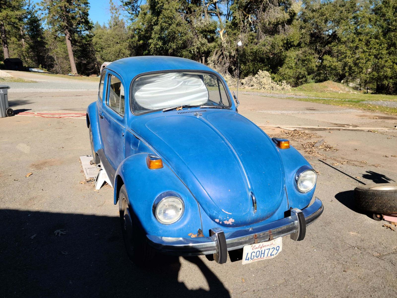

Nice! That’s a good looking SB!

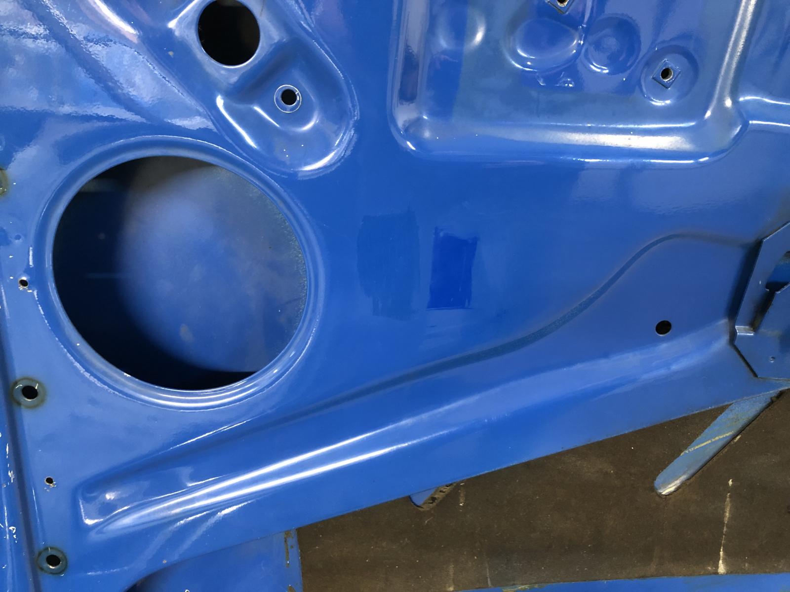

Unfortunately the DUNGBTL exterior paint is not the original Enzian or Gentian Blue (a one year only color for ‘72 beetles) but an old repaint (only one!). Car does have some very cool patina, esp the roof, which I have enhanced. The interior is all original paint and in very good condition.
I removed the fenders (doing something different with those) and color sanded (1500) and polished the exterior to enhance the patina. I do not plan on painting the exterior (fenders yes, have plans for the fenders/bumpers). Doing a polished patina look using only color sanding, polish and wax, no ‘sauce’.
FWIW, I found that Euro color standard RAL 5010 is almost an exact match for my Gentian blue. It’s much cheaper to buy a standard color than a factory specific mix. I’ll be painting the some of the interior, touching up the frunk and engine bay with this.
The RAL 5010 ‘rectangle’ is on the left…Rustoleum ‘pure blue’ on the right.

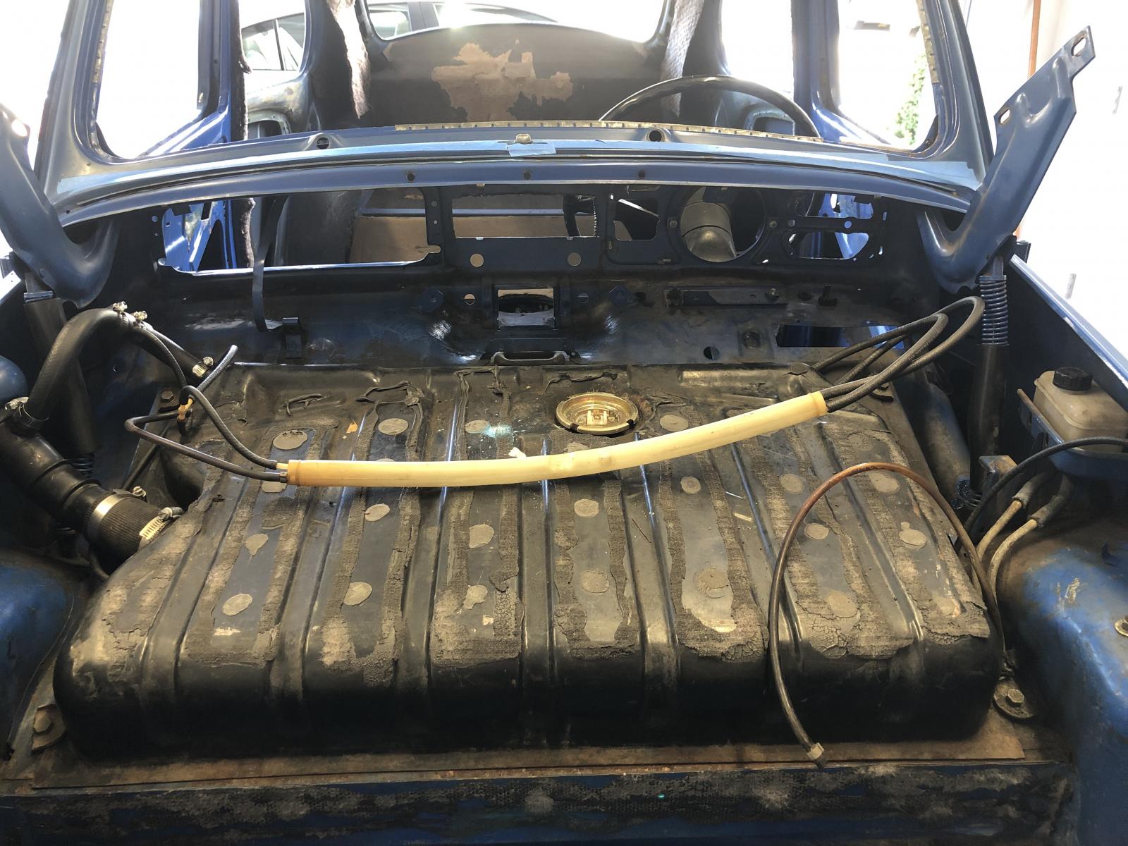

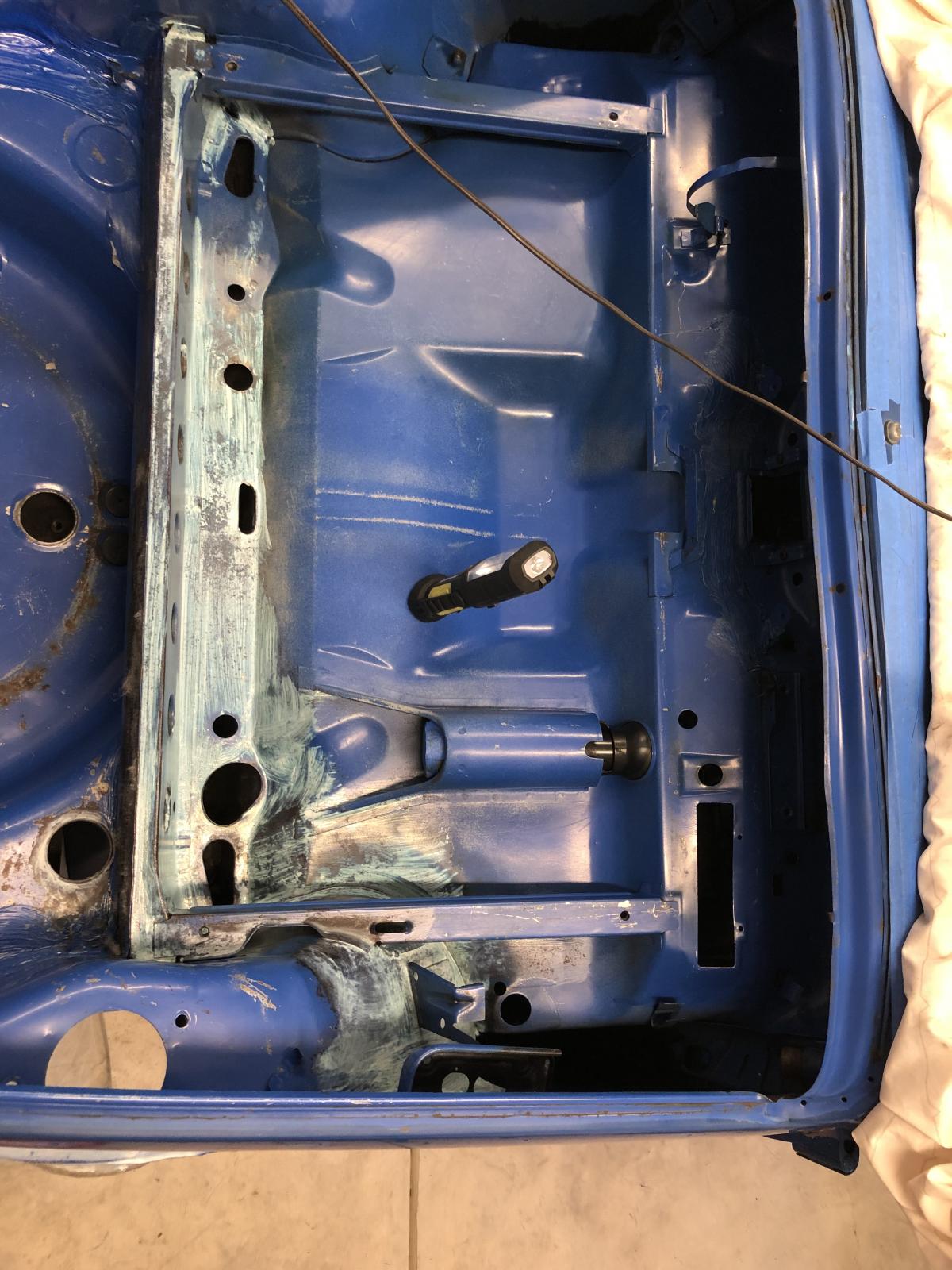

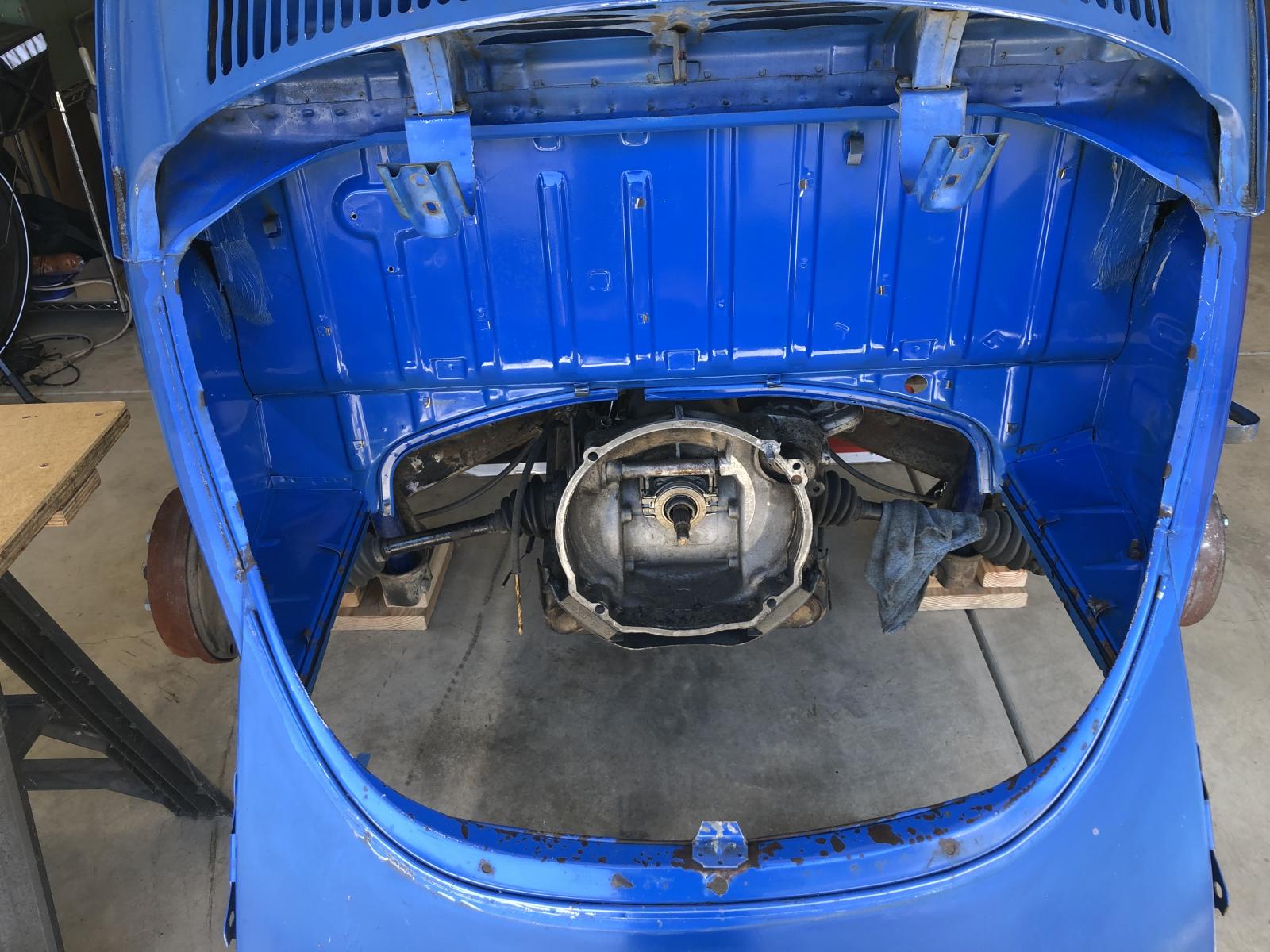

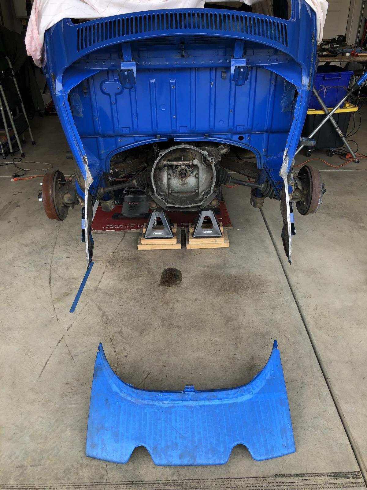

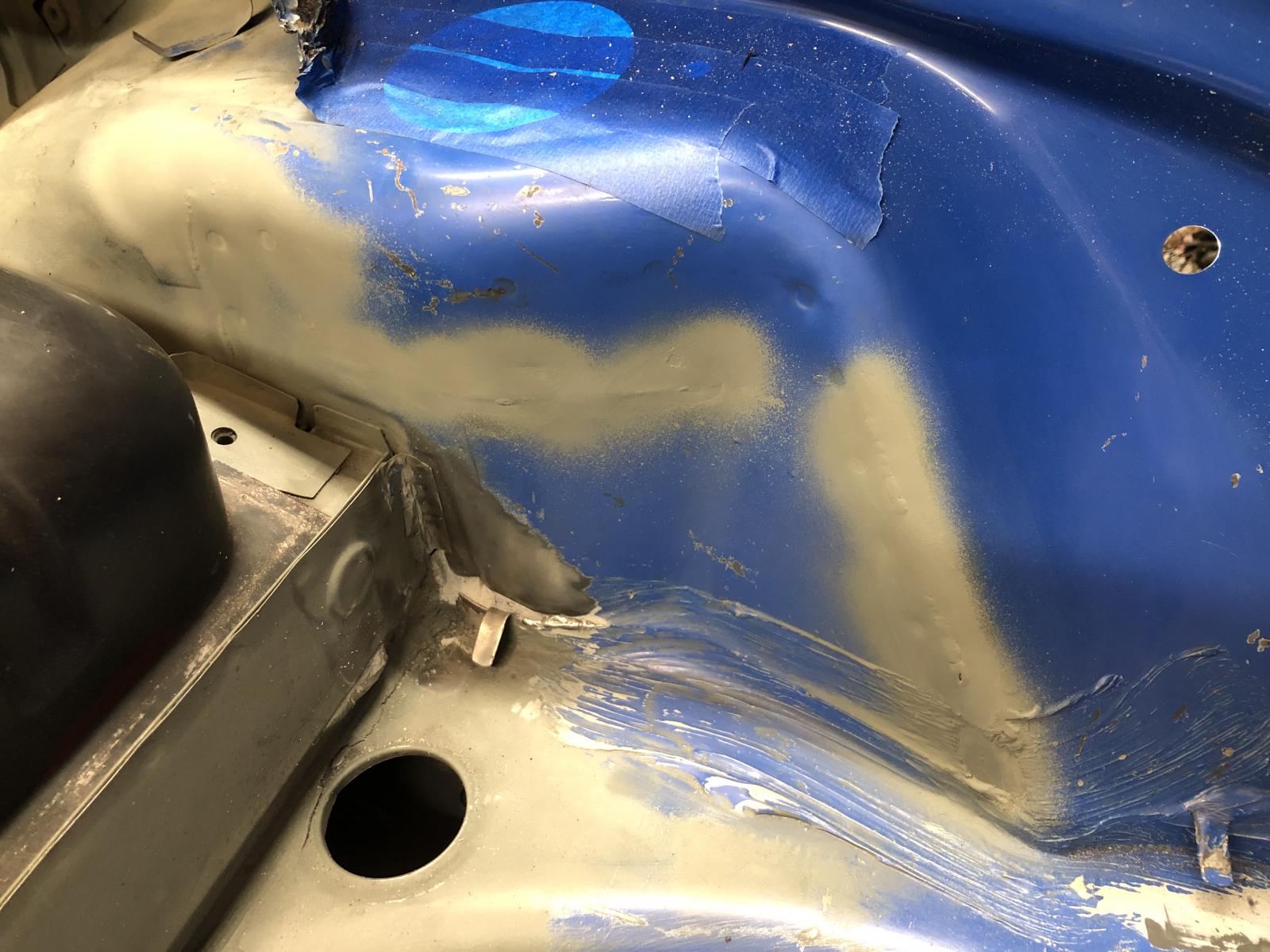

After removing the pile of personal belonging from the deceased owner, I stripped the car of interior, all glass (all original except for windshield), front suspension, gas tank and wiring rat’s nest.
It looks like the master cylinder was leaking so I cleaned that area up and treated it w/rust converter…
…then I went to the opposite end and cleaned the undercoating(?) from the eng bay to reveal the true Gentian Blue color! Very Happy

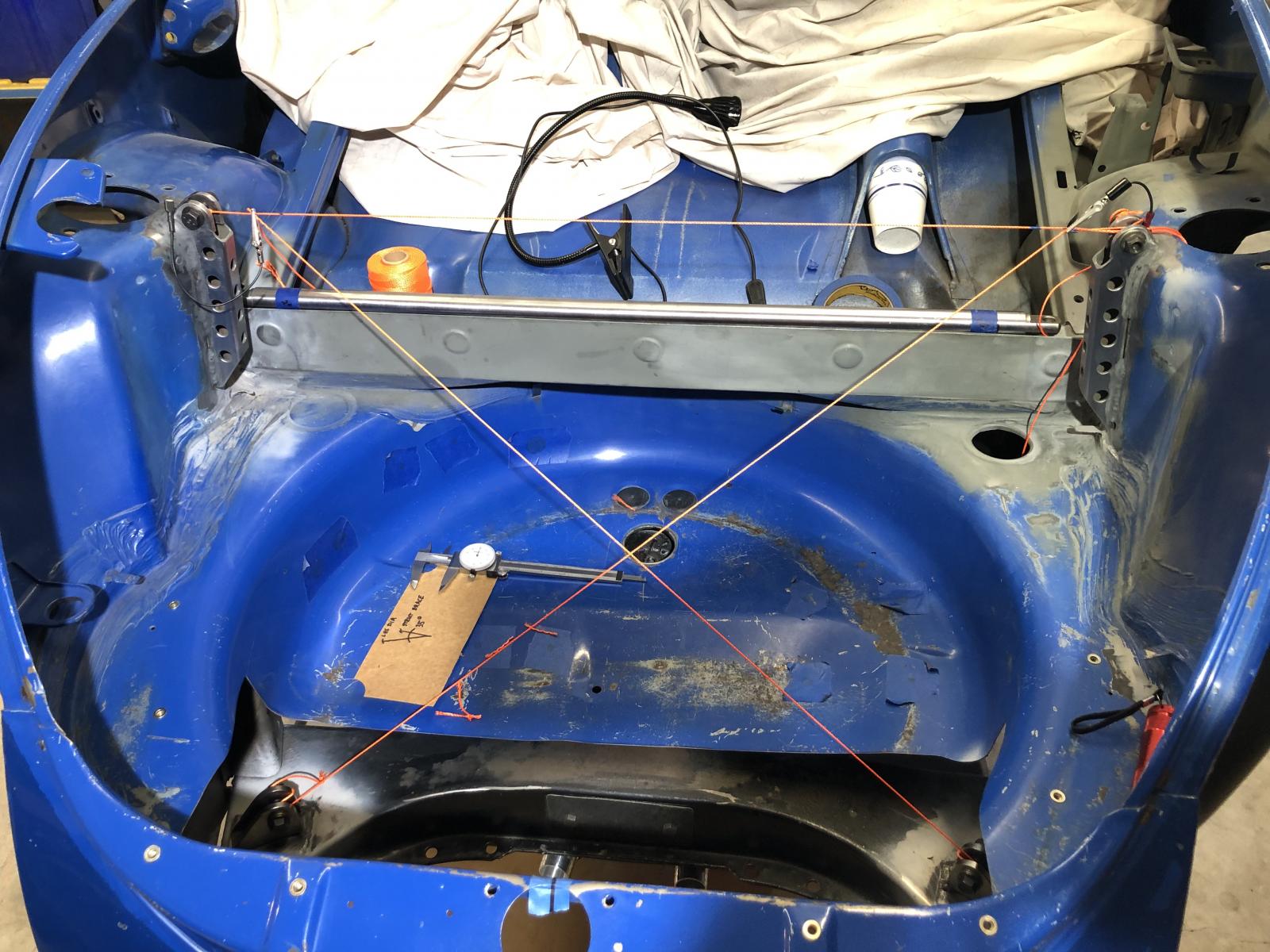

While I was back there, to make installing the EJ25 Subie engine easier, I drilled Very Happy out a few dozen spot welds (or so it seemed) and made the rear apron removable…

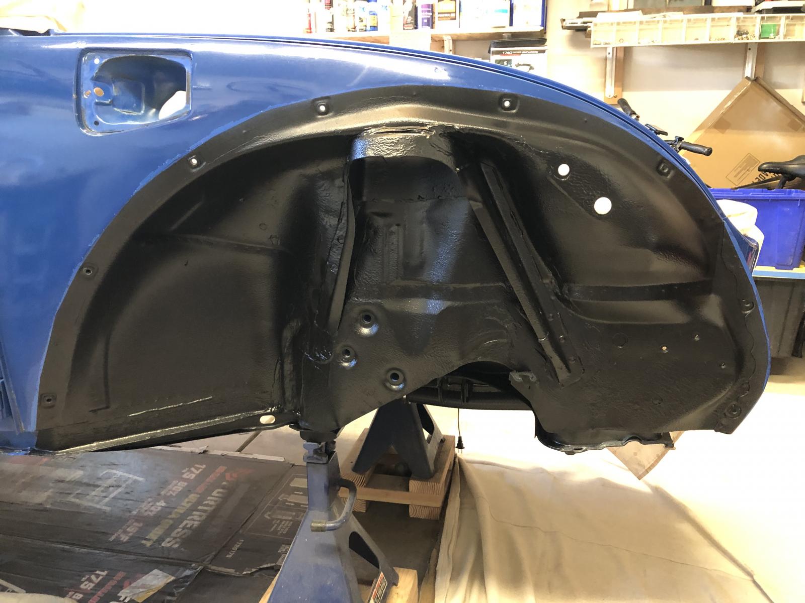

I cleaned up the apron (underside…this is a patina build, remember! Smile )…undercoated (Wurth), and painted (using my favorite chassis paint: catalyzed Rustoleum Satin Black). Then packed it up for storage for install at a later date!
Of course this wasn’t done all in one day. I’ve been at this for a year and 1/2 and have hundreds of pics…I’m just trying to catch you guys up! Very Happy
Cheers, J.

R7 was also sensory overload, even the parking lot had so many cool Porsches! I got to talk to Rod Emory about a few of his cars which was a cool moment, and there was a Singer there too. I also went to Luftgekult last spring which was equally incredible.
I think the guy that did that 356 inspired build either used to or still works at Singer. Pretty cool build for that guy. I love those wheels but they're pricey! Especially compared to what Mobulwagen offers. I'll need to do some more research on the standard and lowering, wheel spacers, and wheel tire combo, etc.

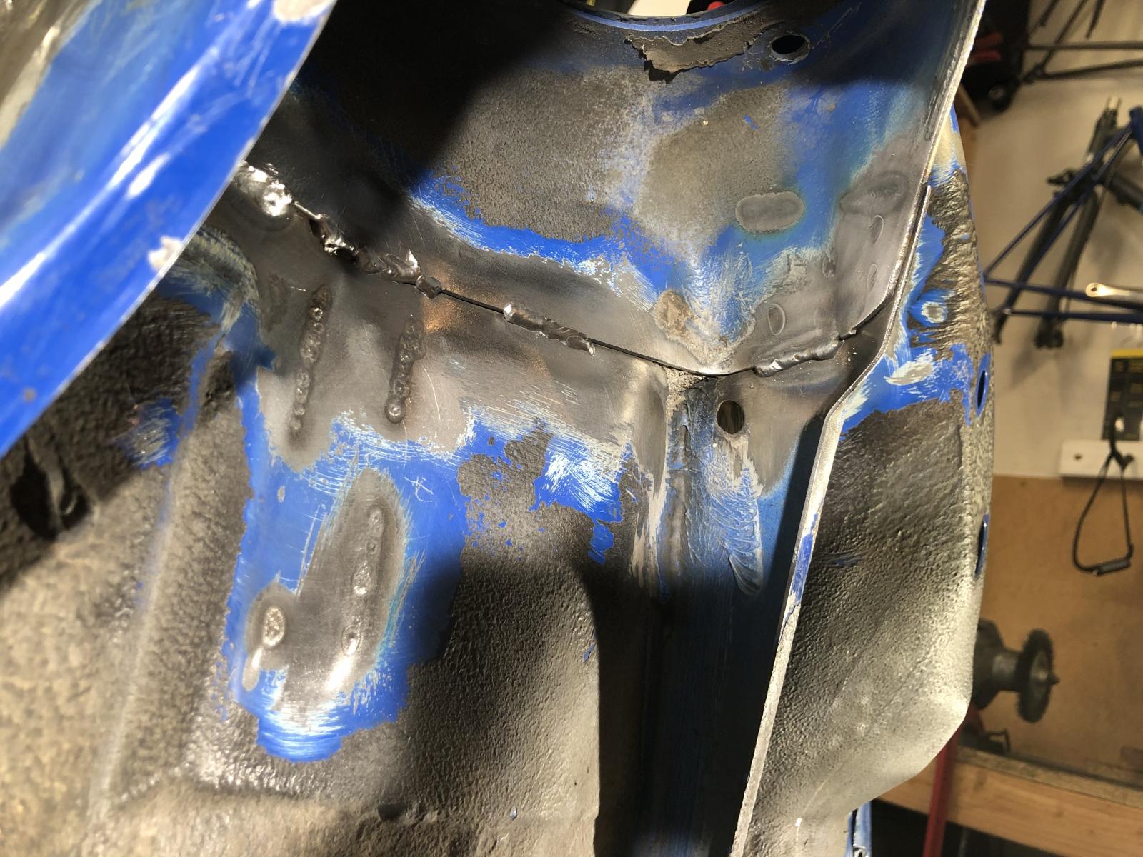

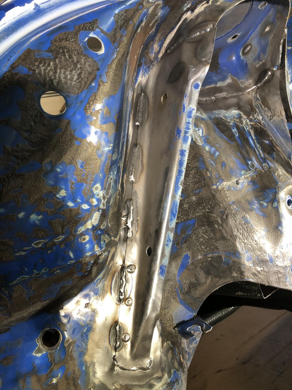

PostPosted: Fri Nov 10, 2023 8:01 am    Post subject: Re: The DUNGBTL Build Reply with quote

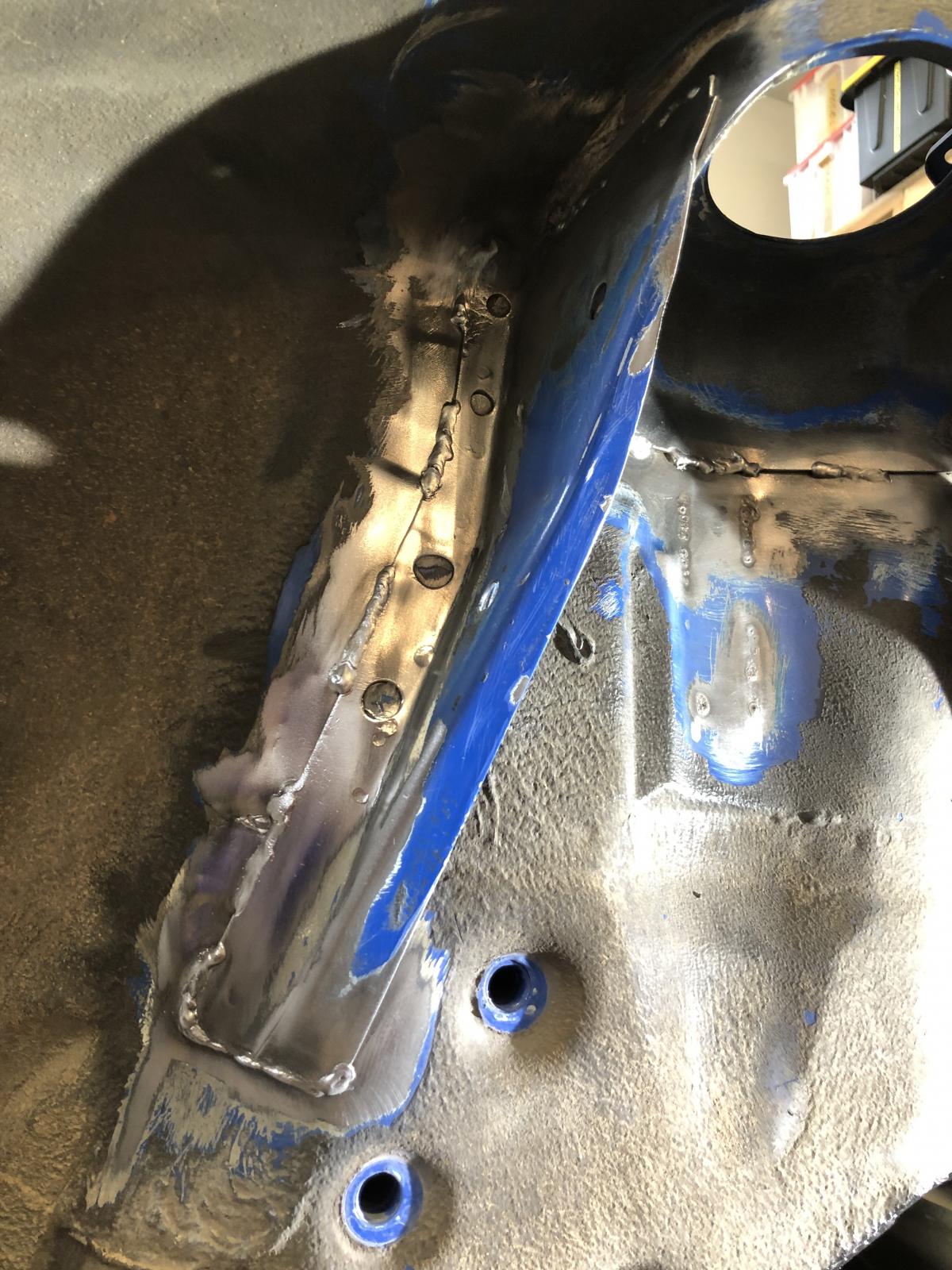

On with the show!

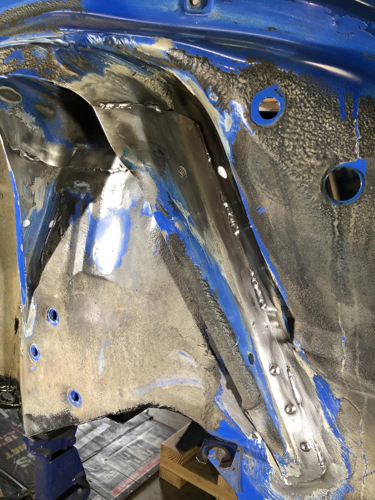

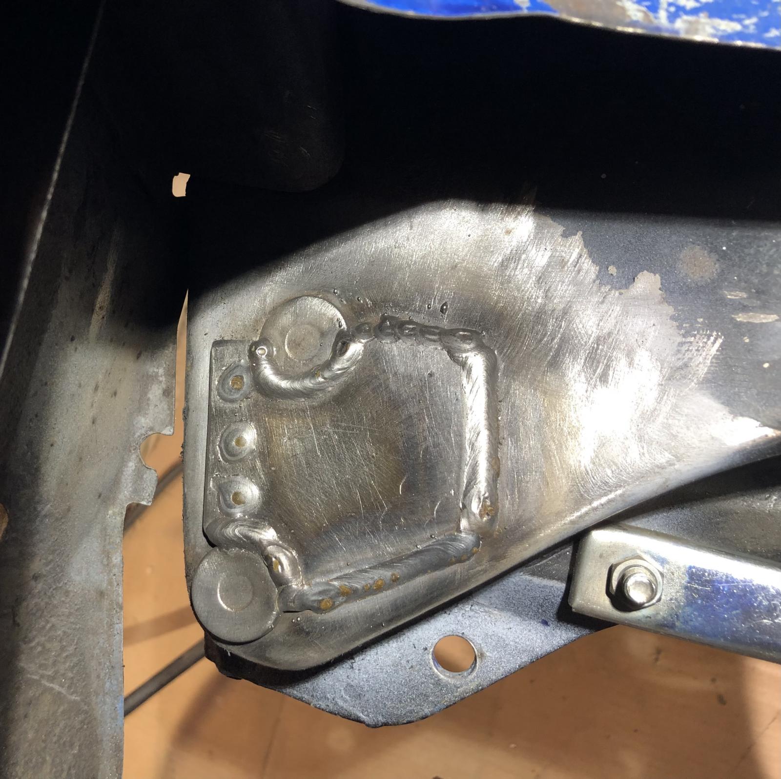

Suspensions typically work better when they’re attached to a structure that doesn’t deflect…a stiff chassis. To that end I started my attempts to add some chassis (read: pan & body) stiffness to the DUNGBTL. Started w/the front strut towers. Wire cup brushed (on angle grinder) away 50 yrs of dust and debris from the wheel well and used fire (propane torch) and a paint scrapper to remove the seam sealer from the strut tower doublers. LHS Prepped for stitch welding:
…LHS strut tower stitch welded…
….stitch welding penetration…I had shoved my car cover (old bed sheet) into the frunk prior to welding. Imagine my surprise when I smelled smoke and flipped my welding helmet up and saw flames! Yup…weld penetration set my ‘cover’ on fire! Shocked Good thing I was wearing thick welding gloves…clapped the flames out and continued. I did have an extinguisher 3’ away…

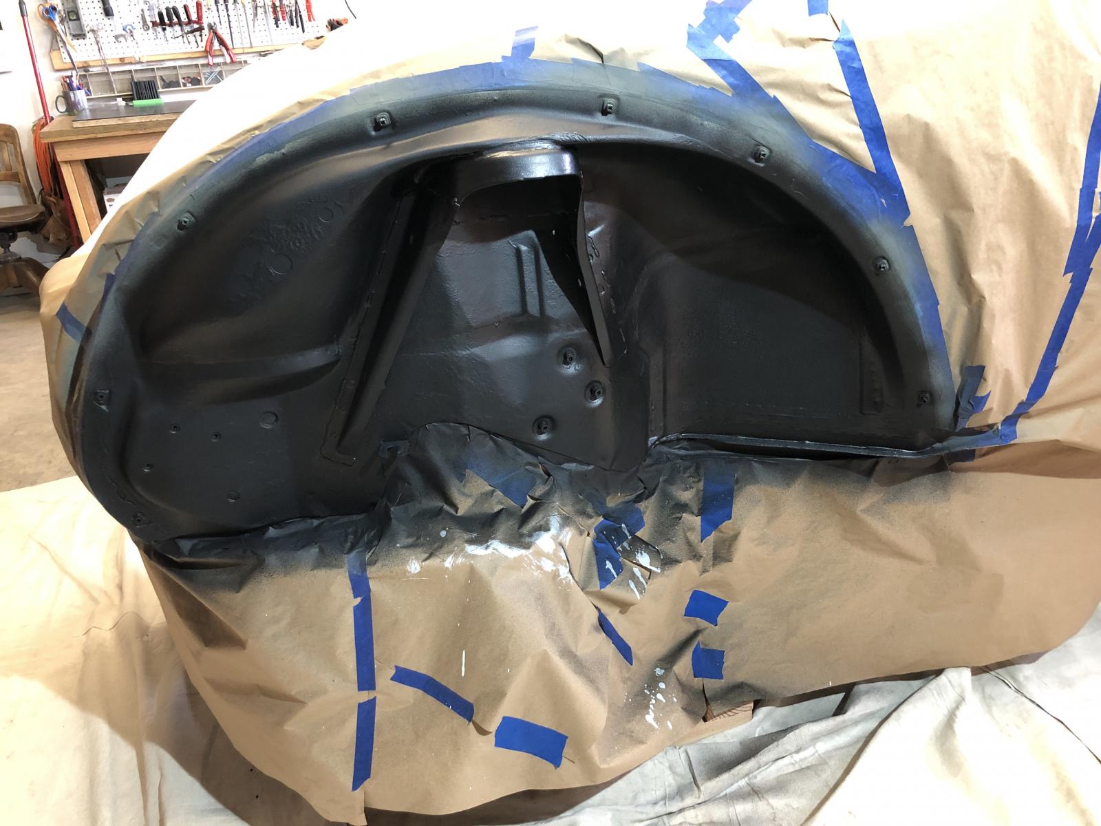

Etch primed the welds and wheel well, undercoated (Wurth undercoating) and top coated (catalyzed Rustoleum satin black: 10:4:1, paint:acetone:acrylic enamel hardener)…
…and etch primed the frunk side…
And rinse and repeat for the RHS…

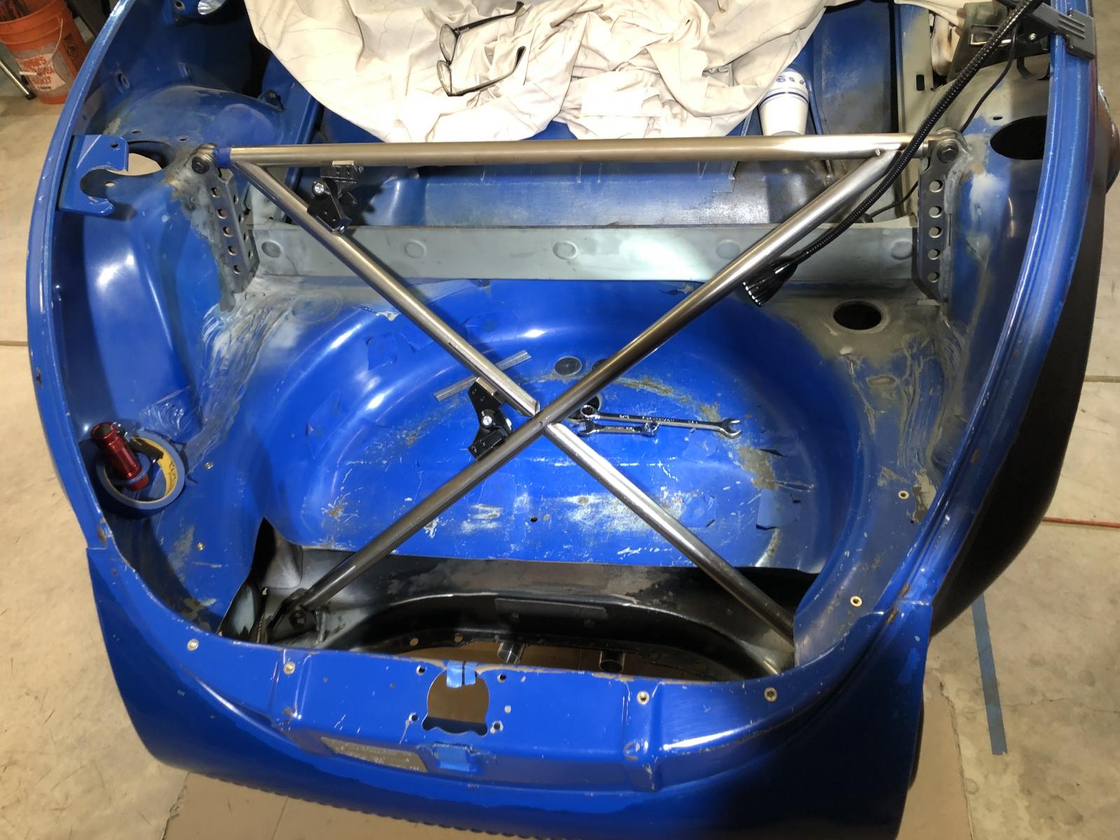

Next up…custom strut tower brace fab/install…

Thanks for the info! I’ve read about the flipping tie-rods trick. I’ll keep this in mind when I get to the front suspension. I’ve checked out TL’s offerings and already have a ‘wish list’ on the site. Those parts you mention and others are in there!
Most commercial stb’s (strut tower brace) leave a lot to be desired, imo. Most all are just a single tube/bars mechanically tied into some bracket mechanically (bolted) attached to the strut tower. Typically they have a pivot at either end which can only transfer axial loads. So, if you imagine the frunk as an open “U” btwn the struts, any side loads on the ‘tub’ reacted by the stb can still deflect the strut towers because the stb ends can pivot (tub taking the shape of a parallelogram).
Of course how much this actually occurs depends on the load level. And the stickier the tires, typically more the load transfer. DUNGBTL will use sticky tires, possibly ‘R’ compound. Ideally you want to triangulate the stb to react that pivot moment and stabilize the open “U” of the tub. That’s the kind of stb I designed…which is basically a copy of what’s been done countless times before. I essentially copied the design of the stb that vintage 911 race cars used back in the day. All in keeping with the vintage Porsche theme of the DUNGBTL! Wink
I’ll post the write-up (w/countless pics Shocked ) of my stb in a day or two.

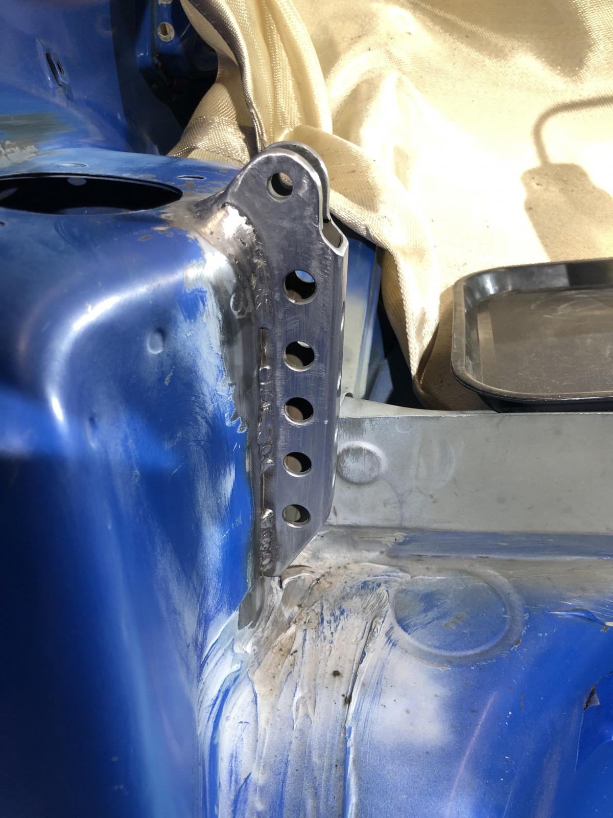

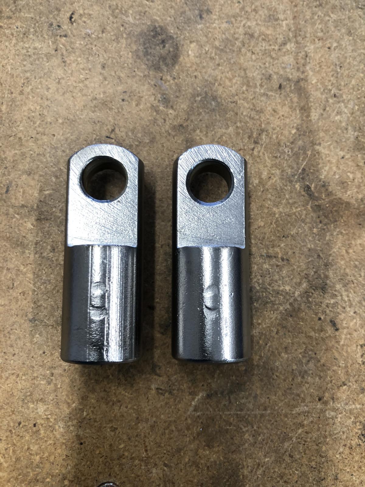

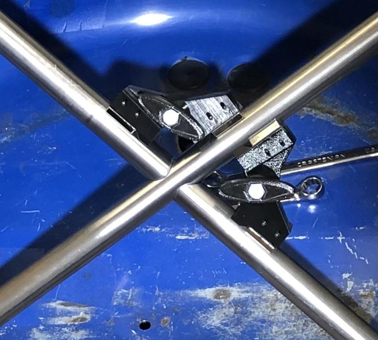

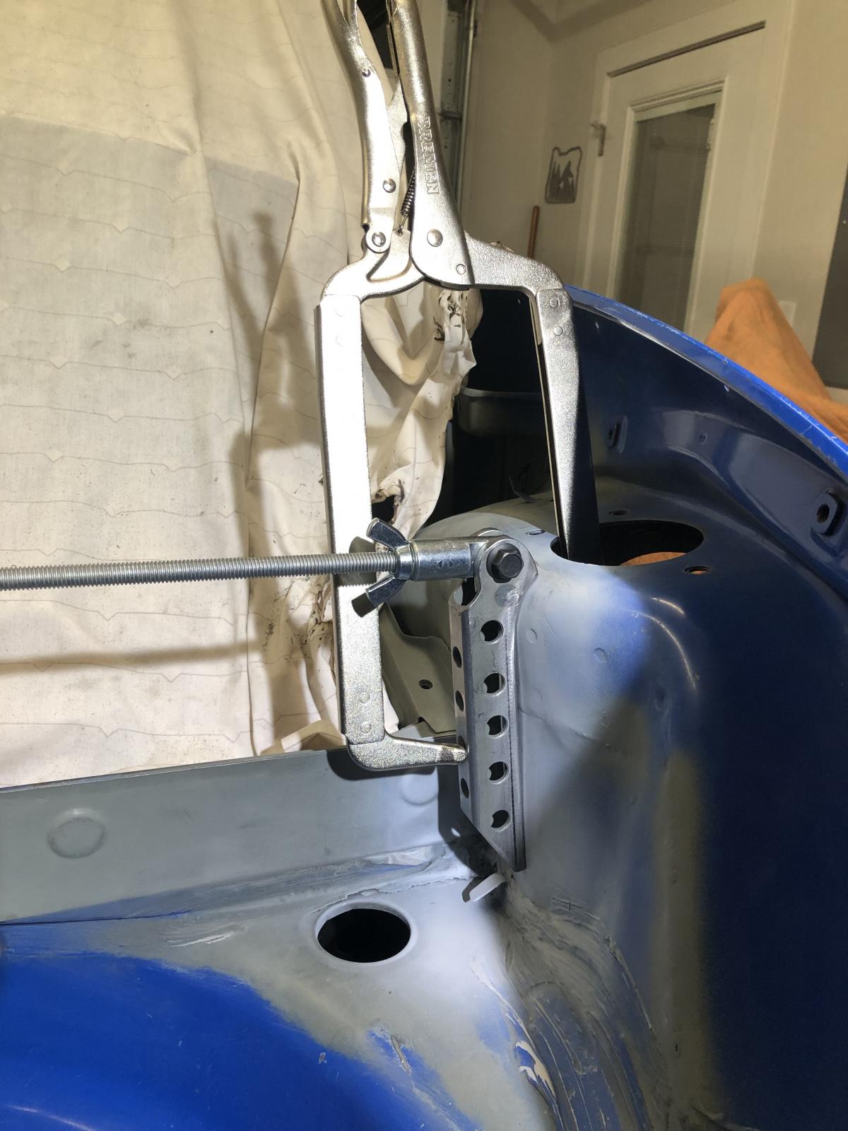

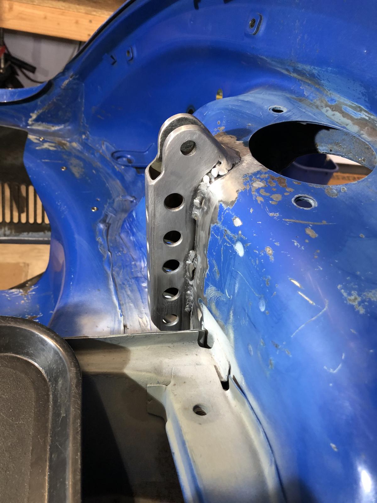

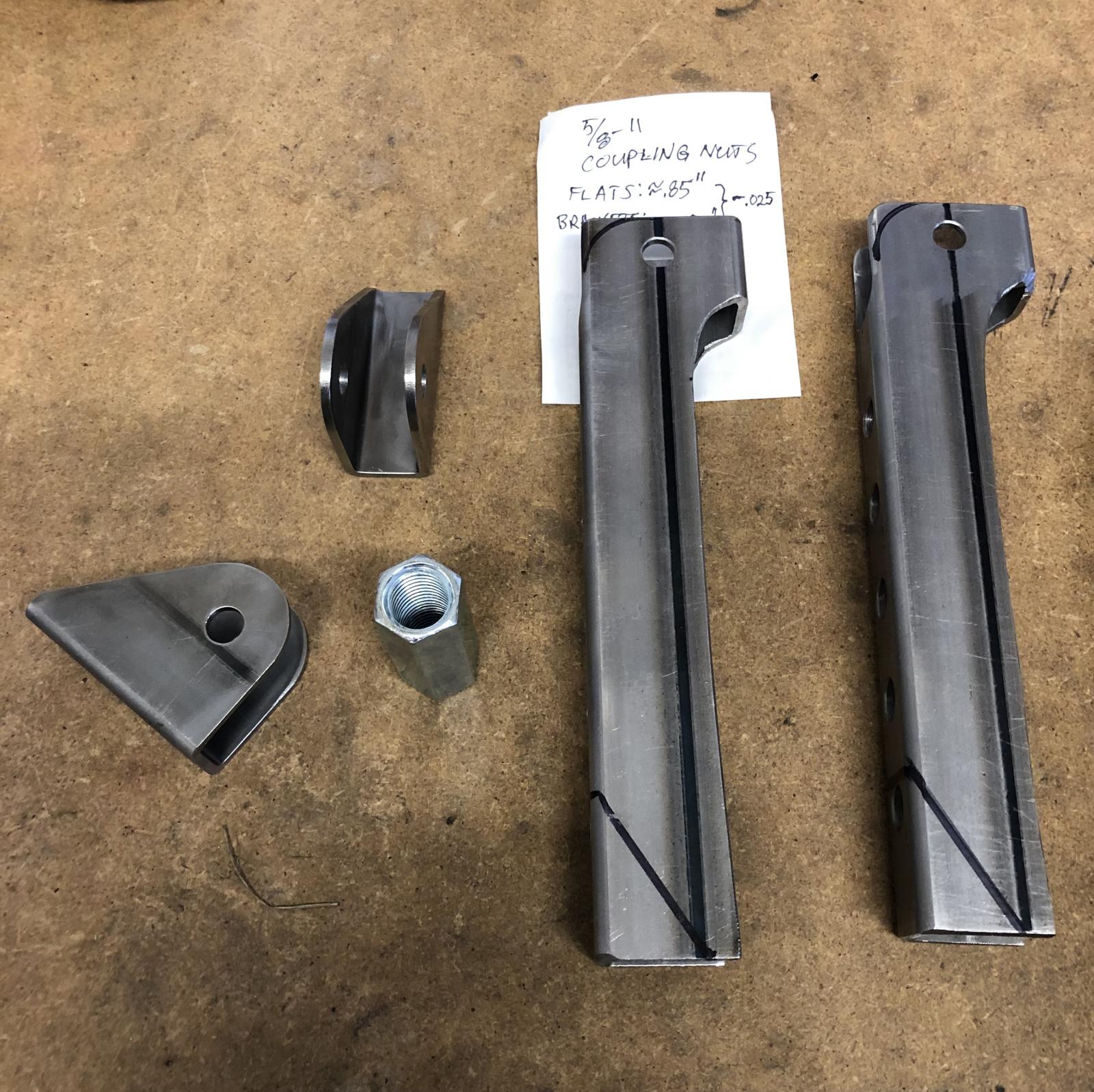

Strut tower ‘truss’:
To both stabilize the strut tower and frame head, and in keeping w/the vintage Porsche theme, I made a ‘truss’ in the style of the 70’s 911 RSR race cars…
I wanted the brace to be welded directly to the tower structure. I started w/1x2x.120” rectangular tubing and whittled out the tower and frame head attachments…
…w/some fine fettling, I ended up w/these parts…
The frame head where the stabar attaches, appears to be cantilevered a bit from the one bolt attachment to the front body structure. IMO, this location of the frame head could benefit w/some stiffening. It appears to me that the stabar on the SB not only functions as a torsional spring (stabar), but also as the fore-aft load reaction member of the lower control arm (lca)! Imo, it’s attachment could use some reinforcement! To that end, I wanted to have a welded attachment to the strut truss to stiffen by triangulation the strut and frame head structure. Jeeez… Shocked …lots of words there…on with the slide show!
But first…lets weld a 1/8” doubler on the frame head to capture the stabar attachment inserts:
Then I set the strut tower braces insitu on the towers (after using threaded rod to check for squareness w/the opposite side) and I ‘burned them in’ (as all the cool kids say Very Happy )…
After I had the truss reaction points located, I set about fabbing the bars (tubes). I used strings to represent the centerlines of the bars and measured the tube angles, printed out coping templates for said tubes, coped and fitting the truss together (photo montage time! ) Very Happy
Tubes tacked in place for welding on the bench…
Finished welded and bolted in place. Fits perfect, no threaded adjusters required!
The eagle eyed amongst you probably noticed the clevis attachment to the frame head doubler…
…this of course facilitated the truss attachment. The fitment of these clevises took a an inordinate amount of fiddling to position so that the truss ends fit tight in their slots but could allow the truss to be removed. In the end, all that time and fiddling was worth it as the truss fits “right and tight” but can be easily lifted out!
For the tube ends, I used hydraulic ram ends found on Amazon. This took seemly hours of checking dimensions to ensure that they would fit the ID of the tubes, have the width to fit my clevises/brackets and have a large enough hole for a structural fastener! Phewww…another run-on sentence! Shocked In the end, I did have to turn down the OD of the ends using my ‘drill lathe’ . I fined tuned the OD to be an interference fit w/the ID of the tubes. Froze the fitting and heated the tube ends to slip them in. Used 3 rosette welds (120* apart) to secure)…they’re not going anywhere!
So that’s the DUNGBTL strut tower/frame head truss! And yea, I cut a huge gapping hole in the frunk Shocked That’s for the water-pumper flat four’s cooling system (yes…it’s a Subaru EJ25 swap). I’ll cover that probably in the next post.
