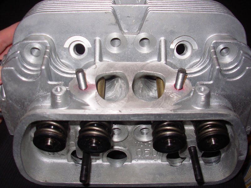

here some pictures from my 050 heads, they are still new, so i dont have personal experience with them .... yet .
76x88 , 1849cc engine build :
http://mundoescarabajo.com.ar/me/viewtopic.php?t=635

in the second photo from the top are those holes where the liner would rest, seems like they broke through to the fins when they machined these heads.

PostPosted: Tue Dec 20, 2011 4:36 pm    Post subject: holes Reply with quote
Yeah, those fin holes don't matter, since the compression "sealing" is all at the cylinder-to-head surface.

hmm,how thin is it at the aera where it does seal??,I have the 042's about 10 years old,wedgeported and work great.(wish roy would update the chamber)

PostPosted: Tue Dec 20, 2011 6:51 pm    Post subject: Reply with quote
doesn't matter, that area isn't used for sealing. you should know this already. you've got a porsche logo in your avatar. 3.0 liter (and larger) air cooled porsche 911 cylinder heads are like that from the factory.
