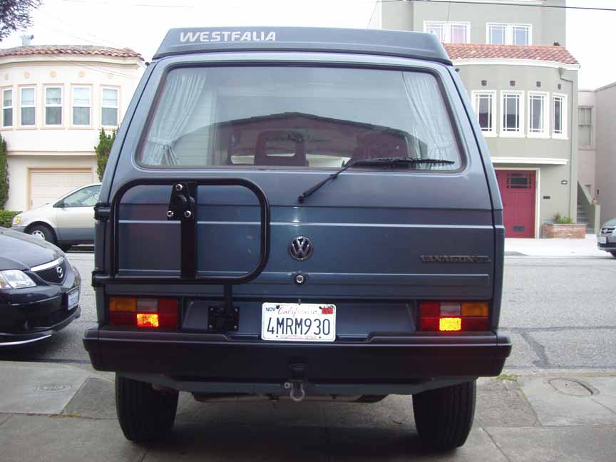

The swing away tire carrier:
Description:
The Burley swing away tire carrier was designed to carry any sized Vanagon spare tire/wheel. The wheel mounts so that the carrier spreads loads across its frame structure without stressing any one mounting. Load is shared between 2 24” mounting flanges. The backing plate flanges is full length and copies the exterior flange mount (the one with the brackets)
When the carrier is open, load is spread over the length of those two brackets. When the carrier is latched closed, some load is transferred to the striker plate and it's backing plate.
The flange mount comes pre-drill with 8 ¼” holes. The holes are perfectly matched to those on the backing plate. These 8 bolts effectively sandwich the Vanagon sheet metal between the two flange mounts and adds the structural support on which the carrier swings.
The tire/wheel sits on an adjustable tube mount designed for preload such that vibration and rattling is virtually eliminated.
All ETs should fit. But if you have any doubt contact Burley Motorsports direct.
Mine are 37.. and fit perfectlyt.

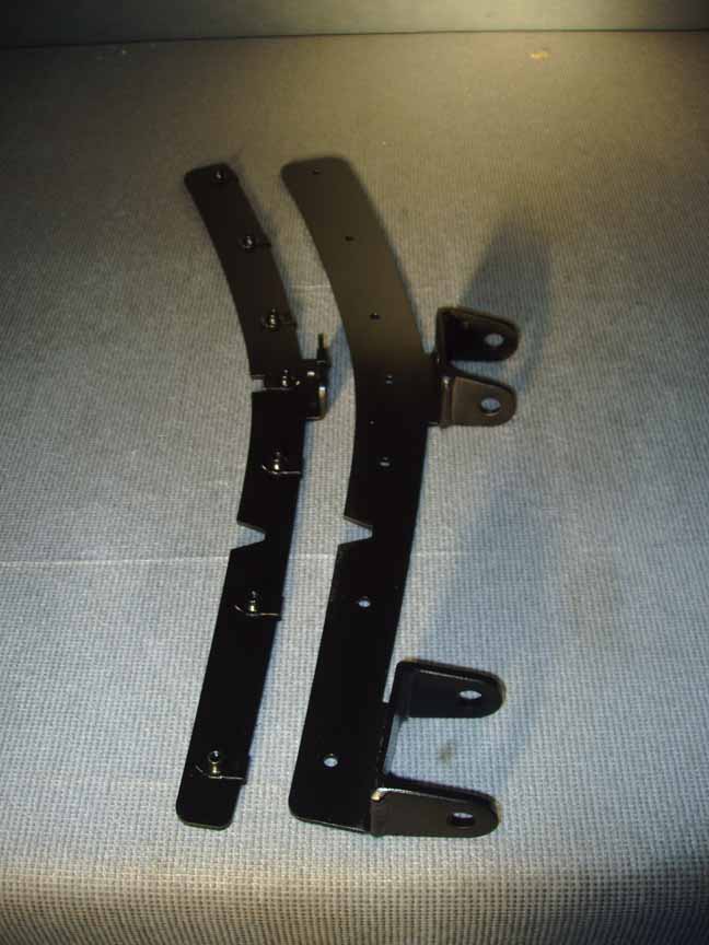

1. Swing-away tire carrier rack with polyurethane bushings and steel sleeve inserts
2. Wheel mount (adjustable) with three studs and lug nuts
3. Mounting flange with hinge brackets
4. Mounting flange backing plate

The primary mounting flange fits to the inside face of the rear hatch driver side pillar.
The matching backing plate mounts up from the inside of the body cavity of the sheet metal.
Access for the backing plate is from above, behind the plastic vent trim. Remove those two screws and the vent comes off easily. No plastic tabs to break.
The latch plate mounts to the tail-light sheet metal panel, just left of the license plate.
(pic?)
Inspected all mounting areas for dirt, grime, and rust.. Cleaned all mounting and backing plate areas. Lots of dust and crud built up in 22 yrs.
Treat for surface rust if necessary. I was lucky. No rust.
Touch up scratches to prevent rust later.

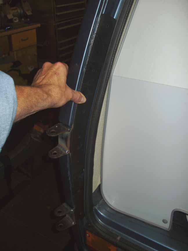

Mounting the flanges up.
The exterior flange:
Place the outside flange against the Vanagon body panel. The upper hinge bracket fits cleanly into the creases of the panel. You want this thing right down ON the sheetmetal.. formed to the shape of the body.. Press in firmly so you get the holes right on.
I used blue masking tap applied over the sheet metal to reduce risk of scratches or worse and a little foam tape on the backside to keep things from sliding around
Now is a good time to pull back the hatch weather stripping along the driver’s side to protect it from damage, too
Mark your holes.
I used a center punch to mark my holes.. and taped the flange in place to free up my hands. A Sharpie would also work.. but you want to get those marks centered and you don’t want the flange moving and screwing up alignment.
I drilled the top hole and placed a bolt thru it.. then checked all the marks to make sure they were still centered. Check! They were.
I took a deep breath and drilled all 8 ¼” holes.. VERY cautiously I might add.. as I am not at all used to drilling holes in my Westy..

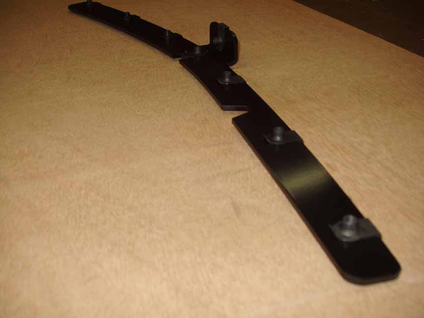

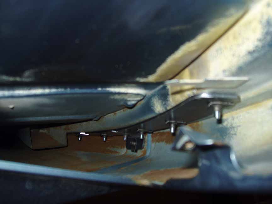

The backing flange:
The backing flange is full length and access is tight down inside that body cavity. Burley provides these nifty sprung slip-on backing nuts for use on the backing flange. Attach the backing nuts as shown. There are 8 in all.
(I sprayed some black rustoleum over this flange which helped hold those clips in place)
Now I was ready to place the flanges and bolt them up.
This job can be done solo.. but it certainly does not hurt to have an extra set of hands for this part.
I started the top bolt and got a couple turns on it.
I checked that the backing plate was still properly positioned down inside the body cavity.. My camera verified that..
(see pic above showing the body cavity)

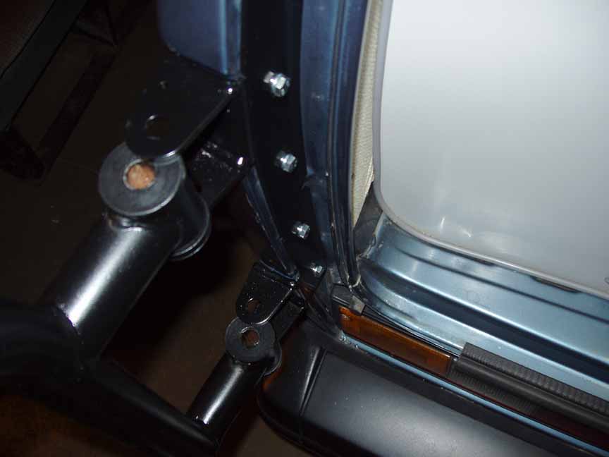

Here’s the big moment when it starts to come together.
Move the carrier into position by sliding the bushings into the hinge brackets.
Slide the two large bolts and spin on the nylocks
Don’t forget the “lock-open” pin.
I store it in place for use when carrier is swung open.

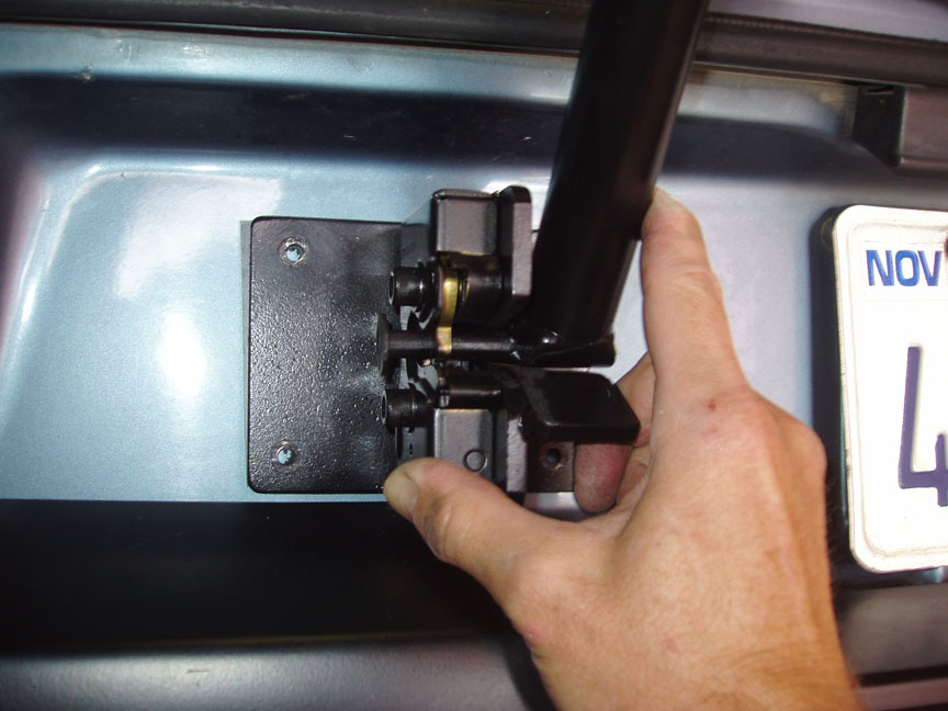

Installing the catch mechanism.
Important! At this step, the carrier should not have the tire and wheel in place.
You want the carrier empty and unloaded when placing the latch meachnism for marking holes.
And of course the hatch should be closed.
The catch mechanism assembly uses a backing plate much like the flanges. This helps spread loads more evenly through the tail-light body panel and provides a more solid structure.
As noted…
Swing the carrier in towards the Vanagon hatch (Take care not to swing it too far and damage your paint job!.. I wrapped a towel around the tubing.. just for good measure.)
Close the latch mechanisim over the carrier pin. Make sure it is in ALL the way in (2 clicks) and that the strut clears the nut/bolts of the latch.
Move the catch mechanism assembly against the tail light body panel. The bottom of the plate should sit approximately 3/8” above the lower crease in the. This leaves about 1/8” between the latch mechanism and the f/g bumper. And with steel bumpers there will be more room.
Mark and drill the 4 ¼” holes.
You’ll need to get to the backside to place the backing plate.. HA HA!.. I tried to slip it in behind the 2.1 Pressure Coolant reservoir.. Don’t waste your time.. unbolt the damn thing from its mount and just move it aside. Much less of a hassle. And that allows you to clean the sheet metal up.
Slide the backing plate into position and bolt it all up
Yer done!
Pretty nice unit… Dontcha think?

I wonder if he'll make one just a little bit longer, allowing for a jerrycan.
Burley has a passnger side swing out coming soon.. That one can be used for jerry cans, jacks etc.
If building your own, I'd be careful about loading up more weight on a longer lever. That attachment point is strong on Burley's.. but it will work over time with more weight out and away.
Moving a heavy jeery can inboard is a lot of force.. offroad/roughroad its gonna beat the carrier, the mounts, and the Vanagn body pretty good.
Keep weights over/as close to attachment points as possible.
Also.. if you want to see this in person, you're more than welcome to swing by (PUN!).. I'll be back in town on Sunday.

PostPosted: Sun May 22, 2011 8:03 am    Post subject: Reply with quote
You are welcome, VP.
So I am back from a quick trip to LA from San Francisco. 1000 miles, 3 days.
Tire carrier.. Solid. No rattles. No vibration.
70-75mph on HWY 5 most of the way. Big wind over Pacheco Pass (152 near Hollister) and over the Grapevine into Santa Clarita (lane changing wind gusts)... not to mention, plenty of truck lane driving.. Shook everything loose.. Felt like my fillings were gonna come out.
Damn! that lane is torn up on the Grapevine.
Bolts still tight. Never saw the tire move in the rear view.
And a funny little story.. come to the grinding traffic near LAX and a Hummer pulls alongside.. windows down.. driver gives me a "cool guy" nod (probably thinks I'm a syncro).. Anyway, he inches forward.. And I notice his tire carrier.. that factory jobber.. with tire/wheel bouncing around, hardware rattling. That Hummer rack is no lightweight junk.. (well maybe its junk) but I was feeling pretty smug about then.
$700? Thats fine by me, when the design works, the welds are beautiful, and it holds up to real use..
Pretty stoked on the thing. Now I am looking at ideas for security. Wondering if its necessary, even.
Reason I ask is that we had a catalytic converter stolen off a Toyota T100 4WD recently (my brother's).. Seems people will steal anything these days?
Anybody had a spare stolen?
Franklinstower, et al.. I have no added lean from driver's side mount. But I use Sensatrac load levelers in the rear.
Its easier to access the tailgate when parked on the street, since the rack swings away towards the street. But if people are really motivated towards a passenger side swing away.. Maybe email Burley and inquire. I know he has the matching flanges in the works for a passenger side carrier. If you get the comments into him early.. Maybe he can design the passenger side swing away to mount a tire if so desired?

Just a quick question j dirge-
Instead of bolting the wheel mount bracket to the frame, would there be a problem with spot welding in place ????
Thxs
Thxs
You mean the wheel mount female tube into the carrier male tube?
I don't see any problem with spot welds, except that you would have to cut the spot welds if you ever changed ET/wheels?.. But then again.. you'd have to drill new holes for new ET/wheels, too.. (6 of one.. half dozen the other)
I dunno.. I can't think of any reason not to.
I'd recommend you email Burley on that question... I had an "idea" that he nixed for good reason.
Much of what he has done on this carrier (and the hitch I have as well) were done for a specific reason.
In this case, the drill/bolt method is for ease of install for DIYers. (my assumption)

Talking to Burley this last week... and I am looking to jumpstart the build for the passenger side rack.
Originally to be an accessory rack, some comments here will be folded in to the design. I.E. we discussed a tire mount for those who want to mount on the passenger side rather than.. or in addition to the driver side.
Burley says,
I like all of those ideas, lets go for it. I too thought the right side should have the high lift mount , and the 1-2 can tray , that tray can also be a tool box holder for the guys that want to push there van with a wrench in there hand after they run out of gas , ha ha , and as you said offer a tire mount for those who are brave enough to cross the border these days. as I was saying in my last email , I lowered the price to $650 on the website tonight. We will be offering nice discounts for Samba members at the $595 and $995 prices
If interested in this production run please email Burley, directly.. The $595 price is for the current tire carrier driver side. and the $995 price will be for both swing-away racks. For you guys only!
I am not an agent of the man.. just wanting to spread some Vanny luv...
Please post thoughts and ideas on your "ideal" accessory swing away.
Design is in progress.
cheers,
the dirge

the way this swing holds open is similar to my gary lee in that it goes past 90 degrees. I suggest putting the stop at 90 degrees so that it can be left open and still swing the hatch open, without blocking someone parked on your driver side.
fwiw, the wisdom of putting the swing on the driver side is supposed to be the ease of access to the rear hatch from the sliding door side, without having to walk around the tire.
However, I agree it makes more sense to put the tire on the passenger side, especially with a westy, and especially with big heavy tires, to balance the weight.
an idea for an accessory rack, a tray that holds a coleman stove in cooking position so you can bbq on the swing.
