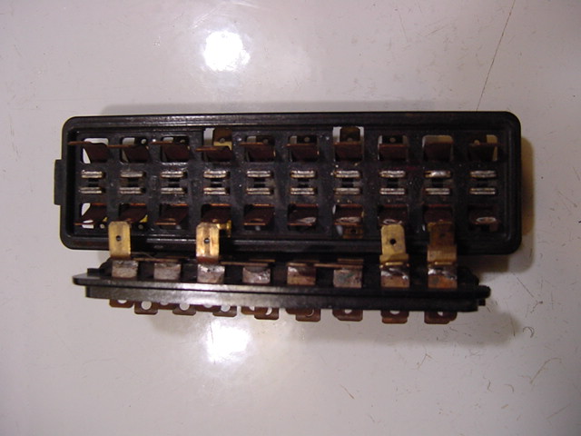

Any pics of an early screw terminal fuse box that has had the solder treatment?
Eric&Barb
Joined: September 19, 2004
Posts: 25875
Eric&Barb is offline
PostPosted: Thu Dec 29, 2011 8:16 pm    Post subject: Reply with quote
Finally got around to pulling out an early fuse box that a DPO had soldered up.

I'm working through some electrical gremlins this weekend and trying to follow the advice about soldering old connections, but pulled my fuse block and am confused about what to solder? There are no rivets and the connections all look direct - am I missing something?
1965 EZ Camper
flyboy161
Joined: December 26, 2009
Posts: 2135
Location: Perry, GA
flyboy161 is offline
PostPosted: Sun Sep 11, 2016 11:27 am    Post subject: Re: Soldering brass clips in fuse box? Reply with quote
Flip it over and look at the fuse side. In this picture you can see where they soldered the two brass ends together...looks like a series of silver dashes across the middle

The above image show the TWO WAYS one can solder up the 1961-67 fuse box.
Make sure to clean the fuse box up with tooth brush, soap and soak in vinegar for a couple of hours to get rid of corrosion. Use a hot enough soldering iron to quickly melt the solder or risk melting the plastic.
