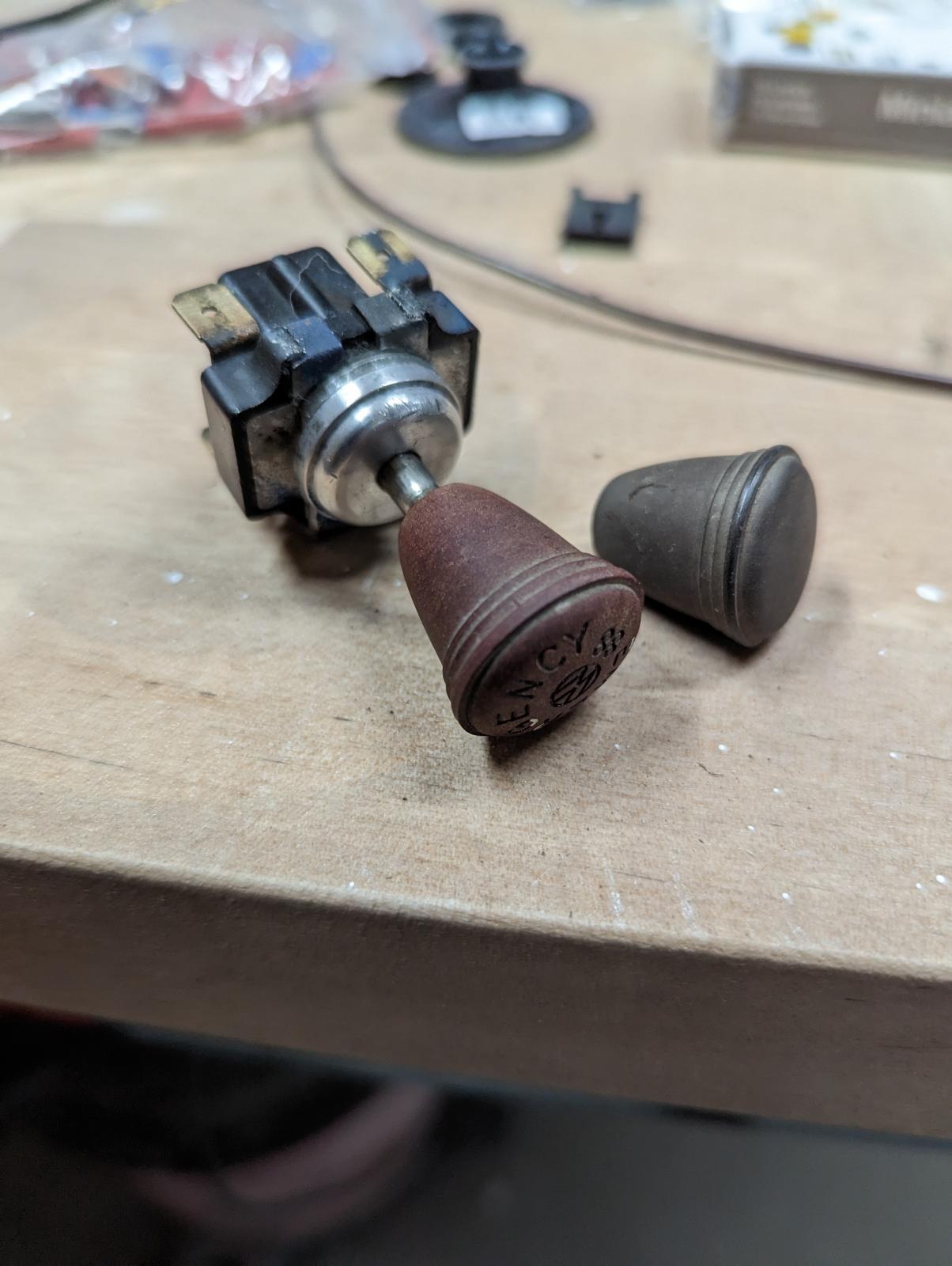

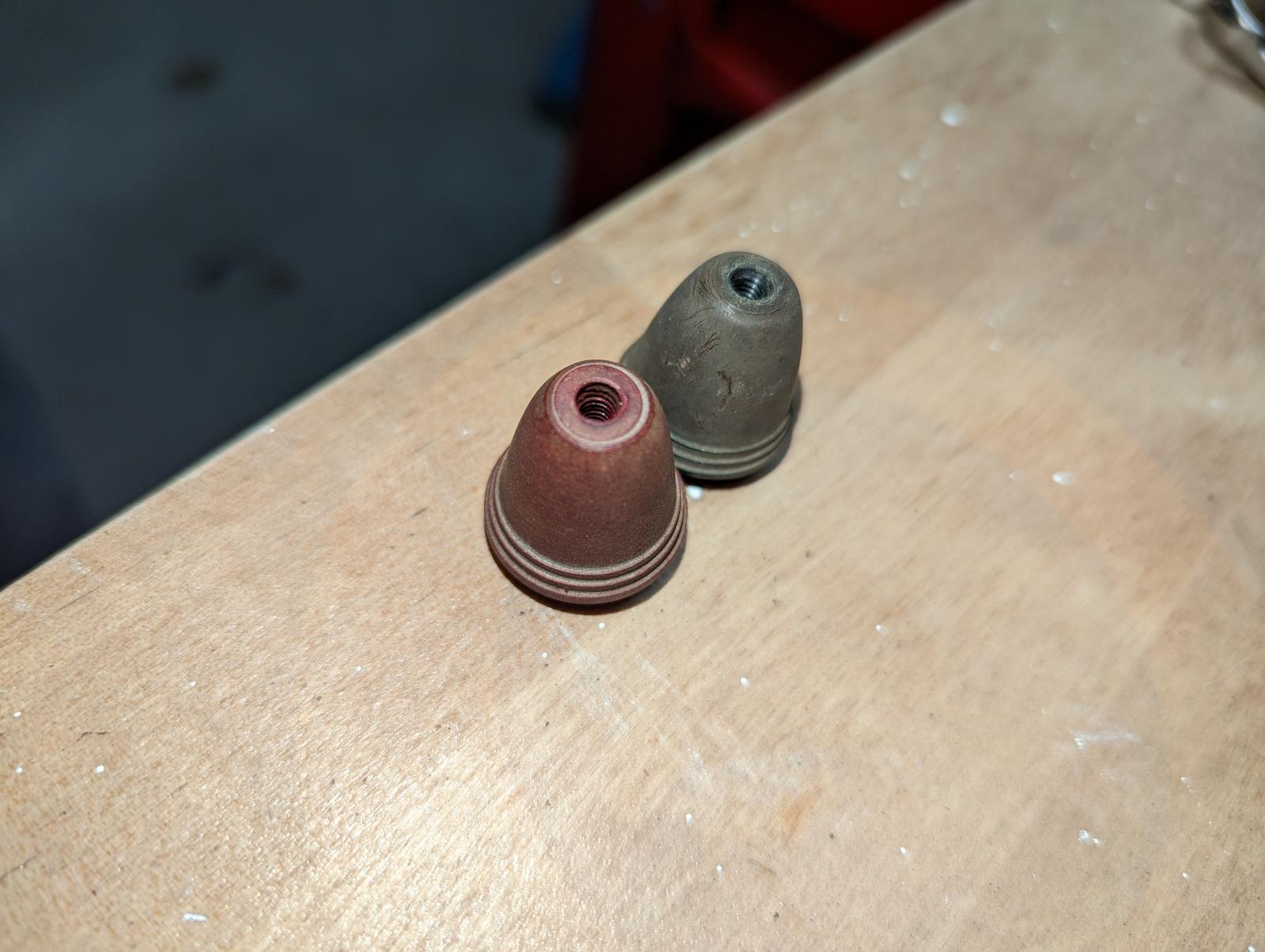

I was doing some research on this to see what is correct for a '63 deluxe and found this thread. My Oct '62 panel van came to me with a red emergency flasher knob and I also have an Oct '61 bus which also has the same emergency flasher switch with a red knob. Do both buses have the wrong switch/knob or is possible the solid red knobs appeared earlier?
Here's some pics of the red knob switch compared to a black knob.

I believe someone installed a later knob in those Buses.
You say your 10/61 Bus has a switch?
I believe someone added the whole emergency light system to that Bus as it wasn't standard yet AFAIK.
Since you say '63 Deluxe:
My mostly original '63 Deluxe has a white knob to match the other dash knobs.
I am 100% sure this is correct.
There was an optional earlier version that was a dealer installed item, much like the early bus accessory windshield washer kit. Years ago found the VW accessory part numbered box for one with instructions in German. Unfortunately the kit was used and only the NOS wiring of the kit remained. I kept it out in hopes of sometime having the instructions translated, but Barb did not like having it out on display. So she put it somewhere safe and have not seen it in the last two or so decades.... Crying or Very sad

edgood1
Joined: September 30, 2004
Posts: 2116
Location: Plymouth, MA
edgood1 is offline
PostPosted: Mon May 22, 2023 8:52 am    Post subject: Re: Early Emergency Hazard Switch & Knob Reply with quote
Thanks Everett,
The two buses look to have the exact same setup. Same two relays and clips in the same spots, same wiring, same switches and knobs. That's not to say one or both had them added after the fact.

PostPosted: Mon May 22, 2023 9:57 am    Post subject: Re: Early Emergency Hazard Switch & Knob Reply with quote
This would make perfect sense. Thanks!
