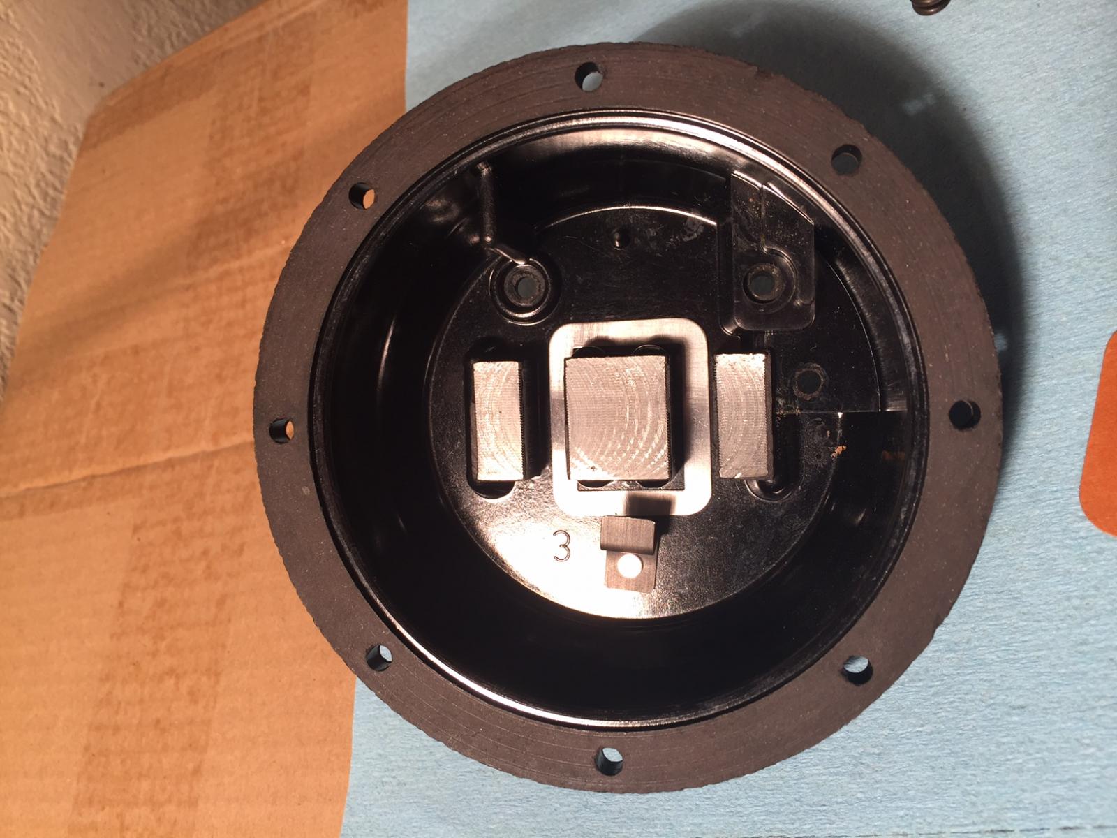

Reassembly
Housing and metal washer
Followed by paper washer

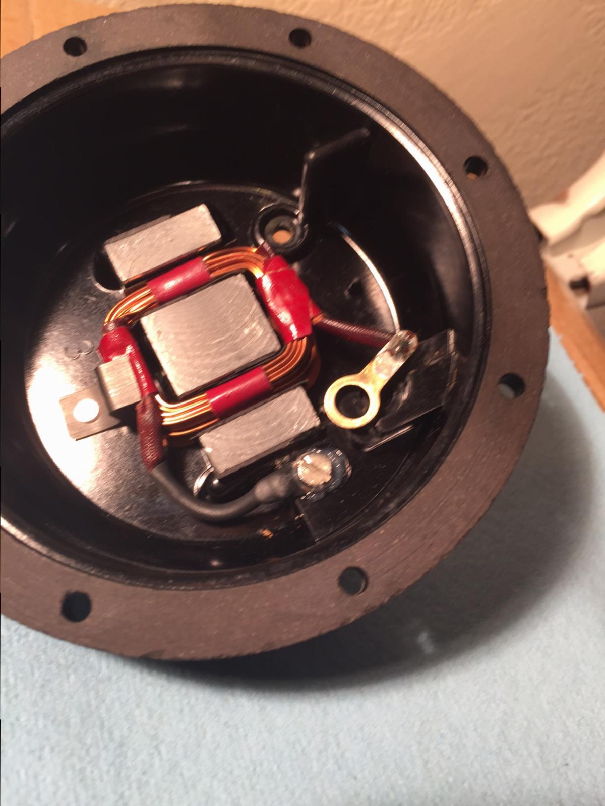

Coil goes in
The securing bracket shown in the left of this picture is tight. I found a small screw driver and some patience allowed me to bend it (it is spring steel) to put the coil in. Make sure to use the insulating paper under the bracket as seen in the pictures below.

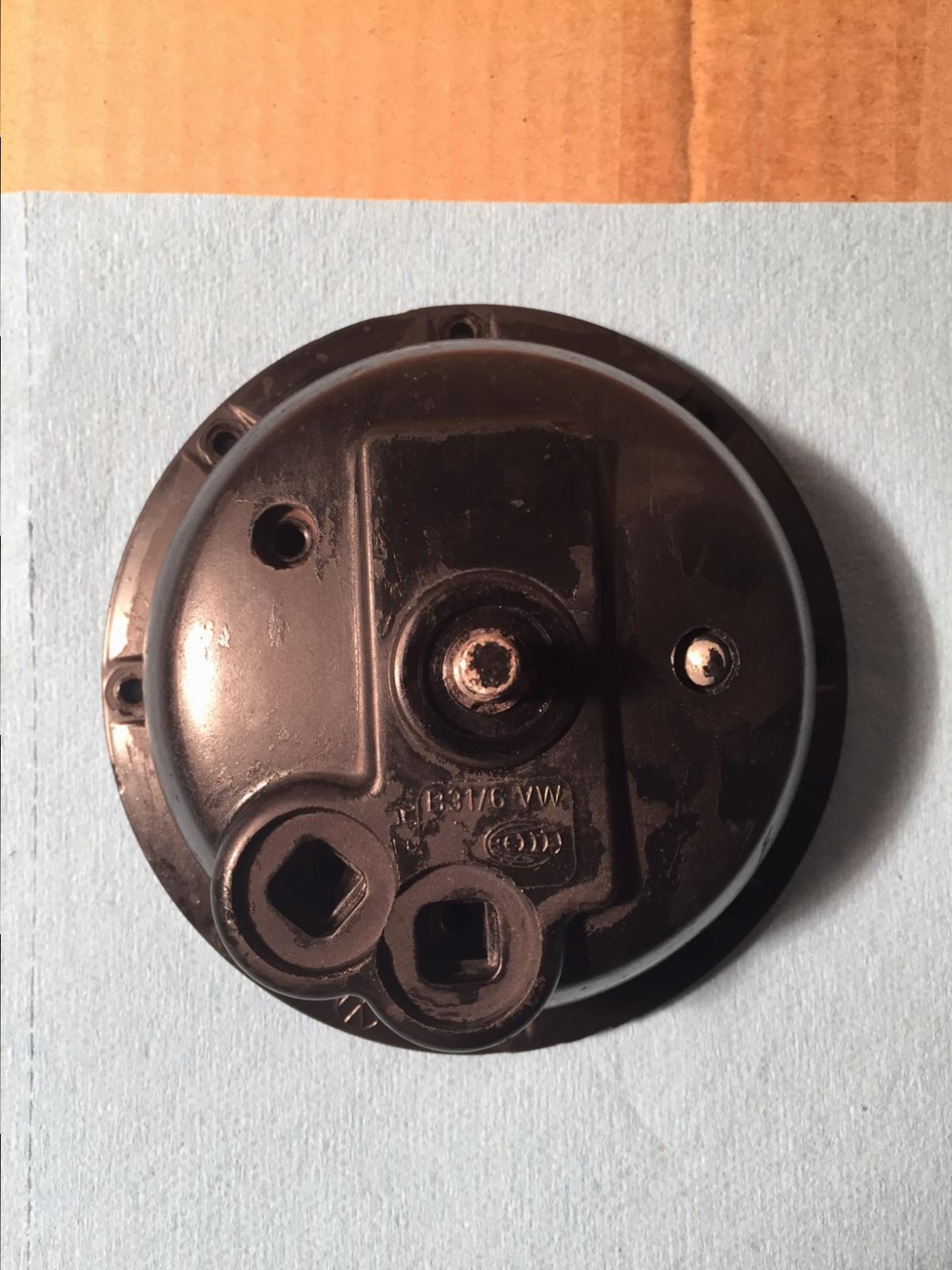

Here is the back of the housing. Notice the texture differences showing the bakelite vs painted material.
Next up is the terminal posts. They are designed to go in only one way. This allows the hole for the positive and negative wires to be on the outside of the horn when installed.
Notice the offset hole.
Another offset hole. These need to match up. There is also a very small piece of paper that acts as an insulator which also goes down into the hole. If it is missing or unusable it is no big deal.
The rubber was a bit stiff so I used a light coating of silicone caulking to try and help waterproof the horn.
This is the screw and washer which connects to what I am calling the negative side of the horn. There is no positive or negative side it can be hooked up either way.
Installed on the bottom of the image. The black heatshrink was to replace some of the rotten paper style insulator which had corroded on mine. I also used some dielectric grease to help prevent corrosion.
