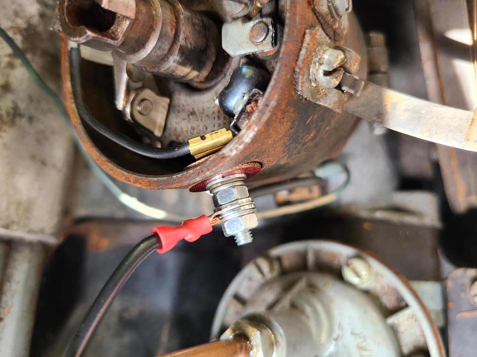

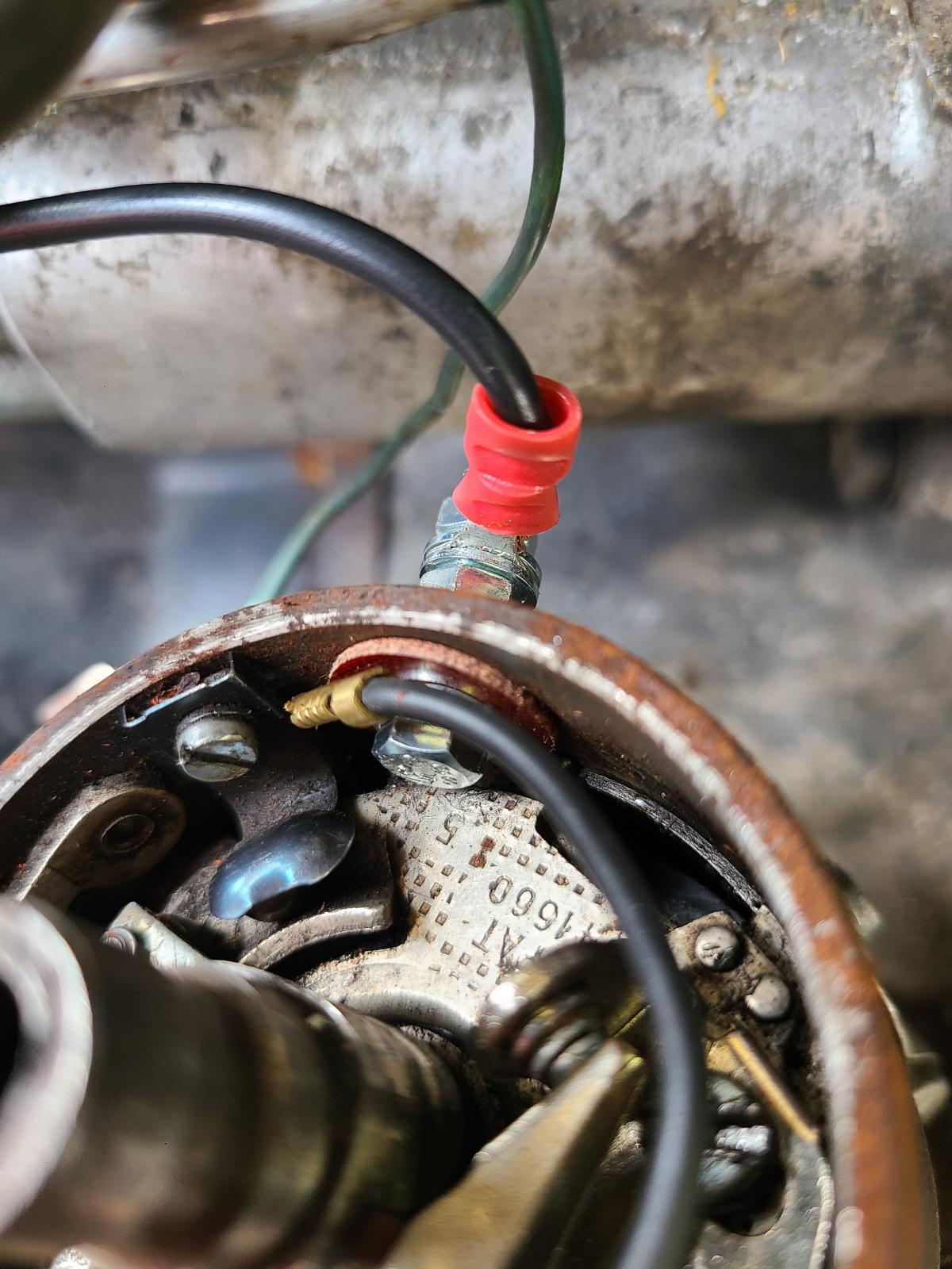

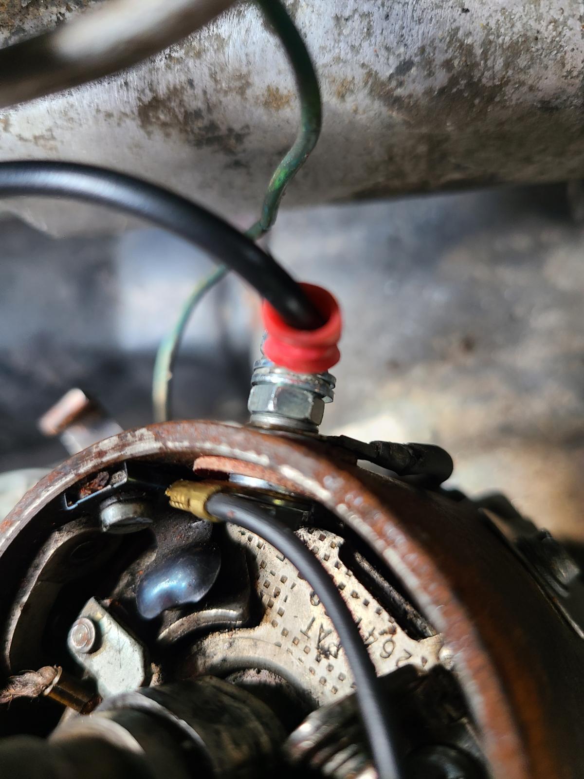

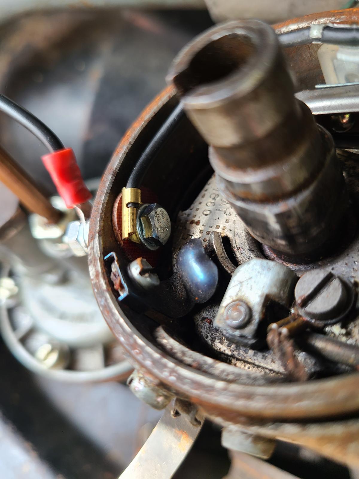

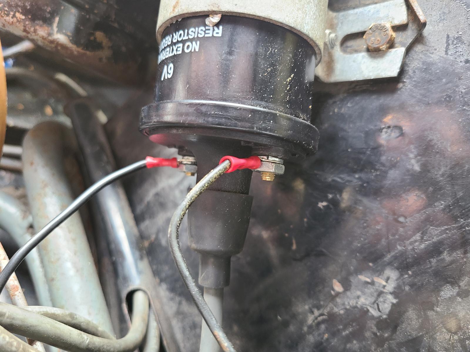

PostPosted: Tue Mar 21, 2023 3:03 pm    Post subject: Re: My single owner 1959 Ghia Reply with quote
Hey guys. Day one of being back in WA and I've started to work on the Ghia again to no avail.
Glenn Ring sent me new hardware for the points and condenser to attach to.
Turns out I was missing one of the fiber washers but that didn't fix the issue.
I checked all the body grounds, they're all corrosion free and secure, the points are new, the condenser is new, cap, rotor and plugs are all new.
The coil has 6v going to it when the ignition switch is in "run" and it has the correct resistance.
I believe I have the hardware stack up correct for the points and condenser but I haven't seen a good view of the entire set up either.
If I have the ignition switch set to "run" and have the distributor cap off, I can rotate the pulley by hand and cannot see the points sparking, however, if I touch the points with a screw driver, they will arc to the screw driver.
I am getting fuel and the compression is fine too. The problem lies somewhere within the distributor but I don't know where exactly or what the next step is to get spark down to the plugs. Hopefully it's easy and you guys will be surprised I missed something so simple, but until there, the ghia unfortunately lies in silence.
PNW Dub Folk & Kitsap dub Folk (KdF)
Austin Aircoolers VW Gang
2020 Ford F-150
1973 Standard Beetle
1969 Cessna 172K Airplane
US Army CH-47 Chinook Helicopter Repairer November 2013 - July 2024

PostPosted: Tue Mar 21, 2023 6:43 pm    Post subject: Re: My single owner 1959 Ghia Reply with quote
I don't see a condenser in your ignition system. Where is it? If you don't have one that can be your problem. Also some of the cheap parts we get these days can be bad out of the box.
1970 Pastel White Westfalia
1971 Super Beetle Convertible (sold) http://www.thesamba.com/vw/forum/viewtopic.php?t=582365&highlight=
1970 Squareback "Savanna" (sold)
https://www.thesamba.com/vw/forum/viewtopic.php?t=714683
1974 Karmann Ghia- current project, 1967cc engine. https://www.thesamba.com/vw/forum/viewtopic.php?t=775207

PostPosted: Tue Mar 21, 2023 7:45 pm    Post subject: Re: My single owner 1959 Ghia Reply with quote
It's attached on the underside of the distributor, it's brand new and I tried both the old and the new. Everything was bought from Wolfsburg West

PostPosted: Thu Mar 23, 2023 8:33 am    Post subject: Re: My single owner 1959 Ghia Reply with quote
After a bit of consultation with Glenn, I was able to get the Ghia running again! Unfortunately I need a new generator and a new accelerator cable, but it is very close to being a driving car again!

PostPosted: Sun Mar 26, 2023 6:27 pm    Post subject: Re: My single owner 1959 Ghia Reply with quote
Big update!
Took some trial and error but after gently emery-cloth-ing the points, she fired up!

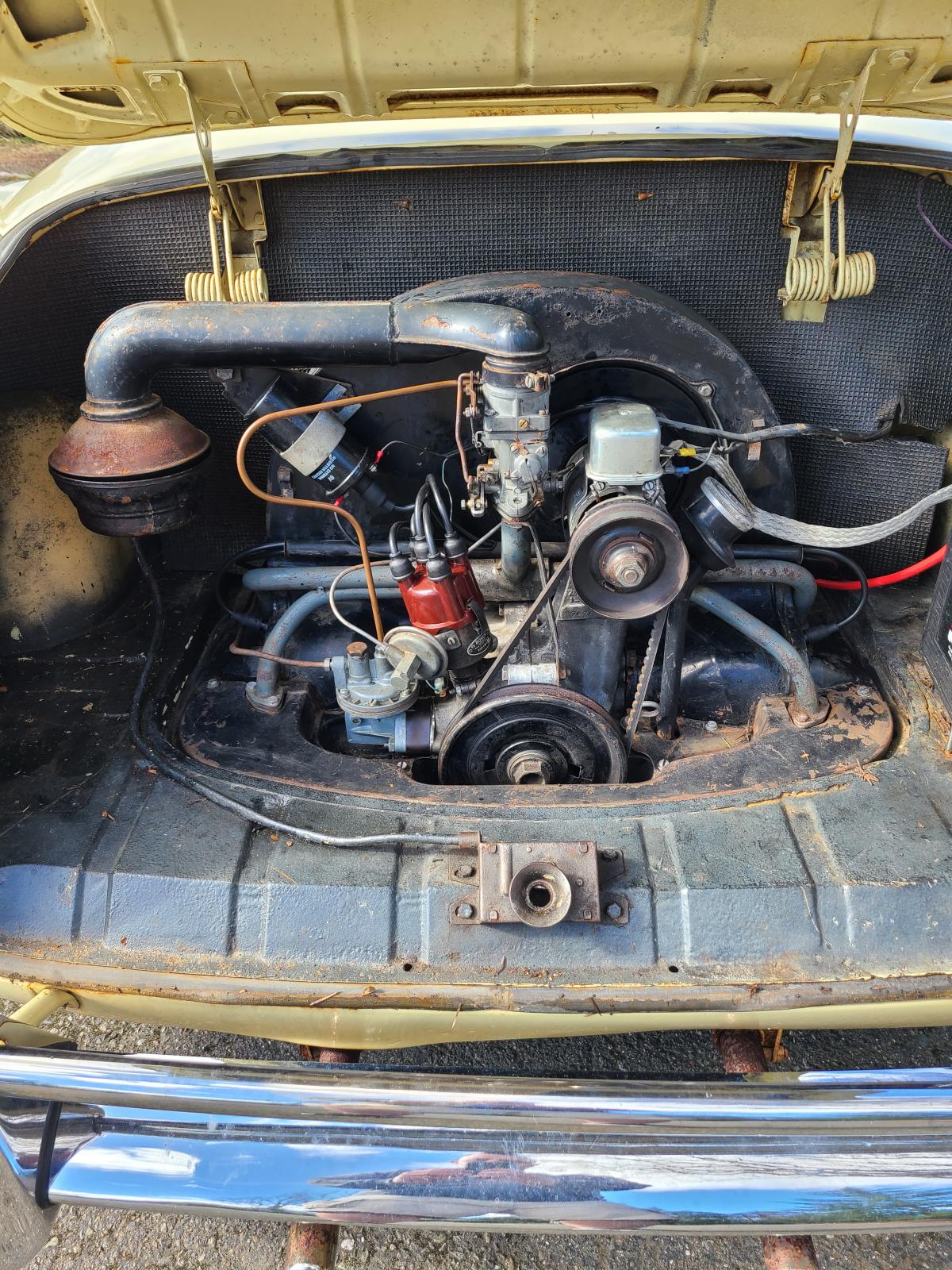

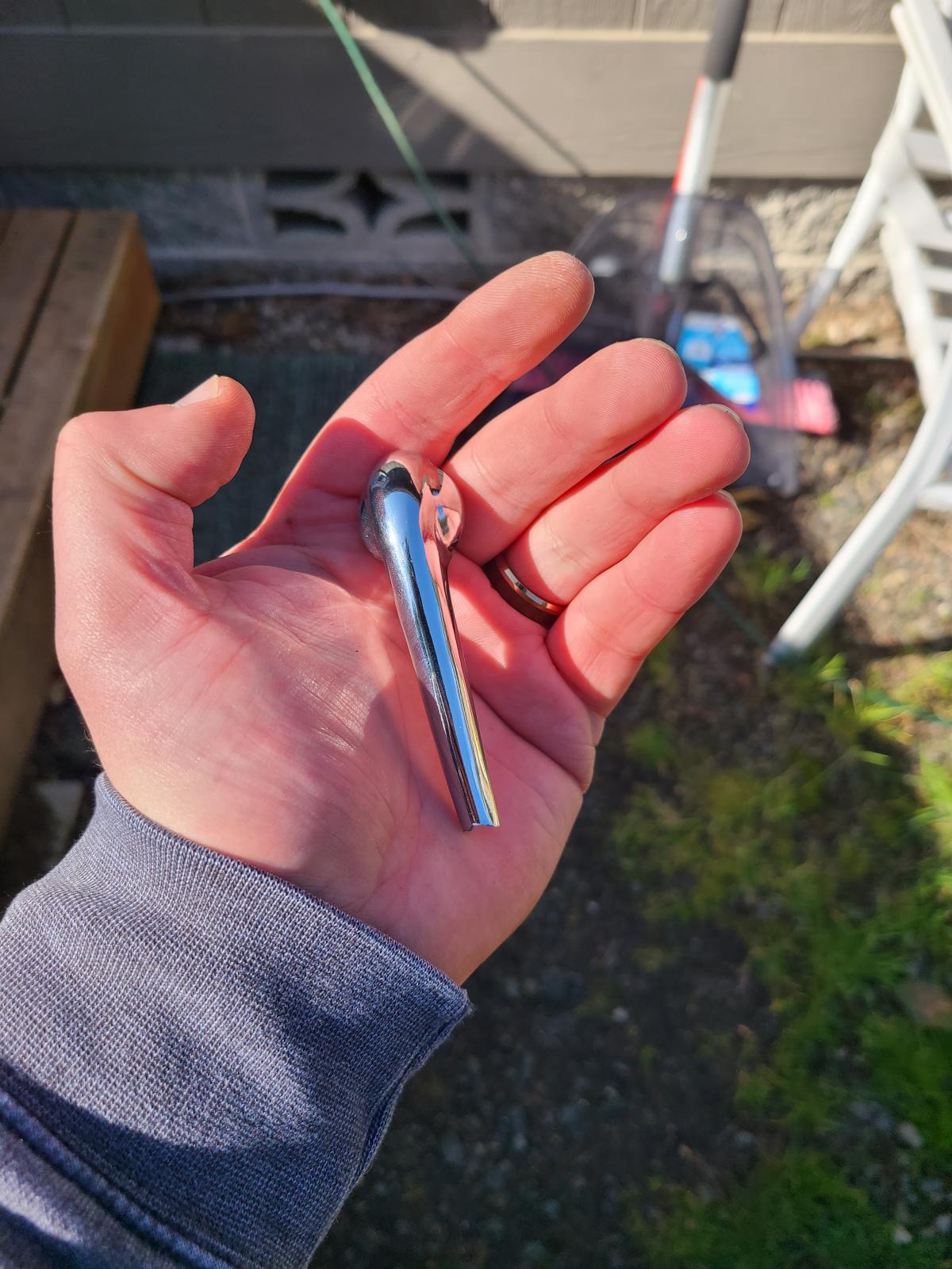

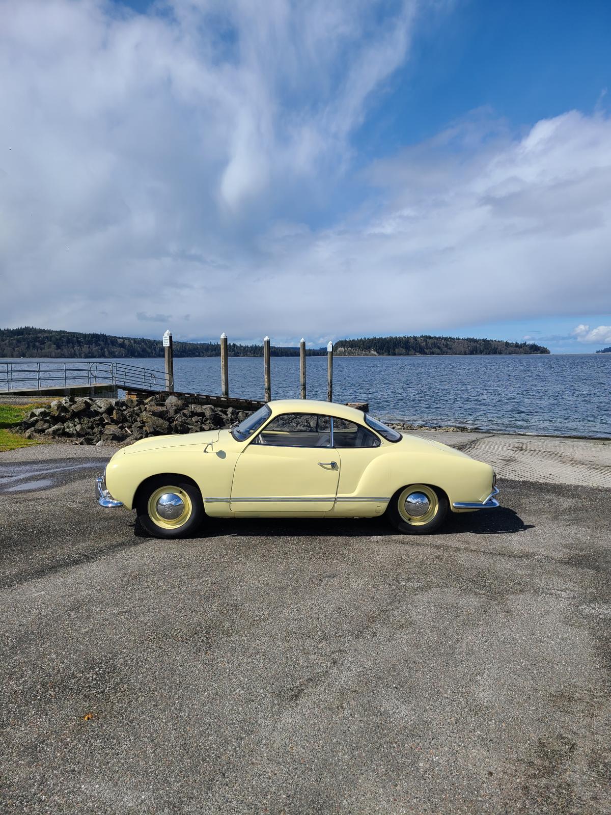

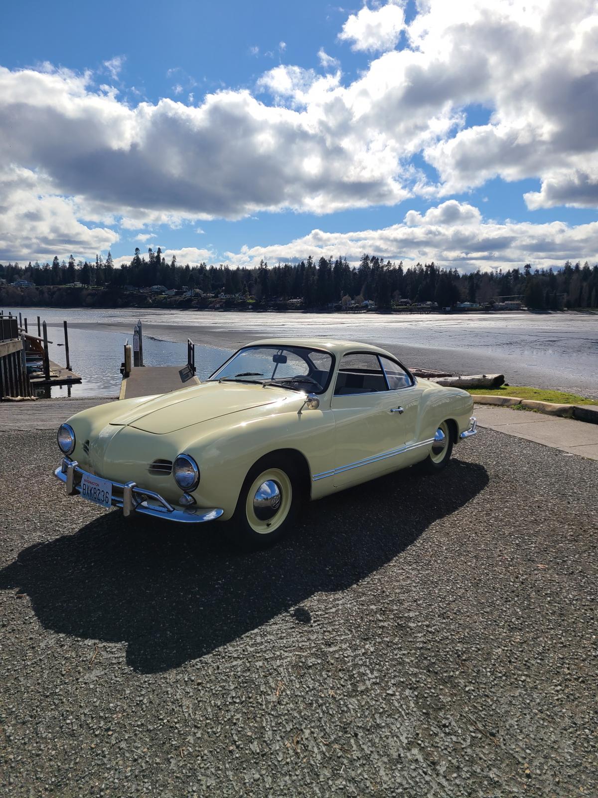

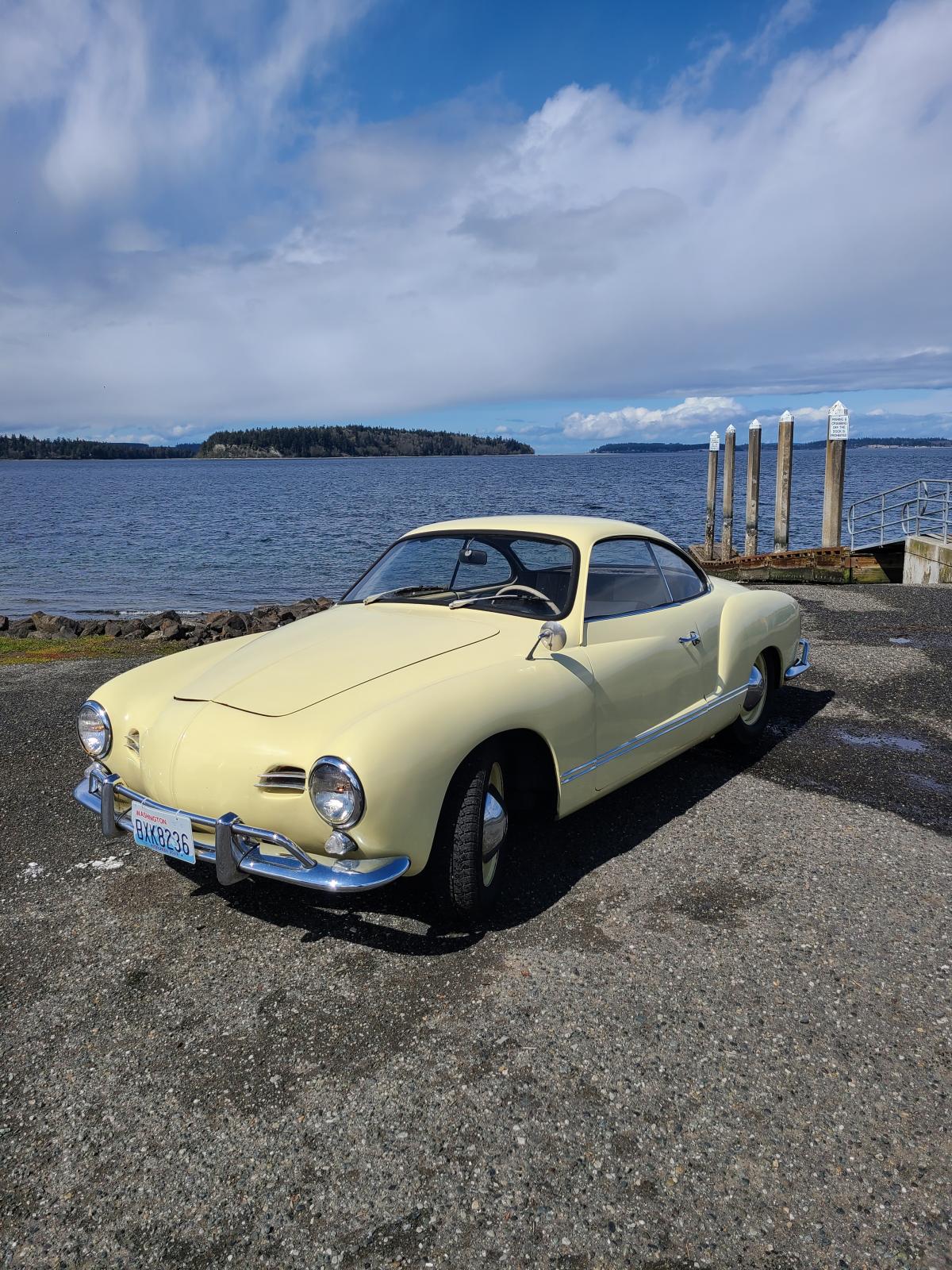

Hey guys,
Just wanted to share some more photos of the running around I did in the Ghia today. Weather was perfect and the car is running like it never sat for over a year. I'm impressed with how much a 36er is a joy to cruise around in.

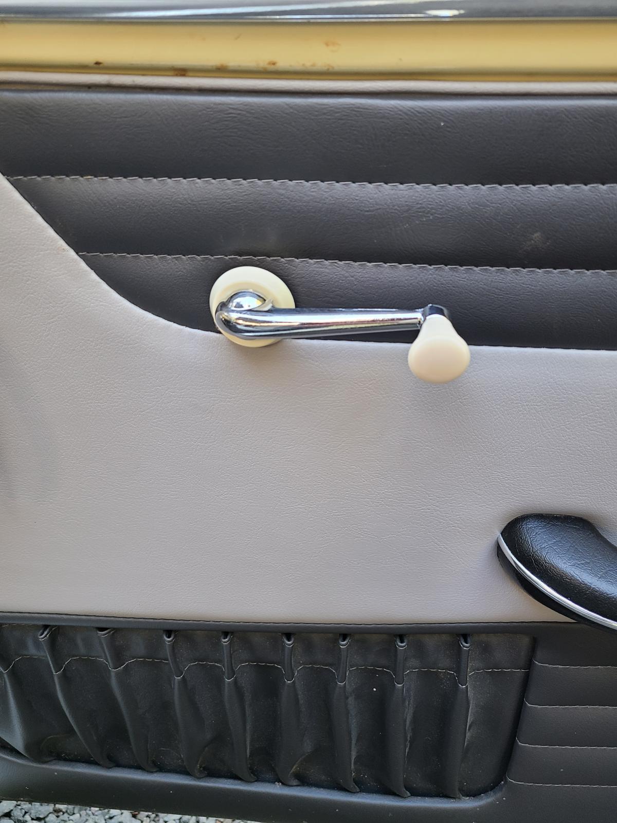

I also replaced the window cranks today. When I first got the car, a buddy of mine ran into the drivers side and broke it and then a family member broke the other some time when I was off in Europe.
I'm coordinating a day this week (time is quickly running out before I have to return to Texas) to get the nose badge finally put in by VolksFab, a locally owned VW body shop and arguably the best craftsmanship I've ever seen.
Then if all works as planned, there also may be an old Porsche radio that fits the empty slot on the dash that I'll be buying from my former boss and local VW shop owner. Fingers crossed that these things all come to fruition before my time here is up and the updates become less regular again. For the meantime, enjoy!

Hey all,
Bit of a hiccup right here at the tail end of my stay. On the 12th, I took the ghia on a decent drive and it performed beautifully. The following morning, I was meeting up with a friend and I got the indication it was no longer charging. I ran some troubleshooting- the generator is a rebuilt Bosch unit and it was putting put ~7v when the engine was revved and there was no issue.
I have lost all charging, the voltage regulator that I bought with the generator is new too, I swapped back and forth between it and my Bosch regulator and had no difference. I went from 6.94v to the battery to 6.05v and I even lost the generator light in the speedometer. I can get it to come and go but I'm still not charging.
Generator is a rebuild Bosch unit, the regulator is new, non solid state, the car struggles to crank over but it runs like a Swiss watch once it's on. I have no idea what would have caused the sudden issue and with time running short, I don't have much time, if any to fix it.
Things I've tried- swapping the voltage regulator (x4 now between 2 units) re-polorizing the generator- it spins just fine. Replacing fuses, checking connections, but I am at a total loss.

PostPosted: Sat Apr 15, 2023 5:51 am    Post subject: Re: My single owner 1959 Ghia Reply with quote
PatterBon wrote:
I even lost the generator light in the speedometer. I can get it to come and go but I'm still not charging. but I am at a total loss.
I'd focus on the idiot light circuit.

PostPosted: Sat Apr 15, 2023 9:19 am    Post subject: Re: My single owner 1959 Ghia Reply with quote
kingkarmann wrote:
It'll come and go, unfortunately the people who restored the car weren't kind to the wires and have them going into a centralized bus bar. I'll take one final good look at it tomorrow and see if there's anything else left to do. I also do still need to check the output of the generator itself just to rule out that it's not the issue.
