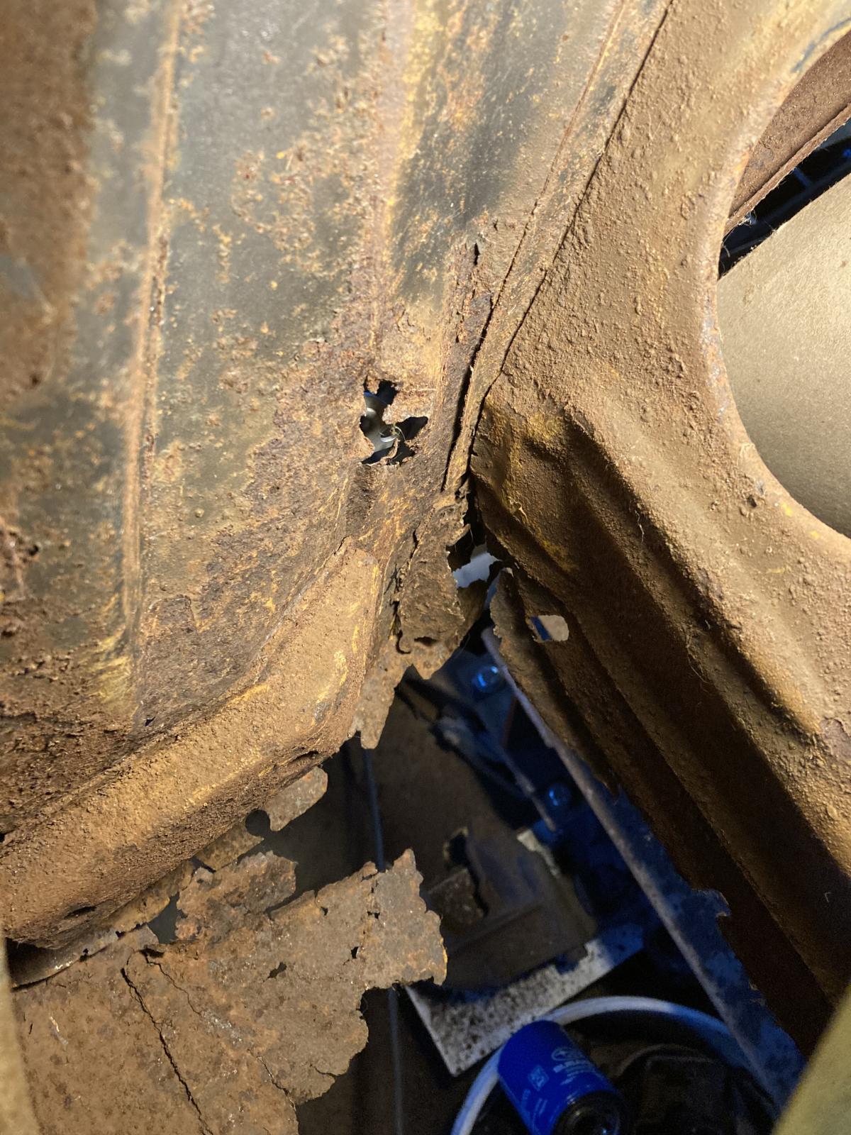

As promised, pic of the setup for stretching out the accident damage up front.
chunk of plywood spread the load.
after pushing bumper mount forward off spare tire backing panel, also pushed backing panel forward from firewall. obviously still some damage here, but no access to swing hammers until the rot is trimmed away in the lower quarters.

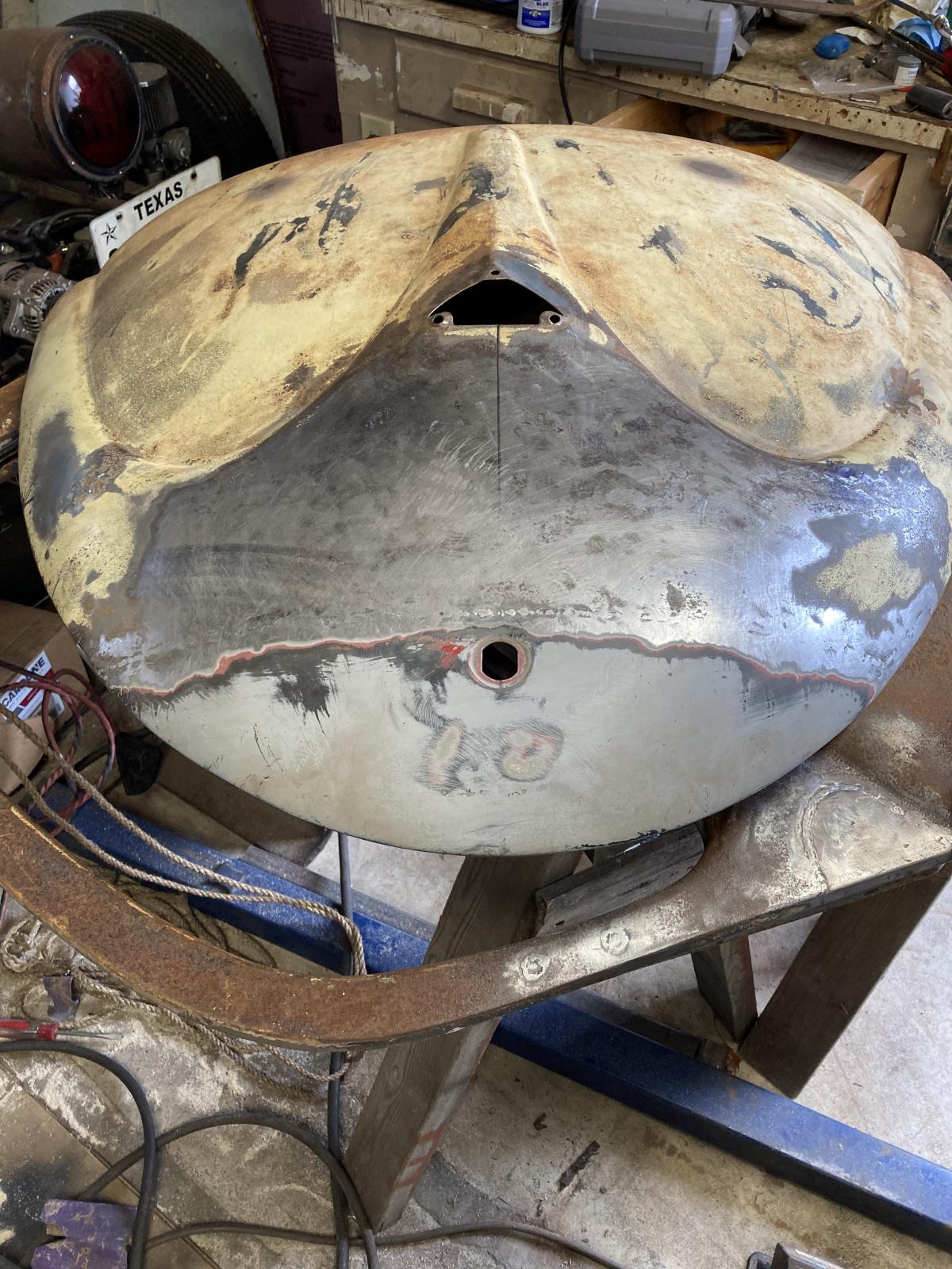

In more exciting news, my rear fenders finally made it to the workshop. Spent a little time today doing some preliminary panel beating. Overall pretty pleased with the purchase. Definitely lots more work ahead.
Drivers side fender needs forward 6” patched since someone trimmed that in the past. Also needs converted to early style tail light. Passenger side has more dents, tears, holes, and rust but has factory heart tail light mounts so that’ll be incredibly helpful.
