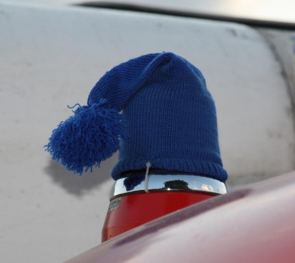

mdege wrote:
... and the beacon light would have to be covered while I drive in traffic.
This reminds me of a nice cover for the beacon light, seen on a Mercedes L319 fire truck.
