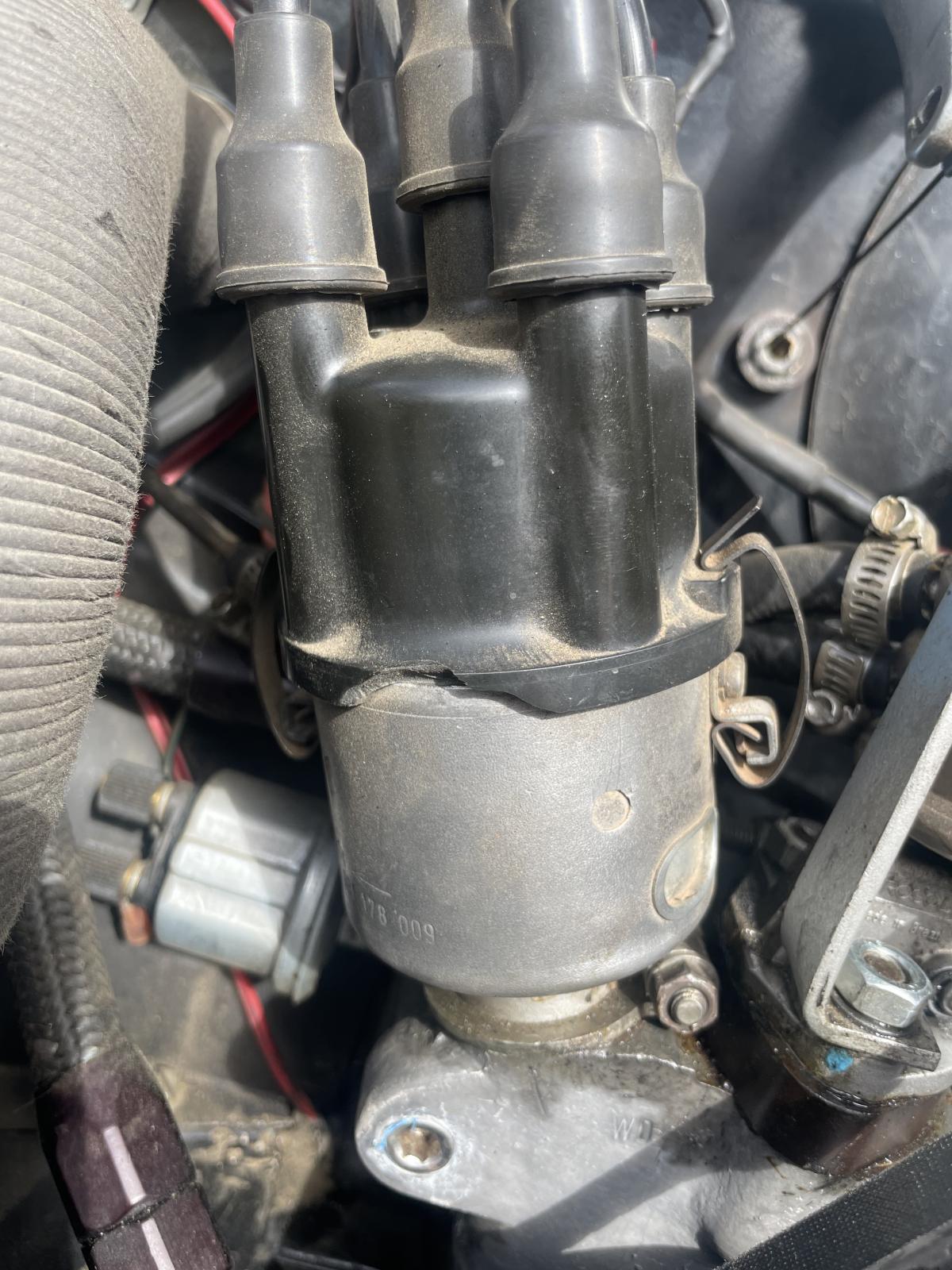

New Bosch distributor cap and rotor, old one had a chunk missing. It started right up, I’ll be driving it tomorrow.

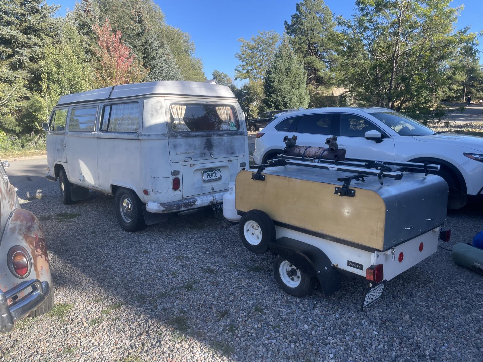

My son, dawg and I are heading to the ABC Jamboree in Flagstaff on Wednesday in our bus. So I won’t get the car back together for a couple of weekends. Stoked on the event and I’ve been getting stuff ready for a few days now.
Apart
Got the trailer packed and hooked up.
__________
’71 Westy build
Adventure thread
’65 Deluxe Build
’71 Double Cab

PostPosted: Sun Sep 15, 2024 6:46 am    Post subject: Re: Scored a local ‘65 Deluxe, The Monster Reply with quote
no bikes this trip ? Im not bringing one either
richparker
Joined: November 24, 2011
Posts: 7818
Location: Durango, CO
richparker is offline
PostPosted: Sun Sep 15, 2024 10:25 am    Post subject: Re: Scored a local '65 Deluxe, The Monster Reply with quote
I'm bringing them. They are calling for rain tomorrow, I'll load them up after.
__________
’71 Westy build
Adventure thread
’65 Deluxe Build
’71 Double Cab
mtnbus
Joined: July 01, 2007
Posts: 825
Location: Colorado
mtnbus is offline
PostPosted: Sun Sep 15, 2024 3:03 pm    Post subject: Re: Scored a local ‘65 Deluxe, The Monster Reply with quote
nice
the trailer looks tight! a before and after shot would be cool for everyone to see how much you did to that
richparker
Posts: 7818
PostPosted: Sun Sep 15, 2024 9:01 pm    Post subject: Re: Scored a local ‘65 Deluxe, The Monster Reply with quote
mtnbus wrote:
nice
I have it documented here and in my bus build thread.
https://www.thesamba.com/vw/forum/viewtopic.php?p=10060076&highlight=#10060076

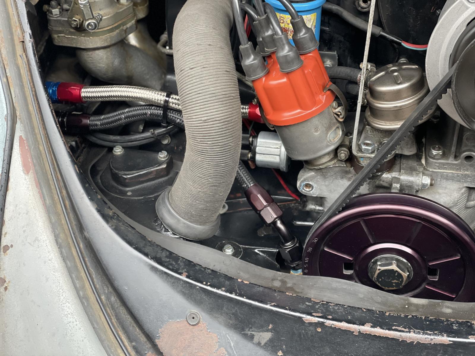

PostPosted: Sun Oct 06, 2024 6:50 am    Post subject: Re: Scored a local '65 Deluxe, The Monster Reply with quote
New oil line was built and installed. The line that was leaking had 2 cracks where the line goes into the AN fitting. New line was made a little bit longer, as it was thought that maybe there was a pulling or tugging happening when the motor was vibrating. About to drive it for the first time in 3 weeks. Stoked!

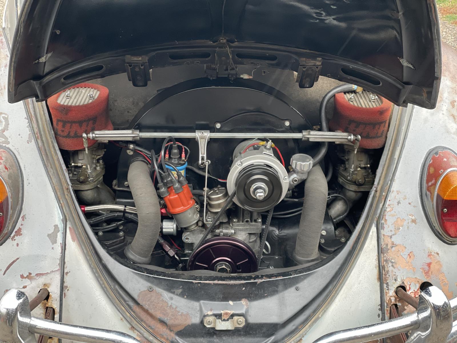

PostPosted: Sun Oct 20, 2024 2:13 pm    Post subject: Re: Scored a local '65 Deluxe, The Monster Reply with quote
The car has been kicking my ass. The new oil line I installed leaked immediately. Built a new line and installed that and there was still oil on the tins after a drive. Cleaned all the tins, removed some tin screws and got in the crevices. After the deep clean there was no more oil, I think it was running out from the crevices. So the new line isn’t leaking, happy about that.
Went to start it today and it was locked up. I was able to rotate it backwards to unlock it and got is started. I didn’t notice an elevated oil level, I didn’t notice a gas smell and the car ran excellent. I decided to change the oil and once I got it into the oil pan I noticed the gas smell. So new filter and oil. This engine takes a solid 5 quarts.
I need to check the float levels, but it started raining and my outside activities are done for the day.
New oil line. It doesn’t match, but it’s not leaking.
One of engine

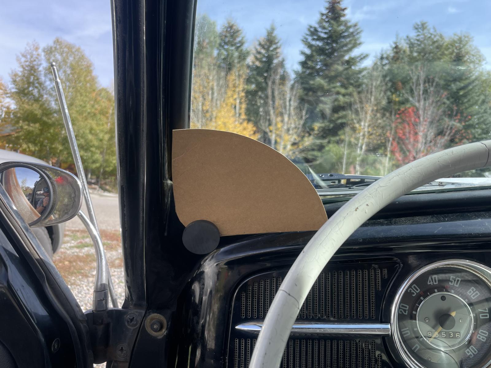

Made a set of defrost extenders. $2.50 in hardware and 2 Tupperware lids from the cabinet (I’ll play dumb when wifey asks where the missing lids are). For the price of these things these are good enough for who they are for.
Template
Final product

PostPosted: Tue Oct 29, 2024 7:24 am    Post subject: Re: Scored a local '65 Deluxe, The Monster Reply with quote
Defrost extenders are working great!
Template
Final product
Hey! Those are not bad. In fact they are pretty awesome. Anyone who has got stuck in the rain at night knows how much the heated defrosters are needed. Especially if someone thinks it funny to tailgate you at this instance. Badass beetle BTW.
