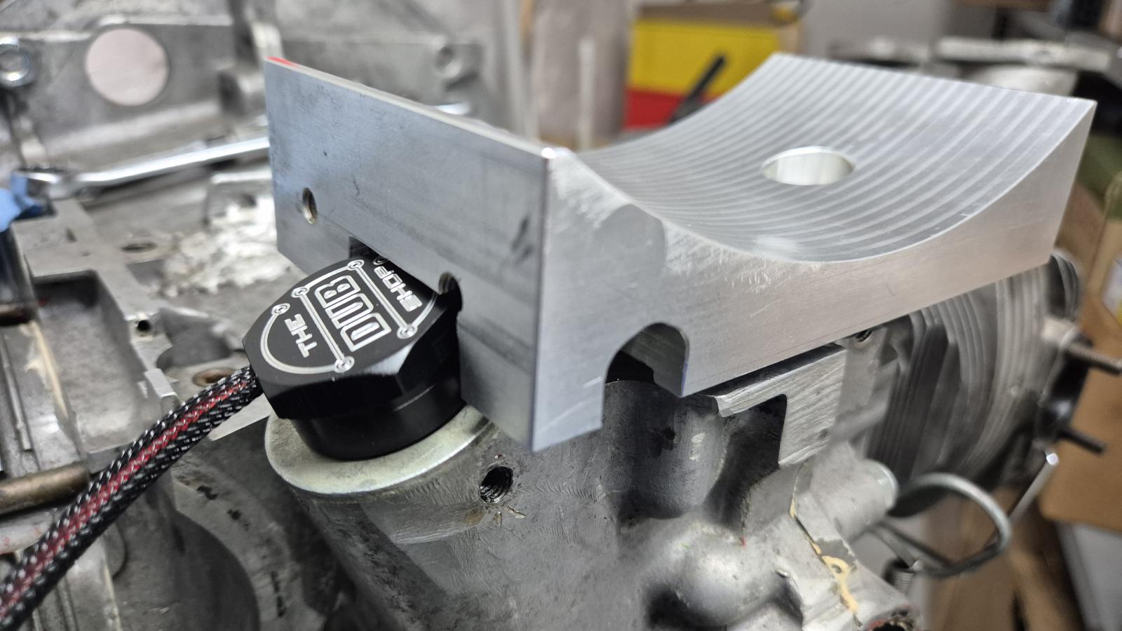

PostPosted: Sat Feb 22, 2025 9:35 am    Post subject: Re: Oxyboxer (s) for my Ghia project Reply with quote
I will be using a Ron Lummus street dual clutch. I reduced some weight on the flywheel, had a trigger milled in and now it's beeing balanced.
This is how the hall sensor will mount

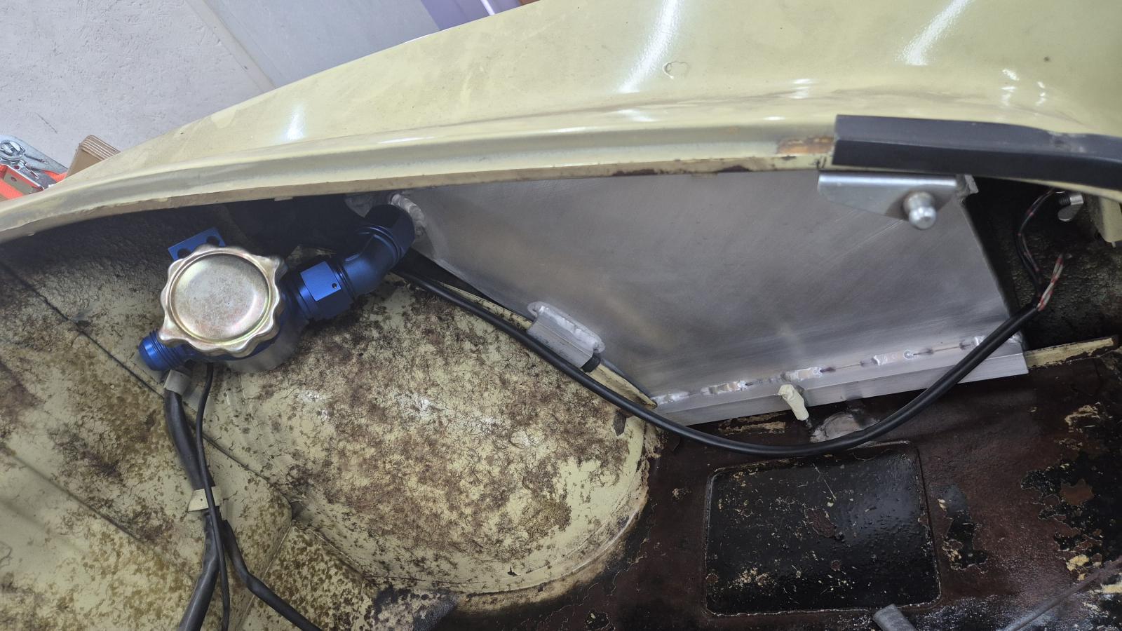

PostPosted: Thu Mar 06, 2025 8:05 am    Post subject: Re: Oxyboxer (s) for my Ghia project Reply with quote
The motor will get dry sump oiling, requiring an external oil tank. Mine has 2 gallons capacity and I hope that will be enough. Plan is to have approximately 5 liter oil in the tank with the engine running. The rest volume is for breathing.
I made a cardboard model first, did all the aluminum fabrikation and had the tank welded. I am quite happy with the results:
Tank with lid
Oil baffle integrated to lid for de-foaming of the oil
Integrated into the rear left inner fender
I am using a modified tank sensor with a float from a 911 oil tank

The valves that Ian linked above are both pressure valves that open at very low pressure, actually they open with slight vacuum on the pump side. And this is what they are made for, to go into the suction line (feed line) between the tank with atmospheric pressure and the oil pump.
You are actually looking for a check valve, to reduce oil going backwards, against its pumping direction:
https://www.improvedracing.com/high-flow-low-cracking-pressure-flapper-check-valve.html
I hope this helps.

The 2.6 uses a 82mm Limbach crank. The pulley end has a cone to mount the prop. I had to modify an adapter ring to make aftermarket Type 4 pulleys work without having to modify them.
Little steps and they all cost time Rolling Eyes
