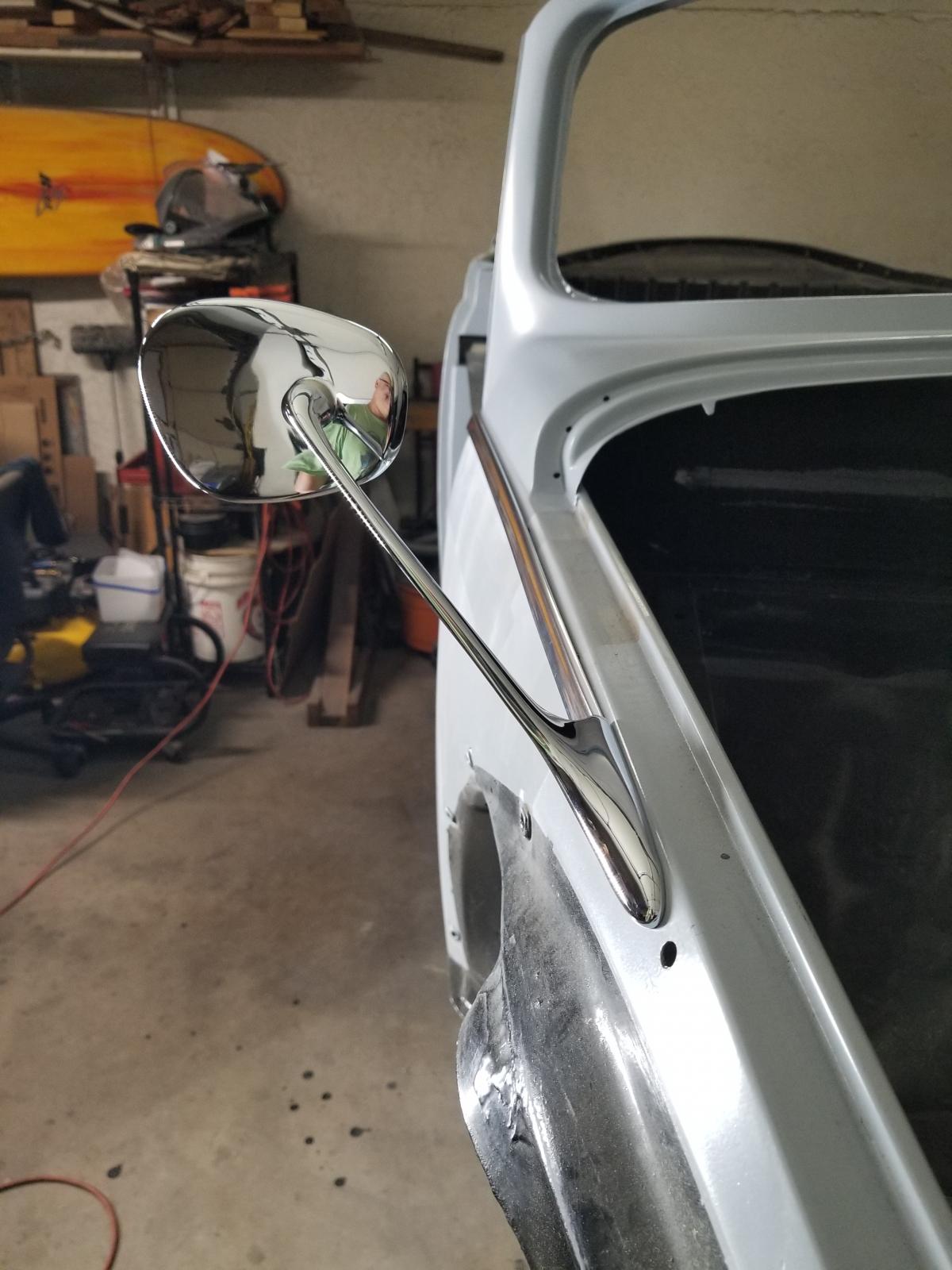

Thanks my Braddah's, JIMBO and BUGGEEE! It's awesome when the little things just work out. My little things don't seem to work out all that often. Well, I think it's because of my inexperience. I think it will be a little thing and then, reality Smacks me down!!

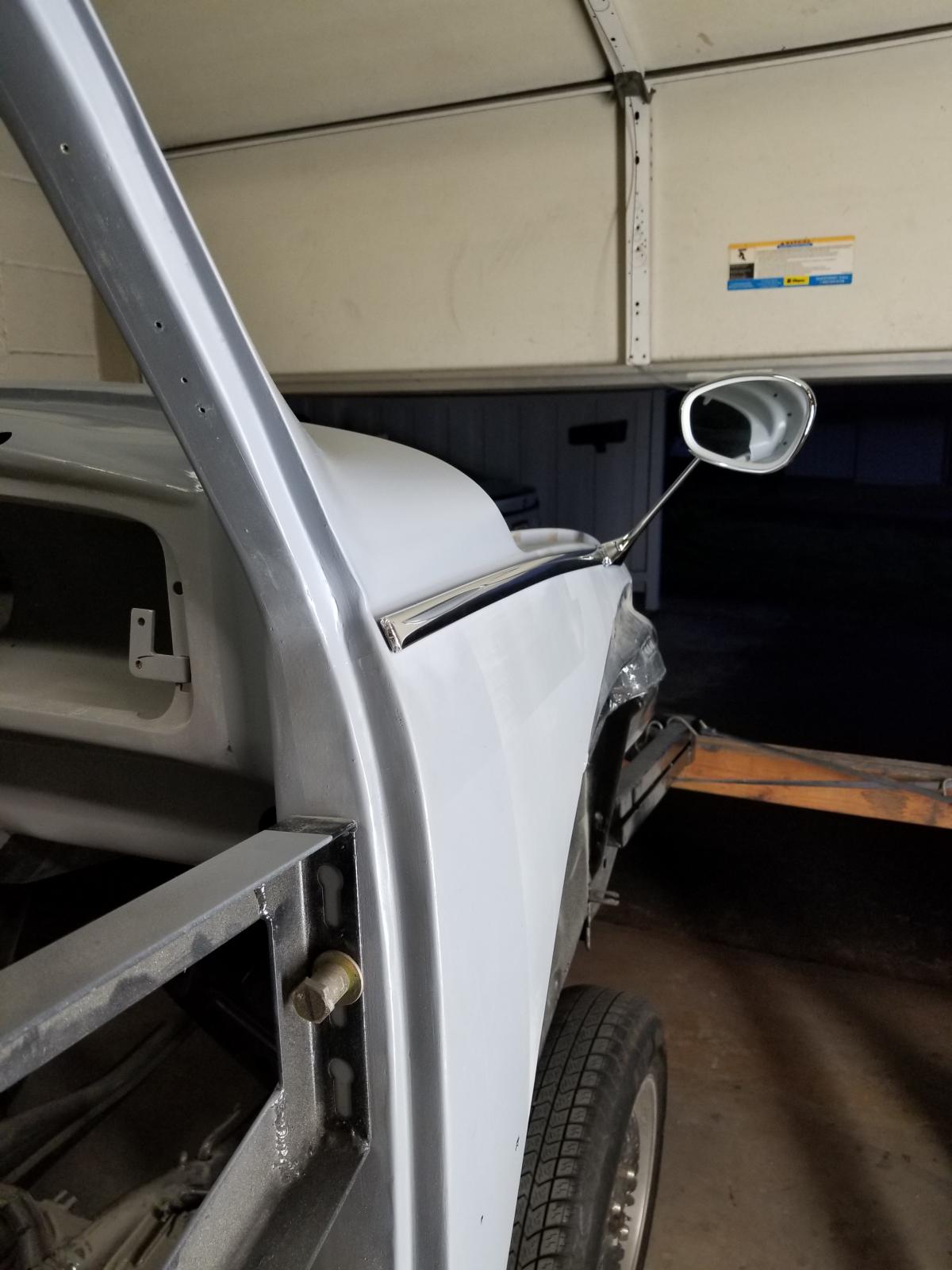

For instance, I thought I'd just fit the Swan Neck mirrors and perhaps have to drill an extra hole. I went with these mirrors so I could move them far away from the Suicide Doors and keep the mirrors from interfering with egress.
Also, I think they are cool looking. Wink
I wanted to go with the Fat Moulding too, since I deleted the extra Moulding on the front Quarter Panel.
Anyway, not as easy as just switching them out as I naively thought.

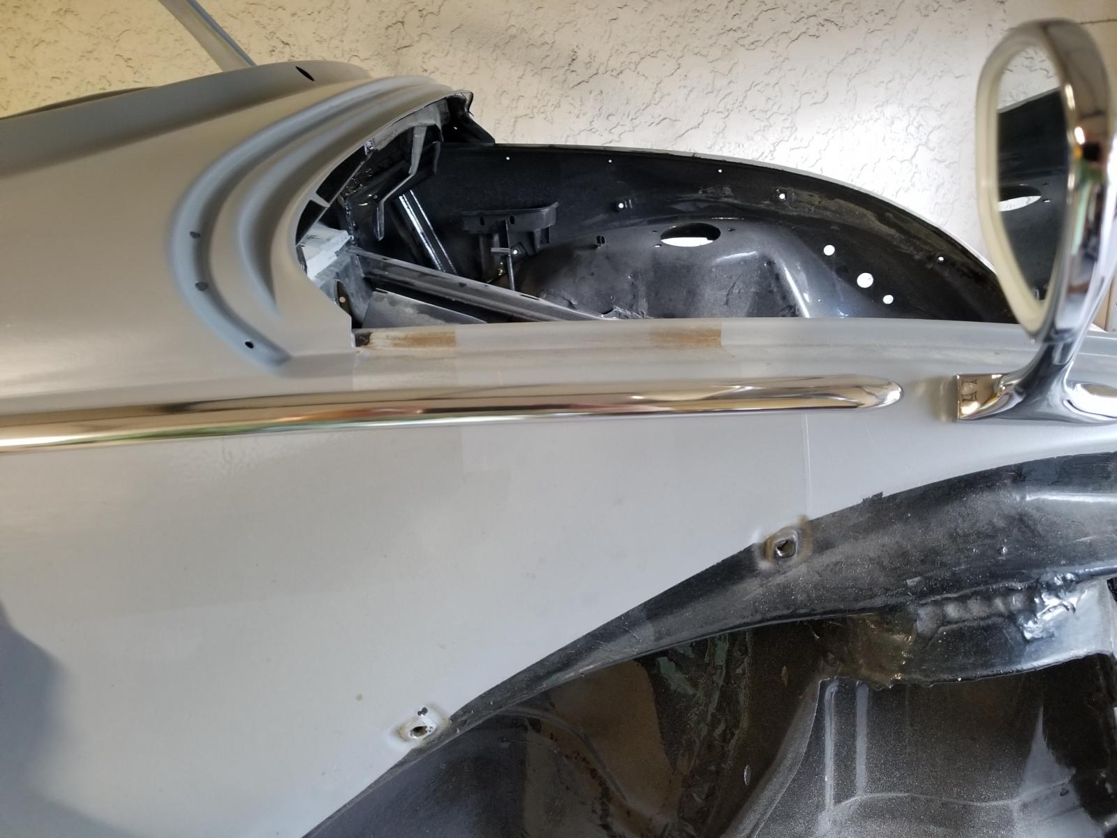

First problem I didn't think about...different size Moulding...different size clips and holes. I did a test hole on some scrap. The drilled hole wasn't pretty. I switched out to my Stepped bits and they made a nice clean hole.
Awwright!! Drilled out the old holes and got the new Moulding to test. The end of the Moulding is open towards the door. Not cool. I finally figured out, that's where they would usually butt up against the door Hinge, which is not there anymore. I did some bending and tweaking. It'll pass I guess.
Then, there's this. Apparently, I'm a bit short on the Moulding. I mean It looks okay, but the Mirror only has one bolt to secure it. The Muolding helps out by going in the channel under the Mirror base.
I moved the Mirror up a couple of inches and drilled a new hole. But, now I got the the original hole up front. I was thinking, maybe put an auxiliary Marker/Blinker light there? Nah, there I go again...trying to make more work for myself. I'll just fill it.
Here's a view from inside the car. Not very practical. I got some convex stick on mirrors that I'll try and see if that makes a difference in usage.
The rear Quarter and Doors were not so bad.

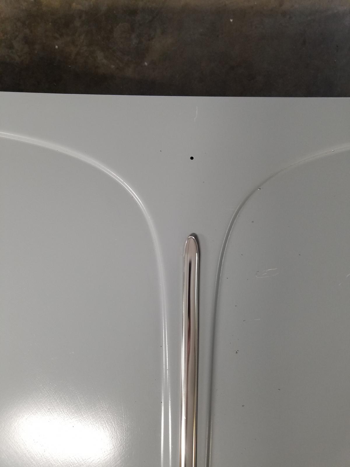

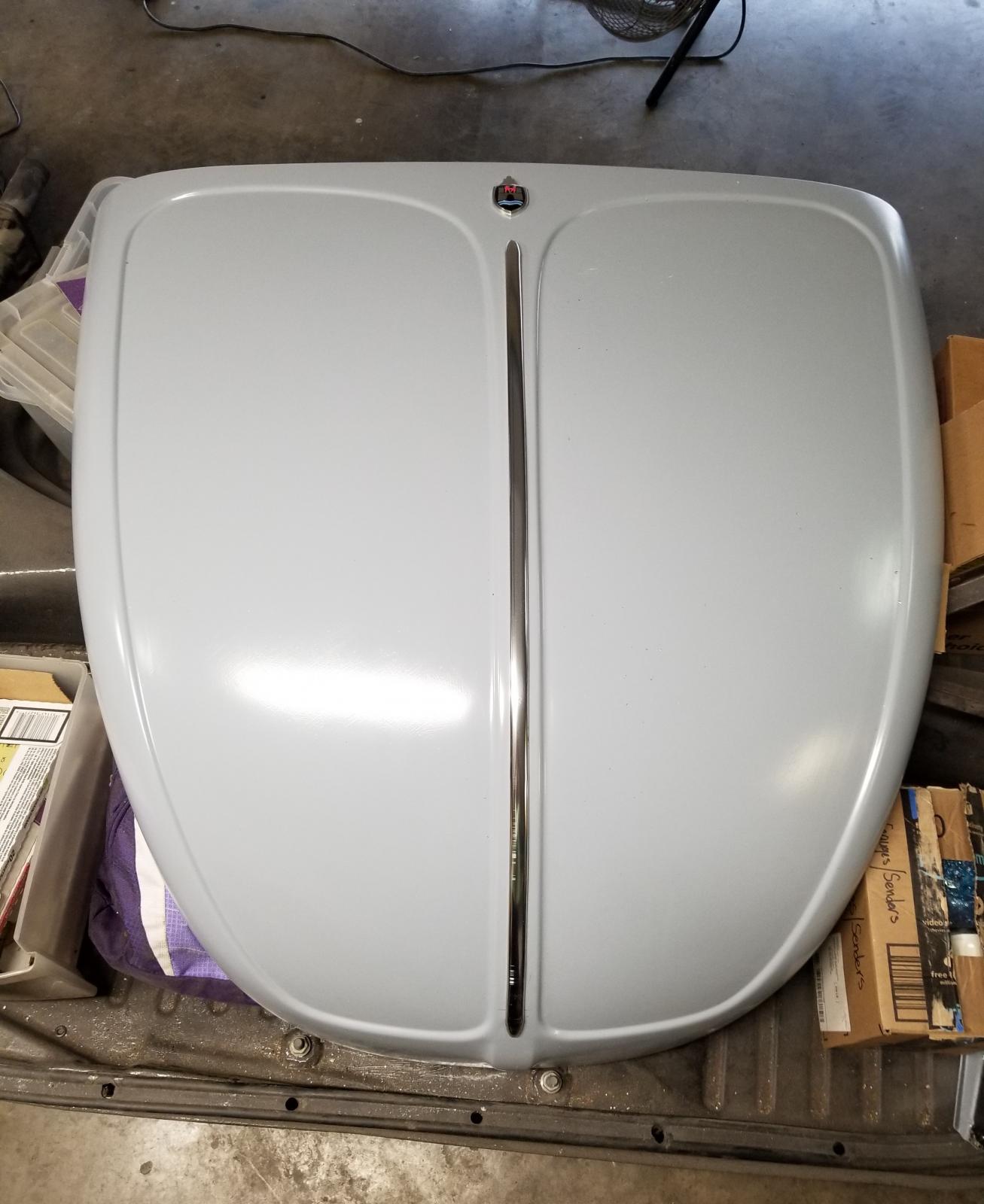

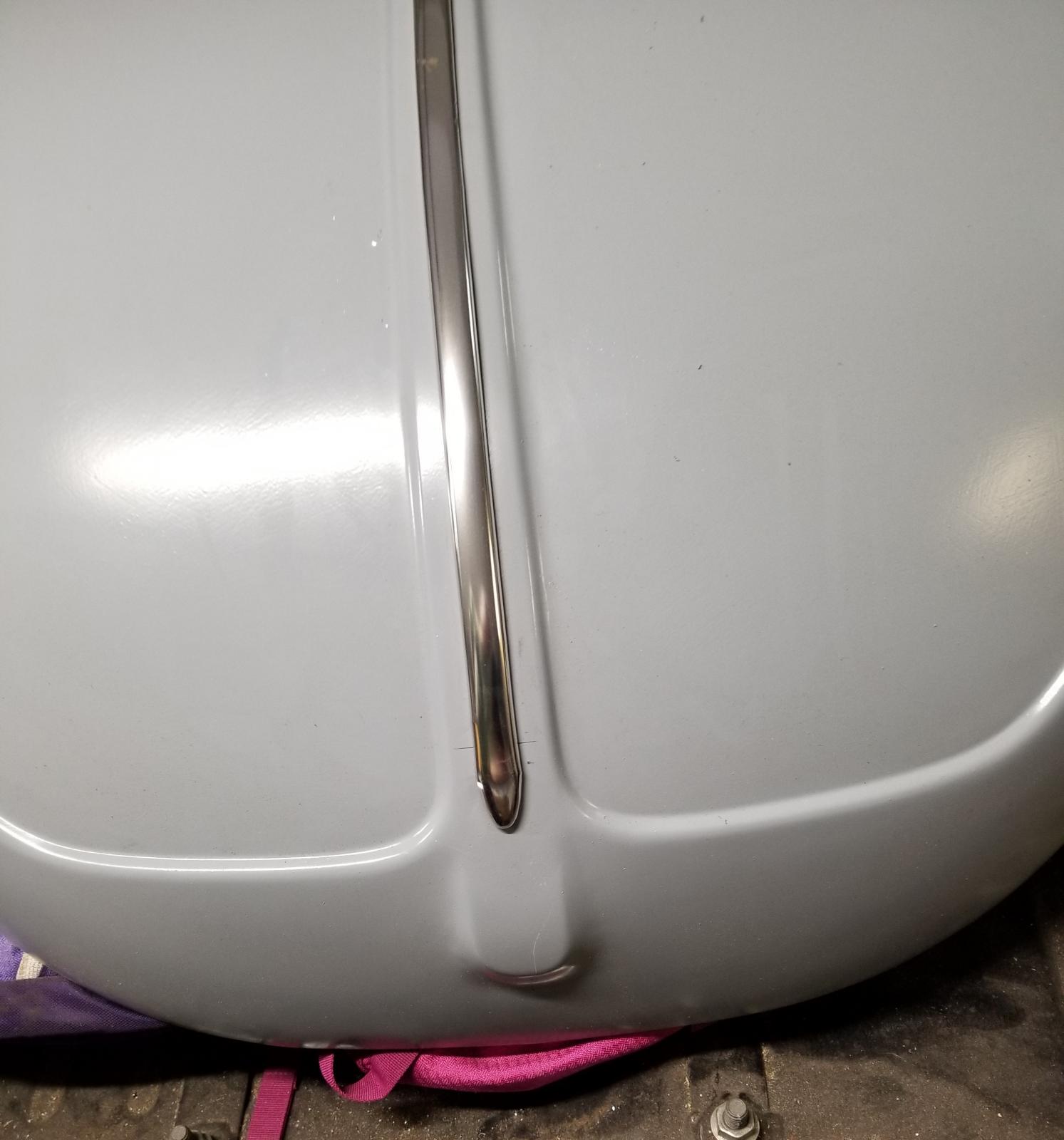

Last up was the Hood. The length was pretty good, but the Super's curvature is much more steep vs. the earlier, longer sloping Hoods. I didn't want to kink that Bastard, so I put in a bunch of relief cuts to just try to relax it a bit.
I had thought of putting the WolfsBurg Crest at the bottom, where the Trunk Handle was. But, the Trunk Latch is under there. I'll have to think about how to address that space. So, up to the Top the Crest went.
That was another, "Not so easy", thing. While trying to fit it and figure the plan, the two prongs that secure the Badge to the mounting plate broke off. Long, aggravating story later...I Epoxied the Badge to the Mounting Plate with a large head Carriage bolt sandwiched inbetween.
Then, bolted it down nice and snug! I'll see you guys at my next "Simple Thing"

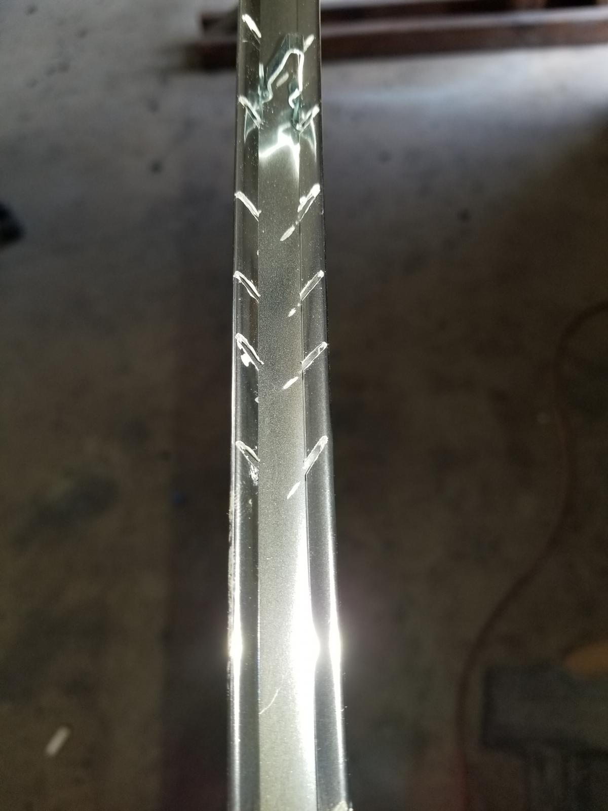

I just cut a little wedge out of the sides, about 1/8". Then put some blue tape on the teeth of my standard pliers(in hopes of not marking the Trim up too much). Bent down the end and folded the side Tabs in. It's not as nice as the Blurry pictures make it seem. But, that was the extent of my skill set. Embarassed
I'm sure you will make it a lot nicer.
