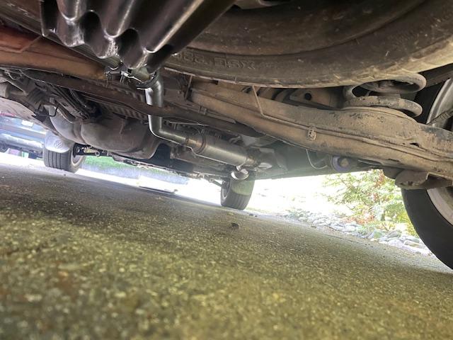

N
ew catalytic converter arrived and installed with new O2 sensors, and custom exhaust.
The O2 sensor was an issue before as there is no more grumbling on post start-up. Idling and driving it is way smoother. Also doesn't stink!!. Yahoo
And more powerful the new CAT is clearly flowing better. Two muffler custom exhaust is a bit deeper like a Porsche 928 sound, but not too bad.
Got some daisies to slap on the side and call the project done.
Also will monitor trans temps. The other day it was hot out and I never got past 70 DegC. The trans line routing is protected by foam. And I should get those superior clamps, as the gear clamps do chew into the hose too much

Looks good! Was your original converter & o2 sensors throwing error codes or did you replace it due to the smell and rough running conditions?
SambaBurnsRed
Joined: February 07, 2025
Posts: 60
Location: object:1698
SambaBurnsRed is offline
PostPosted: Thu Jul 31, 2025 12:15 pm    Post subject: Re: '03 High Mileage EV Red Refurb Reply with quote
Stunk to high heaven warming up from the day we got it. Not unlike the cat-less, bag-less 50-60's classic shiny death traps old guys wearing ball caps drive around here.
But I did get O2 sensor insufficient heating time, intermittent code pop up recently. Cleared and it came back.
Rusty exhaust so do the whole thing fresh install.
