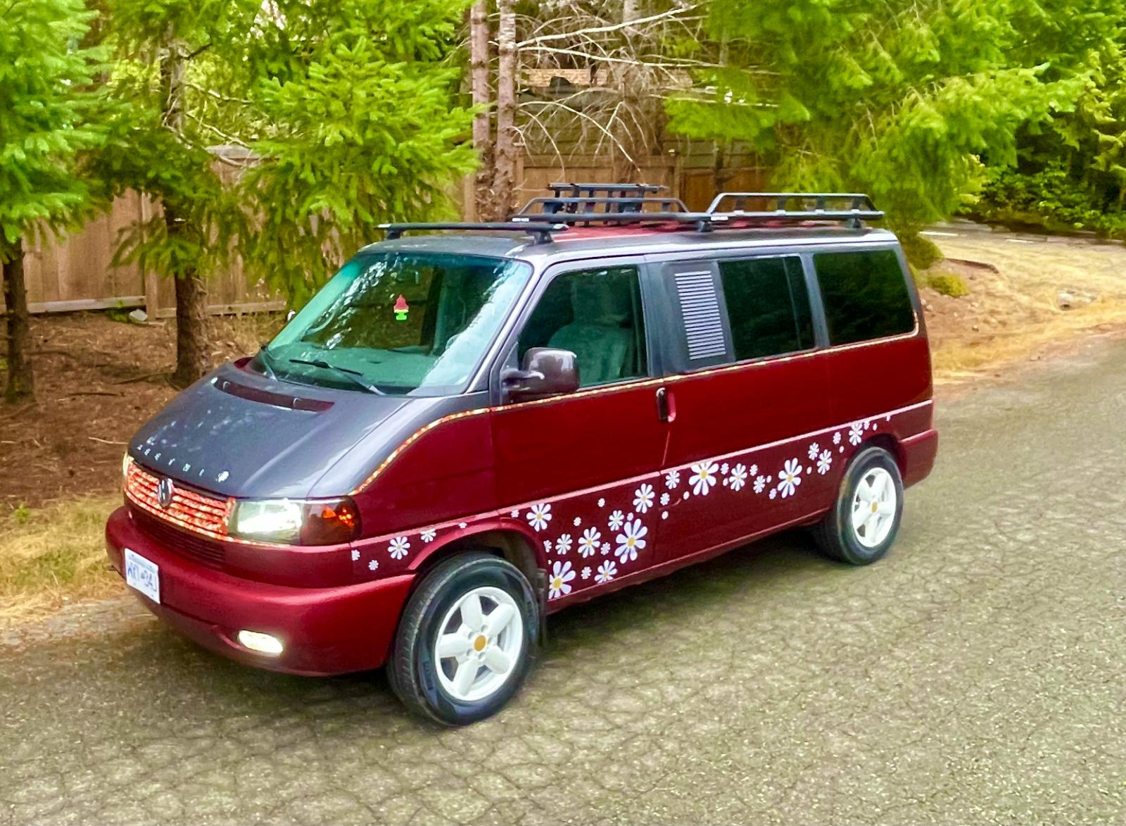

My daughter wanted flowers, so came up with the idea that she just drove through a patch of daisies. Kinda like how muddy roads, aerodynamics form cool patterns on the body flanks. The daisy pattern is constrained by the mid-line crease and bottom line, cool effect. Our neighbour was watching how it came together; she was pretty stoked Smile
I figured out: use masking tape pad to pick the daisy off the decal paper and transfer to the EV. Then remove masking tape, leaving daisy on the body. Much easier!

Painted the dowdy stock wheels white, daisy keyed center cap Wink Very retro-scooby-do cartoonish cool. I put some nice Pirellis on those before I bought the heritage wheels, and they'll ride better than the Hankooks on the 17's.
