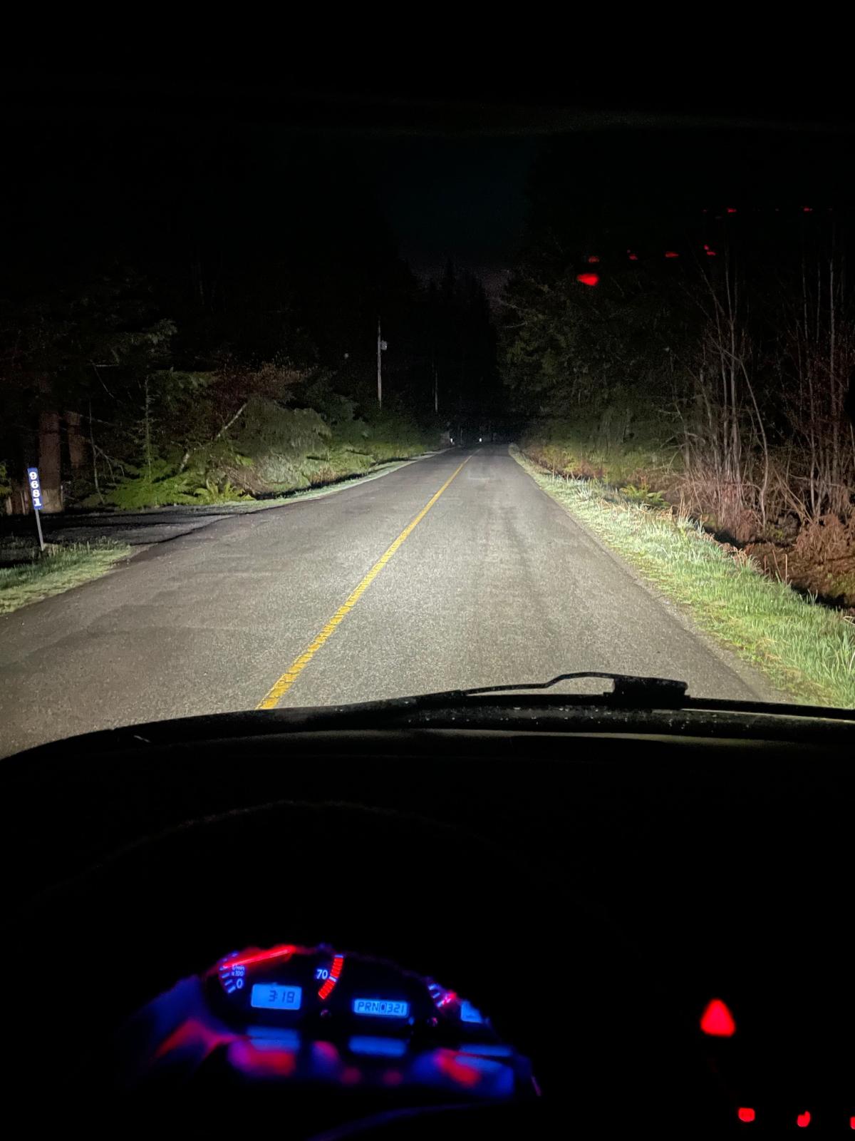

Here is the LED actually pretty good for drop in. Bulbs do a bit of a side kick on Hi Beam. I popped the power steering tank (that was stuck in there) for P-side and got to the d-side adjuster as well. So now I am able to aim things to optimize.
Unfortunately we drive Range Rover/Audi HID, Audi A8 LED, BMW X5 LED so c'mon, who we kiddin'? Meaning it's not going to be OEM engineered performance. But the bulbs that were in there are a brown-out of the first order.
LED lighting so piercingly bright & low current draw - unbelieveable tech!

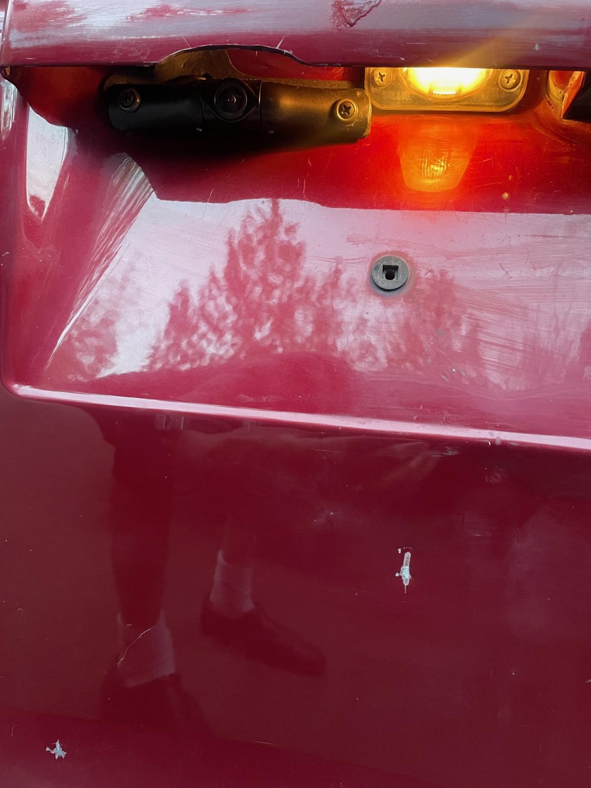

The back-up camera install... ah man...no fun that. The driver's door well has power/audio, so I ran the wires from the hatch, down and under the van coming up into the door well. I did not want to pull apart those interior panels. I traced sw/bl everywhere but could not locate the actual reverse light wire @ front, so ran that from the tailight.
The cable was way too short so janky spliced using some RCA cable I had.
The camera is mounted under the license plate light cover, drilled a hole in the hatch frame to duplicate the OEM path out of the hatch, but I am on driver side. I just ran the wires down along the rubber seal through the bumper gap enroute to upfront. Still took more than a day to complete that work

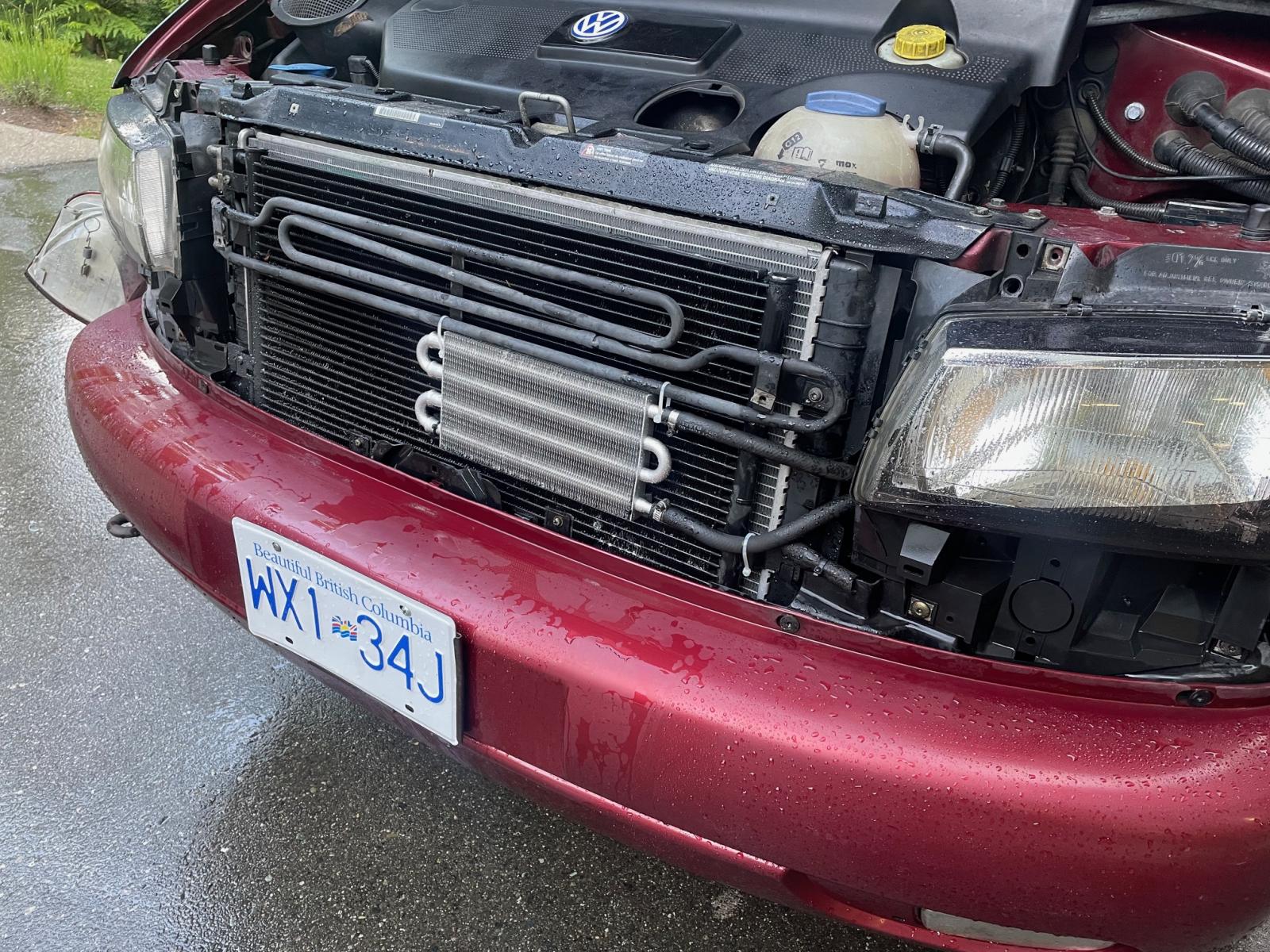

The JB Weld on the trans cooler started to leak again. They say "engine block repair" on the package but I have had two hot oil faiures using epoxy. I had a really clean and well prepped area on this one too.
In any case, the cooler from GTA is a rough looking fused thing. So Amazon to the rescue got a robust and slim 4 pipe cooler for $35/sale price. There are larger ones out there but this one is suitable for an XC90. Our climate around here PACNW isn't very hot. Fits in there nicely too.
And while I had the grill out I changed the front end look from something that looked like a puffer fish to a wider, lower and more whimsical style, that will augment the daisies (?) being sketched in for the sides

Transmission temp is just under 90DegC after a good drive.

Watch those trans oil hoses where the go around that rad corner for chafe. , and replace those clamps with oetikers.

Also will monitor trans temps. The other day it was hot out and I never got past 70 DegC. The trans line routing is protected by foam. And I should get those superior clamps, as the gear clamps do chew into the hose too much |

Do you have any issues with interaction between high beams and fogs? I tried LEDs on my '03 and whenever the fogs were turned on, the high beams would come on as well.
A resistor pack to add load to the LED fixes this but the pack is to big to fit inside the headlight housing so I didn't use it with my LEDs. I was also concerned about the heat of the resistor pack near the plastic parts of the headlight housing.
If you did not have any fog/high beam interactions, please share which LED headlight bulb you used. _________________ 1973 VW Superbeetle (1302) w/ RAT 2270 T4

For the LED bulbs I added 24? ohms, piggyback fuse (2 in series), to Hi Beam ckt, Connected at the fuse panel under the driver's side dash. I think it just needs to be a drain resistor, something to make a connection there. I would test higher ohm values if I had them. The resistor I have is heat-sinked so can handle the 0.5A drain. |
