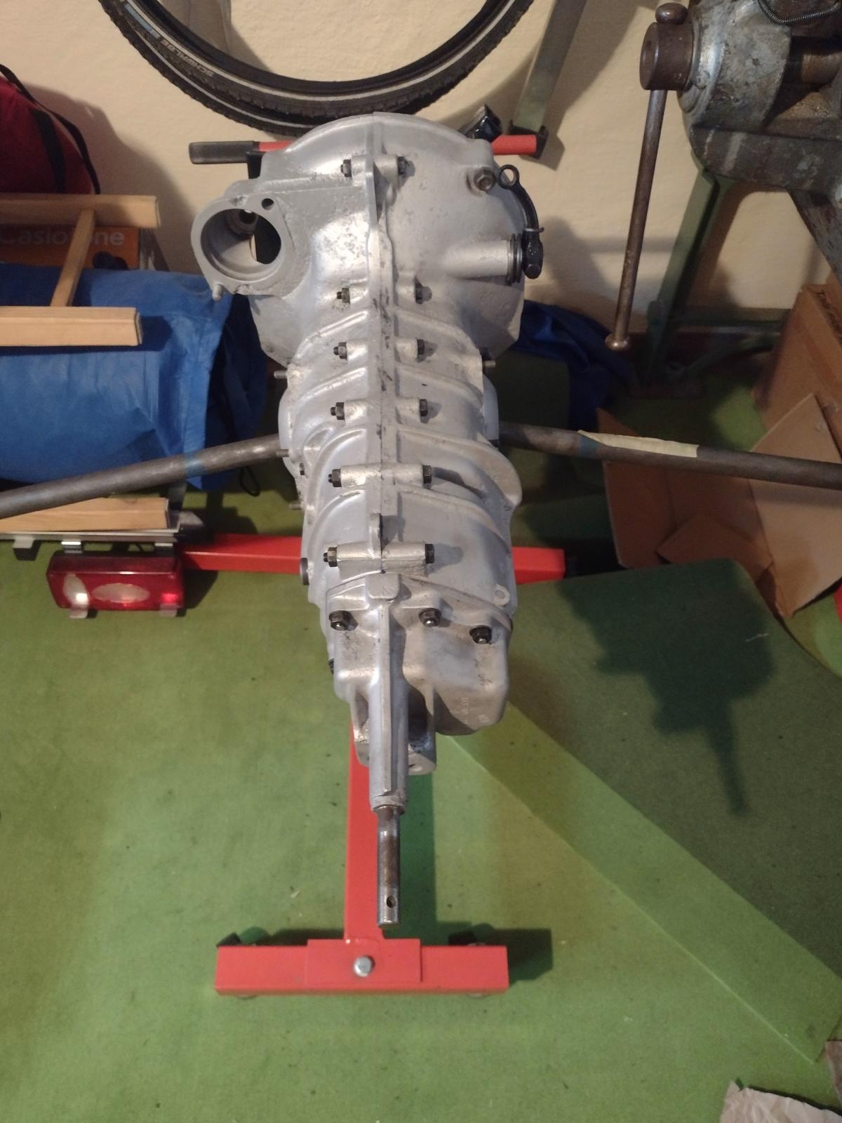

And I rebuilt a 1960 split case gearbox (I did receive the ghia with a modern unit but wanted the "right" one):
Start:
Disassembly:
Blasting of the case: (picked up in style with the ragtop)
And after changing the necessary parts and adjusting the bearing preload:
This will come next on the pan!

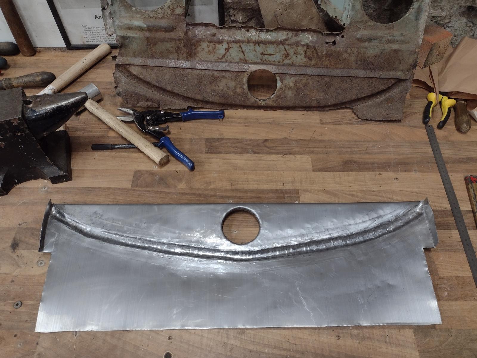

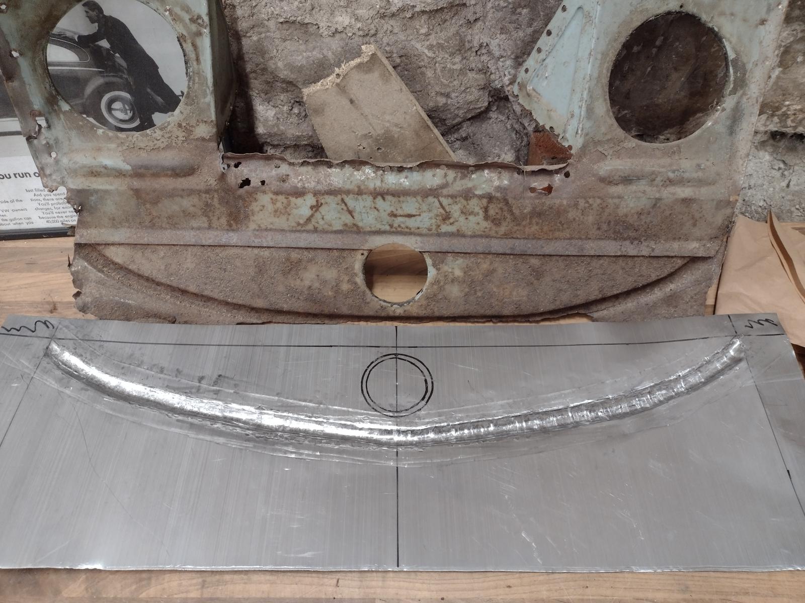

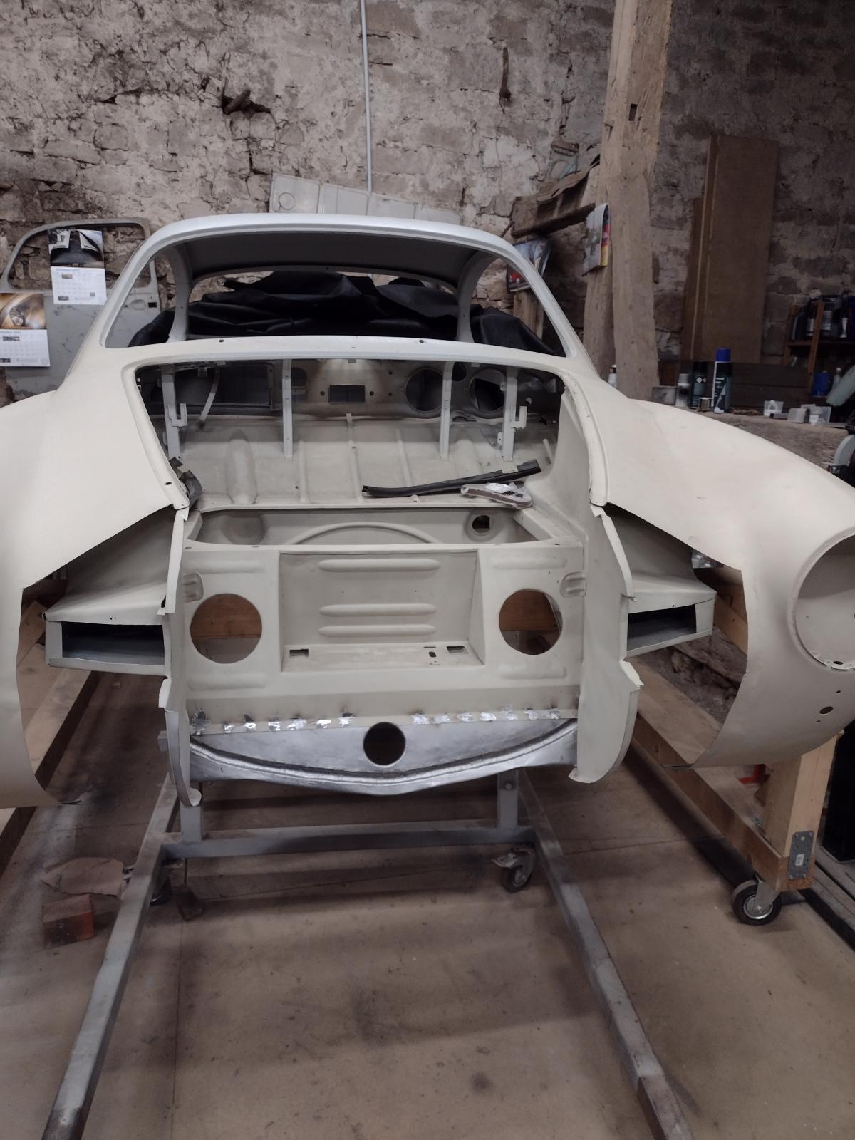

Continuing on the front, I had started here:
So now the build:
Test fitting:
Adjusted in shape:
And welded in:

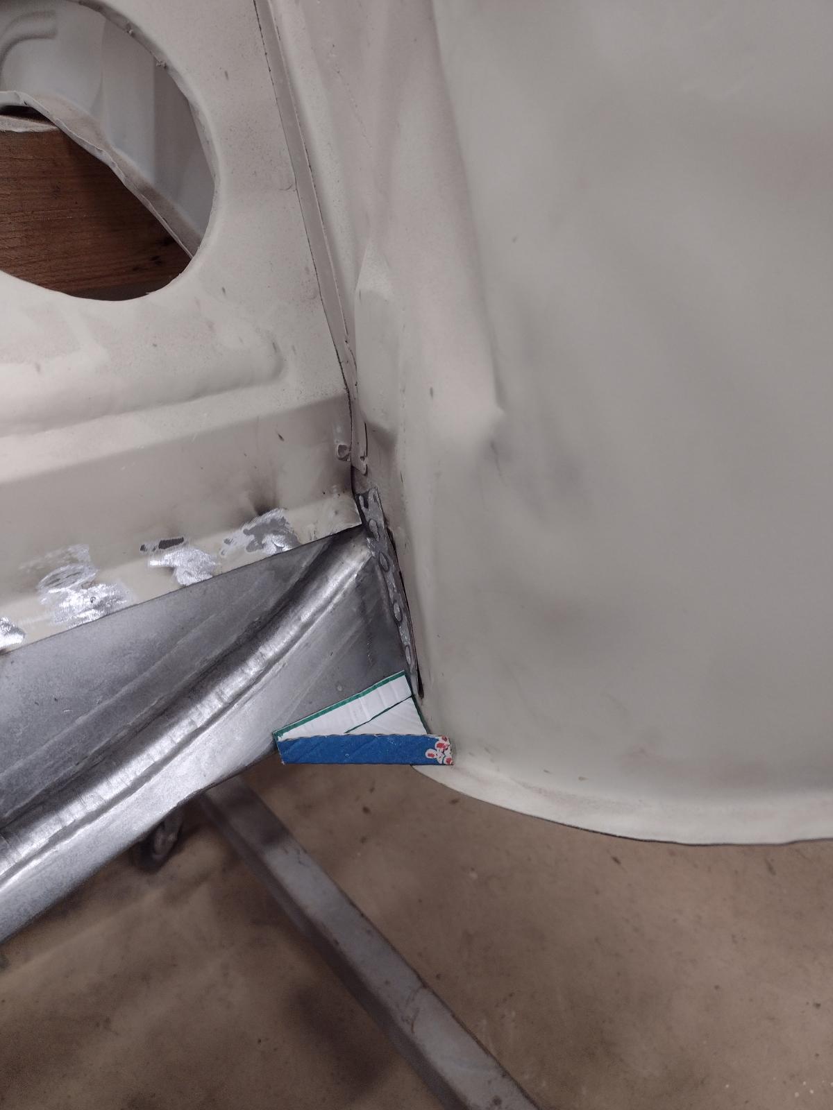

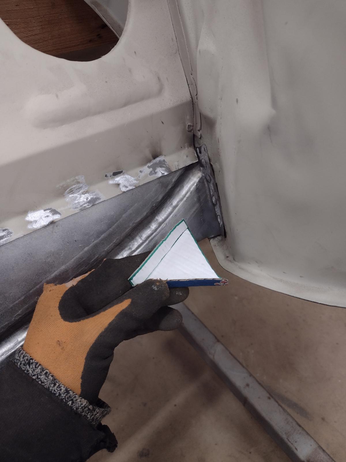

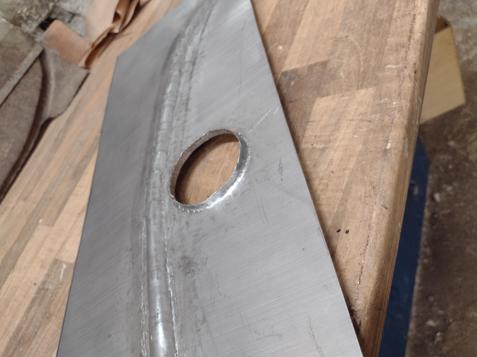

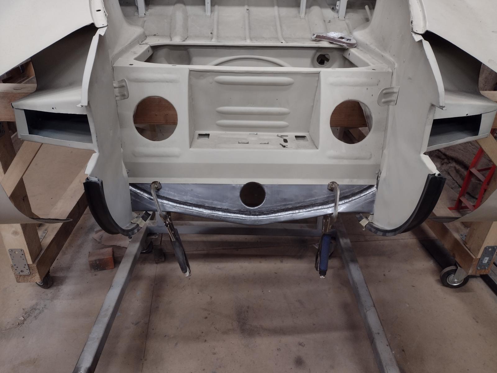

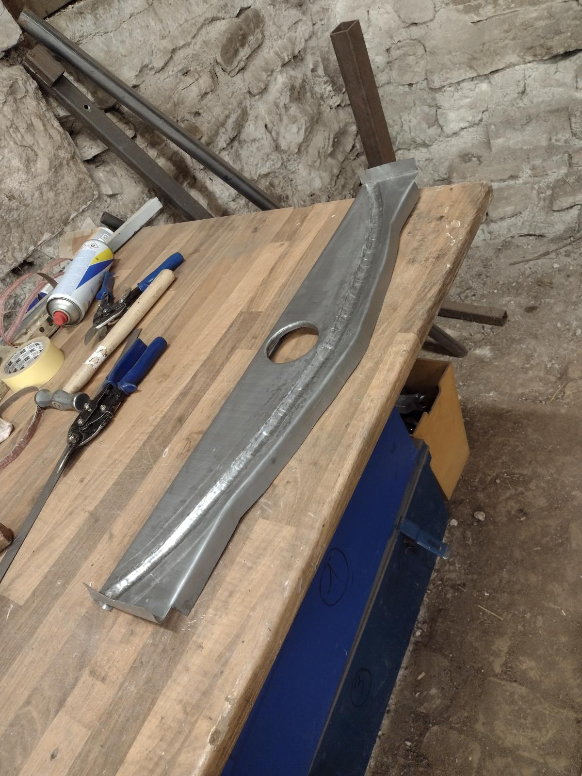

So, after that I build the renforcement triangles, first out of Cardboard:
Then in metal. I forgot the picture but can be seen here at the bottom. Jack's fixation is also visible there:

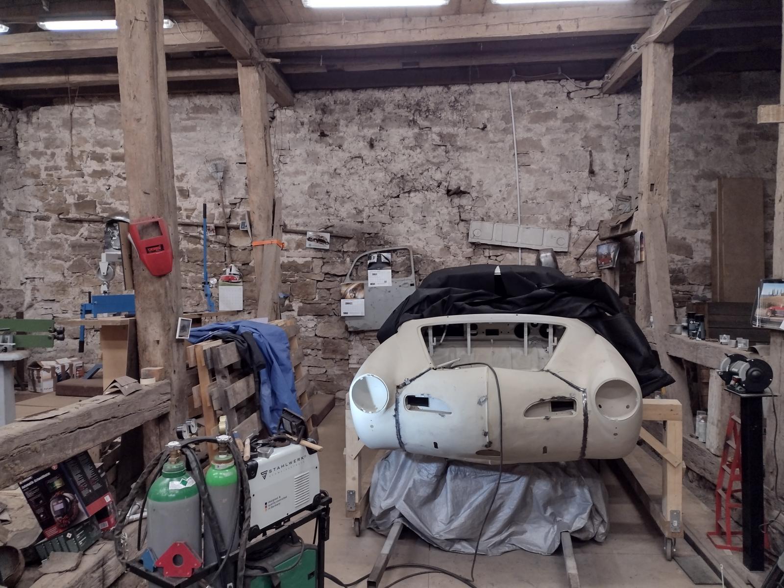

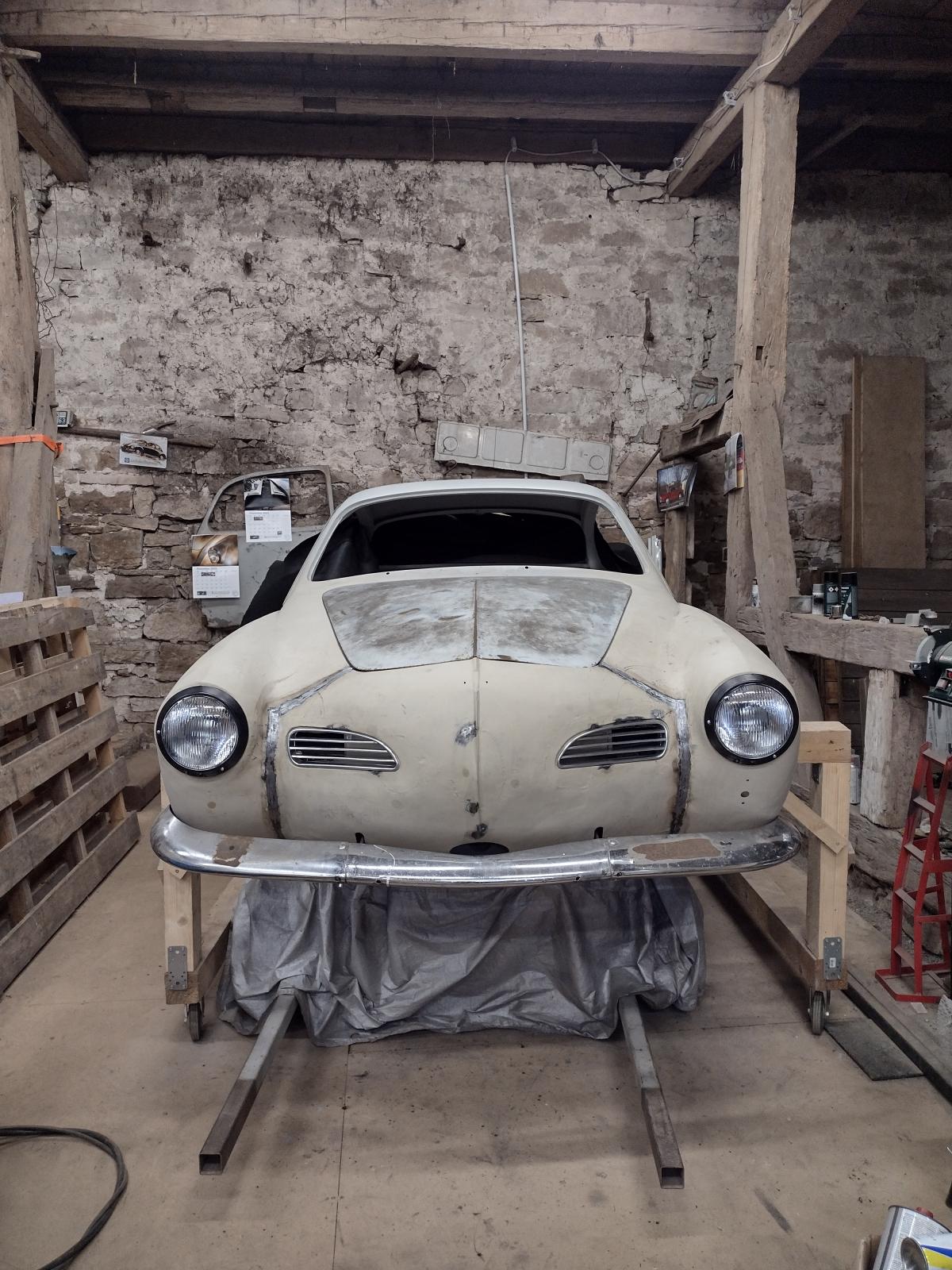

Then it was a big time, adjusting the front mask back:
Then tack welding it :
And here we are, my ghia is finally looking like a ghia again !!
