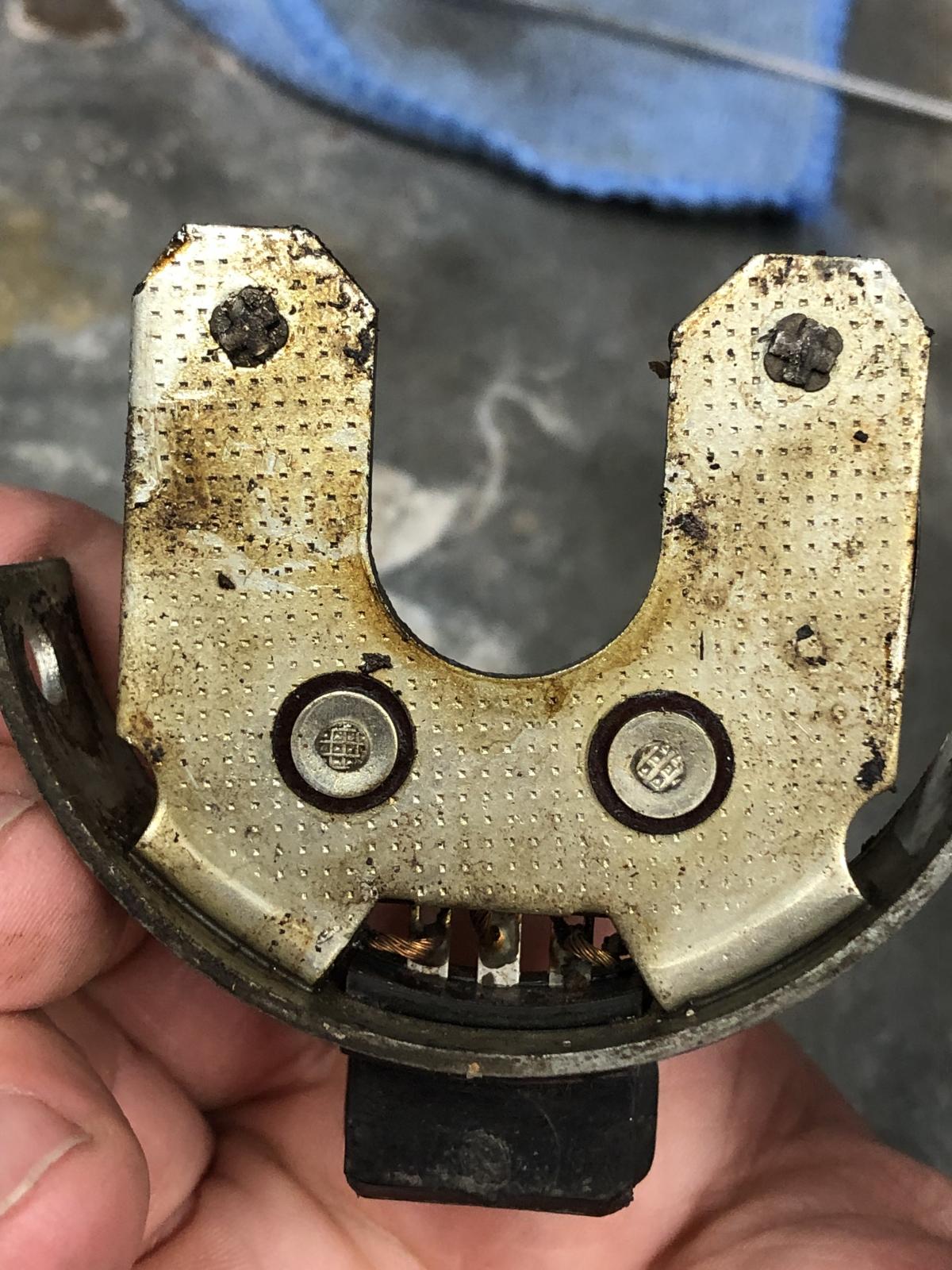

PostPosted: Mon Jul 07, 2025 8:31 pm    Post subject: Re: Another Pickle Post - 1973 Squareback Reply with quote
Pulled the dizzy out, checked the trigger points for the injectors, and gave everything a once-over. Seems to be in decent shape.
Need to get in and clean the shaft, then relubricate it.
Used the brake bleeder pump to test vacuum, it holds well, the breaker plate moves smoothly without any grittiness.

Going to grab a can of this electronic cleaner spray for the connections, and for the trigger points. Anybody have any objections to using this?

I carefully cleaned and lubed the distributor shaft and the trigger points got a quick wipe down. Used some electriconic contact cleaner on the trigger point connections and harness then lubed up the shaft (wait a minute…) and reinstalled the distributor. I then checked the 3-ground porcupine ground connections and cleaned them up well, then the rest of the grounds.
Ran and grabbed the best fuel I could find nearby and added 3 gallons to the tank.
Wired everything back up and she started up immediately and sat at idle perfectly, purring like a kitten.
Woo Hoo! Man does that put some wind in my sails!
I let her sit and idle for a couple minutes as I removed the spare hood and miscellaneous boxes from the roof rack. Then, against all common sense, backed it out into the street and did a short trip down the block. She didn’t like too much throttle, and second gear grinded and would not go in, so I kept it in low gear and only drove about 50 yards then turned back home.
I read that with the engine at TDC on cylinder 1, the rotor should be aligned with the notch in the distributor’s upper edge. As my car is set up, that notch faces directly toward cylinder 4. But the #1 plug wire is 180 degrees opposite that, essentially pointing at the #1 cylinder.
I figured the previous owner had put the spark plug wires in 180° out. So I moved them around to where the number one plug wire was facing the notch in the distributor, pointing at cylinder four.
I figured that would correct the stumbling issues it had the last time I tried starting it. Instead, the car would not fire at all, almost as if it had no spark.
So I rearranged the wires as they had been, and it fired right up. I don’t know if that means the distributor was installed 180° out or if I’m just reading into this incorrectly.
Either way, I’m one step closer to getting this thing running. I posted up a couple of videos to YouTube, I will put the links up here for you guys to view.
