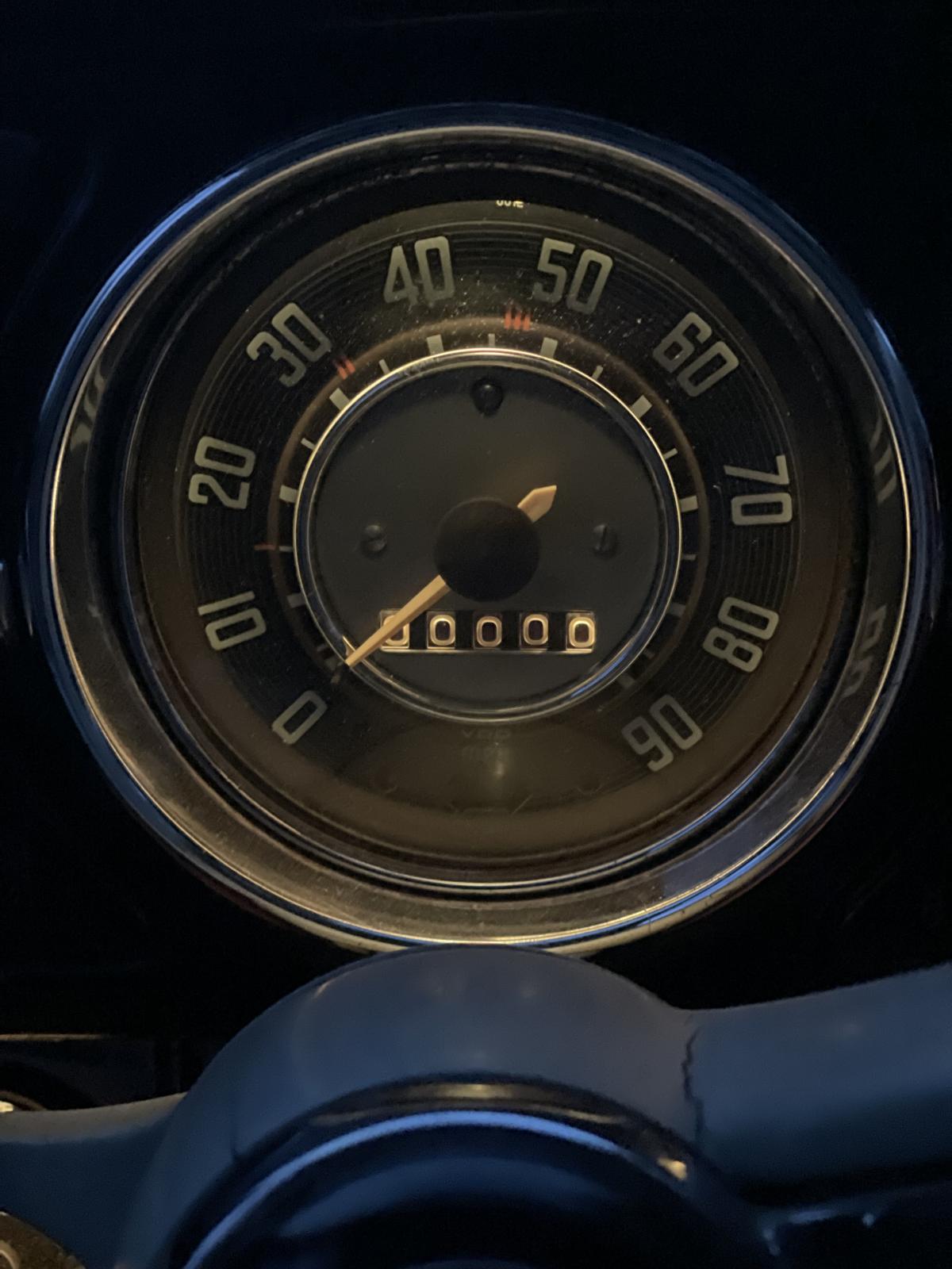

I believe this to be the first odometer flip.

I guess I didn’t realize it’s been 3 months since I updated this thread. The car has been fine since the smoke issue and hasn’t used any oil. Totally weird.

pretty cool you flipped the odometer ! fresh start
