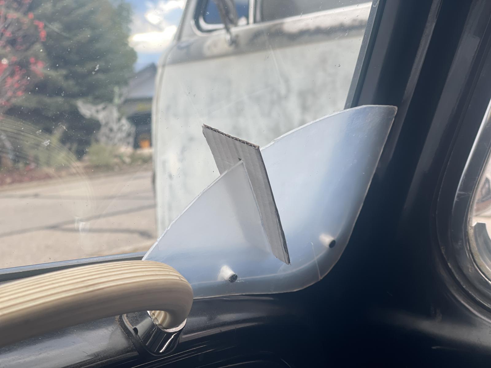

PostPosted: Thu Oct 23, 2025 7:28 pm    Post subject: Re: Scored a local '65 Deluxe, The Monster Reply with quote
Made these carboard inserts for my defroster extenders. They deflect the air to cover more of the windshield when it’s frosty or foggy.

PostPosted: Fri Oct 24, 2025 11:10 am    Post subject: Re: Scored a local '65 Deluxe, The Monster Reply with quote
I wish I had thought of the defroster mod 50 to 55 years ago when I needed to keep an ice scraper inside the car during winter. Nice work.
