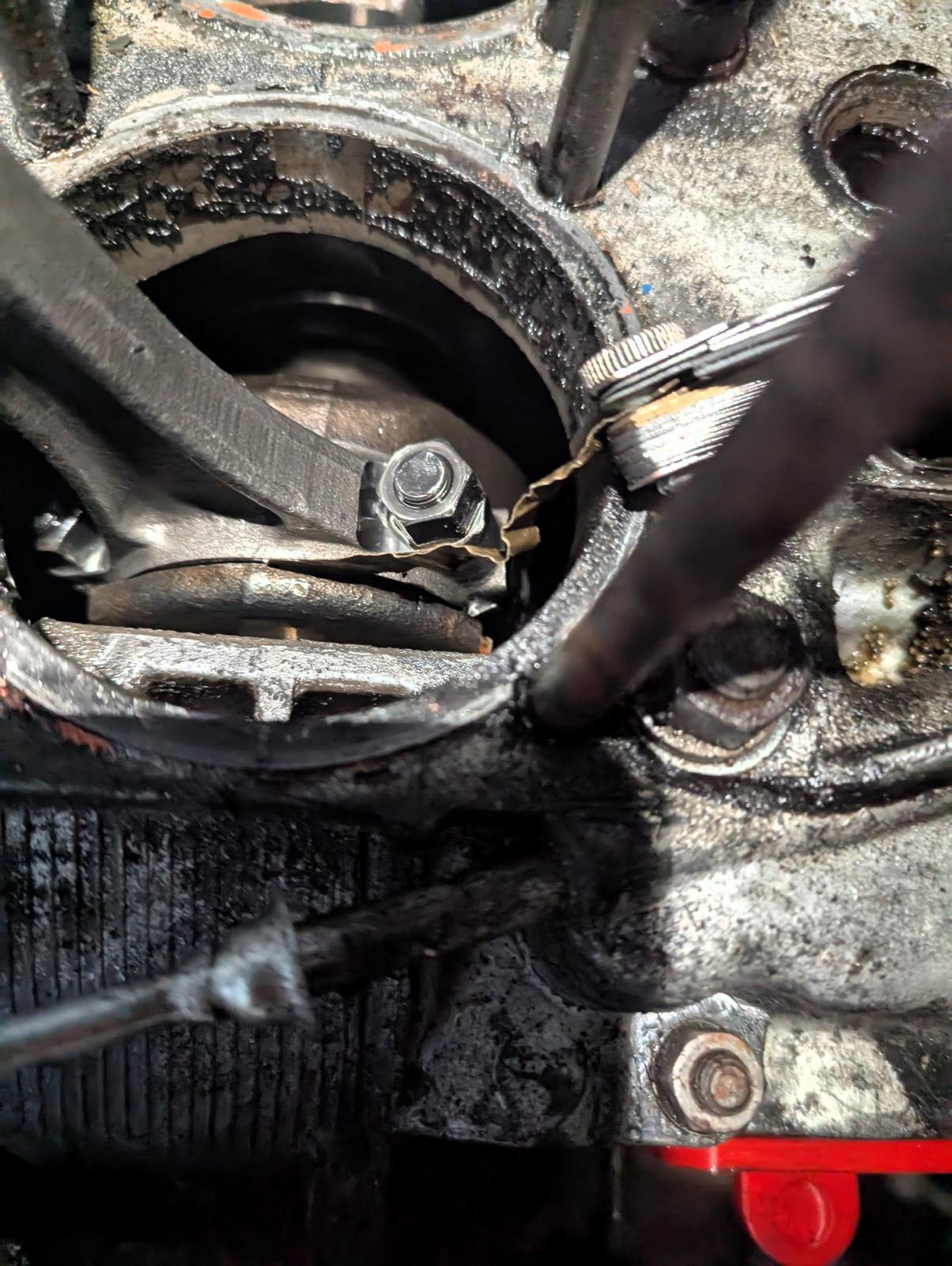

Rome, I'll inspect all of the parts I remove and the ones I don't. I do have the little metal retainer clips for the lifters. Here's what my calculation comes from:
.78 in mm for the deck height translates to 0.03070866 in inches. From what I've read elsewhere, this should be closer to .040-.050. That would mean adding cylinder shims or head spacers, but that would lower the compression to 7.4 or less.
I used one of those steel deck plates to measure the DH. I bolted it on, got the piston to TDC, then used a digital caliper to measure the thickness of the plate, then the caliper's tail to measure down to the top of the piston. Then I subtracted the first measurement from 2nd to get the DH. I took that reading multiple times.
I think the head looks ok. I was expecting to see ugliness after the way it heated up on me on my last Miami road trip. So far, so good.
I have .006 play on both rods side-to-side. Not excessive from what I've read, but...?
Click to view image

Aha. My mistake- I misinterpreted your ".78 to .82" when I responded.

PostPosted: Thu May 08, 2025 6:02 am    Post subject: Re: Yikes! I bought a '74 Super!! Reply with quote
This gauge has seen a lot of valve ajustments!!!! Very Happy
