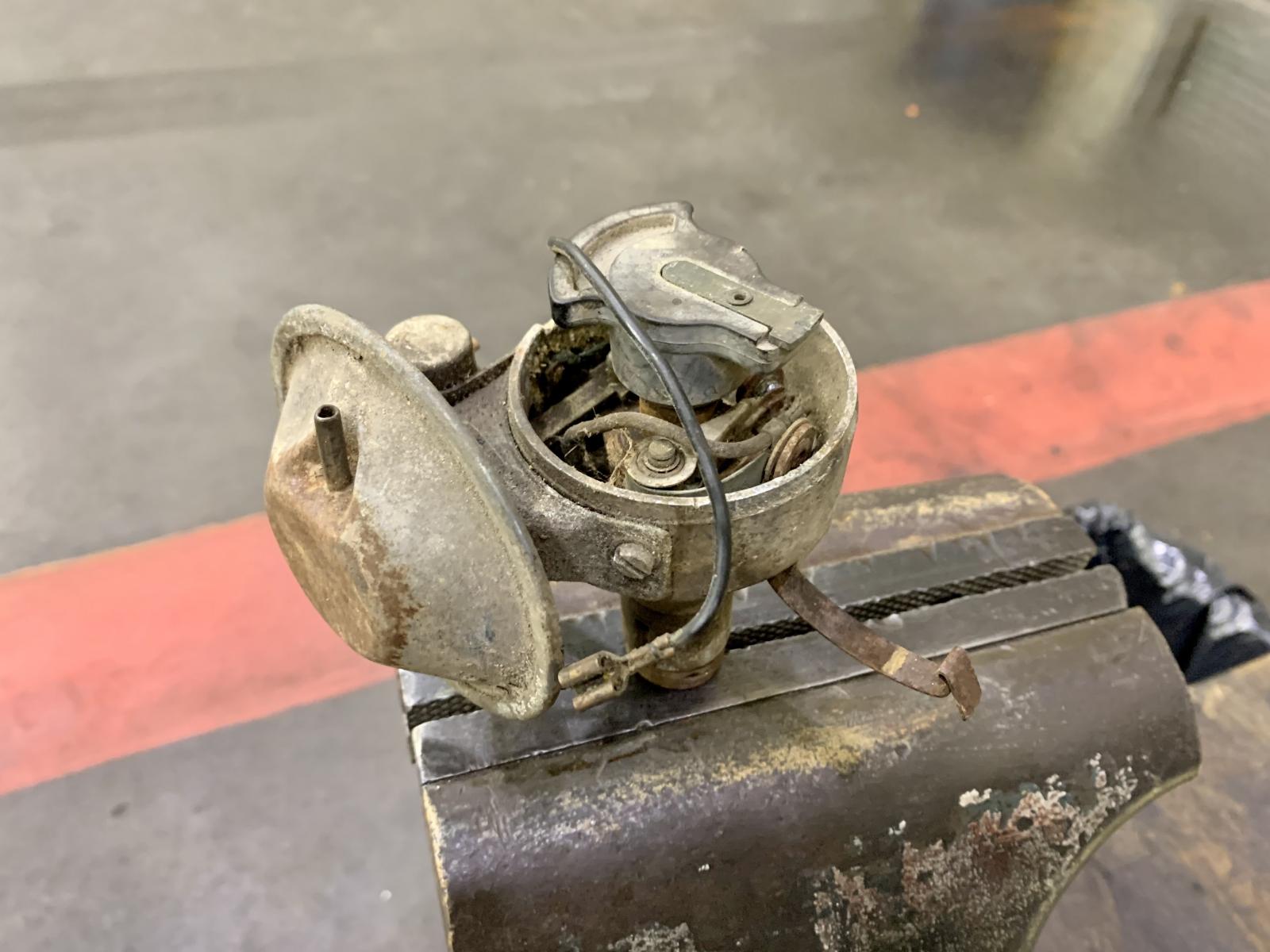

Here's my "backup" distributor. It's another stock VW 113905205K SVA. Stuff like this must just be low hanging fruit! I love rebuilding little parts like this, or the fuel pump, carburetor, steering box, etc. It's just so satisfying to restore old parts. I've already got it torn down, glass beaded, and the body dipped in alodine.

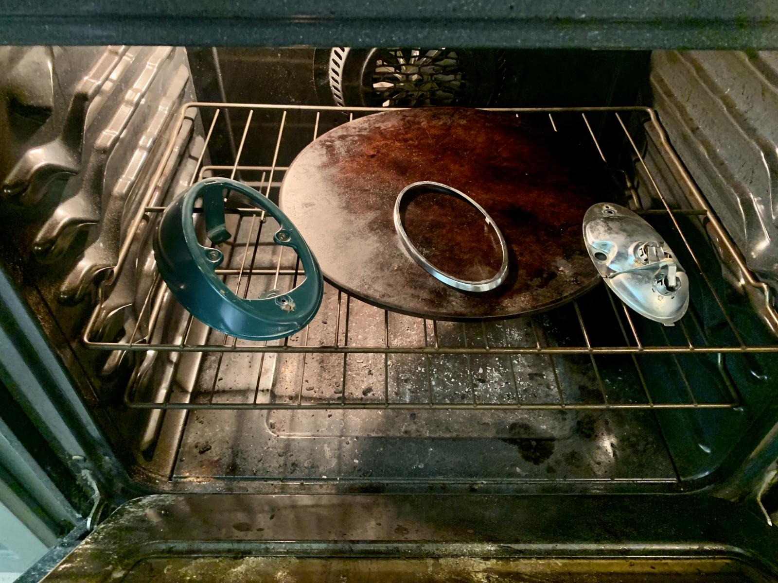

After a few rounds of magic eraser, soapy wooder, and a finishing compound, the fender area is cleaner.
What's cooking?
VW casserole!

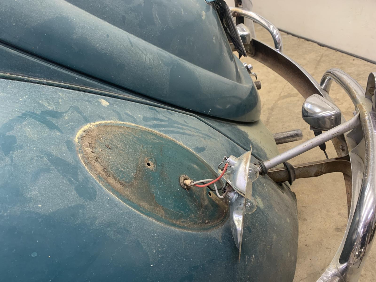

While I'm here, I reterminated the electrical connections with some standard AMP faston tin-plated brass terminals. This is what stock wiring terminals should look like, properly sized for the wire gauge and insulation thickness, and correctly crimped. The stripped end could be a little shorter. VW installed solid brass terminals, which are okay, but a plated brass connector is more corrosion resistant, with a very small additional cost.
I thought I already had all the seals and grommets in stock to reassemble the tails - nope, just the chrome bezel foamy seals! So I placed an order with Wolfsburg West, throwing in their gray front rubber floor mat for good measure.

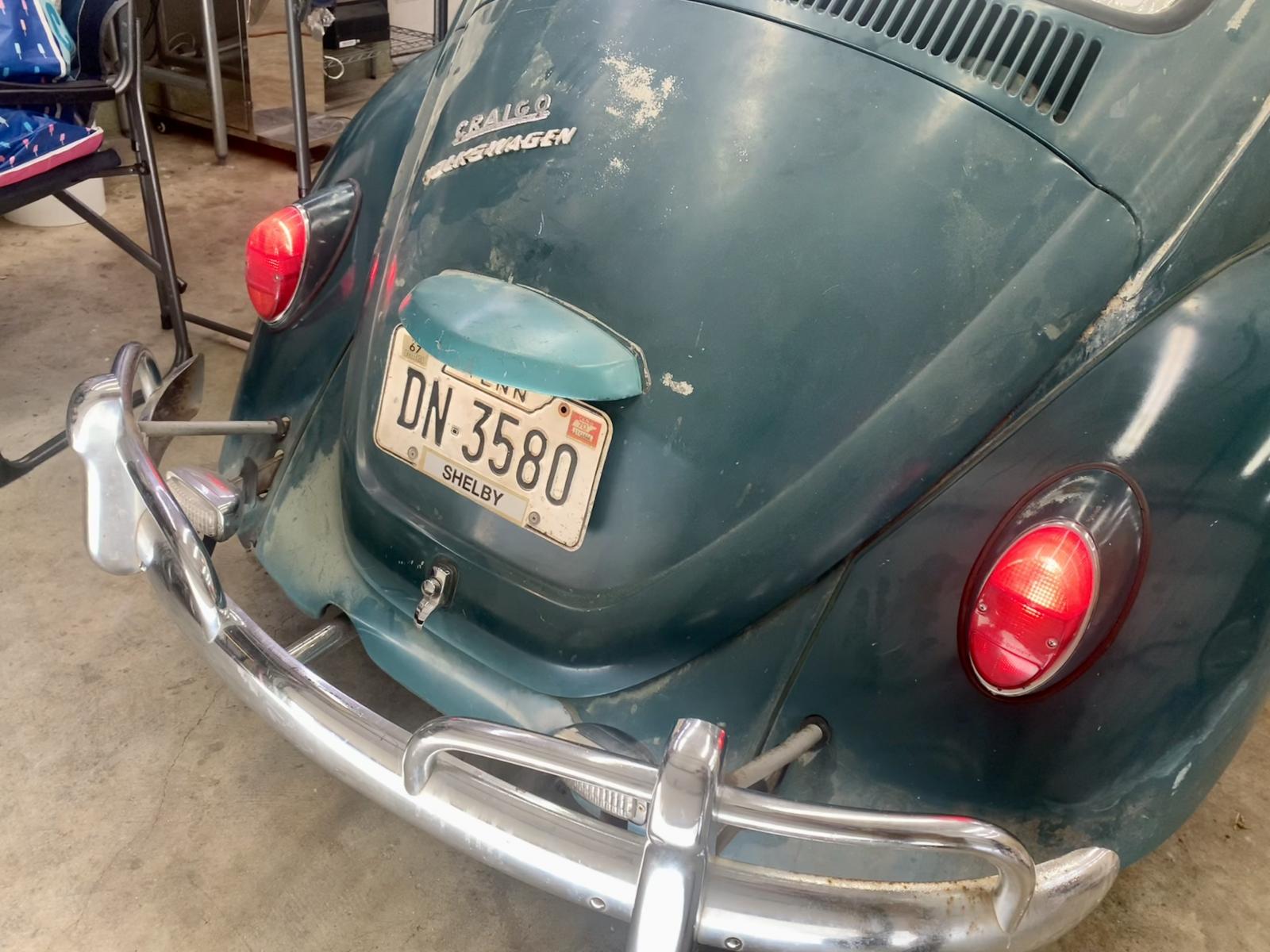

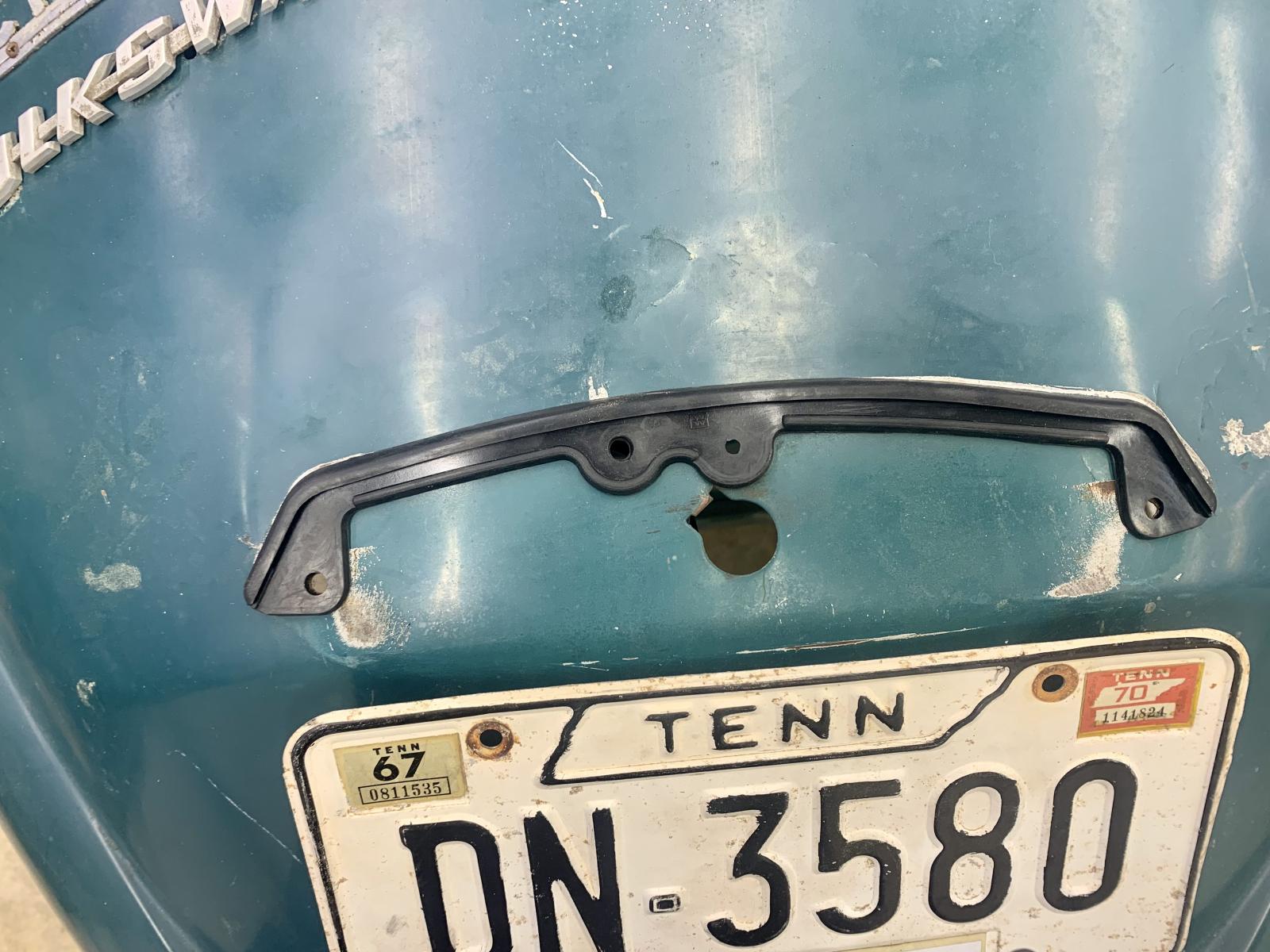

Got the tail lights all wrapped up with the new Wolfsburg west rubbers! Their “multipurpose grommet” does fit the wire harness hole but it’s TIGHT.
Those seals and the taillight rubber aren’t fully punched out for the wires to go through. This handy hole punch makes clean holes! I bought it for hole punching the floor pan and it’s been a great doodad to have around.

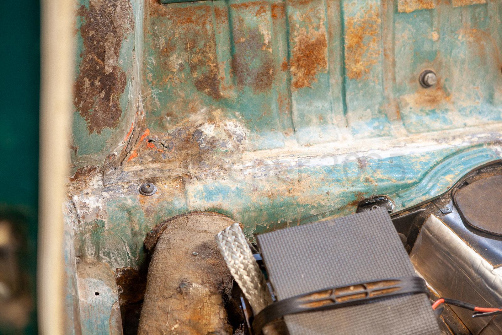

There's some rust in the bottom corners and on the luggage shelf that needs to be addressed. My 3M 08323 seam sealer showed up today to replace the brittle and crumbling factory VW sealer. It's supposed to be applied over a 2k sealer or topcoat, which means all the rust has to be removed and the bare metal will get sealed with my Summit Racing 2k gray epoxy primer. It's good stuff!
I used to work in aircraft fuel tanks years ago.. every rivet, bolt, screw, seam, and joint is sealed with special fuel-resistant sealants. When the tanks leak, I'd locate the leak inside, scrape back the old sealant until I found good dry metal, and reapply new sealant. It was not a fantastic job and I'm only now finding out some of the occupational hazards that happen with exposure to Jet-A, MEK, acetone, and the myriad other activators and parts of the sealant.
But! I gained a lot of experience that is relevant to the task at hand tonight.
Unfortunately as rust usually goes there was more to the eye once I started lifting up the chunks of VW sealer. The left corner at the heater channel has some significant problems that urgently need to be addressed
Most of the metal is intact, except for a small approx 3" section of the luggage tray lower crossmember. The design of this intersection puts multiple pieces of metal sandwiching into the corner of the wheel well without any seam sealer or other adhesive between the layers to stop capillary action. Any moisture thrown up by the tire sprays directly on this corner and the rust cell is hard to stop once it's going. I have a plan... but we're not going to be cutting and welding just yet.
The other side looks pretty good. There's corrosion, and more was under the seam sealer, but it's intact.
The factory paint is still solid in a lot of places so I hate to remove it. I just can't think of any other way to attack this area though, it needs epoxy and seam sealer to stop the rust from spreading as I put more miles on the car.
The best I can come up with is to wire wheel the majority of the lower package tray, abrade it with scotchbrite rolocs, and prep with phosphoric acid wash to dry up the pits I can't reach prior to epoxy. Spraying paint isn't an option at this stage, so although I don't prefer it, I'll have to brush on the epoxy wherever I expose bare metal.

aquifer wrote:
The process never ends! But that’s what I like about projects like this.
I noticed your front seat belts laying there, and I see that the plastic looks like mine, which is to say faded and dry. A friend of mine told me I could use a butane torch and heat up the plastic and it would restore the original color pretty well. He wasn’t sure if it would work on such old plastic, but he had done it on a newer piece that was severely sun faded, and it completely restored the plastic. I found YouTube videos showing how it’s done, and of course I believe everything I see online so I’m sure it would work. /s
Anyway, I’m tempted to try it on an inconspicuous spot to see what happens. You can try it first on yours and let me know how it goes. Very Happy
Are those OEM gazelle-colored kick panels I’m seeing??
I’ve heard of that plastic reconditioning method too! These lobster claws are going in storage though; I might try some heat and see what it does. I bet a heat gun would also work too.
Your car is pretty stock - do you still have the little plastic seat belt retainer clips on your B pillar? The Z-shaped plastic one? I just noticed I have them… well, I have the passenger side. The drivers side is missing. I’m going to see if a friend of mine can 3D print some replacements. Even though I won’t be rocking stock lobster claws!
Robert in Memphis
