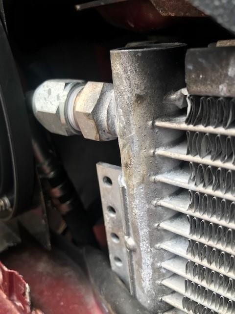

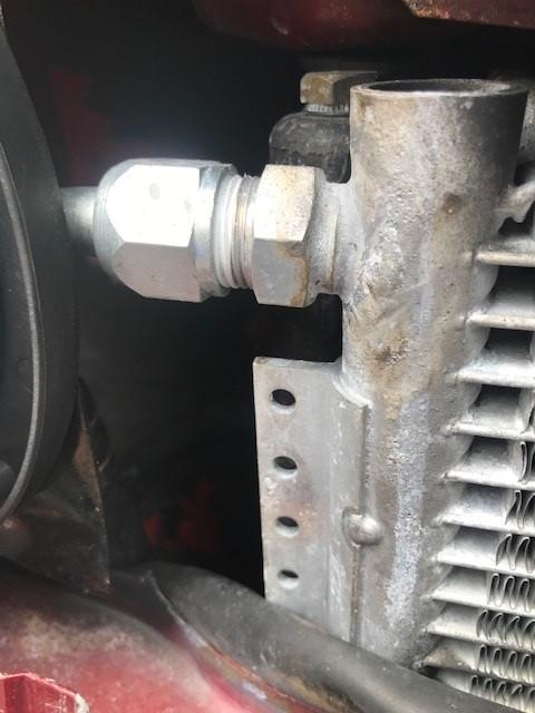

I have been completely rebuilding/refurbishing my 87 aircon with all new barrier hoses, EZ clip fittings, etc. I was looking for a new parallel flow condenser and inadvertantly ordered a 24x16...D'OH! Brick wall.
I routed my hoses to the PS, trimmed the flange for the fan switch, and was able to utilize the larger unit.

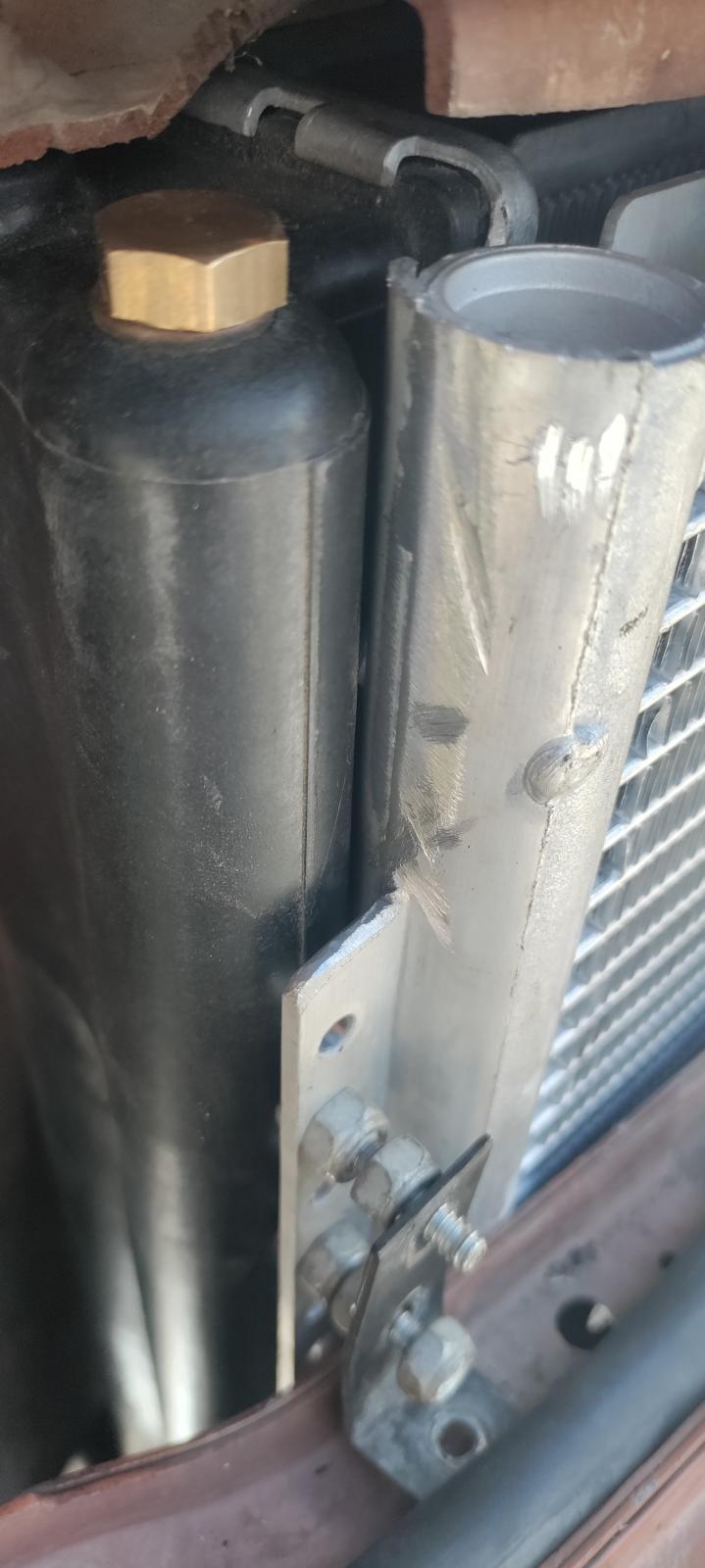

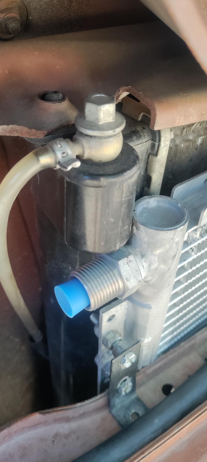

PostPosted: Thu Aug 10, 2023 1:43 pm    Post subject: Re: 24 x 16 AC Condenser Air Conditioning Reply with quote
It fits!
The 24*16 is a juuuust right.
Will button it up later. These pics are with a behr radiator. I have a diff brand where the passenger side is proud of the core only at the bottom and top. On y he e behr it doesn't look like any trimming is needed on the pass side. Yes, the radiator switch is close. Likely need to move the radiator back to replace.
Helped to bend the lower pipe to clear the steering box. This is an early AC, IIRC the later AC has a closer fitting so will likely fit w.o bend.
[/img]
Can you send a picture of the top connection?
I'm also going to flip my condenser with the fittings on the passenger side but the top fitting doesn't fit well against the radiator bulge.

PostPosted: Sun Aug 27, 2023 10:37 am    Post subject: Re: 24 x 16 AC Condenser Air Conditioning Reply with quote
Not the greatest pics. This one shows the angle of the dangle. I used 90* fittings.
This one shows the coziness of the radiator.
Hope they help.

big swifty wrote:
This one shows the coziness of the radiator. Hope they help.
Thanks, they do! Thanks for posting them.
How were you able to fit the side tube and still have the radiator in the top alignment pin?
What kind of radiator do you have?
I have a non-Berh so have only the bulge on top and bottom (the Berh has the bulge all the way top to bottom) - so on mine I was able to lower to get under it. With it up higher the radiator wouldn't align in the top pin. The fitting on the driver's side, it is not an issue with this bulge since just the mounting tab needs to clear.
Another solution may be to tilt the radiator back by inserting a spacer on the bottom mount tab between the tab and the frame and use longer bolts. That angle may allow for the clearance needed between the radiator bulge and the front center body horizontal beam....I didn't try this so just an idea.
