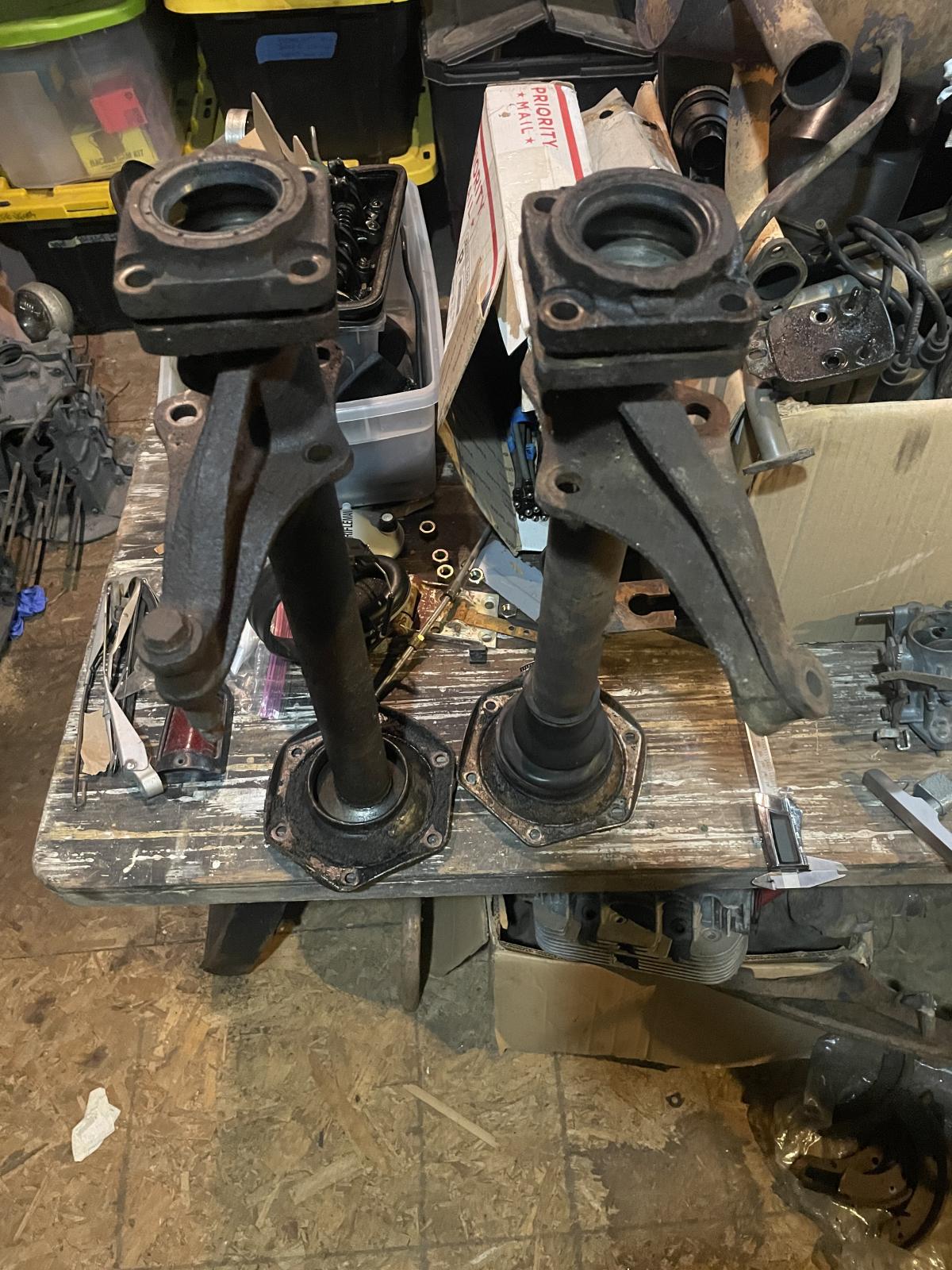

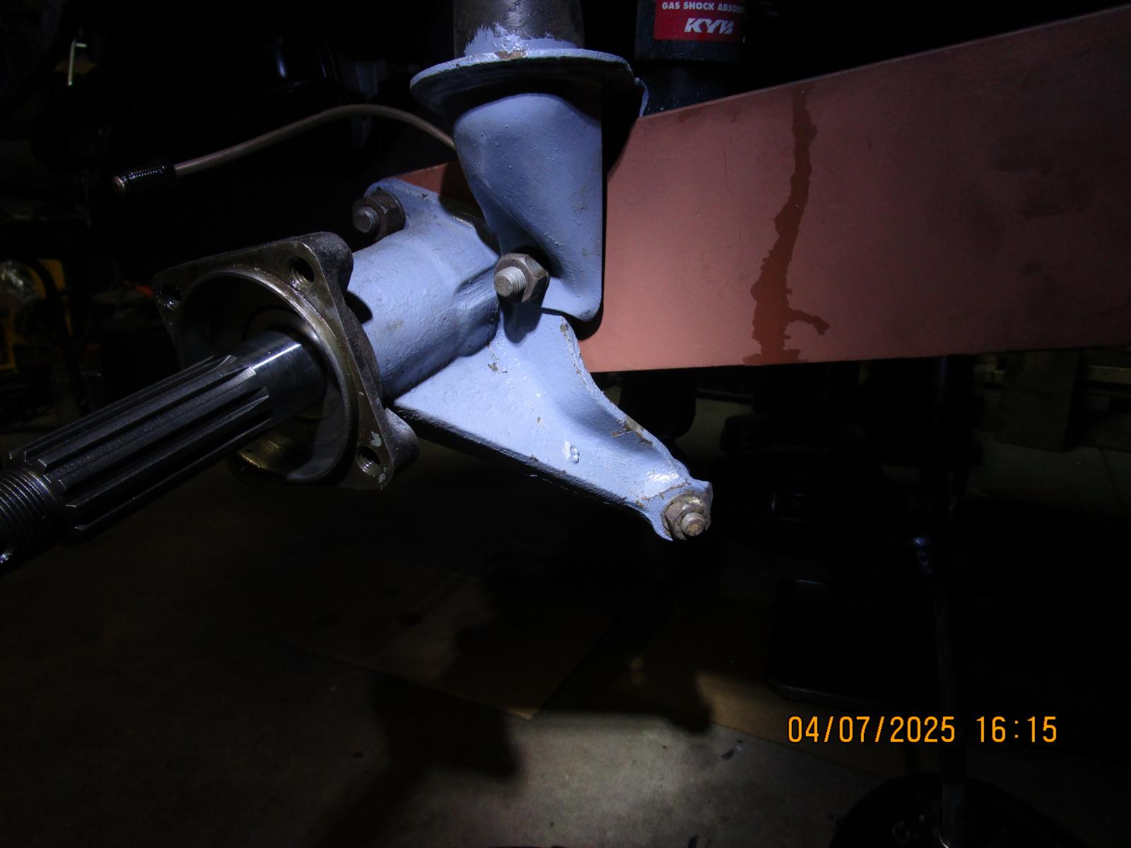

It sounds like a mismatch of parts. From what I can see you have Oval window axle tubes. (There is no twist in the shock connection point.) makes me wonder what the bearing cap looks like.?
Also, bolt the cap onto the axle housing without the plate and measure the gap for the plate. Is it too big?
Those are the first things that came to mind. Not sure if any of it will yield anything, but ??????
Good luck man!
Edit; here is a picture for reference. Later tube on the right.

I have the twist. Will mount the bearing cover tonight and measure the gap.

VW_Jimbo wrote:
JEdit; here is a picture for reference. Later tube on the right.
I would point out there is one other variation, between the 2 shown. There are strait shock mount axle tubes that take the bearing caps shown on the right. Most 1958 Bugs and early 1959 Bugs had that style.
