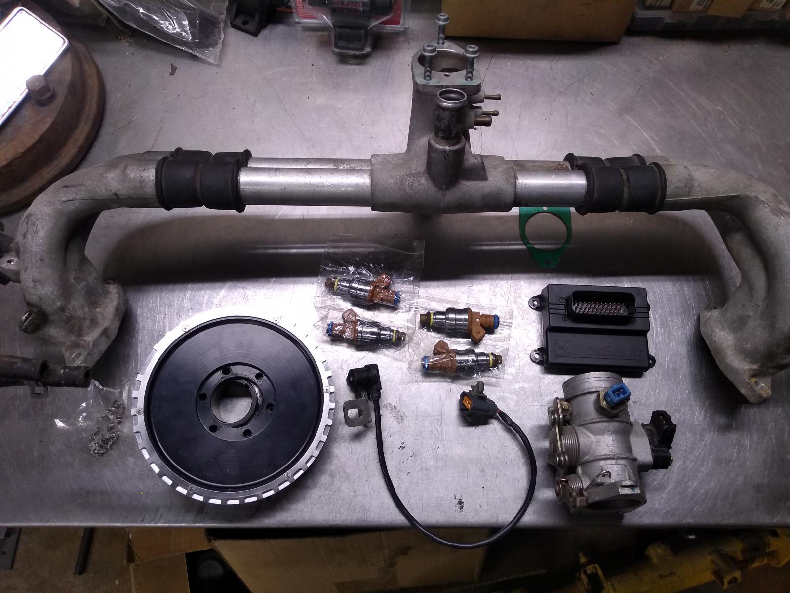

Tell me more. This looks completely different from the Sniper. Injectors at the end castings. Just emailed them for more info.

The main difference between the stock VW EFI setup and Jim's Honda like setup Vs. the sniper stuff is the injectors in the end castings, and this is 100% what makes the difference in drive-ability.
Not sure if you have ever tried to drive a VW with a stock center mount in cold or even cool weather with little or no manifold heat, or a heat riser, but they suck. They run super rich, they make crappy power, and they tend to flood themselves after shutdown. Google latent heat of vaporization.
Same exact problems occur with ANY system that adds fuel 1.5 feet away at the entrance rather than right at the end of the manifold. With the center mount EFI, the computer will just keep running in circles trying to add more fuel to keep it alive, but then pull fuel out because its running so rich.
If you want it to drive like a civic, copy exactly what Jim did. He knows his stuff. I would warn you, it will take lots of tinkering on your end after the install to get it dialed in. Then when you leave town and change elevation, you will need to get out the laptop, and start tinkering again. After a few 1000 miles and lots of elevation change testing you will hopefully have it pretty close to dialed, but don't be thinking it will drive like a civic on the first trip around the block.
I am not trying to be a total downer, but after my VERY expensive EFI install, and a 3500 mile cross country road trip with it, I would have rather had a pair of dirty, half worn out kadron's on my 2332 for that trip. I too thought it would be all unicorns, fluffy clouds, perfect drive-ability, and fantastic MPG, but it was none of those things for me. It was more like get the laptop out at every stop, read data logs, make changes, hope it works..... Maybe I had too high of hopes.
I ditched all of it, and went back to China 44IDF's. Now I am back to worry free driving, super simple trouble shooting, better throttle response, and equal or better MPG. All for about $3500 less.

PostPosted: Fri May 16, 2025 11:29 am    Post subject: Re: building a 1914, fuel injected daily driver. need info Reply with quote
So if a sniper setup costs $2000 and I could get the same performance out of a $500 carb setup, but keep my clothes smelling fresh and keep my wife happy (provided I don't tell her about the $1500 cost for her happiness), then I'm good with that! Very Happy Very Happy Very Happy

PostPosted: Fri May 16, 2025 12:32 pm    Post subject: Re: building a 1914, fuel injected daily driver. need info Reply with quote
The converted Mex system is an entirely different ball game as the injectors are placed just above the cylinder heads, as they should be. for milder engines it can be a nice set up. There is till the same performance limit. Not quite sure where it is, but somewhere around 100 hp. However, there is still the price tag. With the converted Mex system there is also a real option of improving fuel efficiency. i have never messed much with them, but I knnow people who has, and they have been able to reach very impressive overall figures. but, once again, it is not something you do in an evenings time.
Now, IMHO the 34 Solex, - and its modified sisters (37 & 39) are vastly underrated and misunderstood carbs. I will agree that on a 1600 displacement they - can - be a bit of a challenge to get to run right if you are not strict with your build. But on say a 1776 or a 1914, coupled with a better center section, the picture changes complestely. If you maintain a decent manifoild heat as well as proper pre heat to the aircleaner (Not necessary if you live in Ca or Texas or similar) and and make a couple of small changes to the carburettor it can run flawless, also during cold start and warm up.

PostPosted: Fri May 16, 2025 5:56 pm    Post subject: Re: building a 1914, fuel injected daily driver. need info Reply with quote
I don't know how meaningful this data point is, but that perfectly serviceable engine tuned like a Japanese economy car is under my garage stairs, and I have $400 worth of EMPI carbs stacked on the engine in my car now. Laughing
Without going EFI with ITBs, you do hit a wall around 100hp with most of the popular intake parts, and really if you go center fueling and don't have port injection, you sorta lose the other benefit. In summary, I don't think I'd go Sniper or similar unless it was also gonna have a fat turbo. Very Happy So in keeping with Samba tradition, I'd suggest you get a 82mm crank, trade for B pistons, and do the sniper but get a turbo exhaust and boost it. (lol perfect Segway from him being curious about EFI options on a mild 69x94.)
