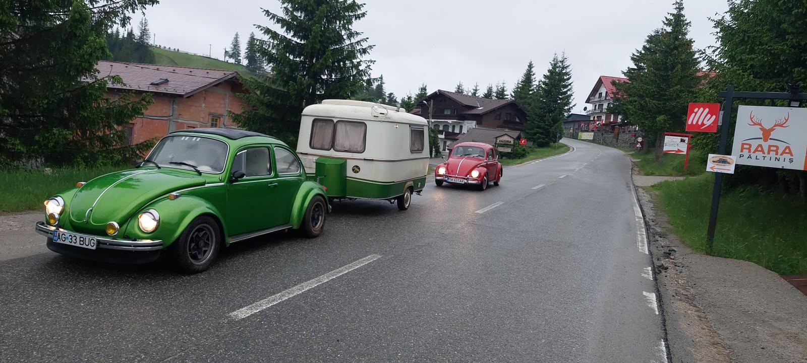

PostPosted: Tue Jun 10, 2025 4:33 am    Post subject: Re: Cipica, VW 1303S from '74 Reply with quote
600km round trip this weekend, to a meeting called "BusStock and American Shine". Well, more Bugs than american cars, ane many campervans, not only VWs. Very nice event, family time, old friends, good weather.
It ran very well, we had several steep roads. Mostly I could even do 50km/h uphill in 3rd. The last pull was 1000m altitude difference in ~20km or less, up to 1400m, and here it was 1st and second mostly. . She could not pull the caravan on the very last slope (200m away from the campground), which was extremely steep, gravel road, which I did not foresee and did not have enough momentum. I tried to start from that incline, I only moved it 2-3m more and cooked the clutch disk (just a bit, it still runs ok). Some guys with a new van came behind, they had towing hook so we moved the caravan to their car and arrived safe.
Oil temperature: only when going to the meeting, around my home, there were 35 deg C outside and on one slope it went up to 105 deg C. Then we started to go down, temperature outside dropped below 30 deg C and oil went immediately down to 95 and it stayed there. So, avoid driving in high temperatures with caravan behind.
Conclusion: finish that damned type4 that sits in the livingroom since 2018.
'74 1303S, L98B Viperngrun (extra glitter), German Look
