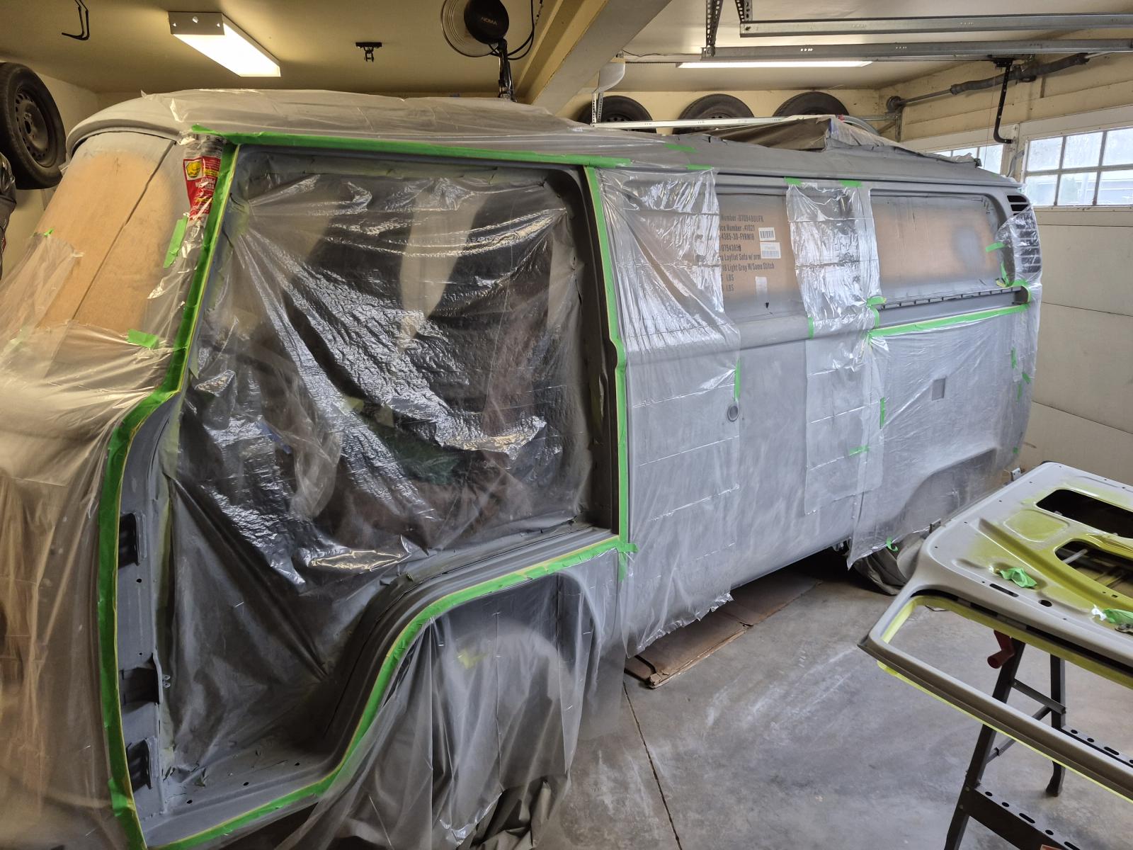

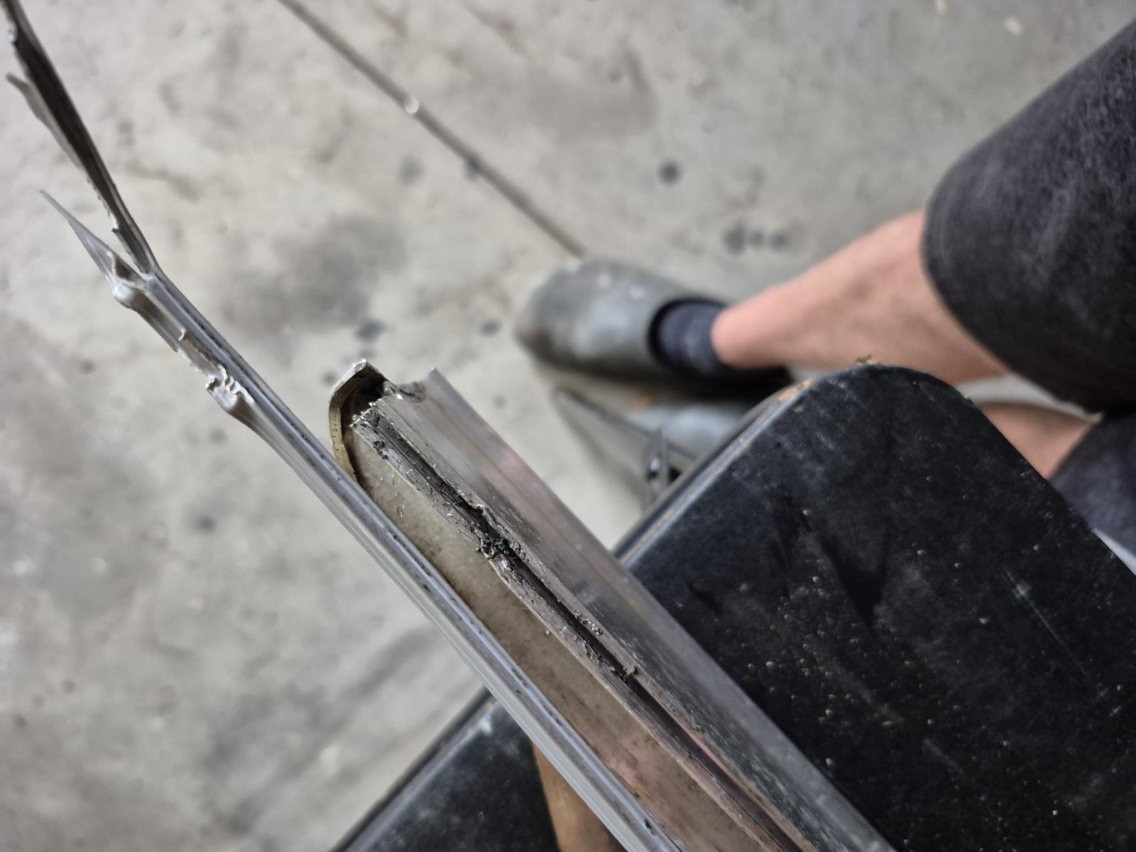

So, I did bite the bullet and cleaned up the original side cover tracks. They weren't too bad, the window frames where they were attached were actually in worse shape. Sprayed them with epoxy and 2k and welded them back on.
I put some seam sealer along the top where the track and the body meet. Hopefully this keeps water from getting into it again.
400 grit sanding was a PITA. Shoulder is done, but I got through it, touched up a few spots where I burned through and then did the same with the 600 grit.
Bagged and tagged for door frame and inner door spray

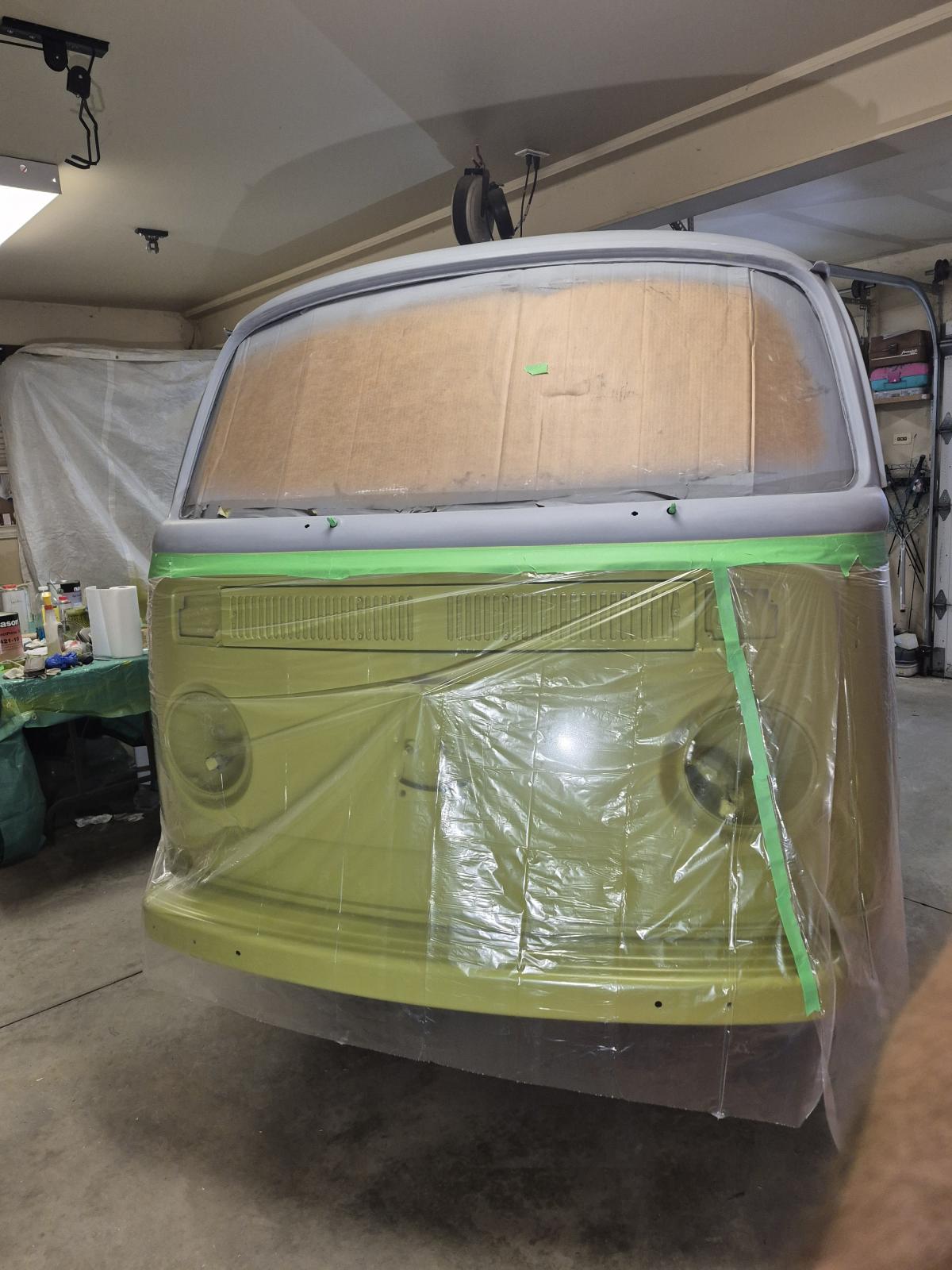

First spray of original VW Sage Green

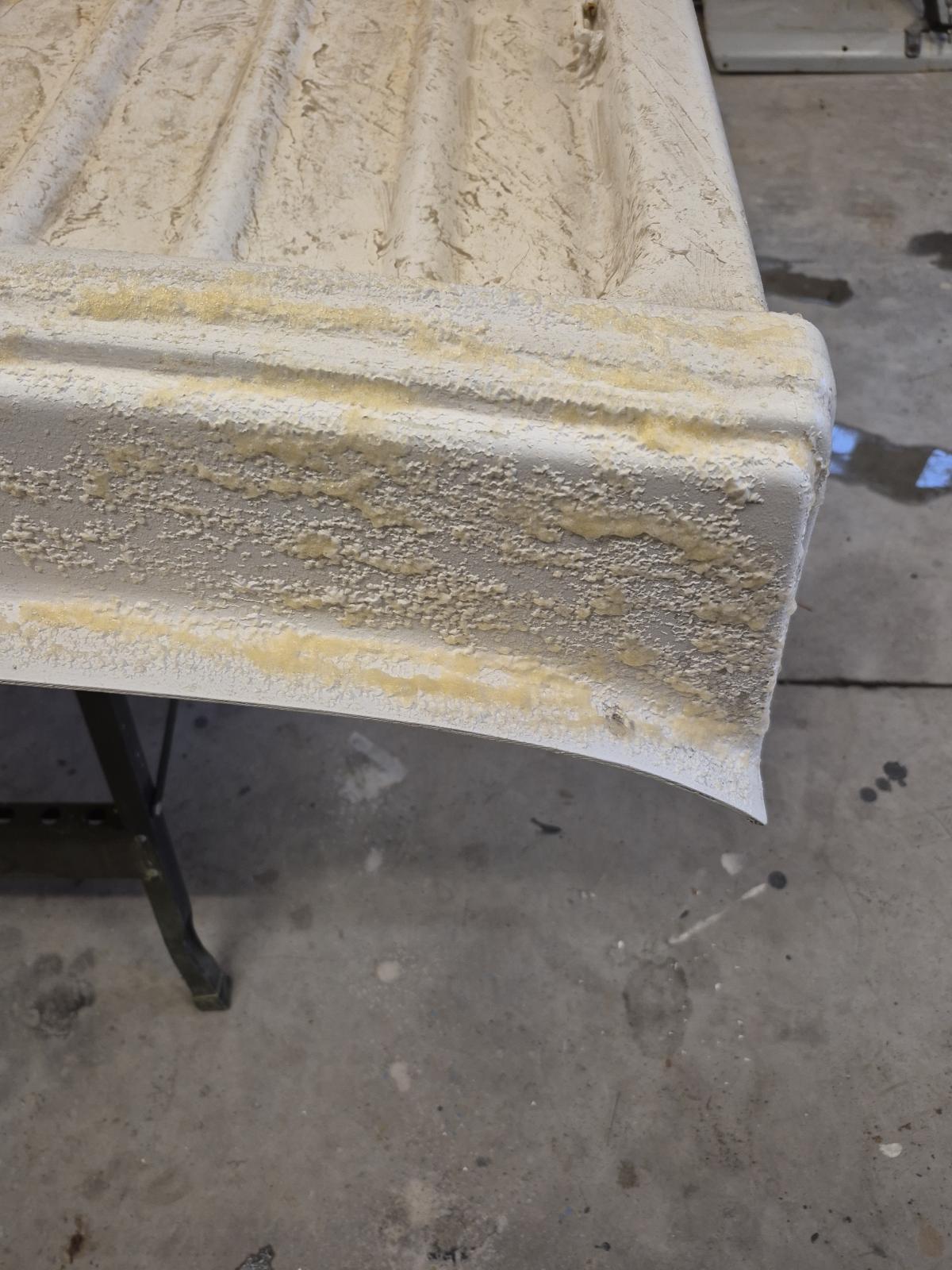

Pretty happy with it, a couple of runs, but I will be more careful with the exterior spray. I also picked up the original VW Chaulk White for the roof. I had painted it a few years back with Rustoleum white, so I guess I'll be stripping it down again so that the single-stage will adhere to it proper. Making more work for myself...

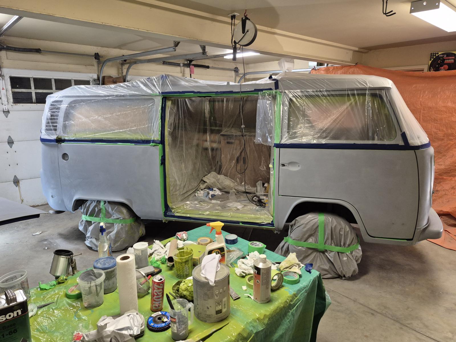

Are you going to replace all that plastic masking before paint ? There's a reason body shops use paper. Upon spraying next to that painted plastic the wind shaking it can release paint flakes all over your fresh paint. Just saying.

Hi Dan - Yes, I did experience some flakes during the primer phase, so it will be replaced for paint.

plastic for auto masking has a treated surface so the overspray sticks to it,and will not be blown off into your paint ,regular plastic don,t have the treatment and the dried overspray will flake off.

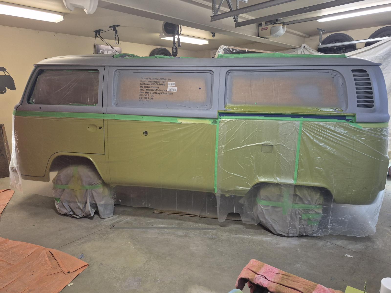

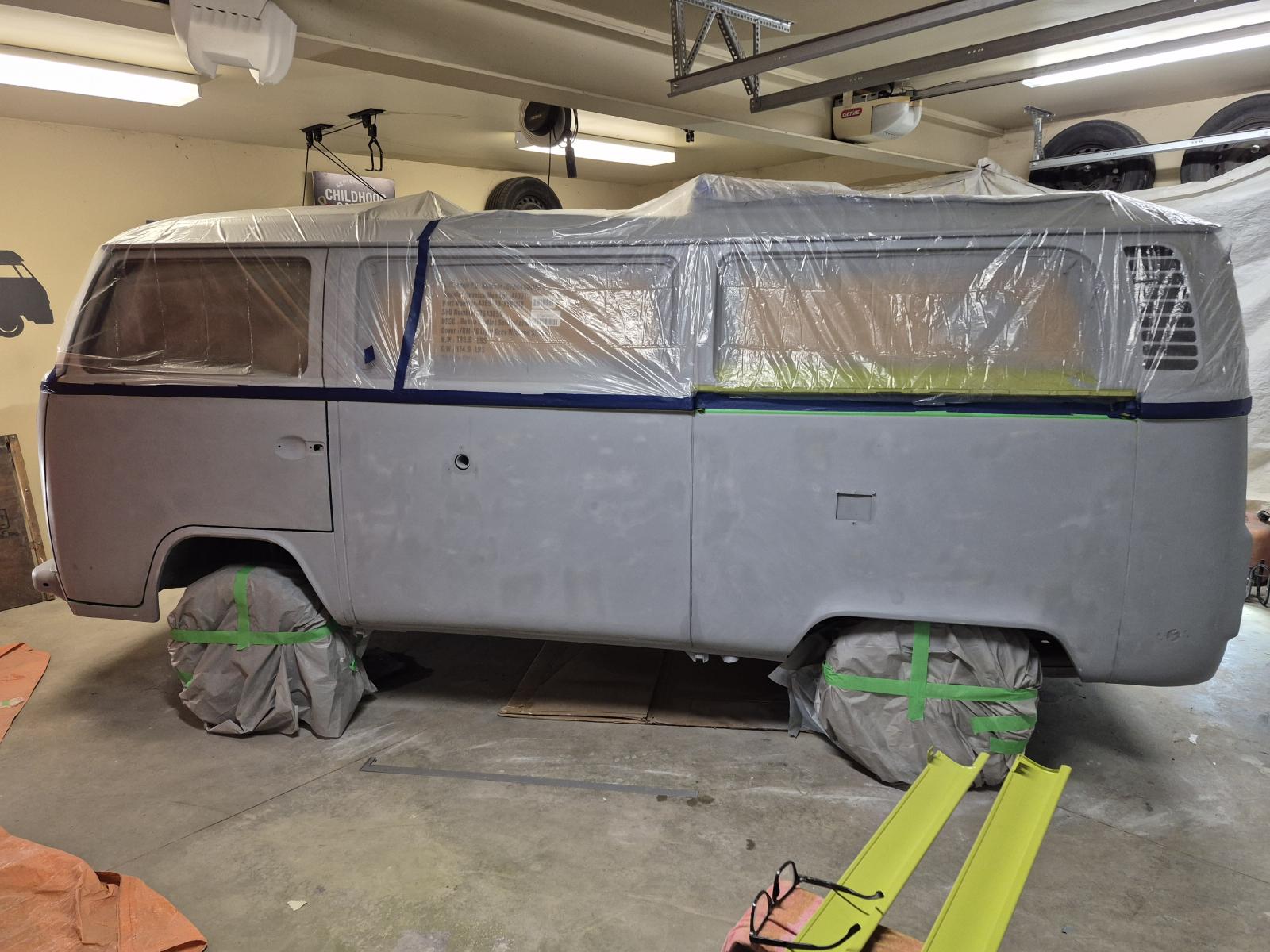

Progress update; I am not a painter... yet...
I started with the bottom, as it was the harder tape line and my next tape job is easier and could potentially fix any issues from the first.
Poured up my Sage Green, although I feel like they should name it $$$ green, because that @#$% ain't cheap!
Two coats, no real issues to report, a couple of runs, which I guess is normal considering this is my first time.

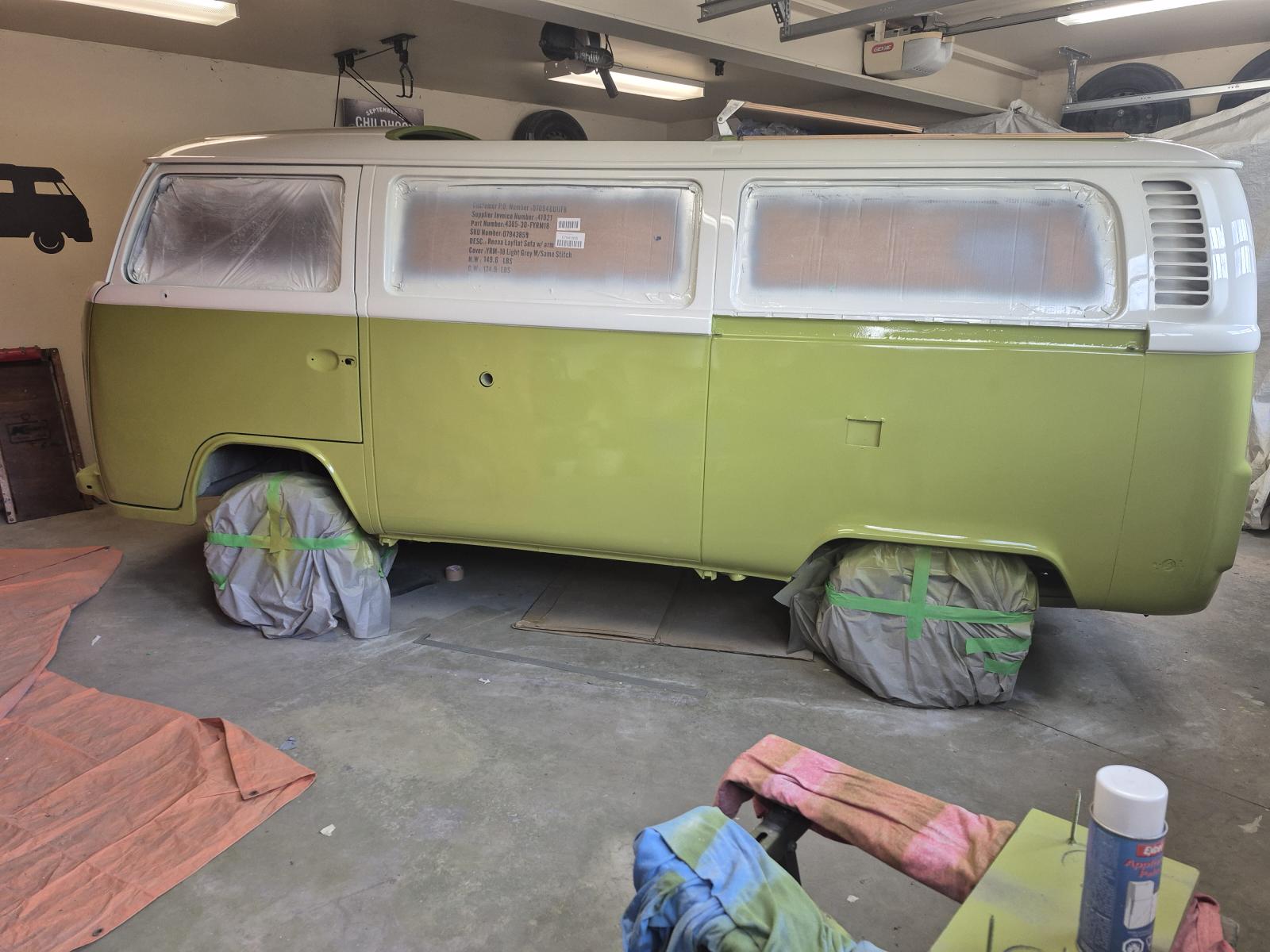

Next tape off the bottom:
And Chaulk White goes in the gun:
So, FYI, spraying in tight, hard to reach or small spaces is tough. So many runs, it's not even funny. I've been looking into fixing runs, but decided I will move forward to meet my deadline and can always go back later to try and fix them, or save some cash and pay someone to fix them Wink
Tape off

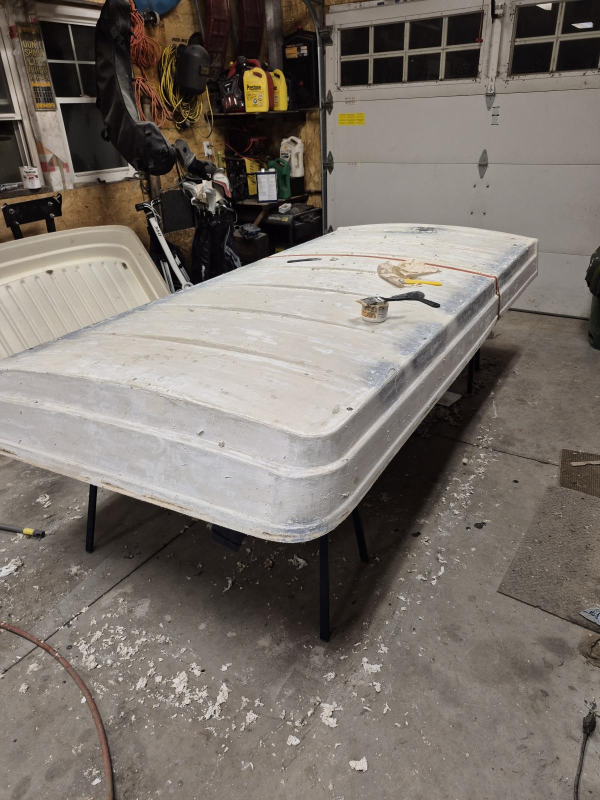

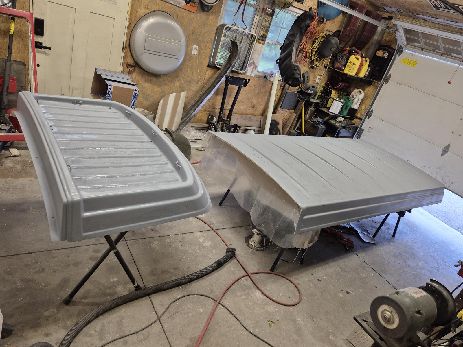

Deja-vu as I strip the top... again
Got it in 2k primer last night
Sand it and shoot it white this week and we're off to the races. Still have to get the bumpers sprayed, but reassembly has already started. Finally the fun part...

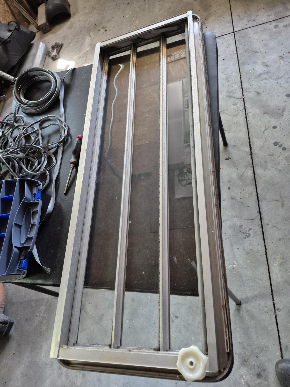

Well, I started on the refresh of the jalousie windows. The only really difficult part seems to be the pinches in the tracks that the rubbers have to slide/lock into. Anyone have an effective way of reopening these pinches without too much damage or warpage to the aluminum?
