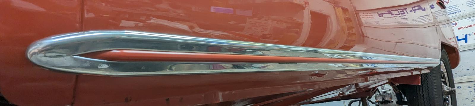

PostPosted: Sun May 18, 2025 10:28 am    Post subject: Re: What did you do for your Bus today? Reply with quote
I polished and installed the rocker trims, and the WCM trim insert matches my paint perfectly

PostPosted: Sun May 18, 2025 5:26 pm    Post subject: Re: What did you do for your Bus today? Reply with quote
Thom,
Your trim came out awesome... I'm just getting ready to do mine. Can you share your technique?
Also, sources for chroming are becoming far and few between... who did you use?
Thanks!

PostPosted: Sun May 18, 2025 7:37 pm    Post subject: Re: What did you do for your Bus today? Reply with quote
I bought a bench polisher on amazon, a couple of wheels, and went to town. There's lots of online resources for this. I bought a two-speed unit, which was a good idea in hindsight, as it's easier to handle the smaller pieces at the lower speed.
I used Sherm's plating here in Sacramento. I've also used Ogden chrome in Utah, which specializes in 'mail order' chrome plating, but you really have to be on them about the quality. They destroyed a set of Type 34 door handles; luckily I had a spare set and they re-chromed those for free.

PostPosted: Tue May 20, 2025 9:29 am    Post subject: Re: What did you do for your Bus today? Reply with quote
Buskraut wrote:
I need a process aggressive enough to remove some light pitting, and then work my way up to the beautiful shine you have.
You're probably better off wet-sanding with a progression of 400/600/800/1000/1500 to handle the pitting. Start with the higher grit, if it's not working, then move down a grit until you start seeing results, then work back up. Rotary buffing is not going to remove pits unless you use a very aggressive compound. Remember, you're ultimately removing material to smooth out the pits.

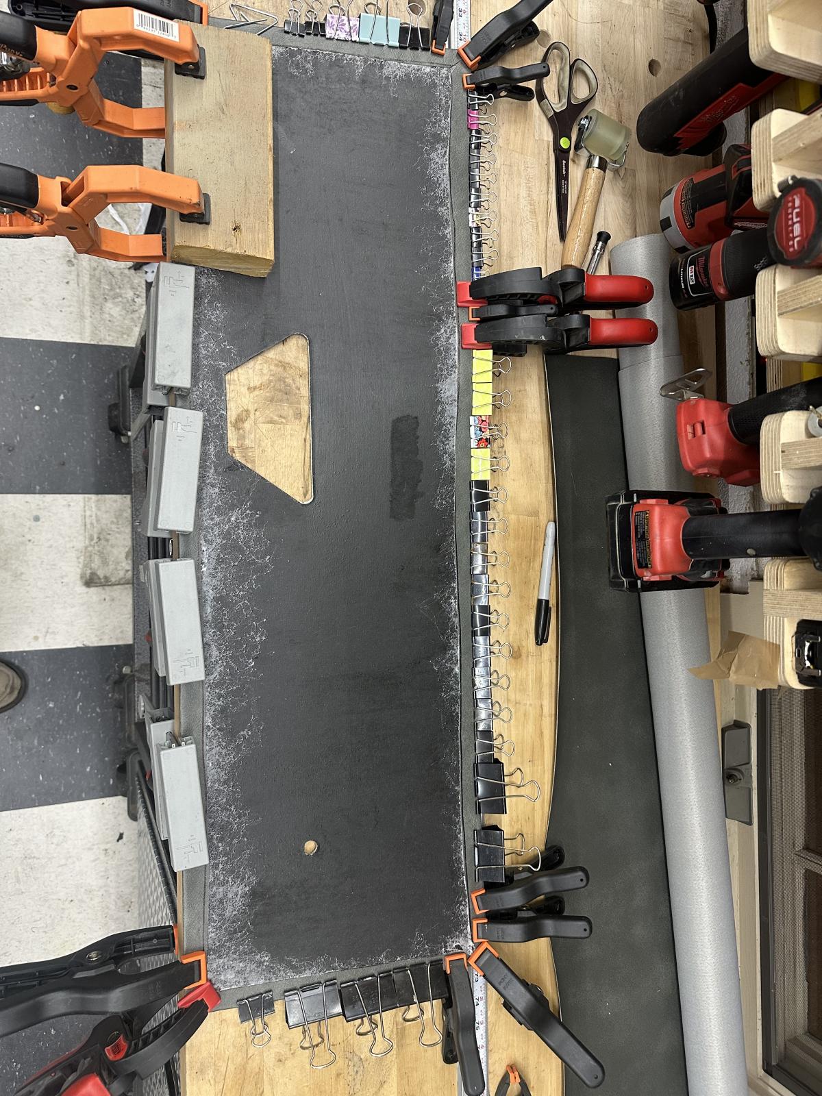

PostPosted: Tue May 20, 2025 9:53 pm    Post subject: Re: What did you do for your Bus today? Reply with quote
Glued some vinyl on the rear quarter panel. Yeah, yeah, I know stock was painted, but IMHO the vinyl looks good and should wear well. Went overboard on the clamps because I hate puffy edges. Next is to add some piping.
