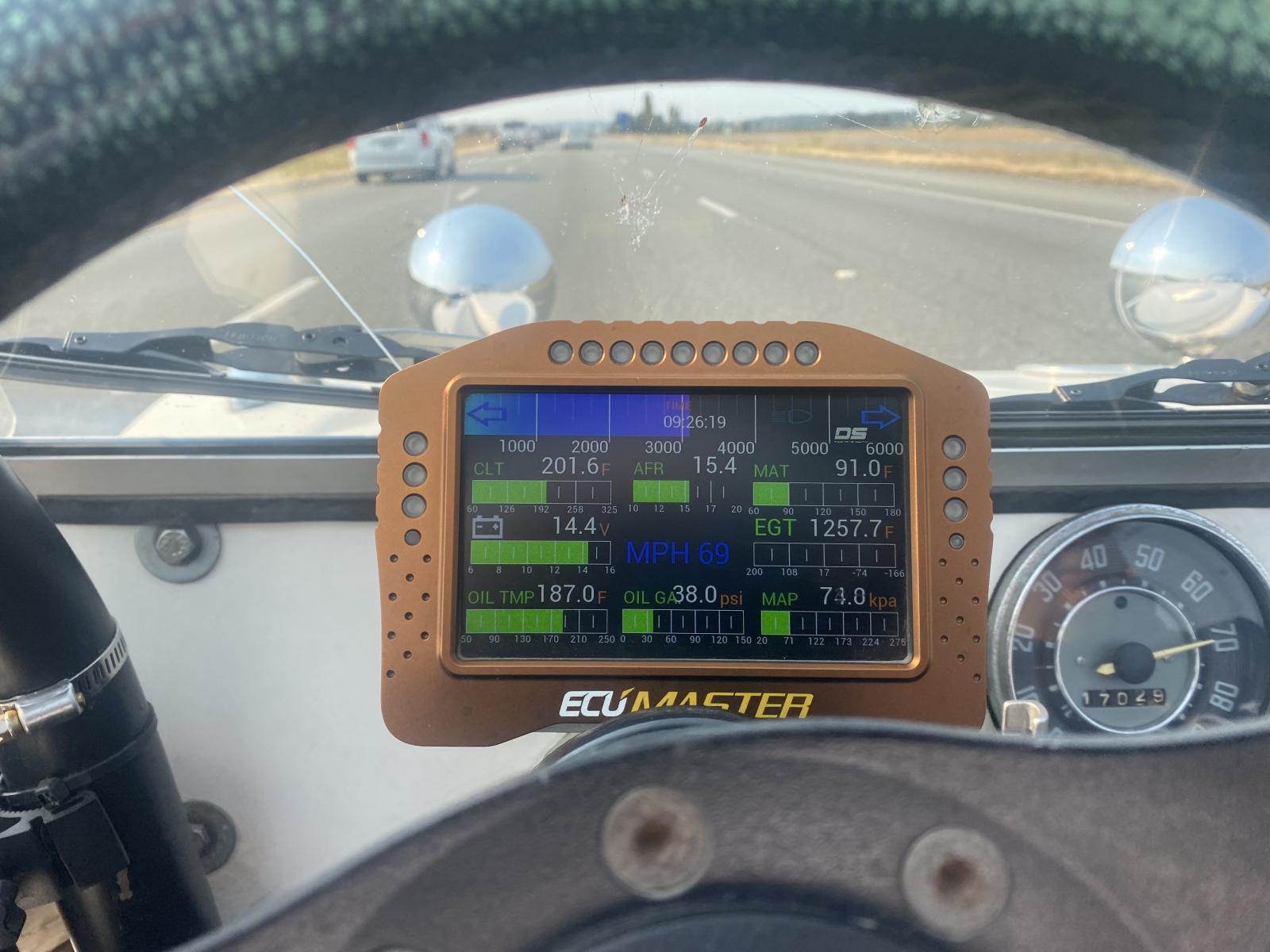

Here is my digital dash with real time info.
Top right is MAT......that is my intake temps while cruising at 69 mph.
There's two ways to look at the bit of info.
1.) Some warm air is recirculating into the intake from the engine and off the exhaust pipes due to my filter placement.
2.) It warms the air for better atomization if it was a carb removing the need for carb heat. The turbo accounts for about 20* F. of intake heat since ambient temps were probably around 70* F.
1.) Some warm air is recirculating into the intake from the engine and off the exhaust pipes due to my filter placement. Thats a smart thing to do on an engine your trying to keep IAT’s down on
2.) It warms the air for better atomization if it was a carb removing the need for carb heat. The turbo accounts for about 20* F. of intake heat since ambient temps were probably around 70* F. Again, smaaart….
