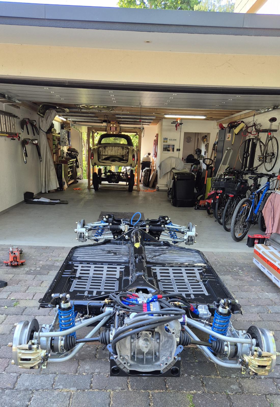

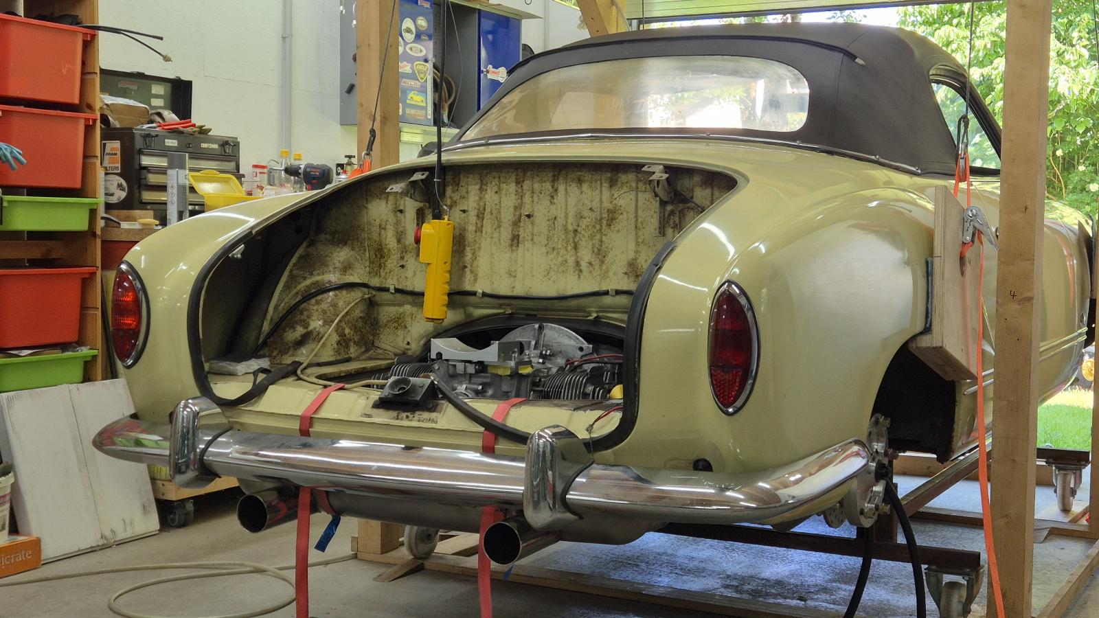

Time for try on... I need to check out a couple of things with the body in the chassis.
BTW these extra attachment point make excellent locator pins for lowering the body to the chassis Wink

What he said! I have never seen a gearbox with external filtering and cooling like that. The whole chassis looks amazing. I can't wait to hear how it handles compared to an original, it really is state of the art.

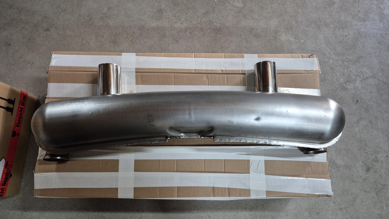

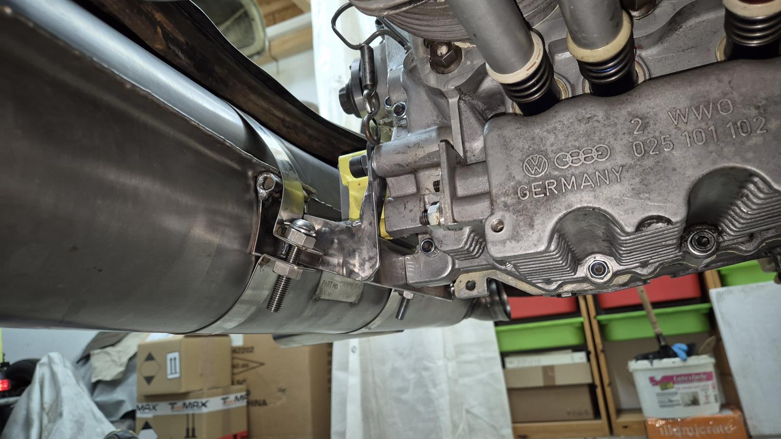

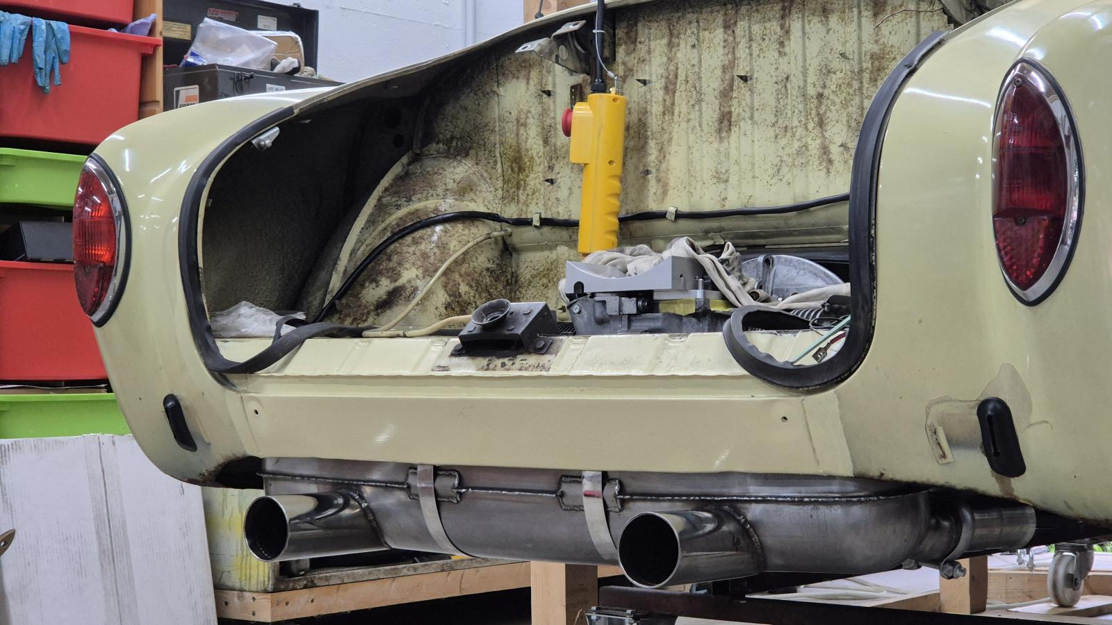

Looking for an exhaust that is somewhat quiet and yet does not compromise the power of my 2.6 or 2.8 OXY. I opted for a Porsche 911 sport muffler in street version from Cargraphic.de
First try on:

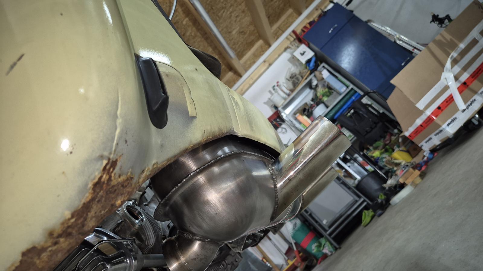

Another custom bracket Laughing

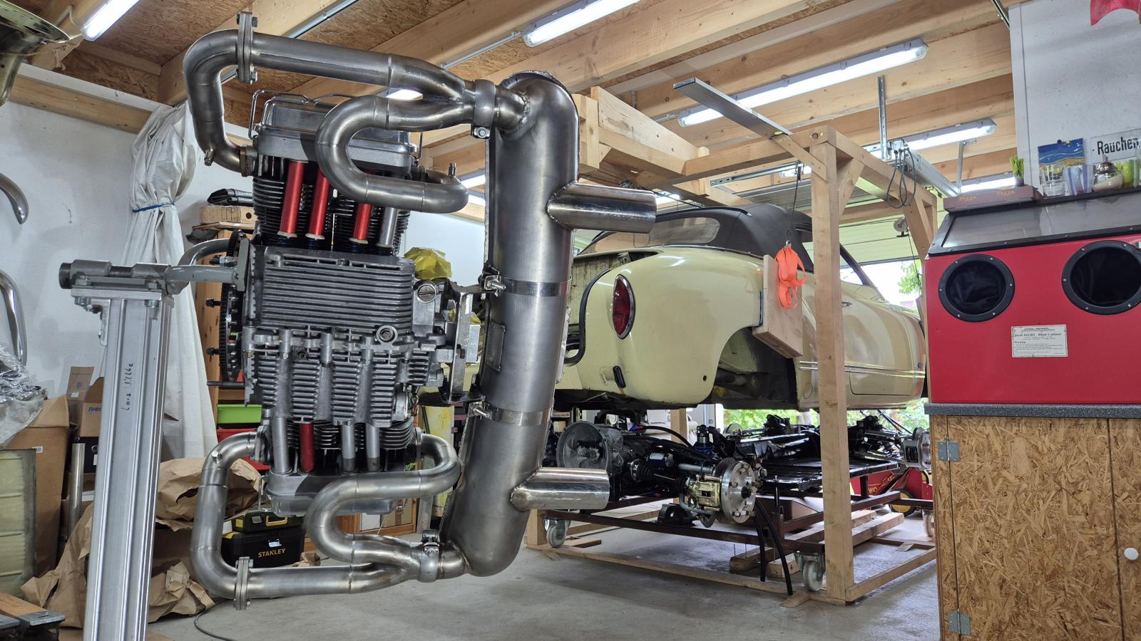

... assembled to the motor:
Fits great! imo Very Happy

that porsche muffler is a perfect shape for the back of a Ghia!
the bracket is a bit like a T3 Transporter. well done

PostPosted: Mon May 26, 2025 7:09 am    Post subject: Re: Ghia coming home Reply with quote
Wow, that is a perfect fit!

Did you know beforehand that the curvature of the 911 muffler matched the curvature of the Ghia's rear valance so well? That really looks like it could've been made for a Ghia, the fit is so perfect.
It's amazing how well it matches the body curvature, isn't it...
I have been playing with the thought of using a 911 muffler for some time and tried to fit an original 911 unit, I borrowed from a friend. It was extremely tight and was about to look for something else. I gave it one last try and called Cargraphics, manufacturer for high quality sport mufflers. The where very! helpful on the phone and offered to send me one of theirs for try out. It's the one I have bought and installed now. The curvature is exactly the same as the 911 stocky, but overall a little smaller, making it the perfect fit.

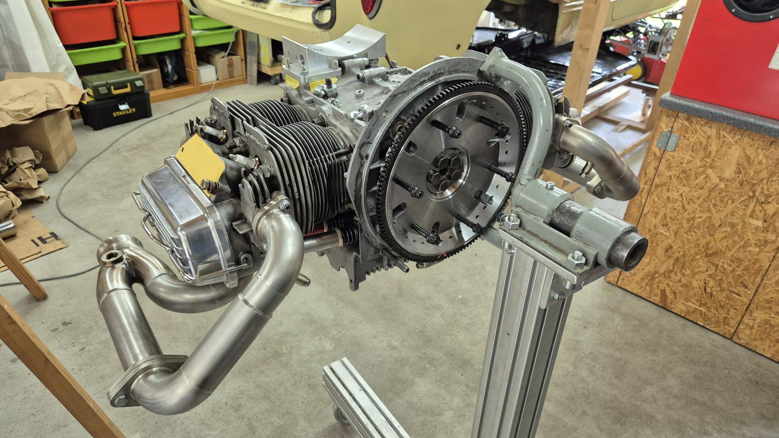

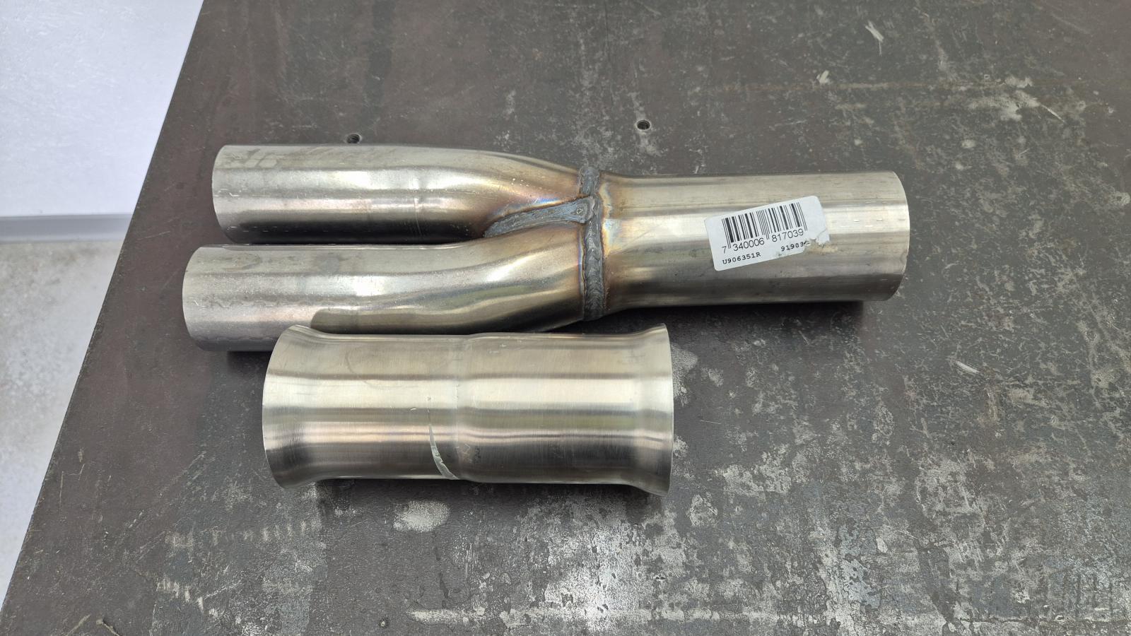

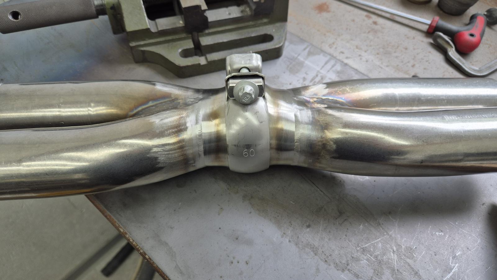

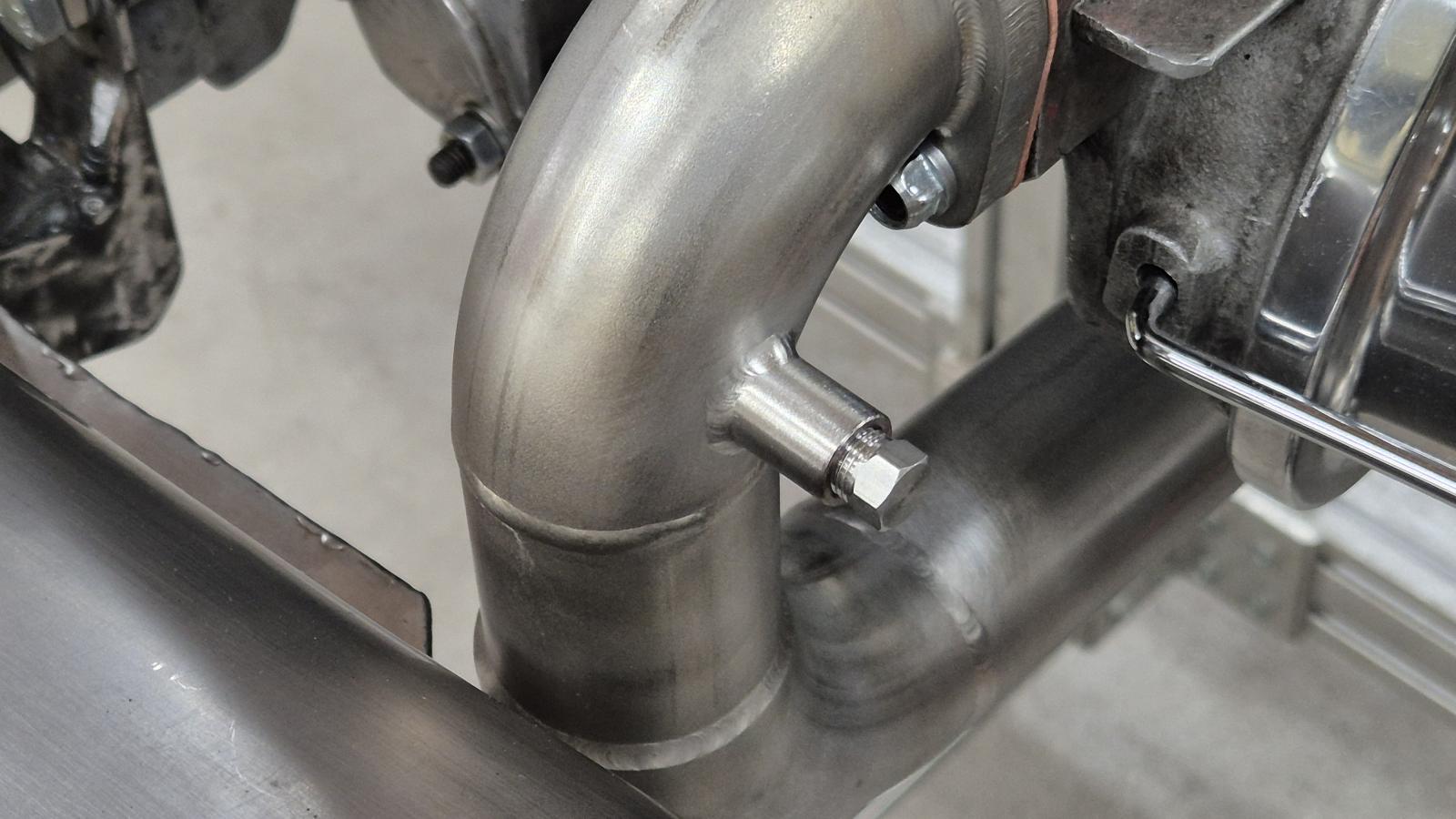

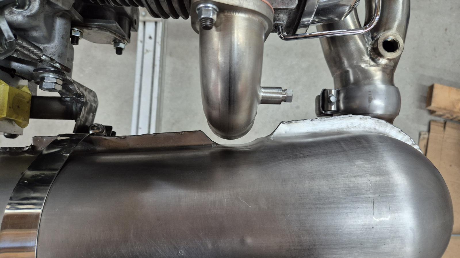

Tobi from TMR https://tmr-performance.de/schweissen/ came over to do all the welding for the header. For you guys living in Germany and near, call him if you want something welded. His work is extraordinary!!! just check out below pictures.
Connection from the 2 into one onto the aeroquip muffler fitting took us a lot of effort, grinding and forming:
Connected for forming and welding:

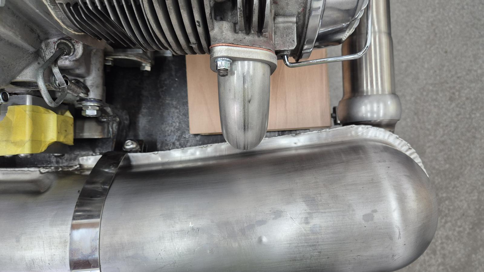

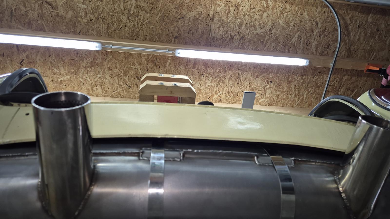

Only problem using the 911 muffler:
...and solved:
Everything was welded using forming gas (is this the correct term? )
[mg]https://www.thesamba.com/vw/gallery/pix/2593532.jpg[/img]

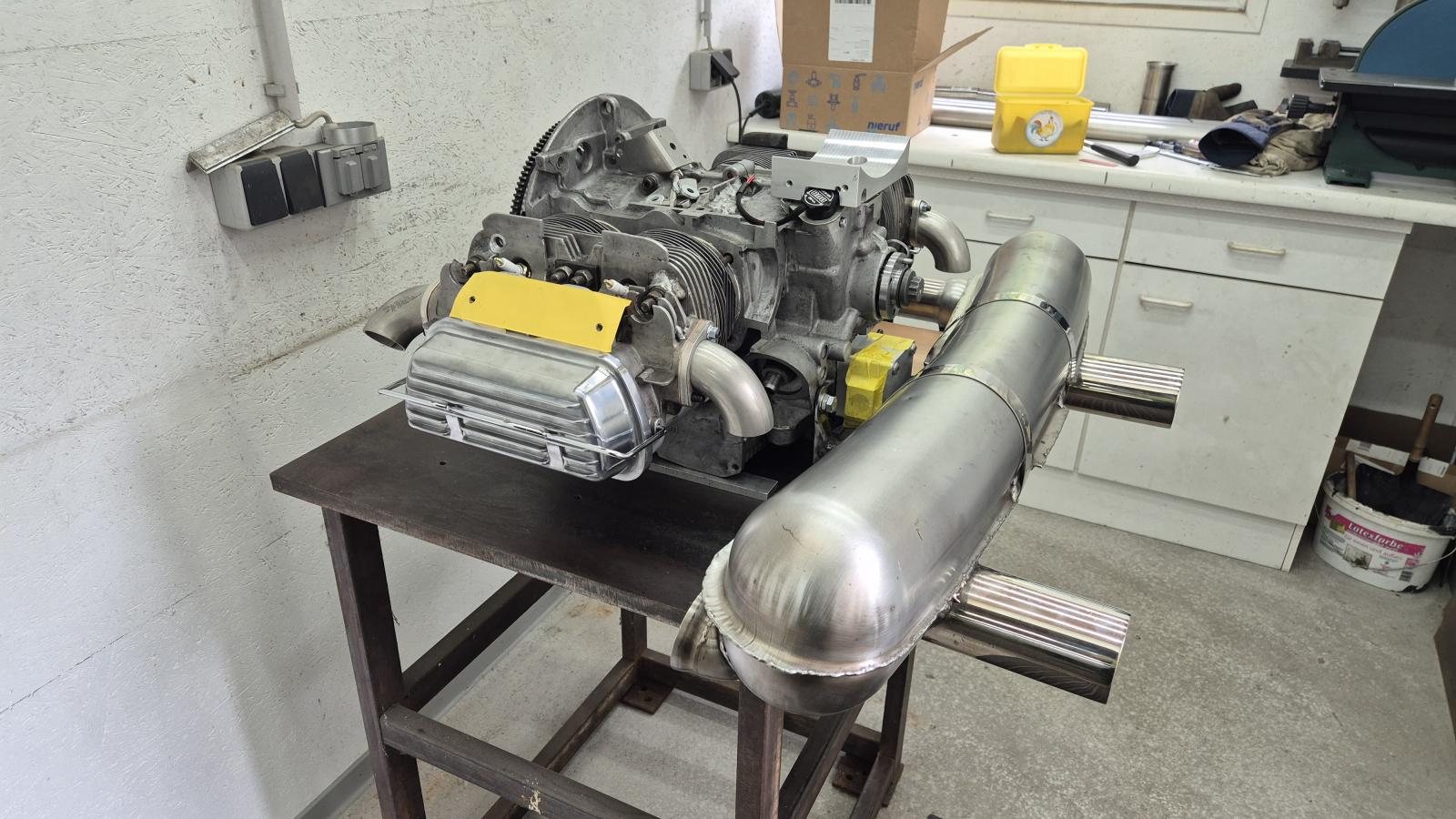

After 18!!! hours of intense work:
Technical details:
Step header, 2x 45mm into 48mm into 51mm into 64mm collector into muffler. Internal tubing 64mm and 2x baffeled exhaust tips 64mm.
We added 4 EGT and 2 lambda bungs.

Ian Godfrey
Joined: September 25, 2006
Posts: 1203
Location: Melbourne Australia
Ian Godfrey is offline
PostPosted: Thu May 29, 2025 7:29 pm    Post subject: Re: Ghia coming home Reply with quote

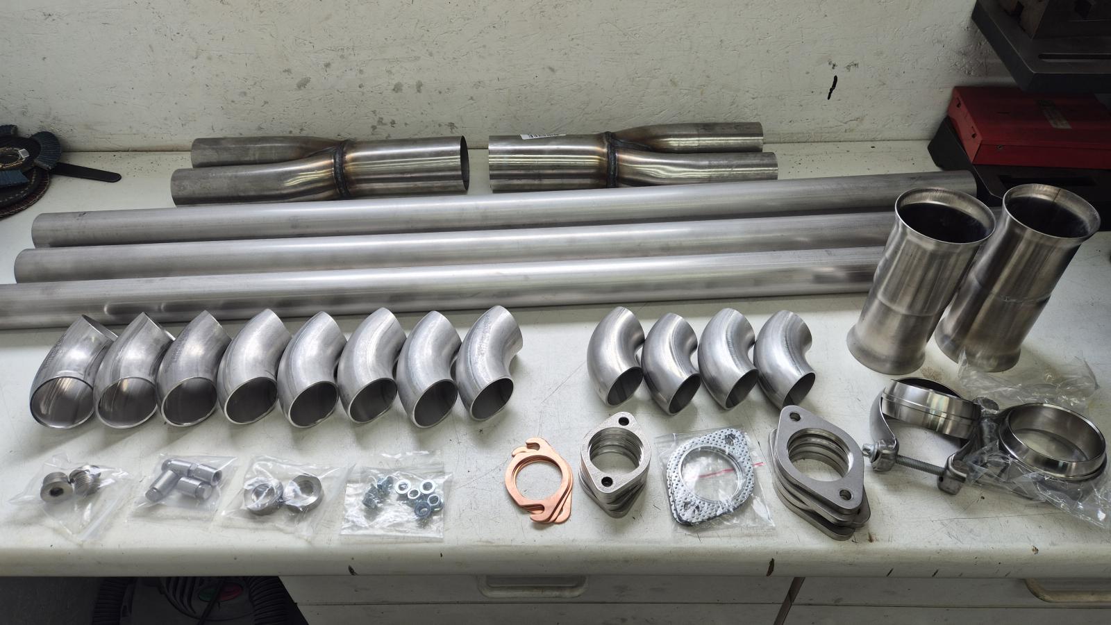

what a beautiful design, I also like the steps, very well thought out . Very Happy
What are those clamps, like V bands but different?
halbug
Joined: March 09, 2006
Posts: 567
Location: Germany
halbug is offline
PostPosted: Fri May 30, 2025 2:06 am    Post subject: Re: Ghia coming home Reply with quote
Thank you Ian!
I' ve been told it's a scaled down version of a Porsche Design. The tube ends have a round flare, on the inside is a custom made hemispherical olive and the rounded clamp comes from aeroquip. You can see all this on the right side of the picture with all the separate parts I bought for the header.
