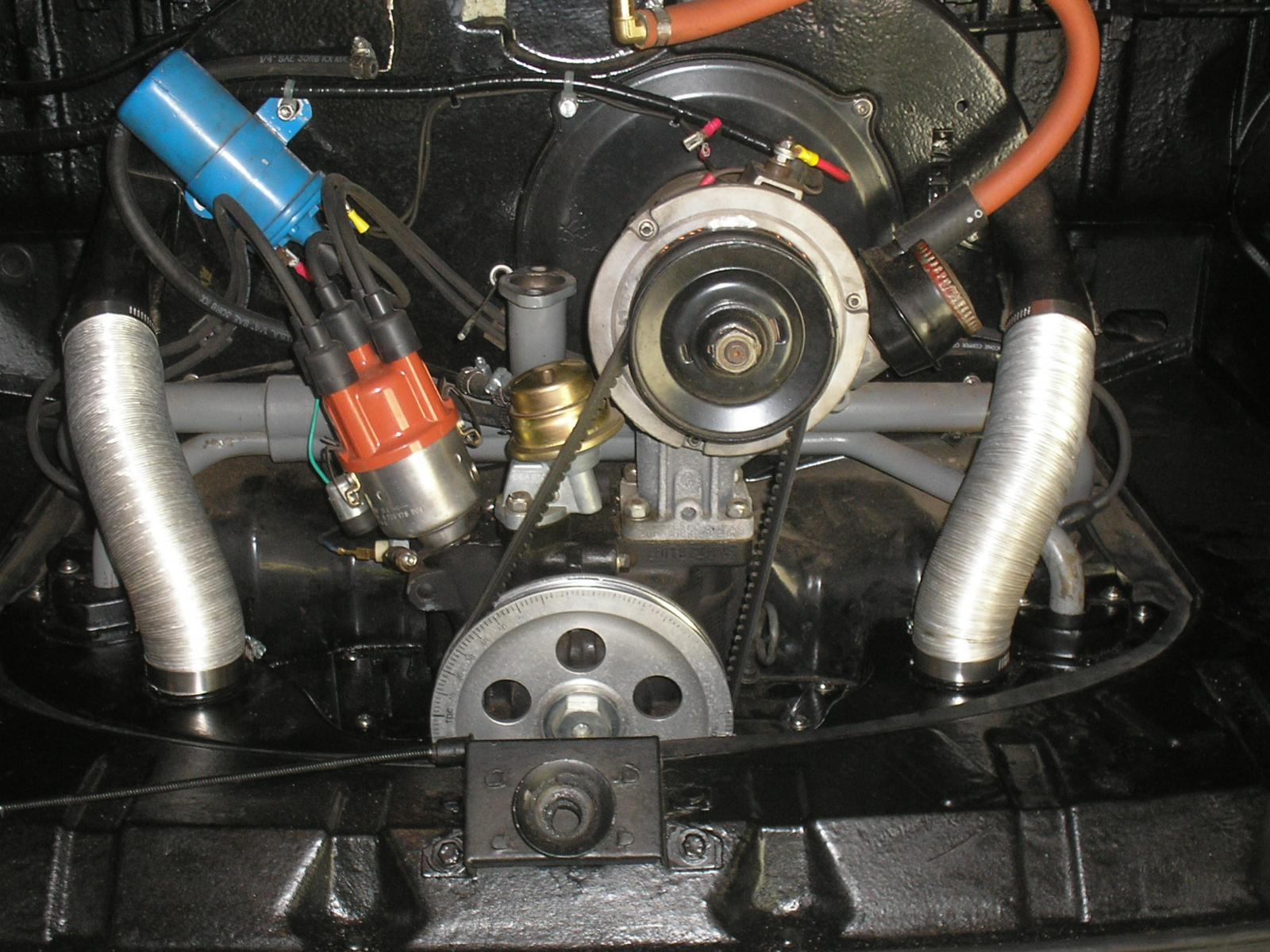

PostPosted: Fri May 16, 2025 11:56 am    Post subject: Re: Deck lid latch release Reply with quote
you can see what I used....painted black of course. Cool
