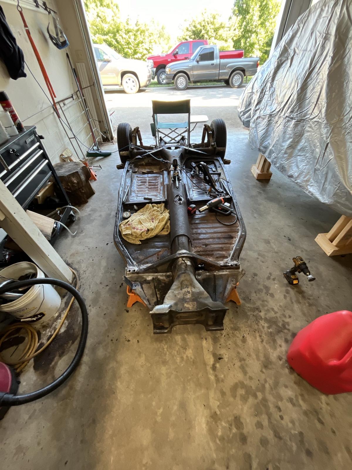

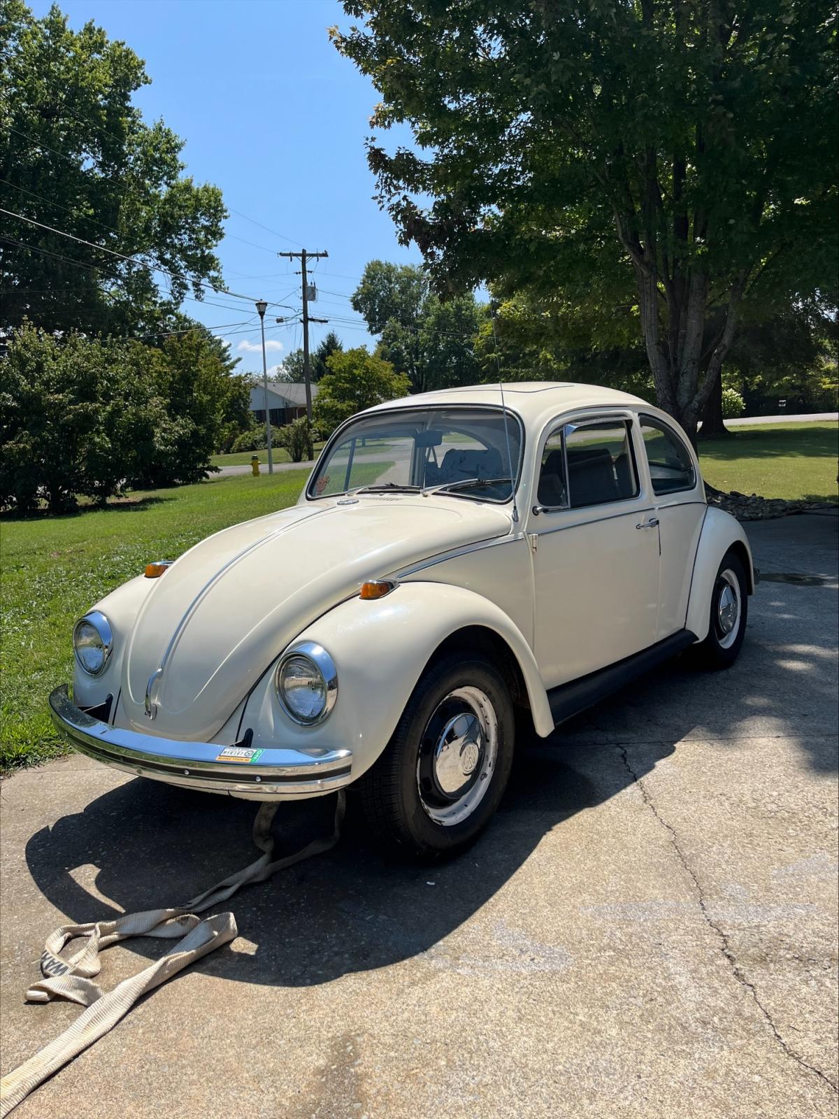

This is my garage find 1969 beetle. It had some significant frame head rust issues and now I am doing a full body off restoration.
Goal:
The goal of this project is to make it handle well. I am looking for any setups or tips to make it stick to the turns as well as possible while still maintaining it as a daily driver. I do not mind a stiff ride and really enjoy riding in my friends little hot-hatches (golf gti, ford fiesta, audi tt).
I understand that the stock 1500sp is no powerhouse, but I can always change that later although I doubt it will happen soon.
Basically, I am looking to make this car keep momentum through the turns to help make up for the lack of horsepower; just to have a fun driving experience.

rndnoramericaina72poptop wrote:
Really nice looking stock sunroof 69! It would make a great sleeper with a dual port engine with more displacement. Maybe some 195-65 or 205-70 tires with some KYB gas shocks would do wonders for the handling and on a budget.
It is a very nice car... or at least will be once I finish it! Being a college student makes it a weekend only project Rolling Eyes . I will l look into those tire sizes, I know there are a lot of forums here regarding that. I have heard conflicting opinions with those gas kyb shocks, but they do seem to add stiffness so that is good.

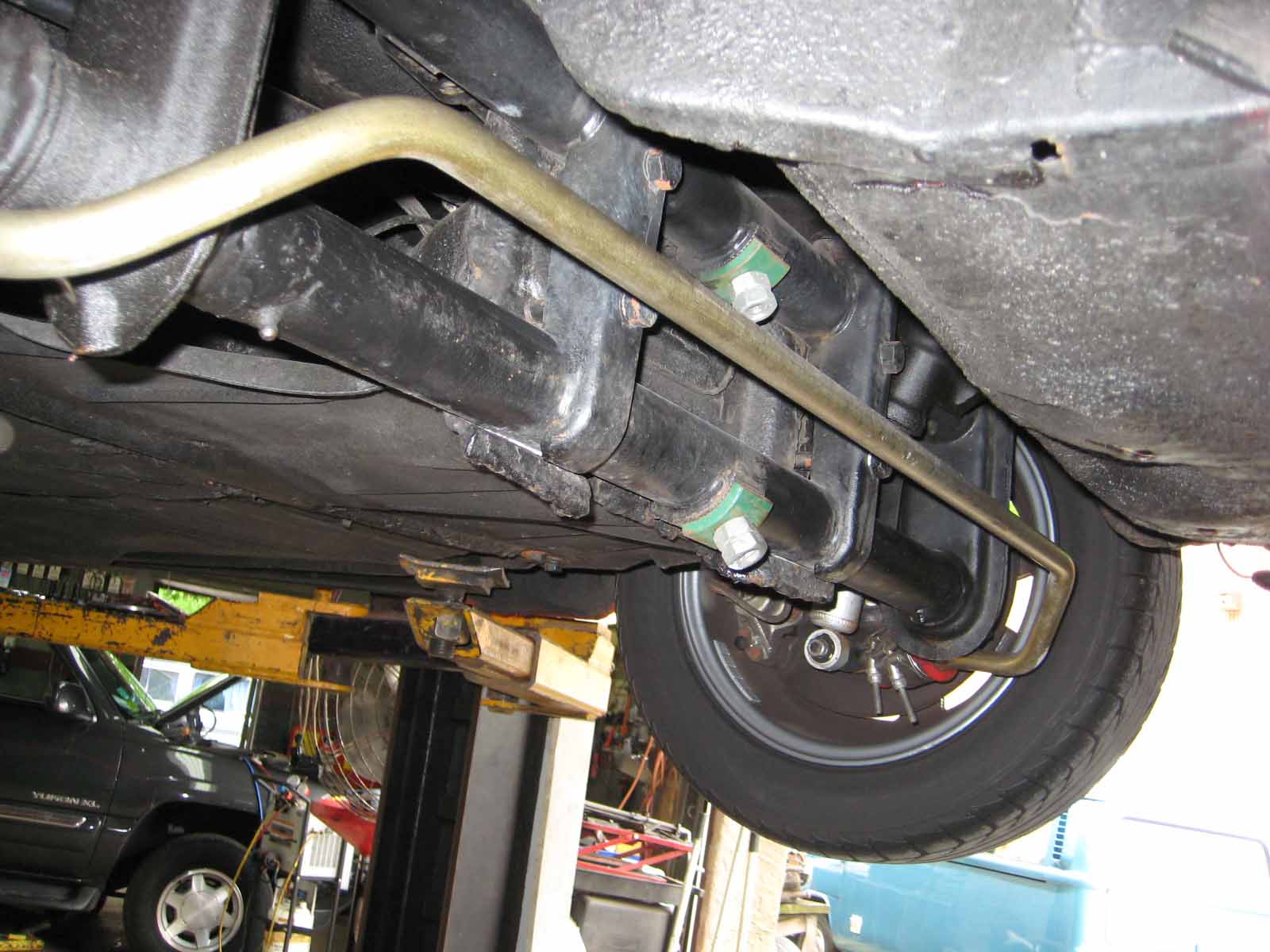

My car handles like it's on rails, so here's what I did.
Front: dropped 3" with AVIS adjusters, 19mm sway bar, KYB GR2 low pressure gas shocks (2' shorter Opal GT), 15x5.5 alloys with BF Goodrich gForce 195/55-15 tires
Rear: dropped 1", 25mm sway bar, KYB GR2 low pressure gas shocks, 15x5.5 alloys with BF Goodrich gForce 205/60-15 tires
Mounts: Type 2 transaxle mounts, Berg rear engine support, Berg front transaxle mount
Ah, the elusive Glenn, perfect timing. This is exactly what I was looking for, a tried-and-true setup on the same platform I have. I do have a few questions for you though, thank you for taking the time to respond to my thread.
1. Do you have any caster or otherwise negative suspension effects (like bump steer) with the Avis style adjusters? Are you running caster shims?
2. Do you rub at all with that ride height and wheel/tire setup?
3. Are the additional transaxle supports necessary for a stock engine? I will be installing CB rhino mounts but can add some more additional mounts like you did to strengthen it up.
Those pictures are super helpful, you have a really slick ride!
Single shim under the lower torsion tube. Steering is like stock.
No rubbing, but the alloys are real Porsche 914 so they have a deep offset.
Not needed for stock.

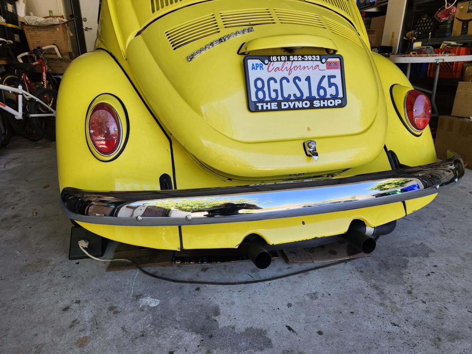

Awesome, I'm down this evolutionary path myself,
Front
lowered 2 1/2" dropped disc
narrowed 2" beam
single caster shims on lower
KYB 344098 front shocks
3/4" sway bar
185/60R15
Rear
rear dropped 2 1/4
truss bar
195/65R15
The wheels are Rivera's from the 80's that I buzzed off that rise on the spokes and had them powder coated... did that many years ago, really like the 914 2-litre wheels on Glenn's car.
Feels pretty good, I may be a 1/4" too low in the back, no rubbing and handles pretty good, still need to tweak it a bit and think about a rear sway.
Engine wise, pretty stout with a 2276cc, L6 DRD heads, sidewinder, dual 44's, XR-302 cam 1.4 rockers, runs pretty good.

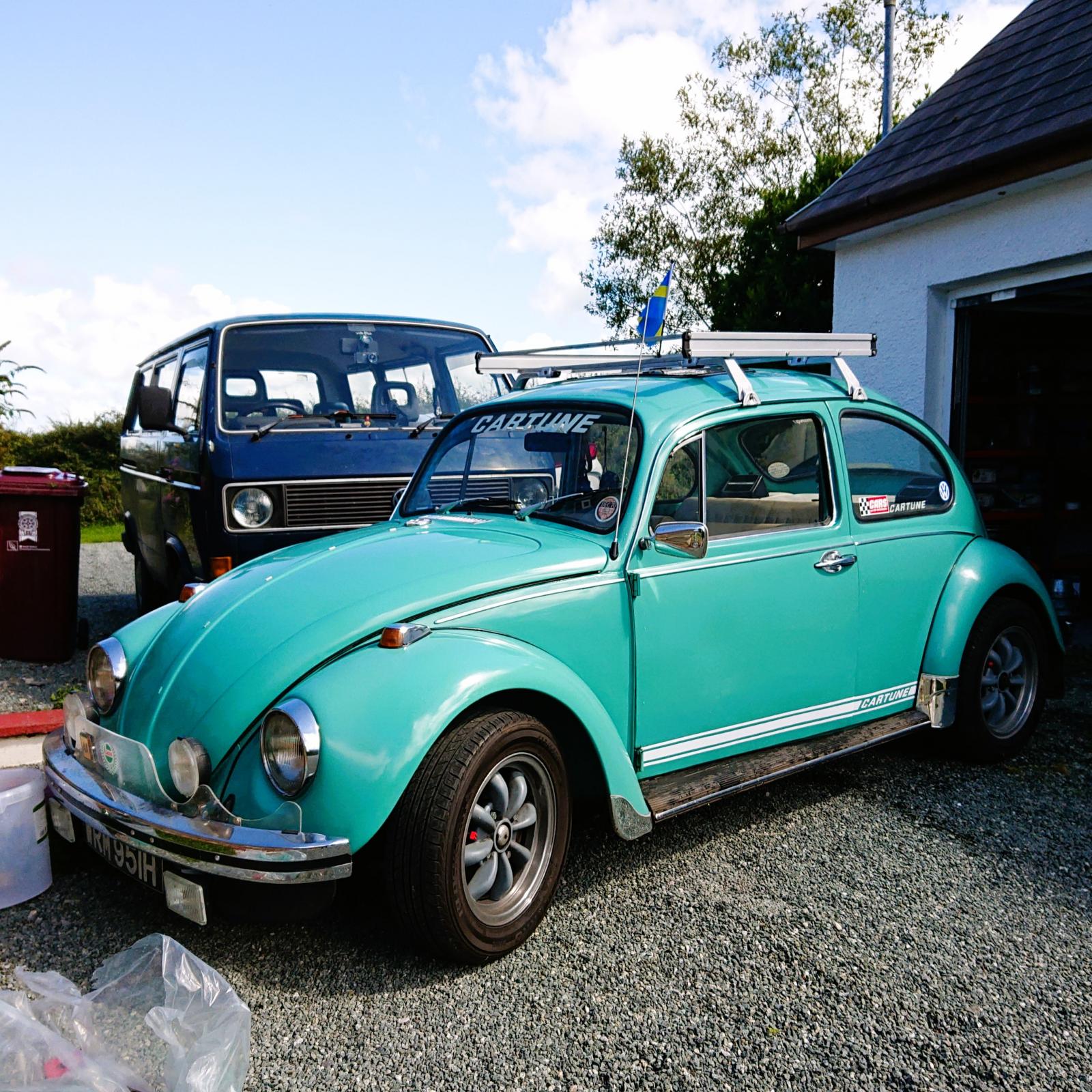

My 1970 handles pretty well on mostly stock suspension.
Its got cheap KYB gas adjust shocks on the rear and stock oil shocks on the front.
Lowered a little at the rear to remove positive camber (its a UK bug so we still had swing axle rear suspension until end of production).
Its running factory spec alignment apart from the slight 0.5 degree negative rear camber.
Front lowered an inch or so on a stock width puma beam, stock front sway bar.
I tried loweering it more at the front but had tyre to wing contact with the wider wheels.
5.5" empi 8 spoke replicas with 185/65/15 all round with pressures at 18f/27r.
Its got a Kamei front spoiler which seems to work well at cutting wander in headwinds.
