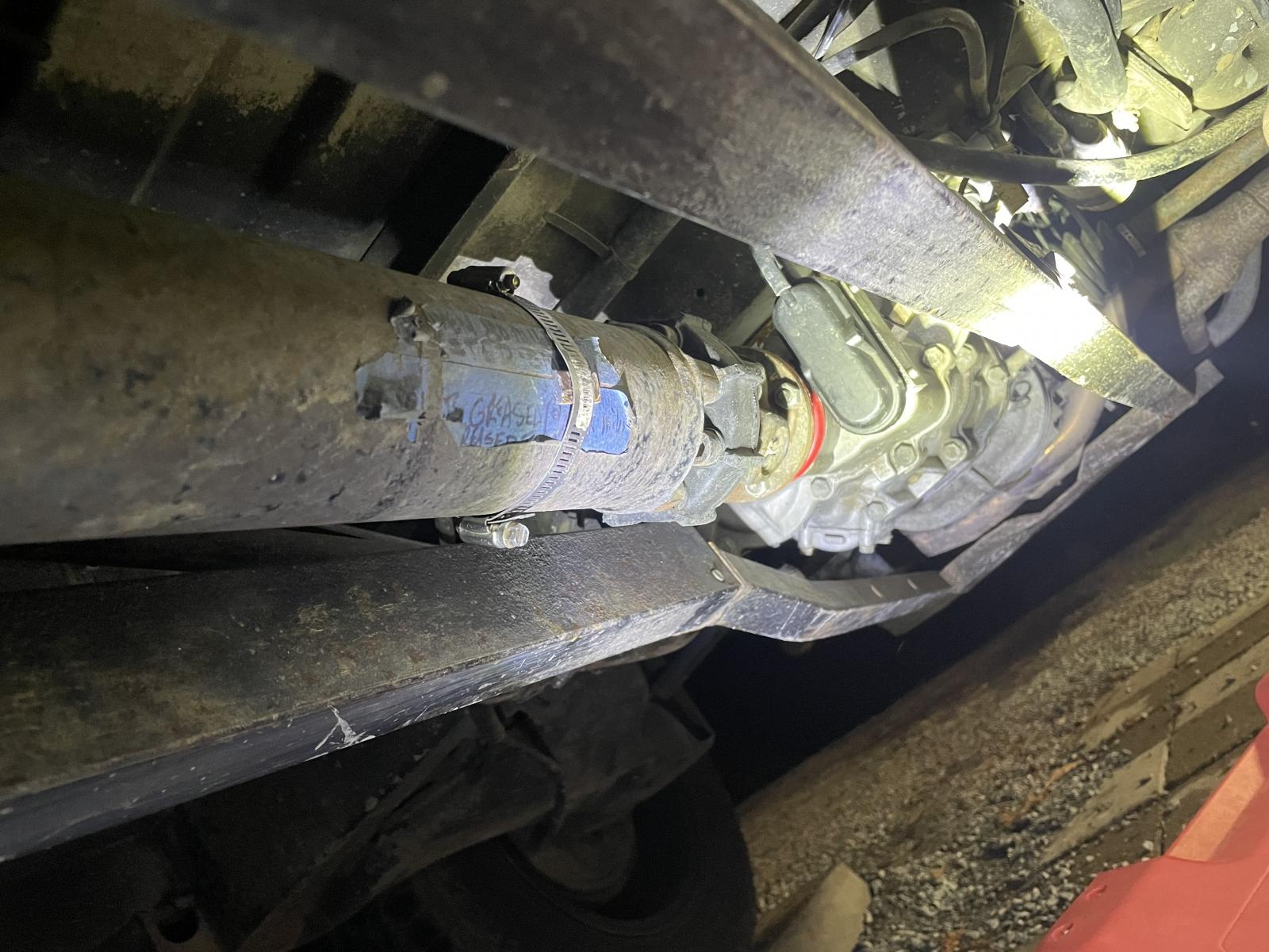

TomInAlaska wrote:
Next on the list in addressing the driveline vibrations.
it felt like it was trying to shake itself apart above like 15 mph.
----> Imagine my surprise when I found that the u-joints were out of phase! No wonder it was shaking so bad! I quickly unbolted the rubber donut from the main propshaft body and rotated the u-joints to be in phase. I did drive it a few miles yesterday and the vibrations were vastly improved,
interesting.... the angle is only ~4° so it surprises me that the pulsation could be noticeable.
Of course the phase should be corrected.
No stone un-turned in the pursuit of Syncronicity
TomInAlaska wrote:
While I had the propshaft out, I scrapped and cleaned as much of the unevenly sprayed on rubberized undercoating off as possible.
Its probably not enough weight to throw the thing out of balance but every little bit helps, right?
Now I'm gonna go the other way and opine that the weight of that undercoating is more than enough to throw off the balance.
I wonder how many other vehicles suffered that undercoater's blessed touch.
YouTube university shows driveline vibration affected simply by the weight of the worm-drive-screw on a hoseclamp.
I was going to try that but didn't have a long enough hoseclamp,
so I put two together and clamped peice of scrap steel in the middle.
Try and imagine the glee when the vibration disappeared on the FIRST TRY!
I think I'd better test again to be certain it wasn't my imagination.
I will report back if the vibration is still there. Cool

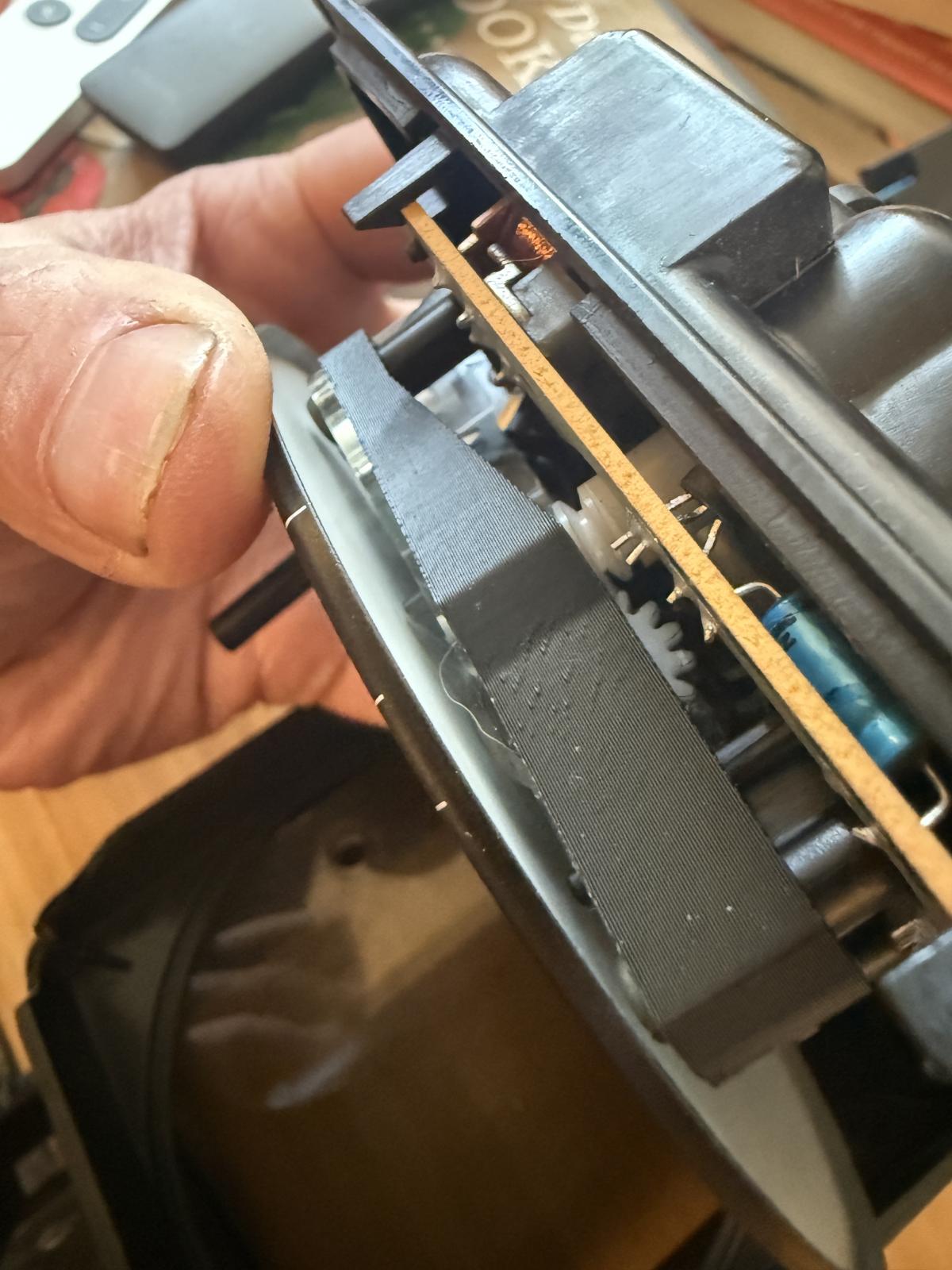

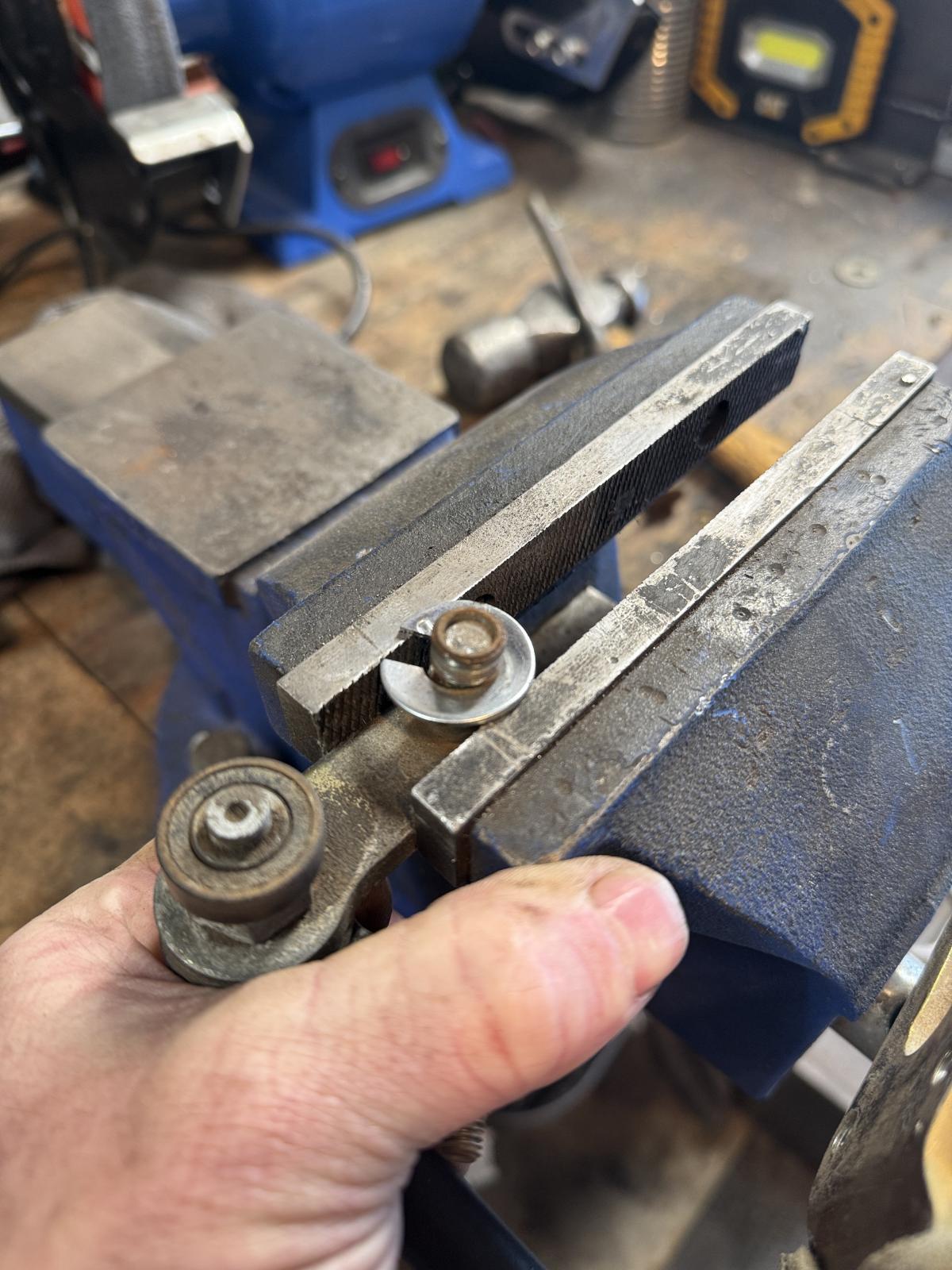

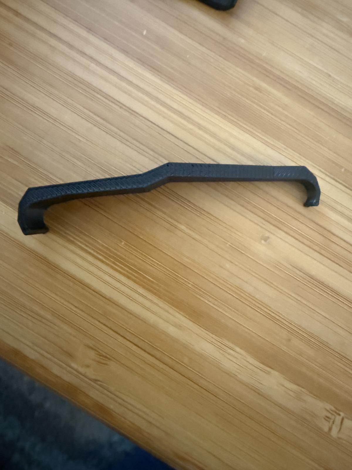

One issue I've been chasing around lately is a wonky odometer. The shaft that holds the number dials with the gear that is turned by the worm gear kept sliding out of the other side of the housing which made it no-worky-worky. I pushed it back in place a couple times but decided to try what is hopefully a more permanent solution:
If that works, I'll post the 3d printer file. (fingers crossed)

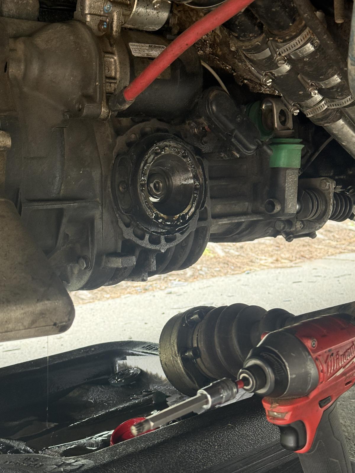

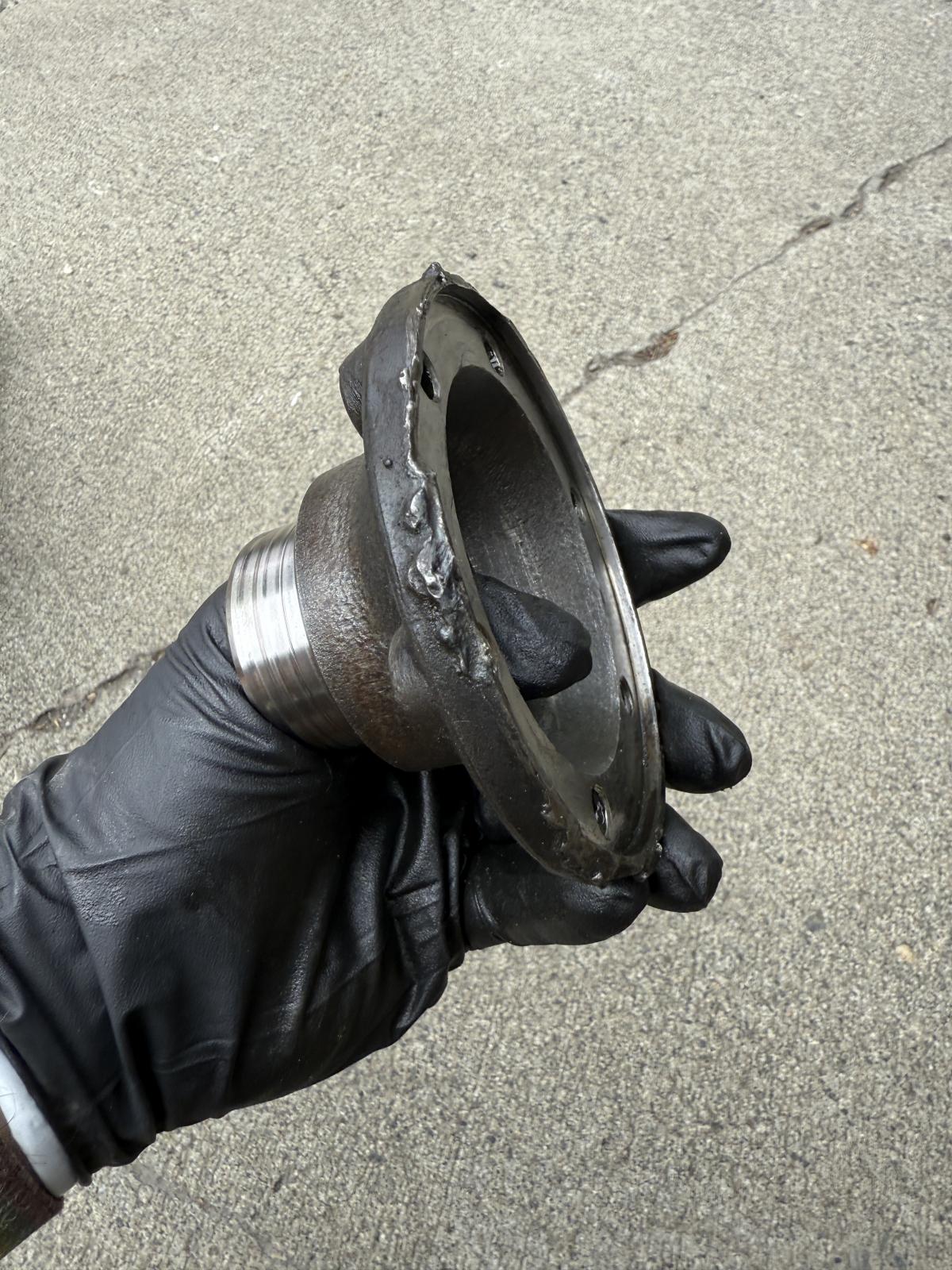

I've been monitoring a slight leak of gear oil around both CV flanges on the transaxle for a while. Nothing serious, but a new spot or two on the driveway every day seems like something that should be fixed sooner rather than later. Anyway, I finally got the time and motivation to do something about it today.
First I drained the oil and checked the magnet:
Its only been about 1000 miles since I checked it the first time, so I didn't expect anything, but nice to see a clean magnet in any case.
Next the CV joint got removed and broken plug seal revealed. I actually rtv'ed it back together soon after I got the van when I discovered the cv boot full of gear oil and leaking all over the place. Needless to say, new ones were ready to go back in.
The right-side flange has some damage from ...something? No idea how that happens. Its doesn't seem to affect the mating surfaces or runout, so <shrug>? Maybe I'm seeing things, but does it look like scars from a cutting torch? Which, now that I think about it, might also explain something else I found (see the last pic)
I was hoping the seal surface was good, but there are definitely some small grooves. Maybe the new seals will hold, but I'm assuming I'll have to go back in and add some speedy-sleeves. Oh well.
I initally tried to gently pry the seal out but was afraid I was going to damage something expensive and annoying to fix, so I grabbed the make-shift tool I made when I rebuilt the 4speed in the previous van and quickly unscrewed the adjuster ring. After punching a mark to get it back in the same spot, of course.
A new seal was installed and the adjuster went back in
And here's the pic that definitely shows evidence of excessive heat. Could somebody have torched the bolts to get the CVs off at some point? There was definitely years and years of dirt and grime on both plastic keepers so whatever happened was a long time ago. Interesting.
Anyway, both sides are back together and the gearbox is refilled. I even used new bolts and serrated washers on the CVs. Was actually easier than I expected and only took a couple of hours. Could probably cut that in half next time. Which, like I said, I'll probably be doing to install speedy-sleeves. So it goes. Rolling Eyes
Or, and hear me out here, I use this as an excuse to go with 930 CVs Twisted Evil

AndyBees
Joined: January 31, 2008
Posts: 2690
Location: Southeast Kentucky
AndyBees is offline
PostPosted: Thu Jul 10, 2025 8:18 pm    Post subject: Re: An Alaska NSYNCro build Reply with quote
Yeah, I suspect someone got carried away with a cutting torch.
Were the seals hard?
Does a speedy sleeve requiring milling with a Lathe for fitment?
Or somebody saw the triple square heads and didn't want to bother getting the correct tool. <shrugs>
The one seal got pretty mangled in my failed attempts to pry it out, but I'll check out the other tomorrow. It came out of the adjuster ring intact. I did see VW/Audi marks on them so they were almost certainly factory.
And as far as I can tell, there's no machining with the speedi(sp?) sleeves: they just slip fit onto the sealing surface and are secured/glued in place with a retaining compound. Looks like they're very thin, like 0.15mm, which gives a new surface for the seal to ride on but not thick enough to adversely affect the function of the seal. Maybe I try to use those, maybe I get new flanges. We'll see.
'73 Super Beetle (formerly resto-mod/rally look with a healthy 1776, currently in another round of resto with a 1641)
'84 GL adventure van project [sold] (1.9L, 4speed) https://www.thesamba.com/vw/forum/viewtopic.php?t=755844&highlight=
'86 Syncro tintop (2.0L Eurospec/ABA engine swap) https://www.thesamba.com/vw/forum/viewtopic.php?t=800194&highlight=

PostPosted: Thu Jul 10, 2025 9:38 pm    Post subject: Re: An Alaska NSYNCro build Reply with quote
Speedy sleaves work great and just 'press' on. They are definitely a viable option but with the rest of whats going on with that flange I'd say you're better off to save it as a spare and source a better condition one.
'84 Adventurewagen 1Z TDI, '08 Audi Avant Quattro 6spd BHW TDI, '03 Jetta Wagon 5spd TDI

PostPosted: Thu Jul 10, 2025 11:05 pm    Post subject: Re: An Alaska NSYNCro build Reply with quote
Here is a topic that goes into the process.
https://www.thesamba.com/vw/forum/viewtopic.php?t=747620&highlight=flange
Dave O

PostPosted: Sat Oct 18, 2025 5:26 pm    Post subject: Re: An Alaska NSYNCro build Reply with quote
Looking at the damage, do you think the positive cable became dislodged at some point and arc'd out against the hub as it cruised along? The plastic damage appears isolated to the top and the melted metal looks like actual arcing..
I only mention this because it happened to me once, but not a vanagon.
In any case, I'm glad you were able to repair it.

PostPosted: Sat Oct 18, 2025 6:02 pm    Post subject: Re: An Alaska NSYNCro build Reply with quote
Woah! I hadn't even thought of that but those marks do almost look like really bad welding beads. And given the melted plastic, I bet that's what happened.
And yeah, no further signs of leaks from the drive flanges since replacing those seals. Very Happy [knocks on the nearest piece of wood]
