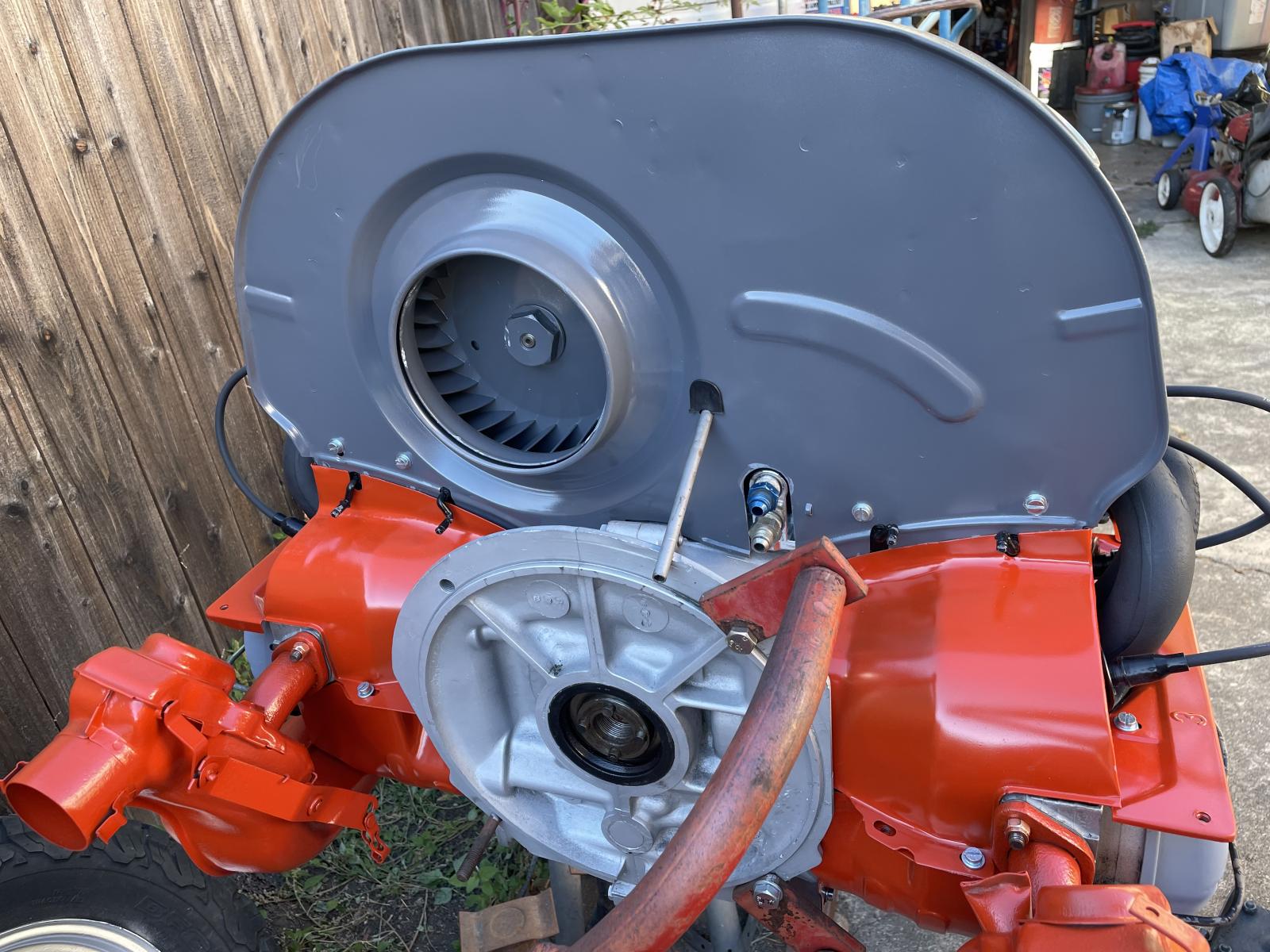

Before you continue on your engine, remove the 4 small M6 bolts that hold the generator backing plate to the fan shroud. Rotate the backing plate with the gen 1/4 turn CW so that the gen's terminals point upwards at the "2:00" position.
There is an air duct inside the backing plate (inside the fan shroud) which needs to be in the corrected position to enable air to pass through the duct and thereby help cool the end of the generator.

do as Rome said , your generator it tilted wrong so the venting isnt right . ya air is forced thru the genny .
I’ll definitely make sure to orient it appropriately when I reinstall it. By chance would you know the proper install of the thermostat flap linkage? For whatever reason I can’t seem to be able to get it lined up without it either hitting the case or missing one of the flap rods. I’ve searched the forums but I can’t get a definitive visual of the orientation. Thank you for your help and advice!

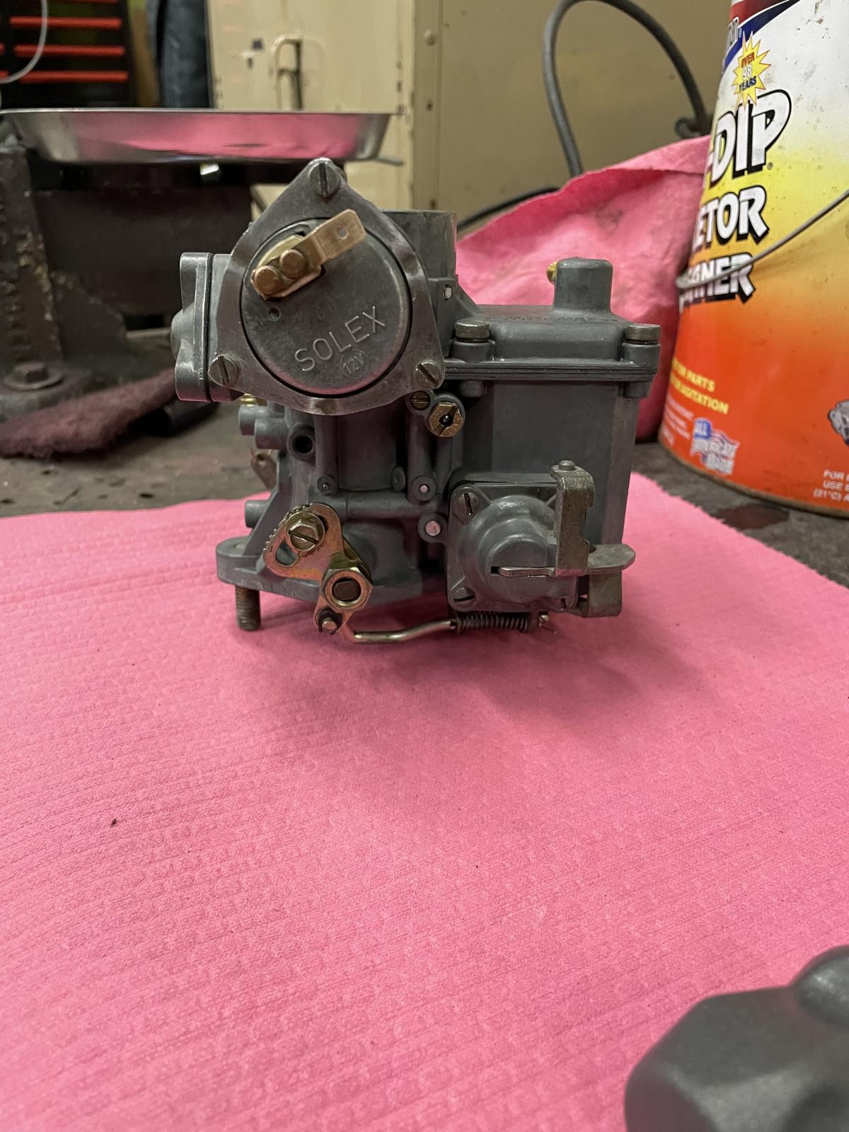

I ordered a cheap chinese rebuild kit from RockAuto that included my missing idle shutoff valve. I did retain the original Solex float as it seemed to be in perfect condition. I cleaned out all the tubes and orifices in the carb after soaking it in carb cleaner for half an hour. I do know the choke is clocked farther than most, but that is the location it originally was and seems to be happy at the adjustment. I also removed the original fuel inlet tube, drilled, and tapped the hole for an 1/8"npt fitting to 1/4" barb. I will also not be using the supplied plastic fuel filter, as I have a glass and metal assembly from Dorman I am going to try out.
I started the final assembly of the engine, specifically getting the tins and exhaust manifolds on to see how everything fit after paint. I also got the disributor sorted out. I originally ordered a set of cap and rotor but they ended up being too tall. I sourced some NOS parts and that turned out perfectly. I replaced the condenser on the distributor before install, and cleaned the points with a points file as well. That has been set to 0° timing at TDC on the #1 and will be adjusted during first fire-up.
I did notice the 70's era filter adapter (which I know will be very polarizing, but I ask you refrain from giving me hell for it Twisted Evil Laughing ) was running into the aftermarket exhaust. I have not decided yet if I'm going to cut and weld the tubing to get the needed clearance, but for now I left it off.

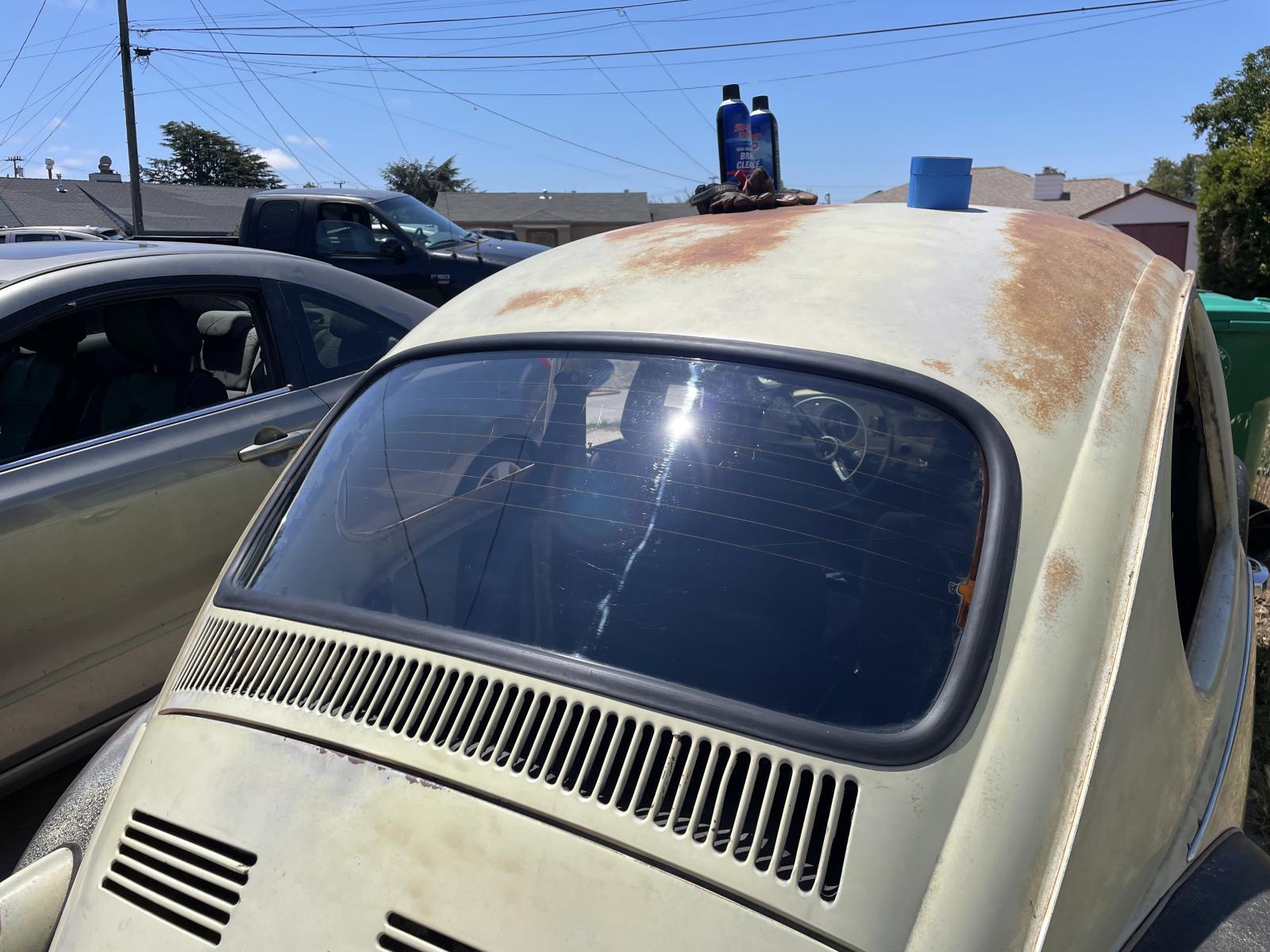

I decided to take a break from building the engine to install the rear window since I am done welding inside the shell in that area. I prepped the pinch-weld and applied some rust-reformer to the window frame. I then installed the new Cal-look seal and popped the glass in. It worked out perfect using jute rope soaked with soapy water, and some plastic trim tools to help it along.
I installed the fan shroud after notching it to clear the oil cooler adapter (yet another sin against the VW gods), I just need to touch up the slot edges. I will be installing new fittings in the future, but these came in a lot box I bought a while back and will let me do the test fire before taking the car up north.
