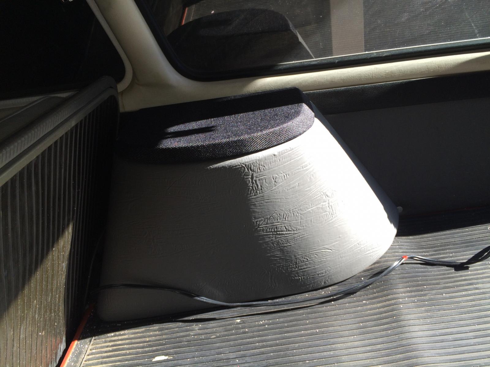

I built speaker pods for the wheel humps so I didn’t lose any cargo space
Before that I had speakers in upholstered sono tubes that looked like roll pillows, they just sat on the rear seat, and were held in place with some elastic and snaps, that way I could drop them on the floor behind the seat if I needed to fold the seat down
I've always thought that set up was pretty slick, and if I ever get another Square again that I'd do something like that. I've had box speakers behind the rear seat before, but they would slide around too, and need to be moved when using the load floor. I always worried about getting hit by them being loose back there.

Great idea, how did you build them??

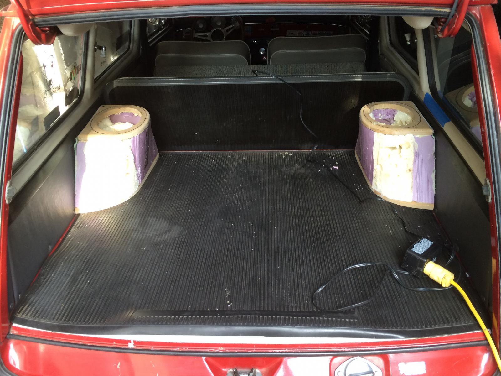

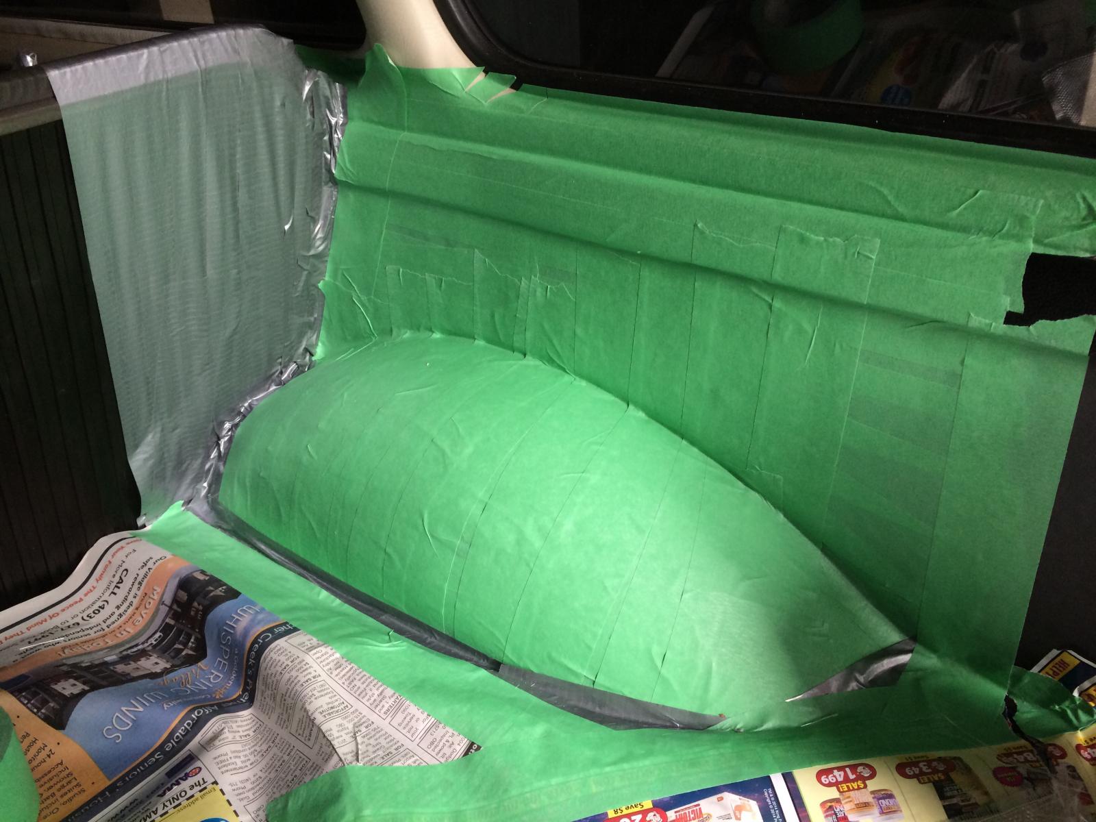

But, it is simply tape off the inside of the car, you are applying epoxy on top, no gaps. PVA would have been good too but this was my first attempt at laying up,epoxy
Epoxy and fibreglass for the wall shape
Wood top and bottom, fill in with styrofoam blocks and shape it however you like
Cover with fiberglass/epoxy layers
I covered mine with vinyl, and made a grill for the top, it attaches with magnets.

Those are too cool. Well done.
