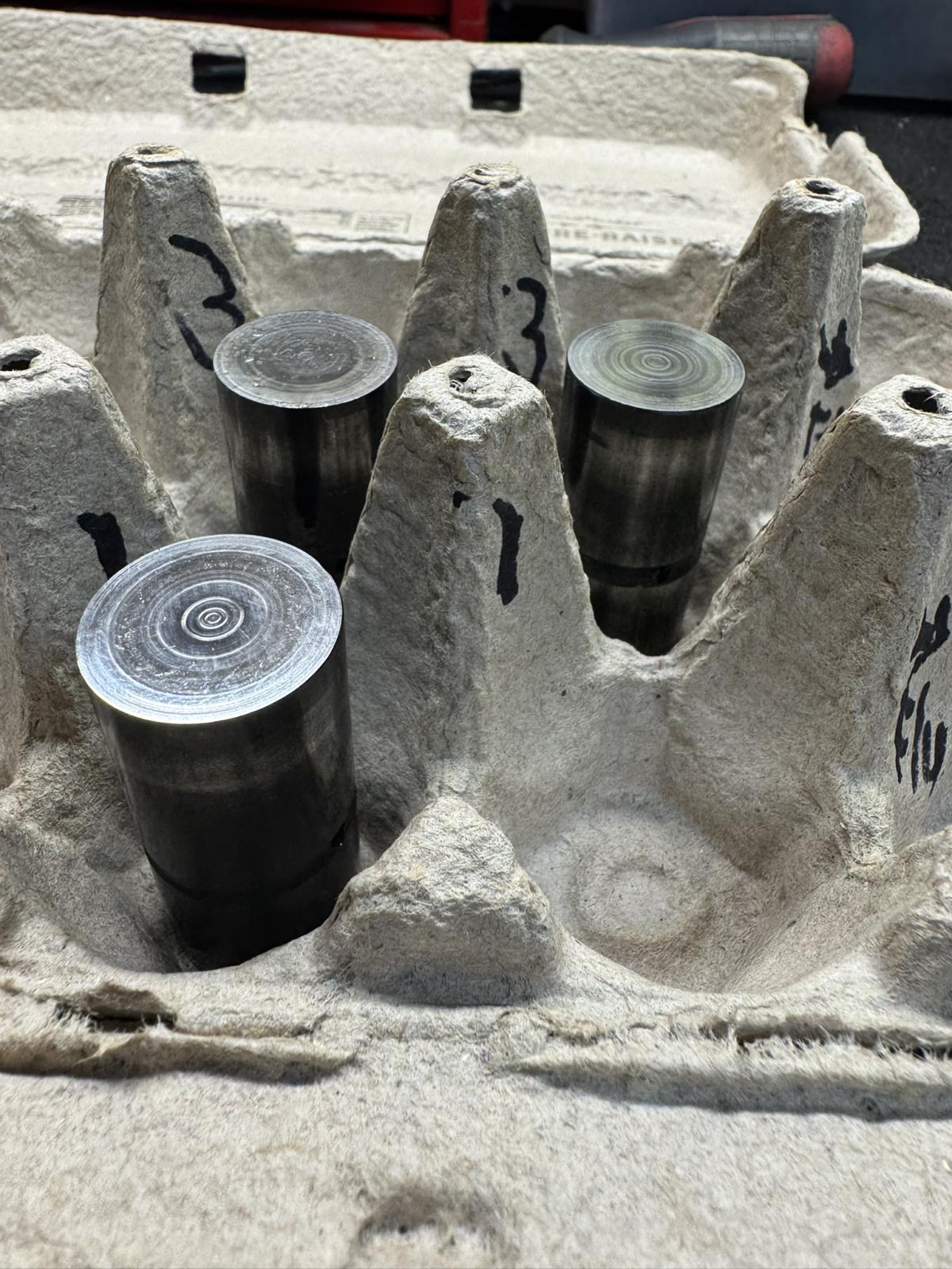

I managed to get 3 lifters out. Both from cylinder #3 and 1 from #1. Here are the pictures. I tried some carb cleaner with no luck.
You can see they are all very flat with very slight mushroom which i think is causing them to not come out properly. You can't even see much but you can feel a slight burred edge. If I can't get them out I will just leave until I do a full rebuild.

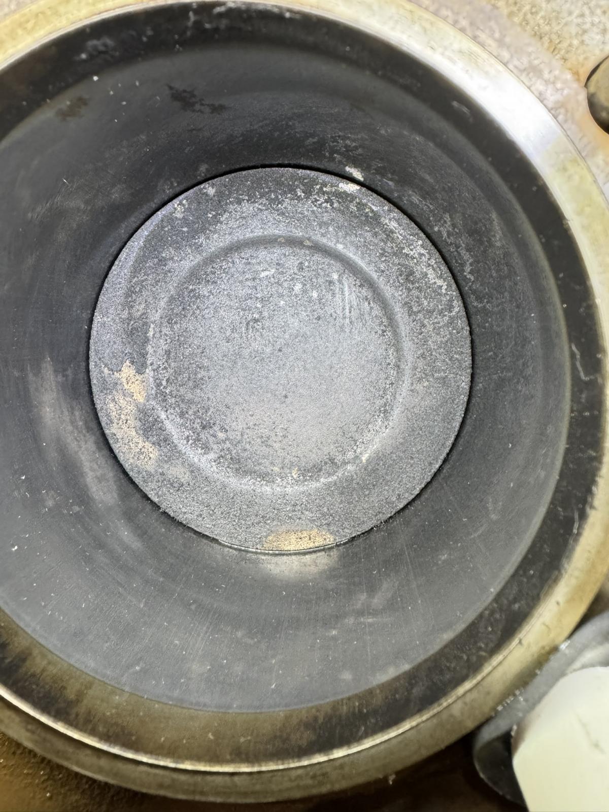

Here are the piston tops before cleaning.

very even coating of carbon. I would say that unless you want to rering it, leave the cylinders and pistons alone other than you can decarbon them. Do it at top dead center. You might smear a little grease around 360 degrees of the edge of the piston and cylinder to trap any debris from washing down the sides of the pistons.
The problem you will have is that each step you take, moves you closer to a complete rebuild and the challenges that has, and away from just cleaning things up.

I would guess that the carbon on your piston tops was in a steady state condition with about the same amount flaking off over a thousand miles as what was being deposited, so I don't think you have much to gain by trying to get it all off unless you intend to go further into your engine.
Carbon and lead deposits of old were a different matter as they could build up thickly throwing the compression off and when large hunk were shed could cause the engine to be out of balance.

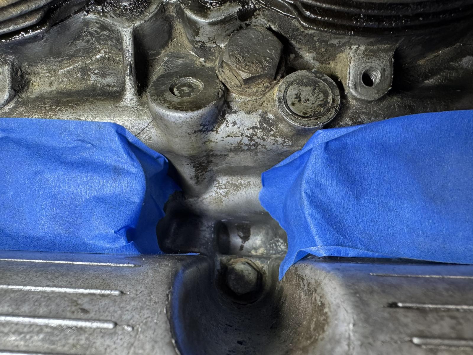

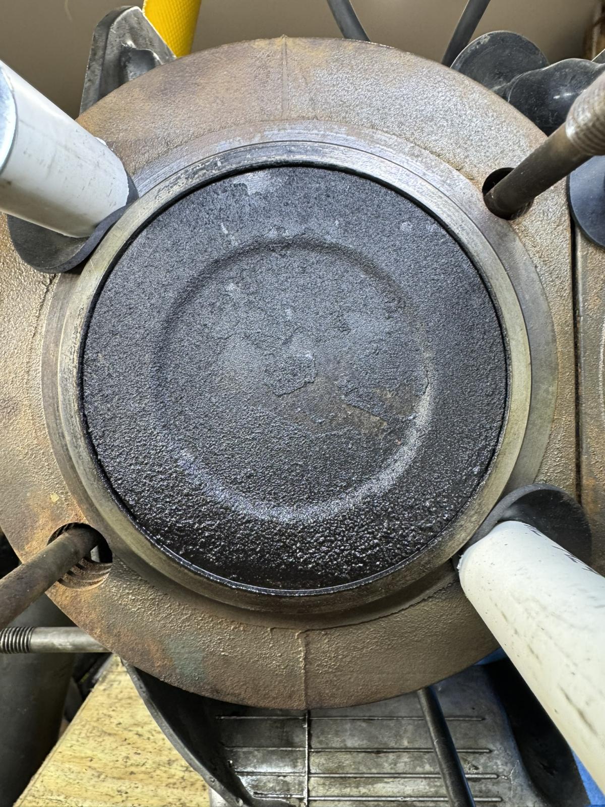

Update for today. I cleaned the piston surface and peened the oil plugs.
The nylon cup worked well, I used the grey one which was supposed to be like a 120 grit. I soaked it with flogging oil after to keep from rusting until I get the heads back.
Peening might not be the best, but better than nothing I think.

A few questions.
Are these the oil plugs under 3&4 that need to be peened?

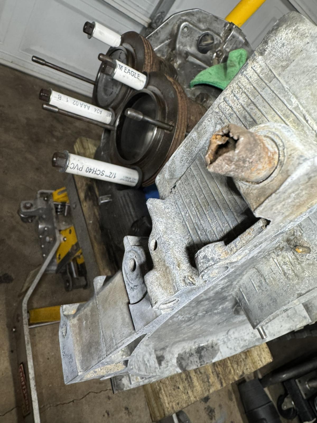

What is this cut off tube on the fan shroud? Should I trim it and plug somehow?

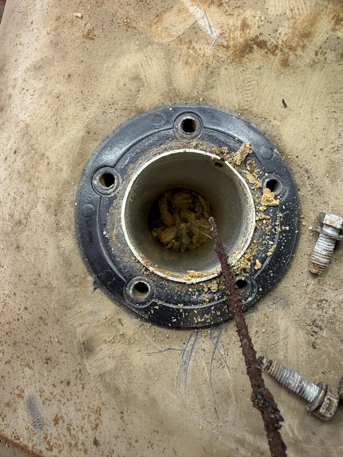

While waiting on engine and transmission parts, I started to remove the tank. I was surprised to see it look so good it the compartment. However, when I remove the bottom nut, it is like tar. I know it is full of tar like goo, but I need to inspect if it has leaks. It might be less work to replace but lets see. I had to remove the engine/tran support bracket to get 2 screws out of the bottom of the gas compartment panel. Bad design.

The smaller of the two plugs should be peened, the larger one is a casting that looks like a plug.
The cut off and mangled nipple on the shroud is the purge air supply for the charcoal canister, pry the caved in parts back out, the rough stuff will never show when there's a hose shoved onto it. It's not under any great pressure, it just blows air.
The 72 tank is rather unique and not easy to replace with new, the new ones don't have the correct fittings. You can take it to a radiator shop for a cleaning, or do it yourself: https://www.thesamba.com/vw/forum/viewtopic.php?t=378770
Whatever you decide do not put any sort of coating in it unless it's peppered with pin holes, coatings fail and peel off and are impossible to remove when they start blocking the outlet. Bare metal doesn't rust if you keep the fuel fresh and top up the tank before winter storage, a 1/2 cup of ATF sloshed around after the cleaning will protect it until it's time to put it into service.

I managed to get the tank out today. Well there is no saving this tank. It was completely rusted thru on the back side and some on the top. I could not even get the sending unit out. I guess I am in the market for a new 72 tank. If you have any suggests, please drop below
