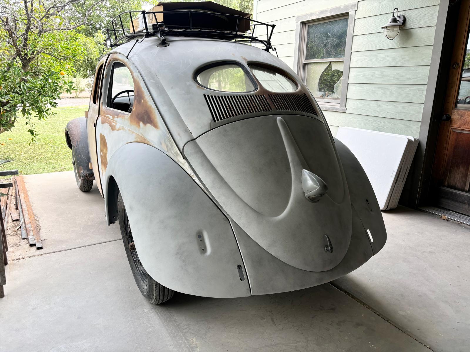

With the welding finished on the clip, I moved to the fenders, fit the taillights and finished any misc welding they needed.
Then I went to body work and primer on the decklid and rear clip. Just keeping things small and manageable as I go. I'm using PPG DP50 on the bare metal then Evercoat G2 on the high build areas...

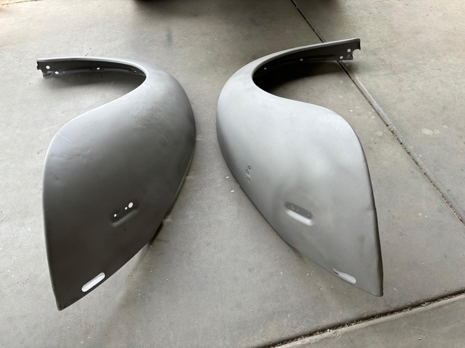

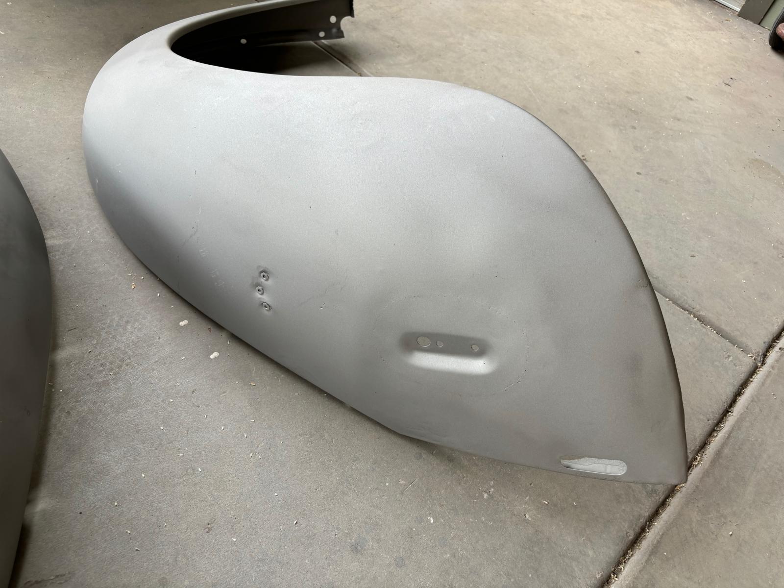

I had dropped off the fenders at the blaster and got them back. There were a couple of welded in nuts buried in the bodywork that I missed on one so I fixed that, did some rough bodywork and got them in primer...

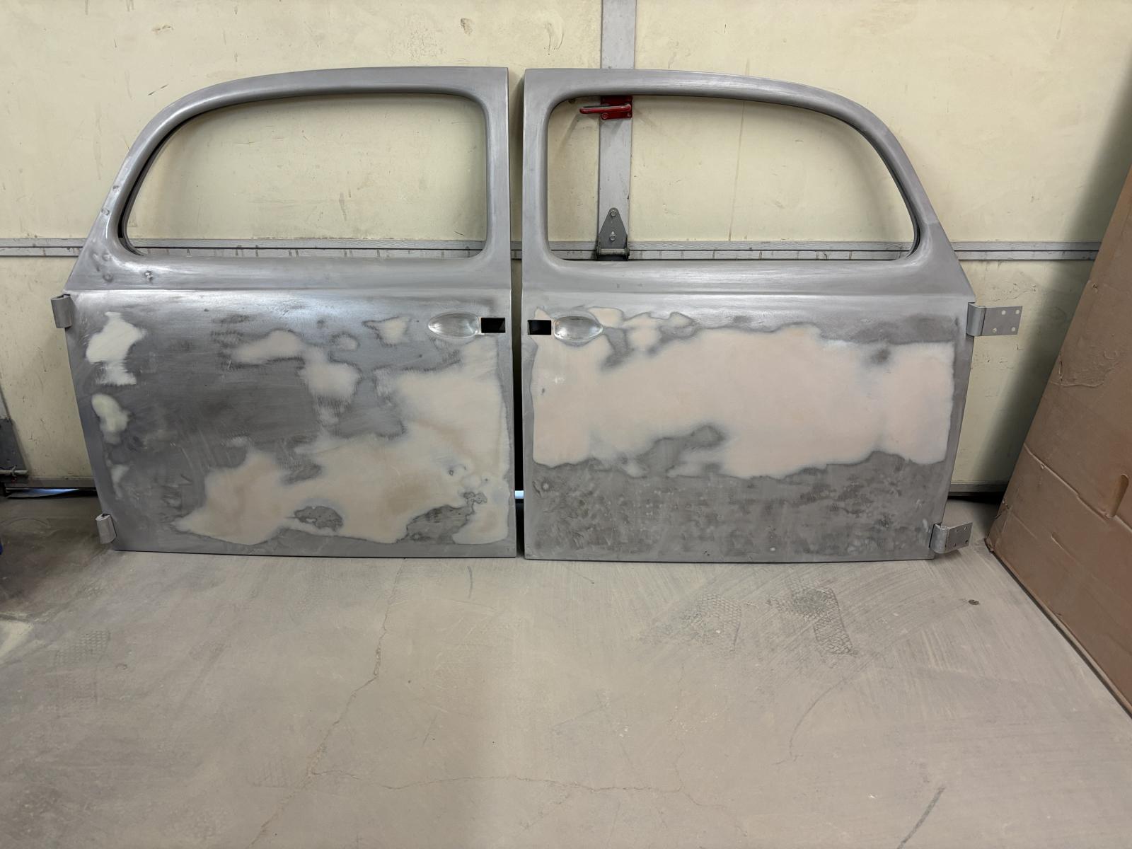

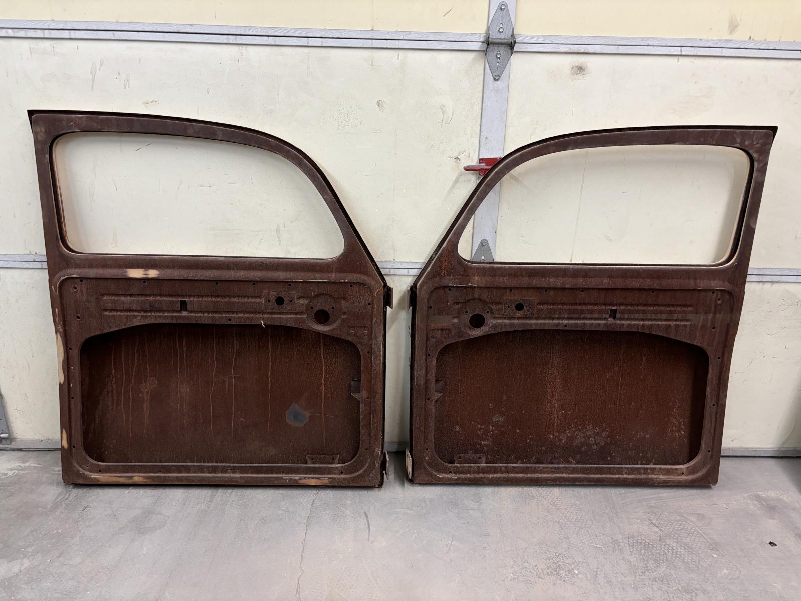

Then I dropped the doors off. With the amount of blasting they would need on the inside, I was worried about blasting the exterior panels also. I quickly DA'ed them and didn't look too bad, so I asked the blaster not to hit the panel exteriors. They came back better than expected...
Only one came back with some pinholes and rust on the bottom. It was rainy and humid that week and I was dealing with some flash rust, so I knocked down the remaining filler and sprayed a coat of epoxy. I also worked these in a couple early mornings, late nights and guess I didn't take many pics. Hopefully enough to get the idea and can see some of what I was dealing with...

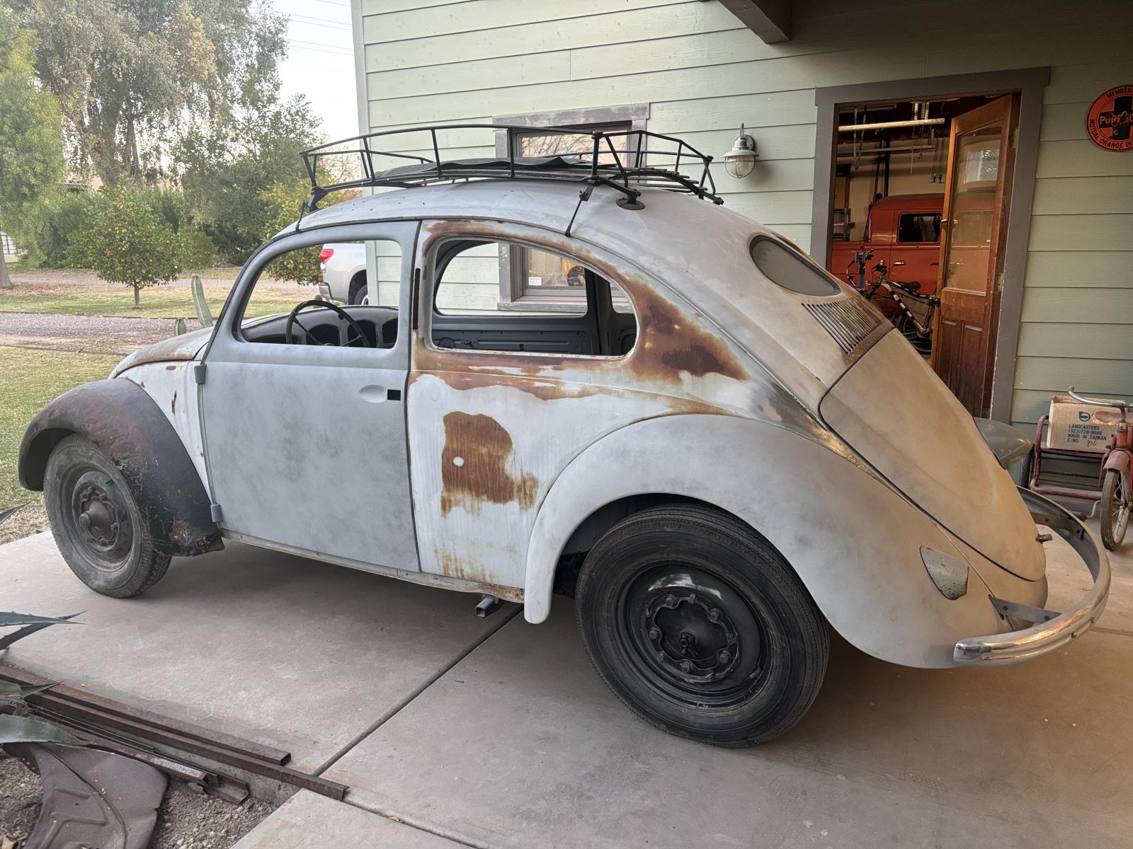

Here's checking fit of parts again including a rear bumper. The bumper is an NOS one I got from Dick along the way. It has some shelf wear and light pitting but should be good enough for what I'm doing. The bumper brackets are from Mika(virtanen).
