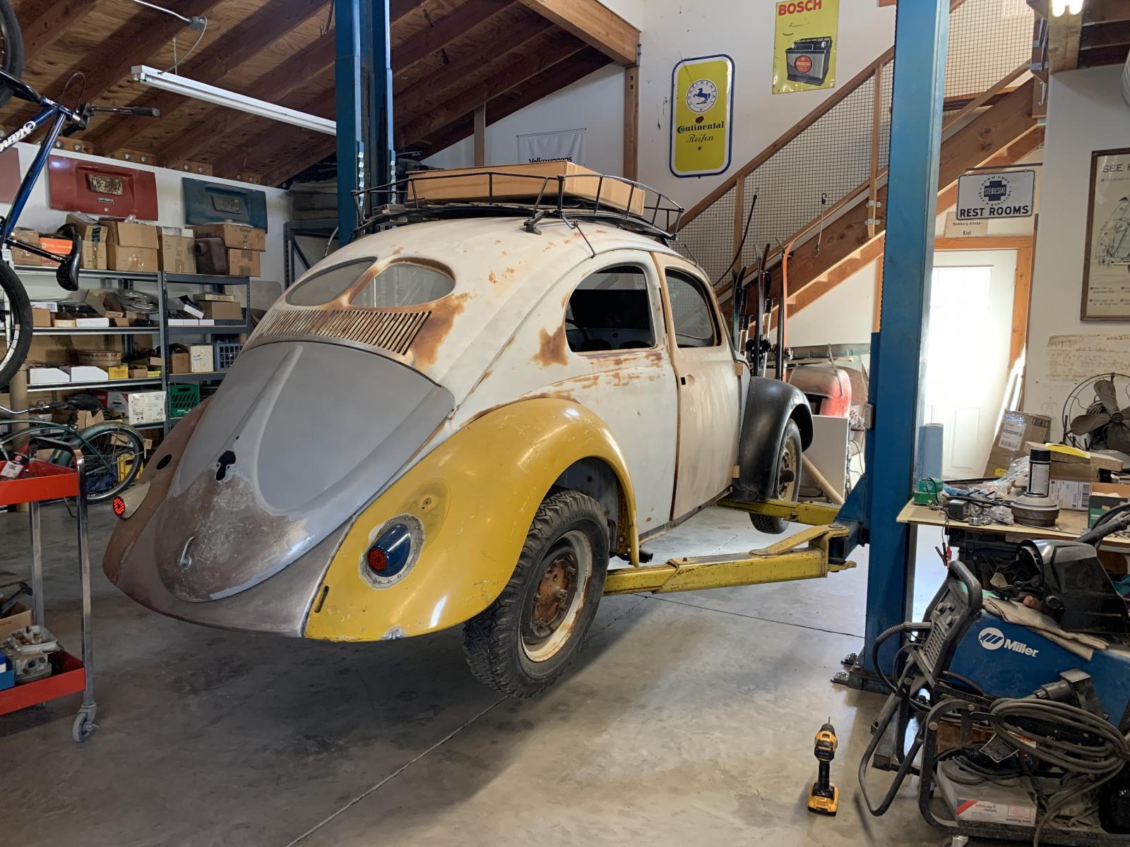

50Splitman wrote:
Did you MIG or TIG the rear bumper mount panel in?
MIG
Here's the other side...

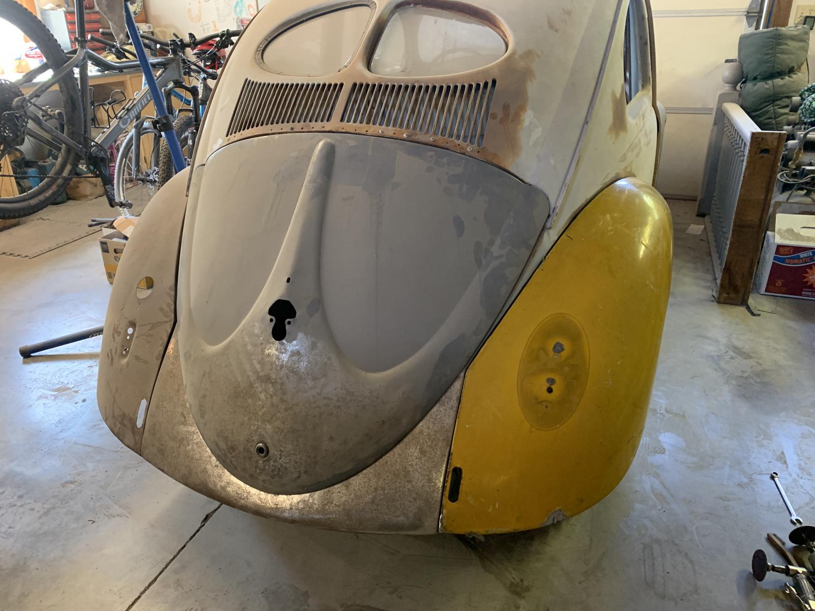

The decklid I got was hit hard and I had started on it years ago. I spent a little more time straightening it out and installed a NOS inner piece...
This goes back a couple years and at this point I wasn't happy with how things were fitting together and the work stalled out for a bit. The decklid wasn't fitting well, things weren't lining up and I decided the right fender I had was too rough to use to figure it out. So I was on the lookout for a better right side ribbed fender. We were in Hessisch Oldendorf for the show and while walking the swap I looked down to see a nice rear right fender at a reasonable price. I start talking to the guy and it's Jan(originalo here). It's always cool meeting people in person you've only talked with over the internet. I had a friend bringing some stuff back, he offered to get it back and I was back on track...

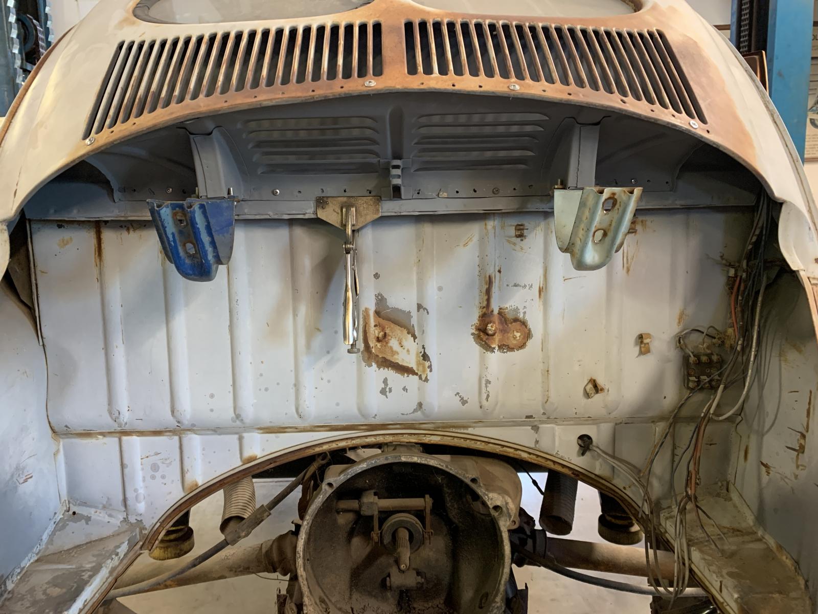

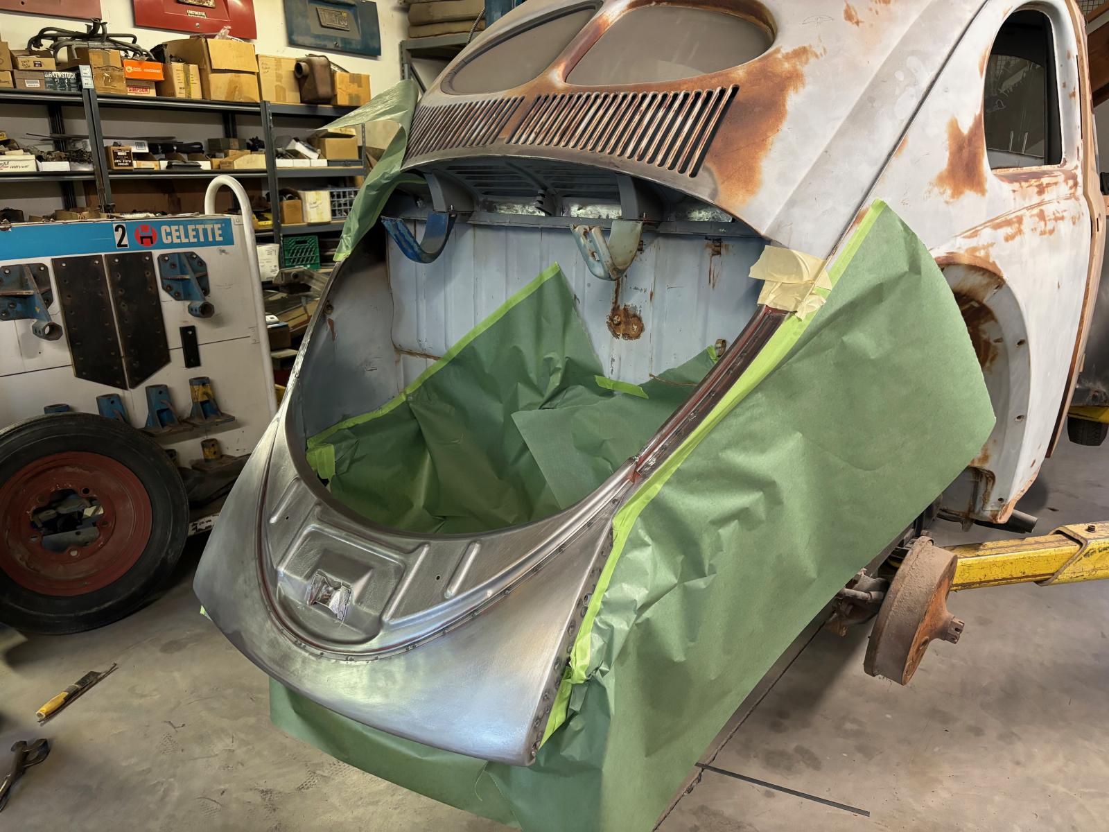

With the quarters all welded up and everything fitting well, it was time to weld the rear apron. I installed the seal channel and inner apron piece. I know there's a repro available now but I had heard mixed results so I just used the original one off the old apron. It's a kind of beat up but will be fine with a little more work. I also primed the quarters in and out before installing the apron...

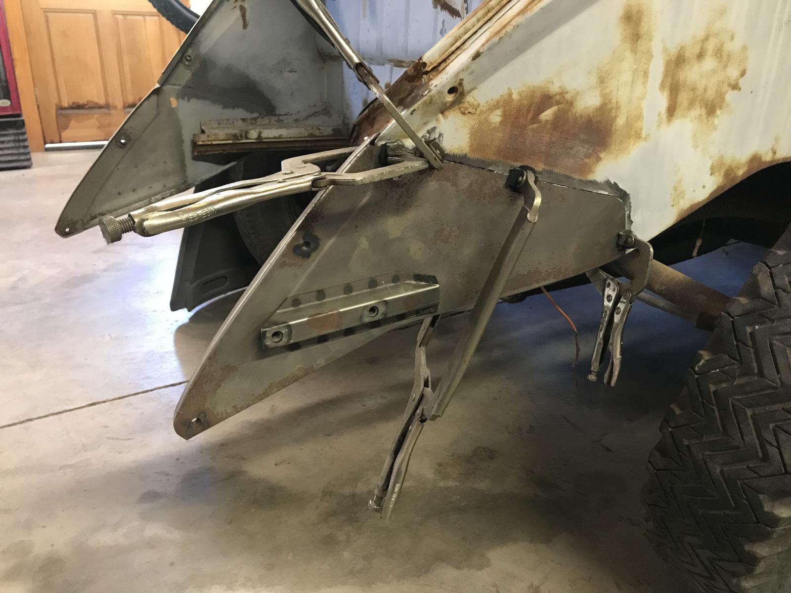

I really didn't see a way to leave this hinge carrier off any longer. The metal was damaged and stretched where it met the decklid and I needed to sort this out now. So I had the piece blasted and I cleaned up the inside as best I could, primed everything and welded it up...

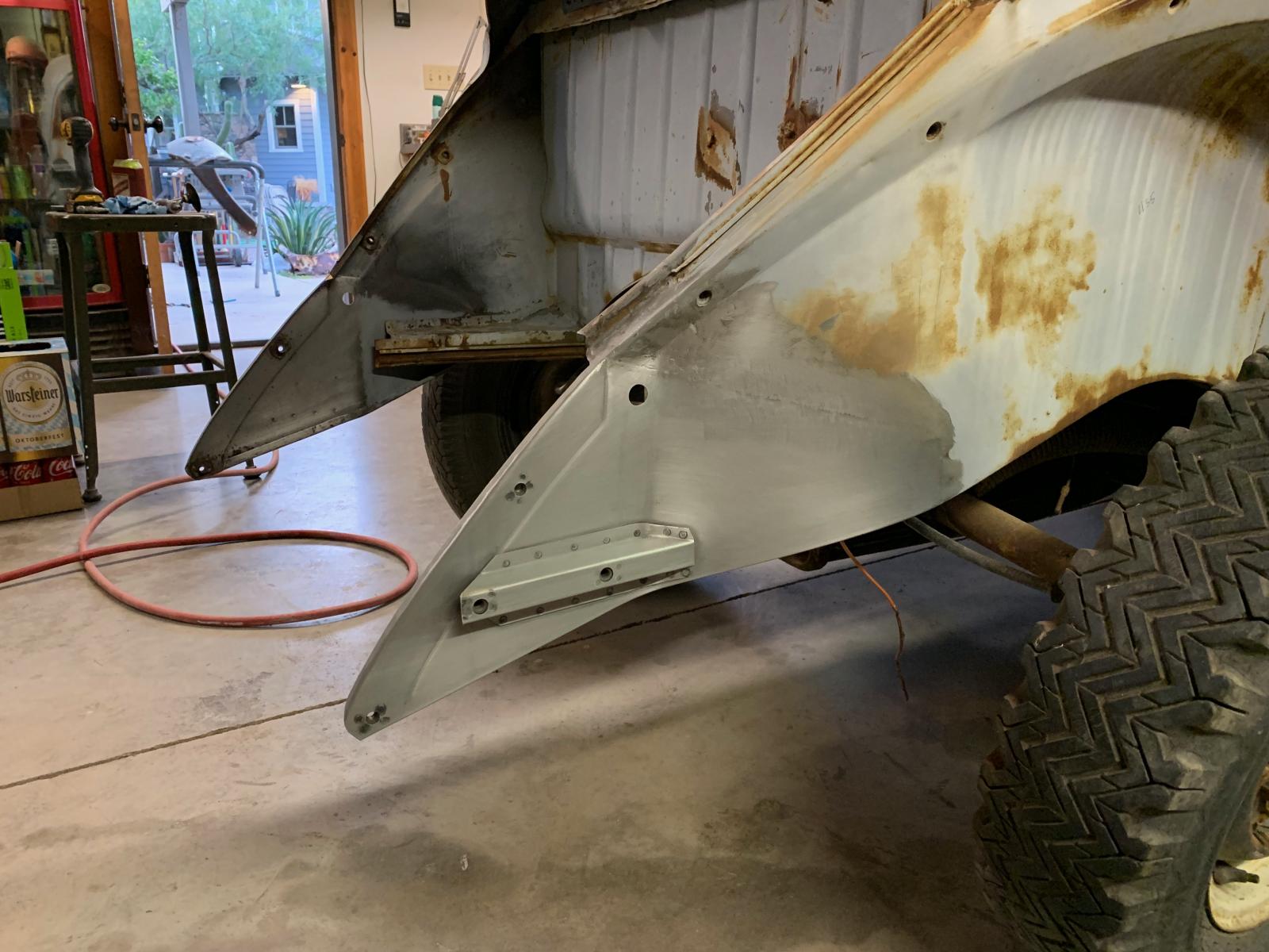

Finally, the welding on the rear clip is just about done...

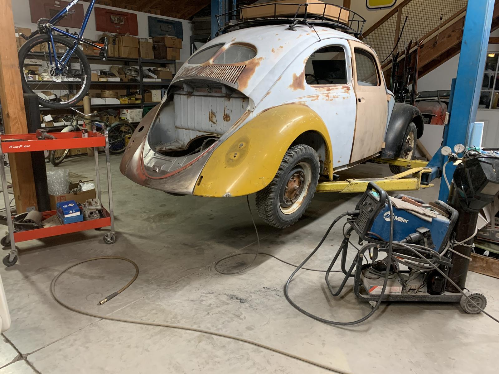

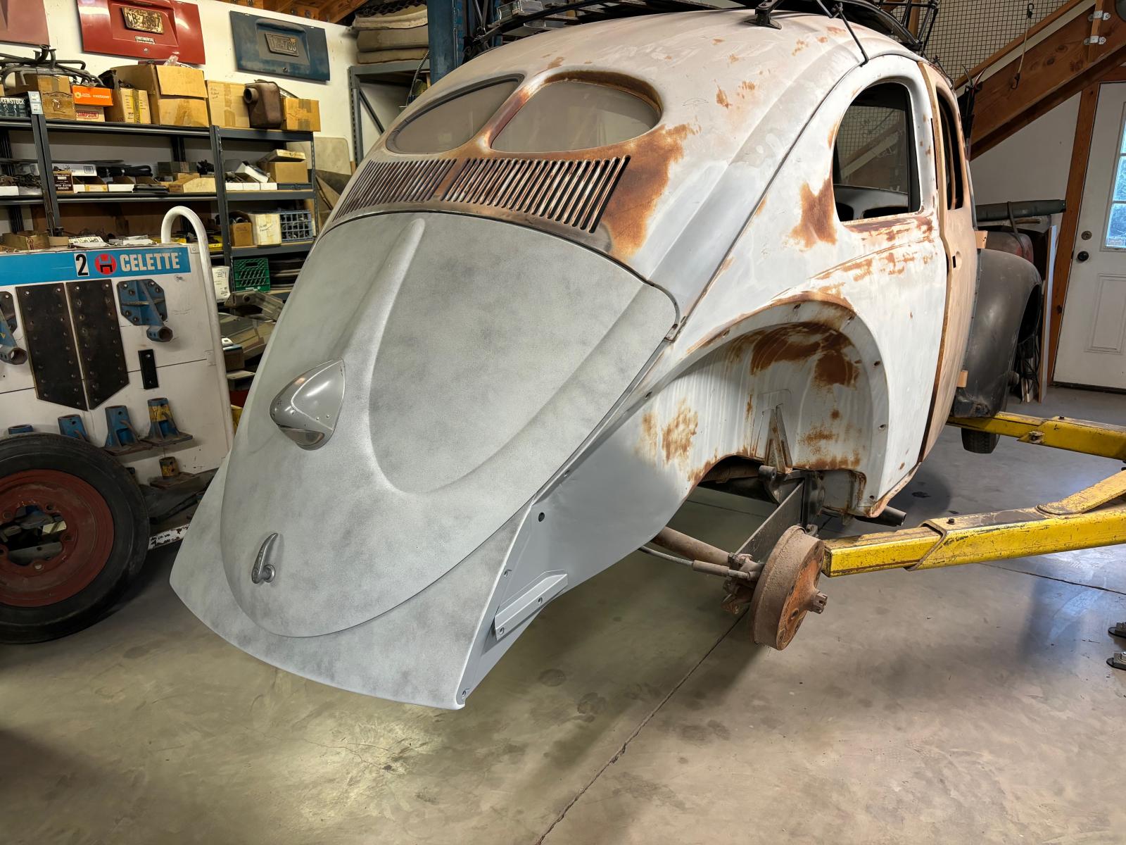

With the welding finished on the clip, I moved to the fenders, fit the taillights and finished any misc welding they needed.

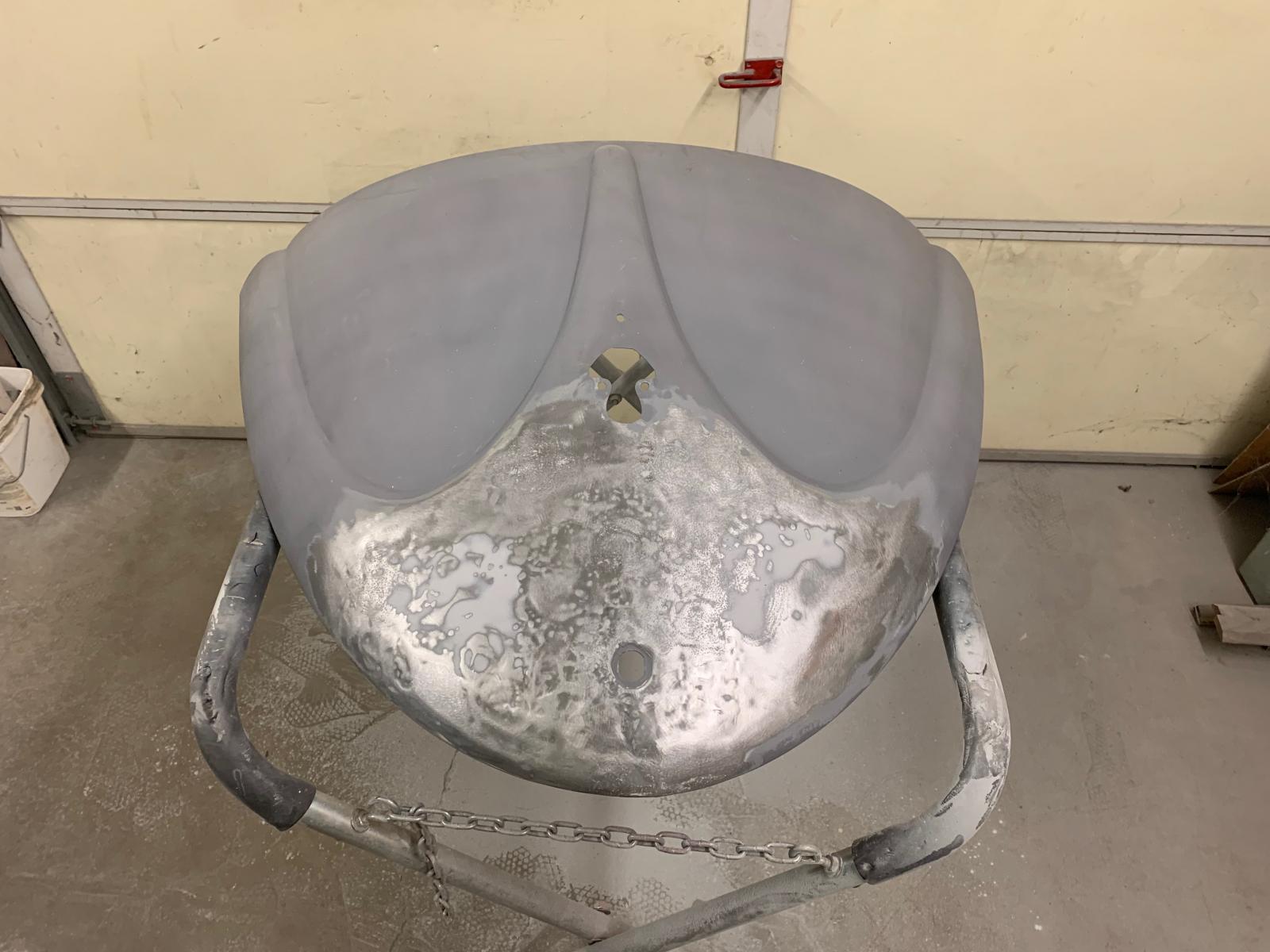

Then I went to body work and primer on the decklid and rear clip. Just keeping things small and manageable as I go. I'm using PPG DP50 on the bare metal then Evercoat G2 on the high build areas...
