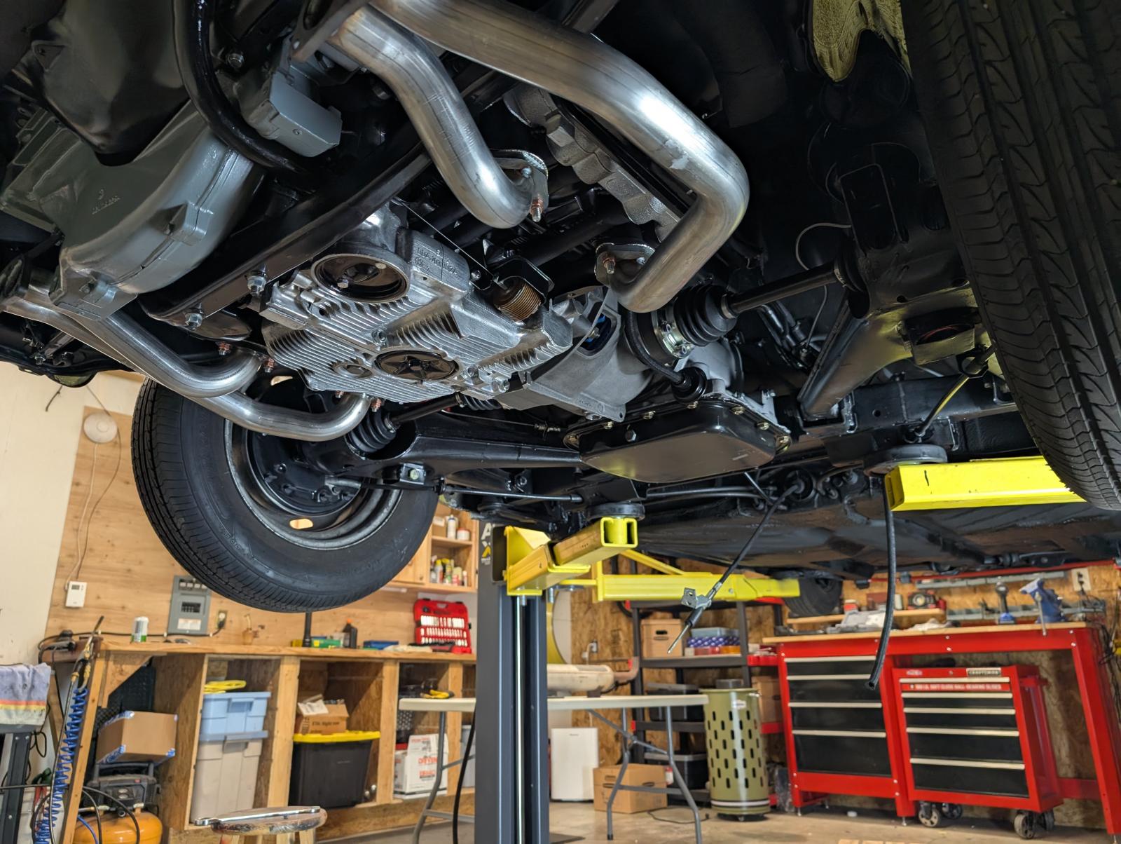

Finished the engine today! Just need to put the exhaust on and it's ready to mate to transmission and install....
I am back to where I was 10 years ago and in need of the first part I ever tried to find.. if anyone has one let me know. I had some ideas of using other materials but it is a tricky piece because it has to flex into place and have the flat section where it is sandwiched between the intake and lid.

Man I've been waiting on fuel hose... ordered the wrong stuff. Waited more..got it today and everything is all ready to go and finally got everything ready to do break in and hoping to do it this weekend. I am currently home with three kids for the summer 4,9&11 so I'm super busy but committed to getting this thing driving this summer
But while I'm doing my summer thing of boating and fishing with the kids we decided to get our recreational lobster license and get a couple traps this year
Well this is too crazy of a coincidence to not share ...
These are the tags for our lobster traps.
Also some pics of progress...

Nice job on dressing out that engine. By the way, I noticed you painted the cooling fan housing. What product did you use?
So have been thinking about the idle inconsistency. I noticed from your photos you did not secure your intake runner fabric connectors with any clamps. When I put my engine together I paid special attention to the runners. I had to realign the runners to the throttle intake plenum because they were off quite a bit. I modified attachment mount holes and repositioned everything to get a perfect align. I finished it by using sealant on both ends of the fabric connectors and adding some clamps. This assured me of a tight leak free intake. I have nice stable and consistent idle. I would double check that on yours. Just another suggestion…
Bill
