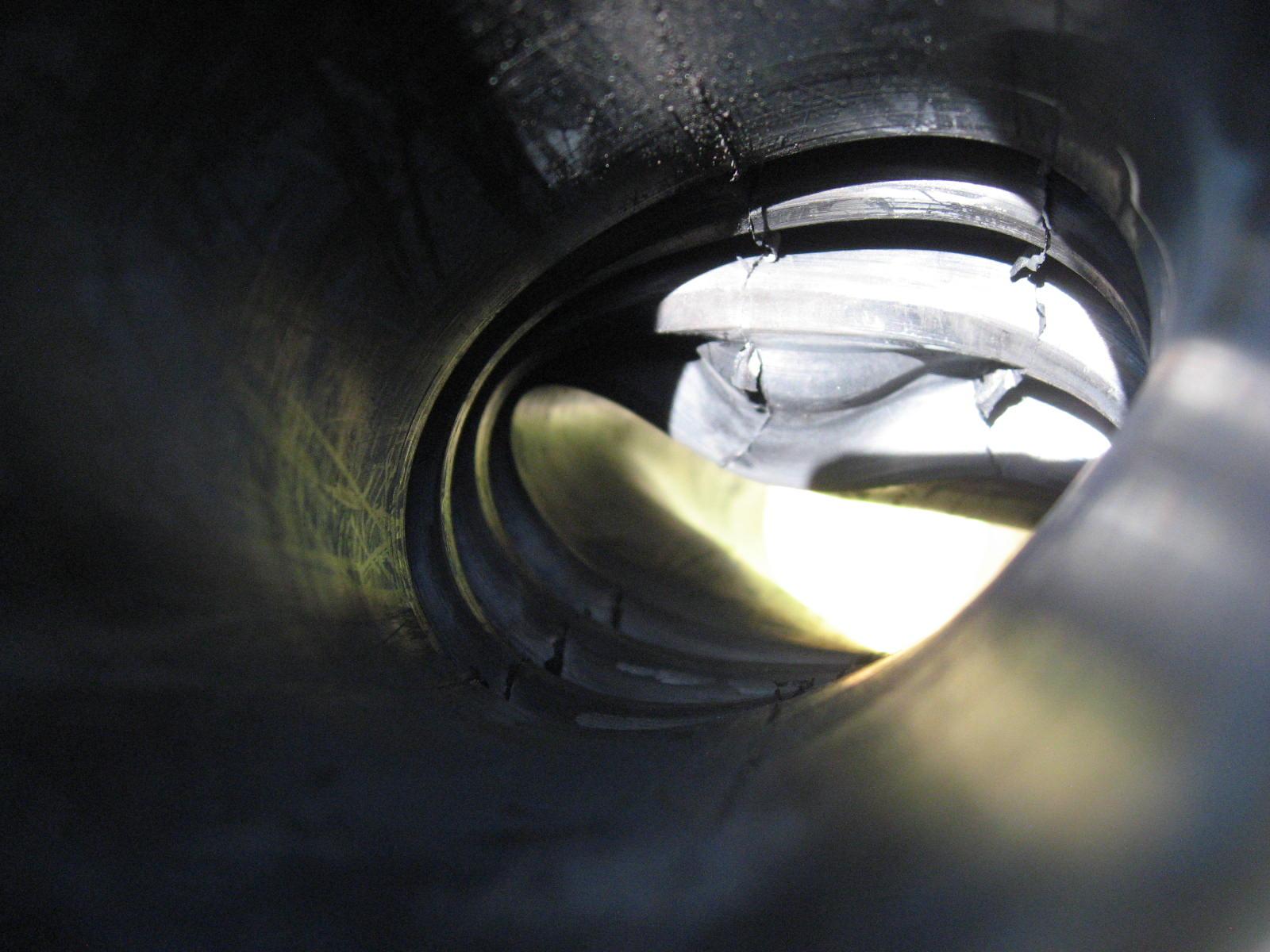

Anyone bought one of these lately? This one I bought from WCM since they supposedly make the best “they themselves would use”. They are unusable as shipped.
Horrible flashing on all four mold seams.
So horrible I can’t imagine what damage the flashing would cause to the carburetor much less when it goes into the combustion chambers if it makes it past the valve seat. Three hours so far delicately scraping to get to this point.
At the bellows it is impossible to deflash the ribs. I don’t know how I’m going to get the flashing gone.
This is but a tiny fraction of flashing removed from the tube.
Total sheesh.

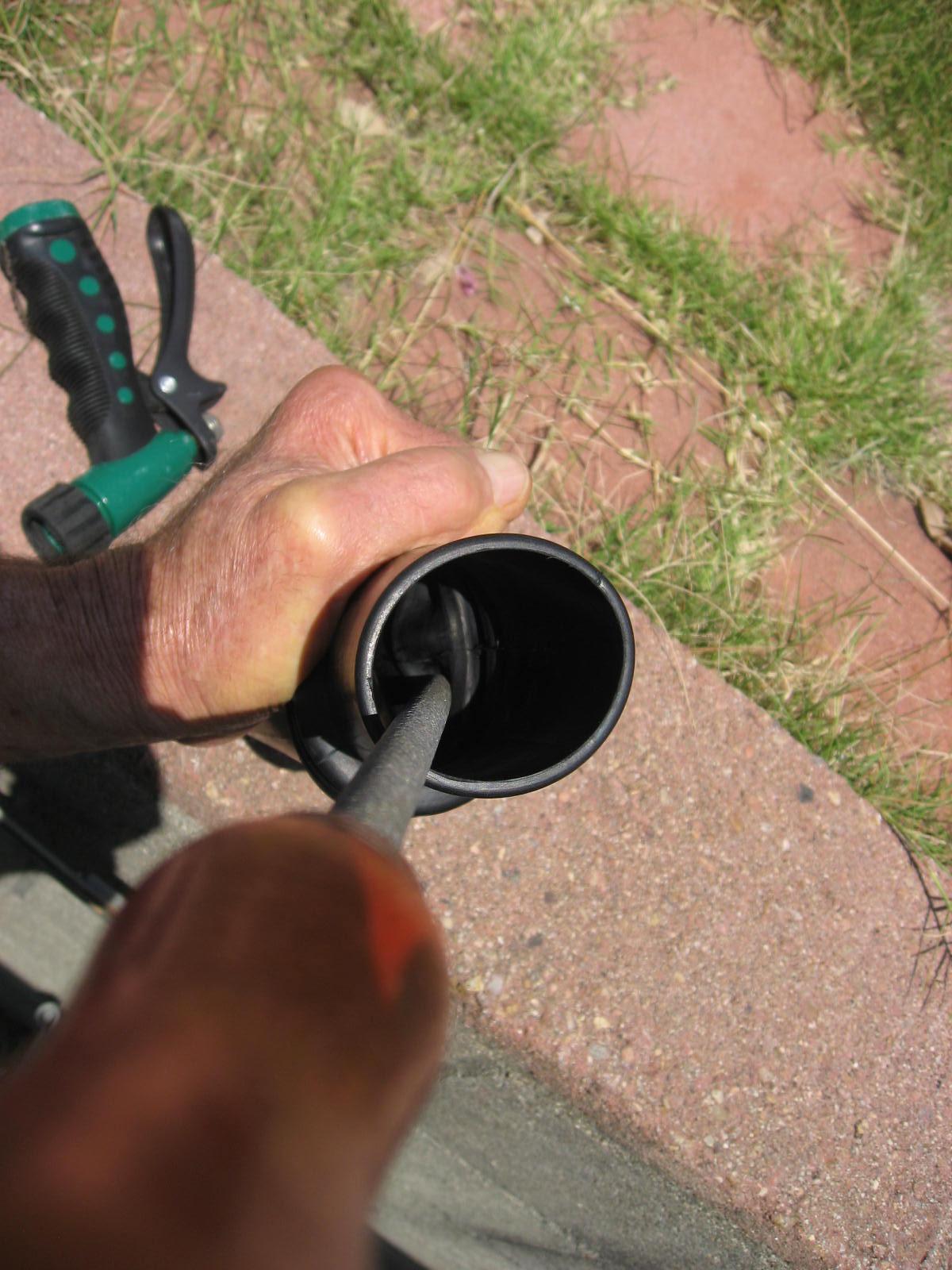

Well, I tried it. My lighter is adjustable so I put it on med low about a 1/4" flame head. I bent the tube so I could see the bellows' flashing.
I was hoping it would shrink away like the shy girls at the Junior High dance but no. The flashing wasn't phased and merely caught smokey. It made my nostrils and throat feel like someone sprayed poop scented surfboard wax on it.
Any higher flame would have melted right through the wall thickness. I'm going to try to find another supplier.

I did try that but the flashing becomes blind as soon as the tool approaches.
I tried it on the easy stuff at first but it was too hard to control even on low. What worked for the parts already done was a large rough rat-tail file with a squared off ending that was sharp and I could slide it lengthwise over and over not as a file but as a sharp pushing blade thingy.

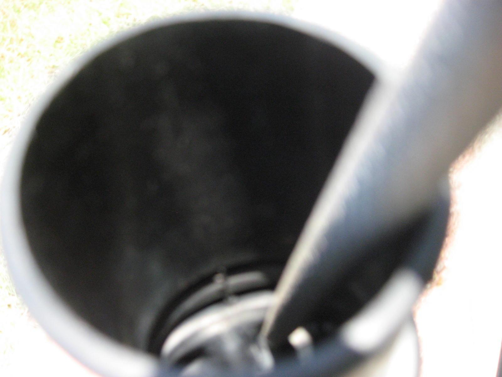

Finally...I thought maybe if I beat on the bellows with a toilet plunger handle I could knock the flashing free and if it didn't fall out then I'd just put it on as was.
I beat it within an inch of its life but nothing came loose.
Then I realized I could squish the bellows to use my sharp file trick.
It was majorly hard to squeeze but I figured get it over with then recover from the injury.
Out of focus but you can see each flash seam had to be squished one cm at a time.
This is the combo that worked.
It took 6 hours. Just to teach it lesson I beat it with the stick again.
