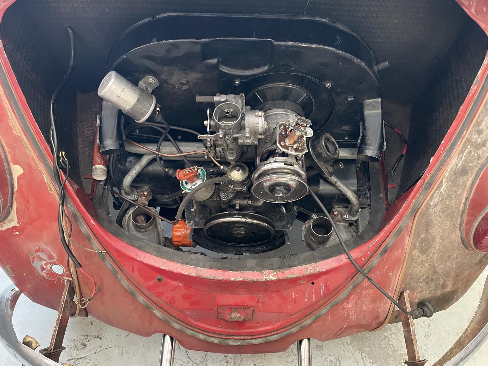

Heinrich, he has a cast distributor. Pretty sure he's asking about the bolt through the insulator and distributor body. Bently manual might list what size it is.
Yeah, he has the fat cap distributor. There's no bolt through that one. It has a set of two piece points with a bolt that goes through it and the condenser attaches to the back. It's a little different than the earlier cast iron units.

Engine put up a bit of a fight getting out, the top nuts and bolts are real fun to get out especially with the dog house setup.
Found the source of the noise.
Confirmed this by pulling all the jugs off and checking for play in the connecting rods. Amused that all were tight, spent a morning rebuilding a set of connecting rods. Oh well, probably good to have a spare set on hand.
I also had a local come an hour drive and help set end play, due to a language barrier easier for him to come out and do it himself rather then explain.

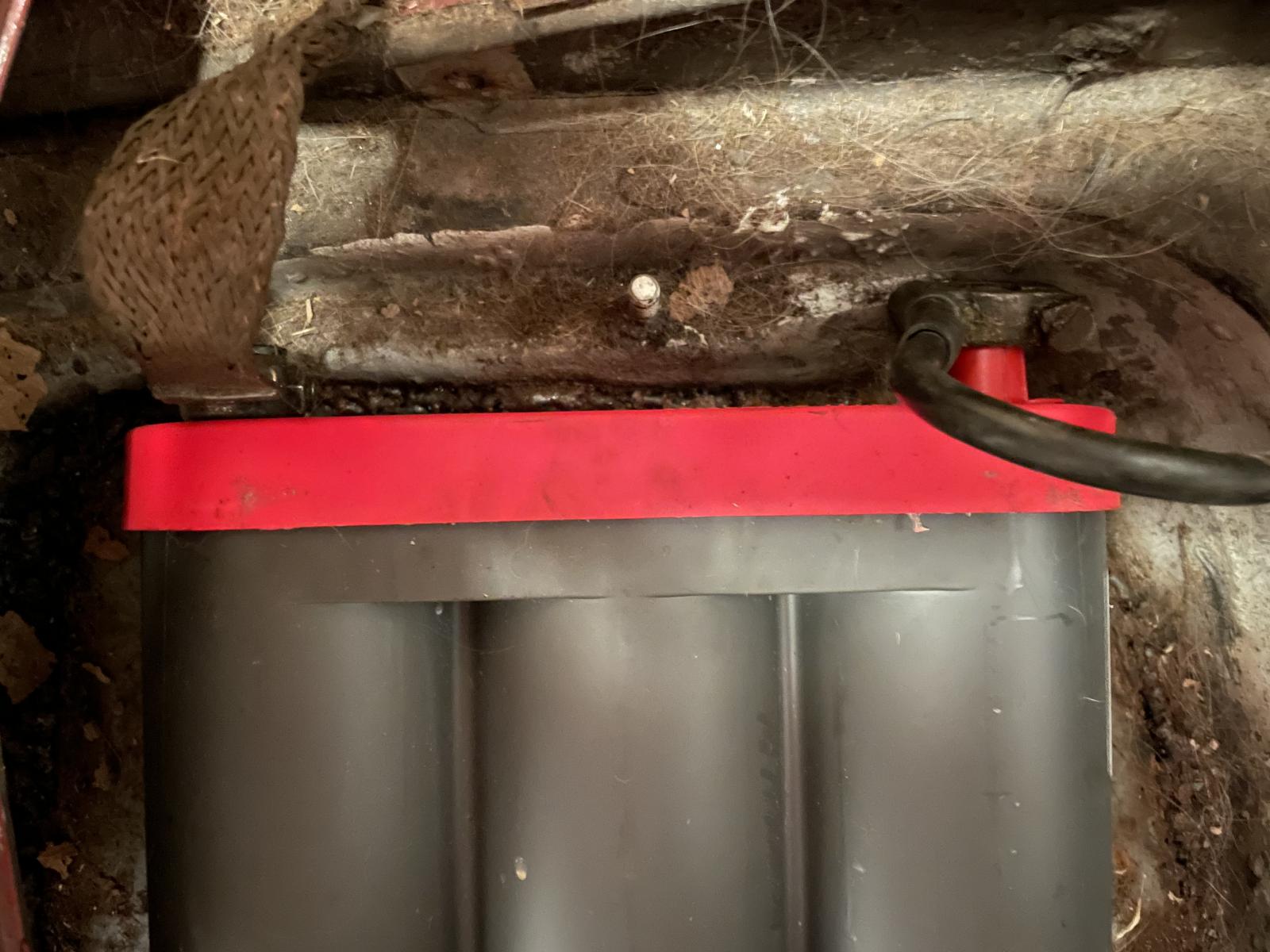

Thirdly, an amazing friend got tired of me having trouble with lead acid, so sent me an Optima (already gave me fancy oil). Shocked More than appreciative. Very Happy So add to the list purchasing or making longer cables to mount it such the posts are facing forward and still laying on the side plus fabricating a new hold down, good thing didn't take the welder back home.
Friday had a brother help get the engine off the cart, but part way down his strength left him and all I could do was pull hard and ease the fall. Busted off the passenger side outlet pipe, welded it back on, but now got to adjust the pipes. Yes, it was first time doing kind of overhead (limited room and visibility) and uphill, but did both practice, might as well make lemonade. Wink
Yesterday, several brothers, not including the one who helped get the engine onto the floor, helped and we got the engine in. Took a couple tries, first the ramps were too high, then one of the engine studs was still in the transmission Embarassed , then got it in and the bolts are too long: the driver side the clutch arm is in the way of inserting the bolt.
