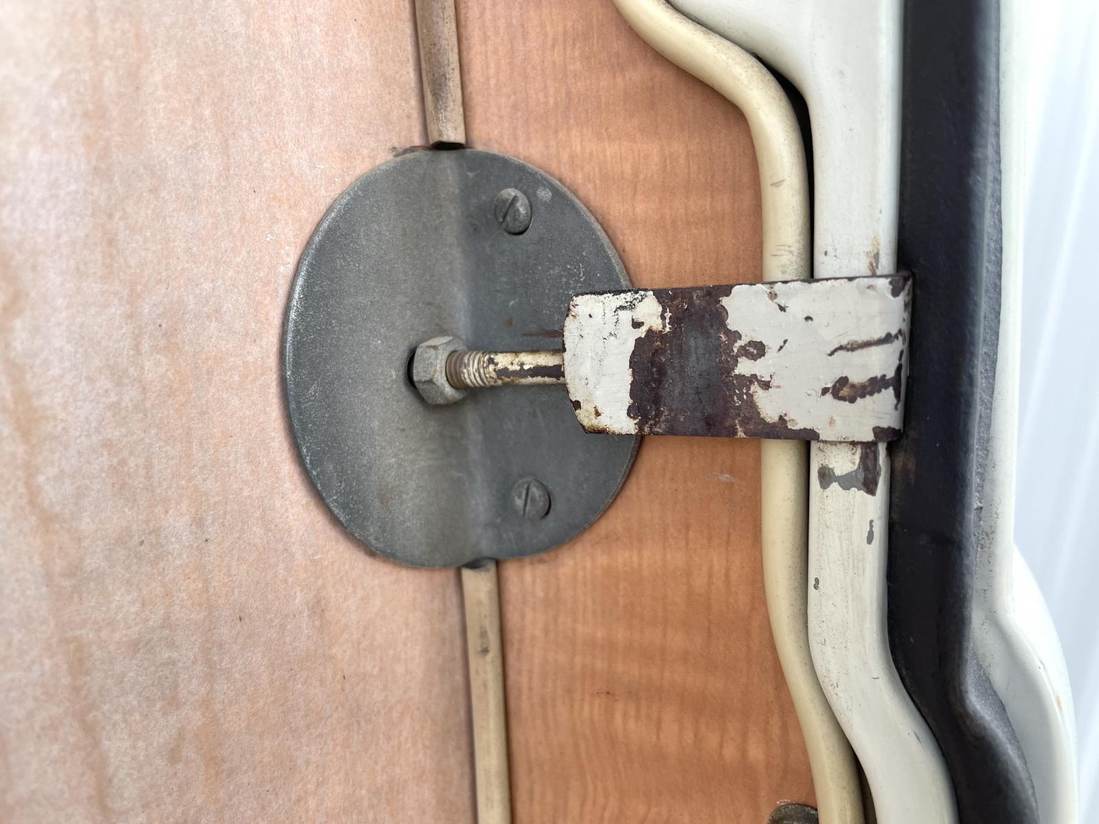

At the risk of crashing your party I thought I would ask my question here rather than starting another thread
We already know that early SO42's (by which I mean Westfalia Fabrik numbers pre number 665)
have a bunch of small differences from their younger siblings such as clamshell lights and sloped rear facing seat, and metal push buttons on the cabinet handles. Am wondering if this is another one of their quirks.
Normally there is a metal/aluminum bracket screwed over this hole prevent the laminate from cracking when the inner rear hatch "lock" is actuated into it. Seeing no evidence of that bracket ever being screwed in here I can only assume it was never there. Wondering if anyone else with early SO42 can confirm or refute this

^^ Exactly. My bus is a walk thru so the rear hatch lock is on the passenger side. BulliBill's 67' SO42 (from which the above pic was posted) appears to be non walk thru so there is an extra cabinet in rear drivers side that I don't have, but the end result is the same, his 67' SO42 has the metal bracket my 65' SO42 does not.

Interesting that your plate that holds the closet latch to the rear hatch seal lip is not screwed into the corner molding like the later models.
For reference, this is a pic from a late '67 SO42.
Is this a super early feature like the missing striker plate for the lock?

I learn more about early SO42's all the time.The closet bracket is apparently another one of them! Also not sure if it was cost saving measure but apparently factory saved some $ not painting the brackets when production ramped up??

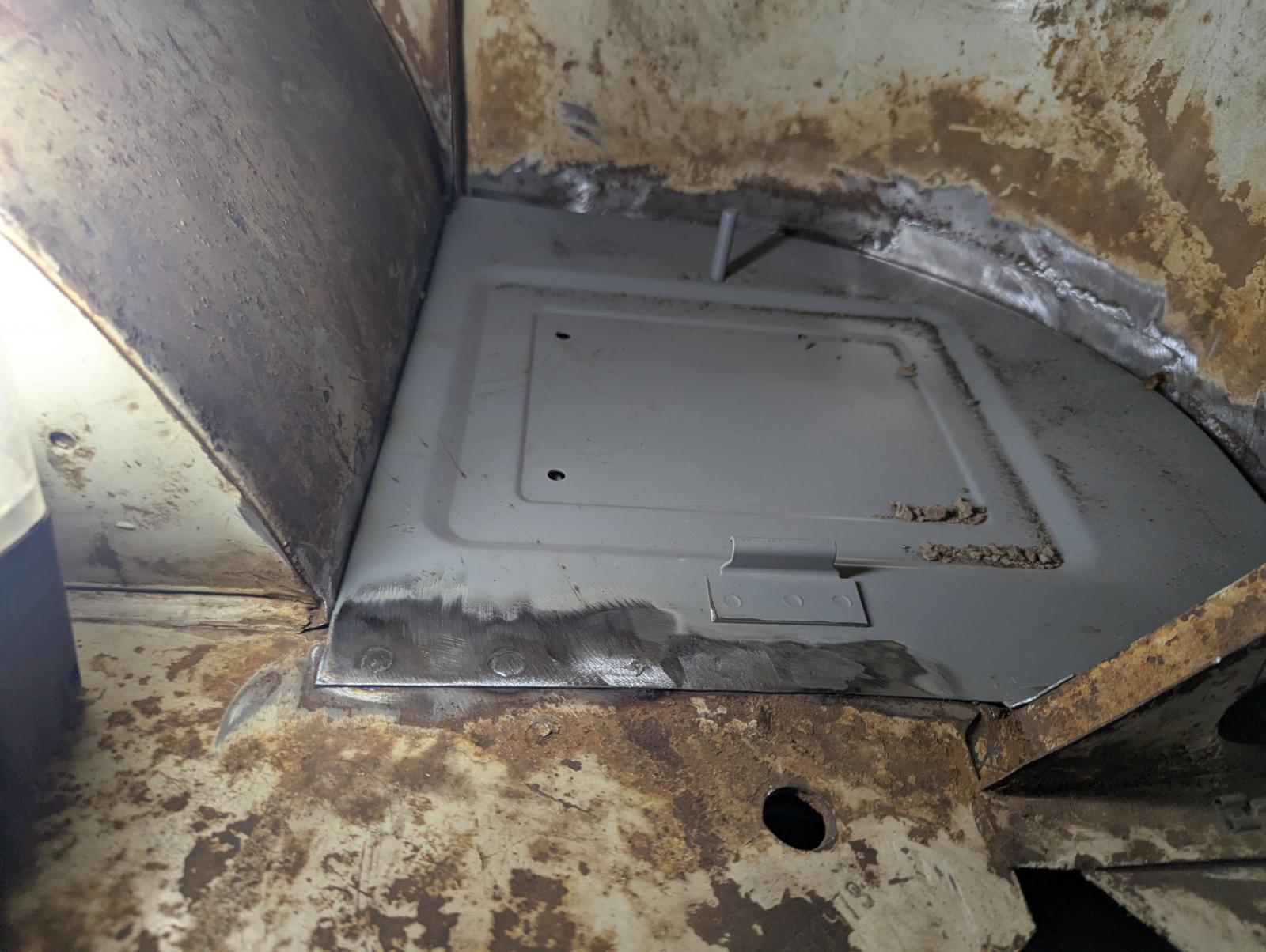

I'm going to patch all the spots that have rusted through. There aren't too many. The worst of it is the cargo floor just near the doors. Water looks to have pooled up in the same place over many years
Someone hacked the cargo floor on the driver's side, which I'll also fix
There are probably 3 or 4 small patches on the side panel above the rocker panels.
I plan on matching and blending the paint for the repairs and the roof. The original paint is in great shape, (except the roof which someone sanded off )and will buff out nicely.

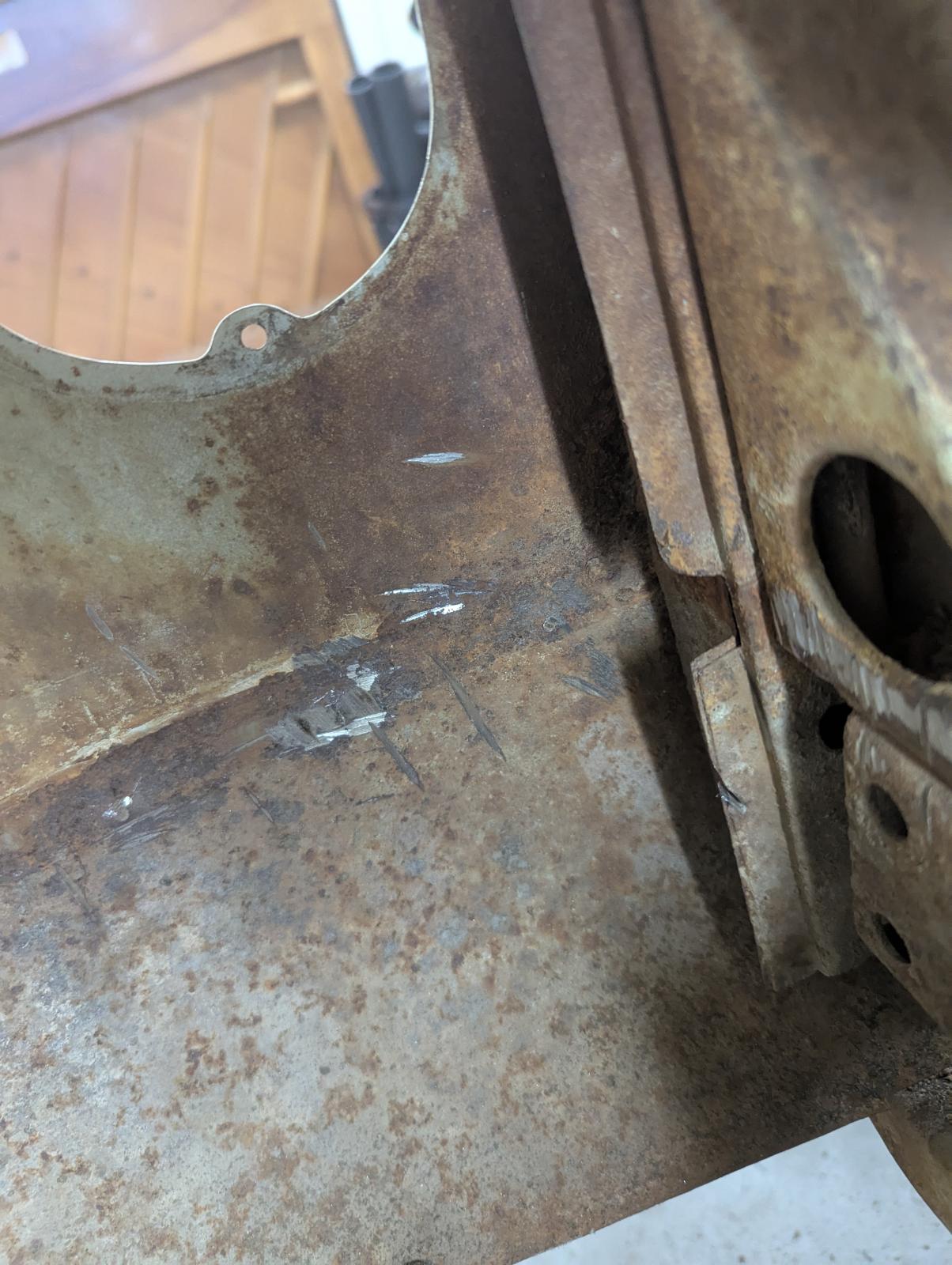

I tore out the rusty floor section this morning
The outer rocker is in tact but the middle and inner have some rust areas I'll need to patch.
Will you do it in place or un spotweld it from the bus?

Looks grea! Hope you remembered to take note/measurement of where the hole for the cold box drain goes Smile
Also good to make sure holes for door spikes line up before welding it all up.

I think I'm going to do it in place, just replacing the small sections that have rusted out. I'm trying to preserve that original rocker panel. Cutting it off and welding it back on would probably be much easier. That plan may change as I dig deeper into it.
I sure did. I kept the section with the hole so I can recreate it perfectly Very Happy
Hopefully I can keep the original door pin holes, we'll see.
