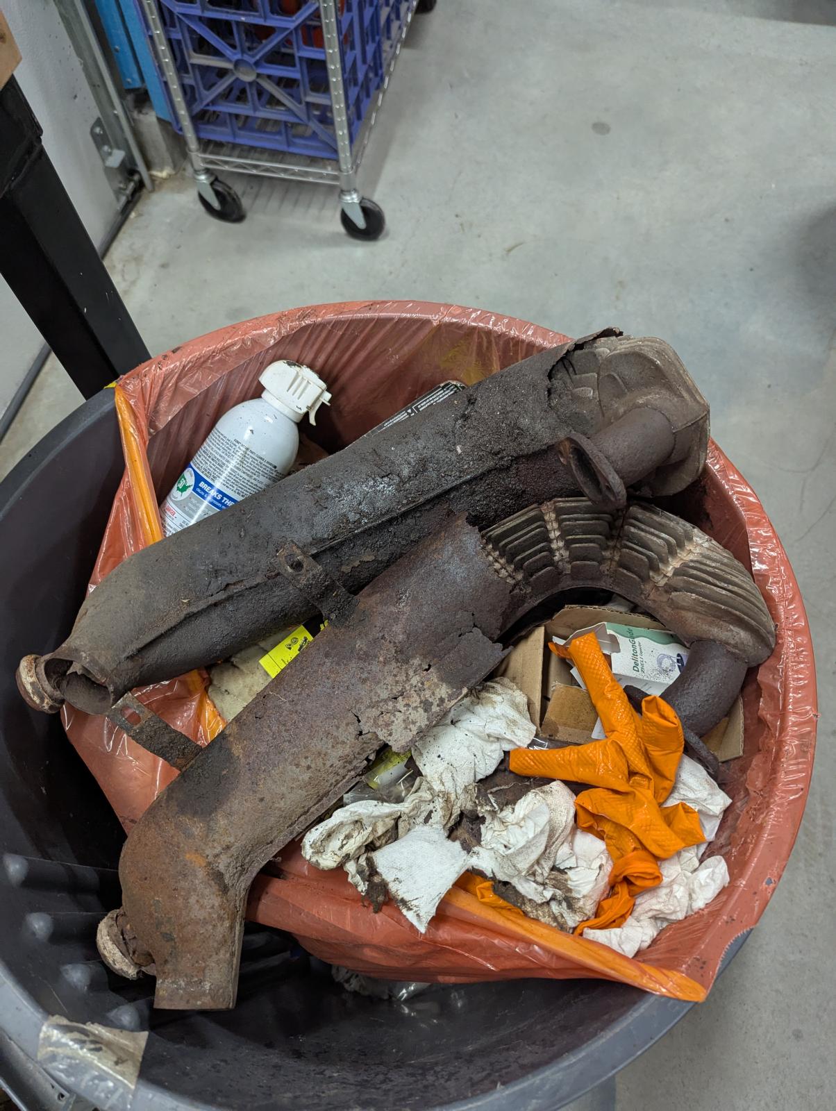

I was trying to convince myself to use the engine as-is, with rusty heater boxes but my better judgement got the better of me. I was dreading the job because working with old exhaust parts flat out sucks. This morning I bit the bullet and dove in. I only broke off one stud (but I broke it three times trying to get it out). I drilled it out and tapped it
I opted to use a good used set of heater boxes to match the style of the engine. I have a few sets of newer aftermarket ones kicking around but I trust the originals better and they work nicely on this engine.
Here they are installed
The old ones in the garbage where they belong
The job sucked as expected but could have been a lot worse.

Those heater boxes are crusty! Having stock heat is really nice on cold days compared to no heat.
Looks like you will be driving down the road in no time. I can envision a camping trip in your near future Laughing
