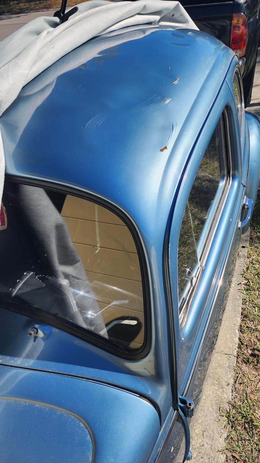

In the pictures below it shows the issues I'm having why it's taking me such a long time to pull the trigger lol. Does anyone have any ideas on how I should approach this? Do I need to weld in a new roof first? Can the dents be dollied out? Boo hoo! Or just don't do it all inputs welcome

I don’t know much about body work but I definitely think you need to plan to do some repairs the edges don’t go over as far as the damage. Good luck, keep us updated
