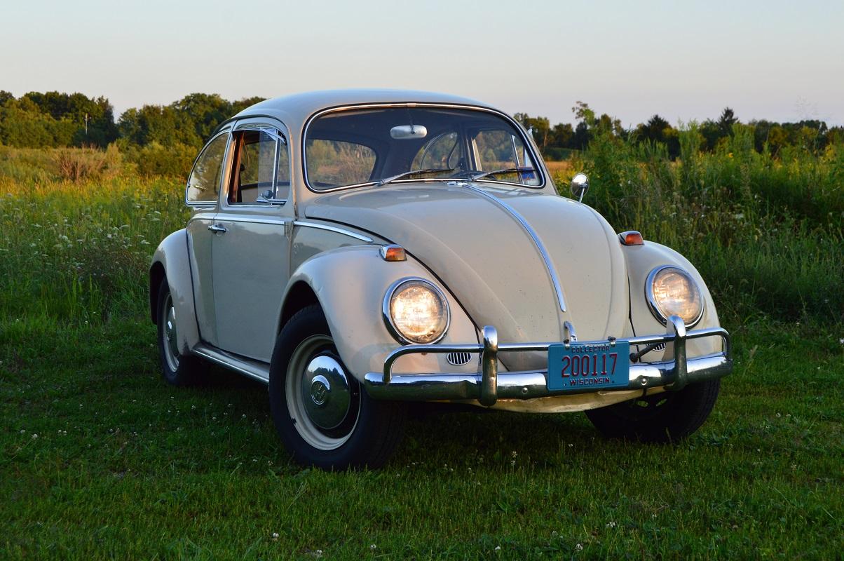

It was a nice evening, so I went for a little drive in the VW. Took this picture in a near Rome Pond.
