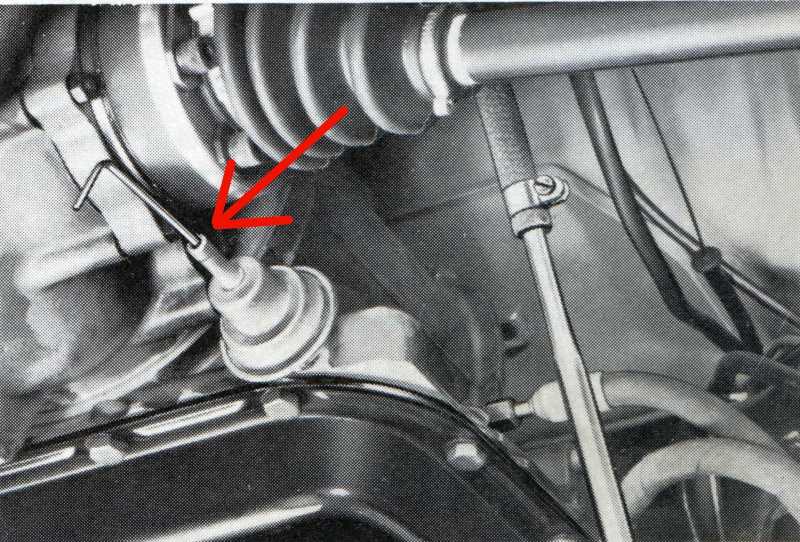

Are you sure it's from the oil pan, and not the governor or the kickdown switch plug?
I think there is a loose metal cap over a vent on the top.
You can see the cap on the final drive side of the mated transaxle.
Also shown here:

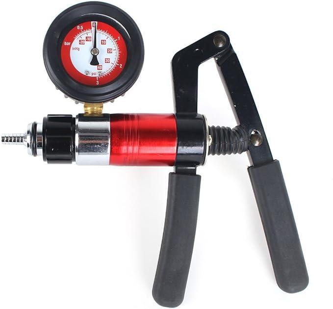

Is it leaving a large puddle on the ground? If it was all coming from the pan, the puddle would be huge. You may have a couple of other issues going on. The ABSOLUTE first thing to check is what Bobnotch brought up, ATF in the final drive. Drain the final drive, see how much comes out, and run your finger through the fluid. It MUST BE 100% Hypoid gear oil. If not, park the bus NOW and drop the trans. Otherwise it will destroy the ring and pinon quicker then you can say Bob's your uncle.
You may have a couple of issues happening: 1st your oil leak.
It is very possible that your governor cover is leaking. Your bus is beautiful, so crawl under it with some towels to contain any over spray. Saturate the governor with carb cleaner. Then using your finger, work a plentiful amount of grey ATV around the governor cover and the case and let sit overnight.
Next remove the vacuum modulator from the trans.
If you don't have one, purchase a hand vacuum pump of your choice>
Use a good piece of hose to connect the pump to the modulator, and give the pump a couple of squeezes. Don't go crazy, we want to see around 10Hg. Watch the gauge, it should hold this vacuum indefinitely. If it doesn't, you have a crack/ tear in the modulator diaphragm, and the engine is sucking ATF out of the trans.
So a couple of things to check, get back to us with the results.
