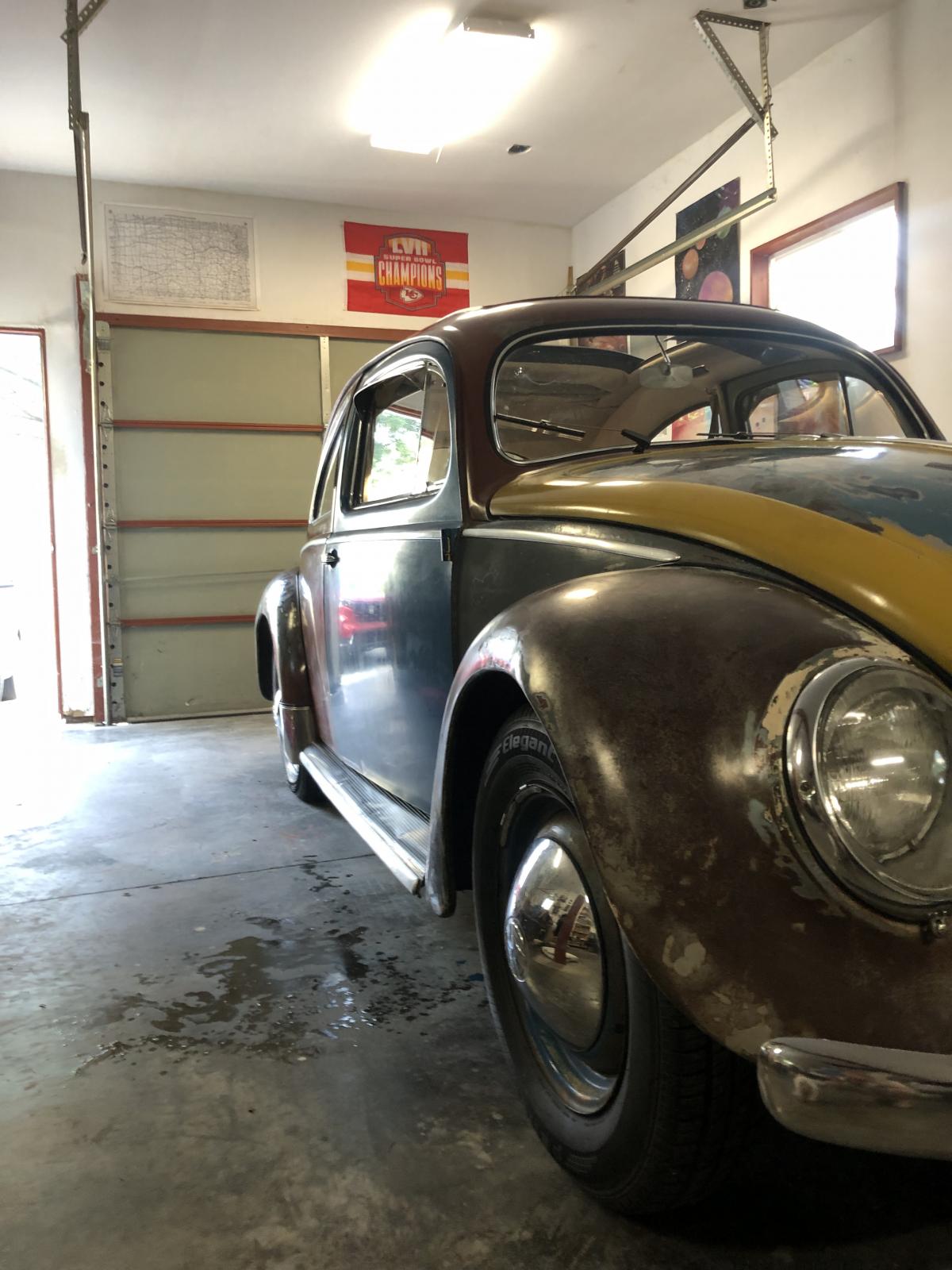

here are some pictures of smiley out in the wide world.
november 1952 ragtop
november 1954 single cab

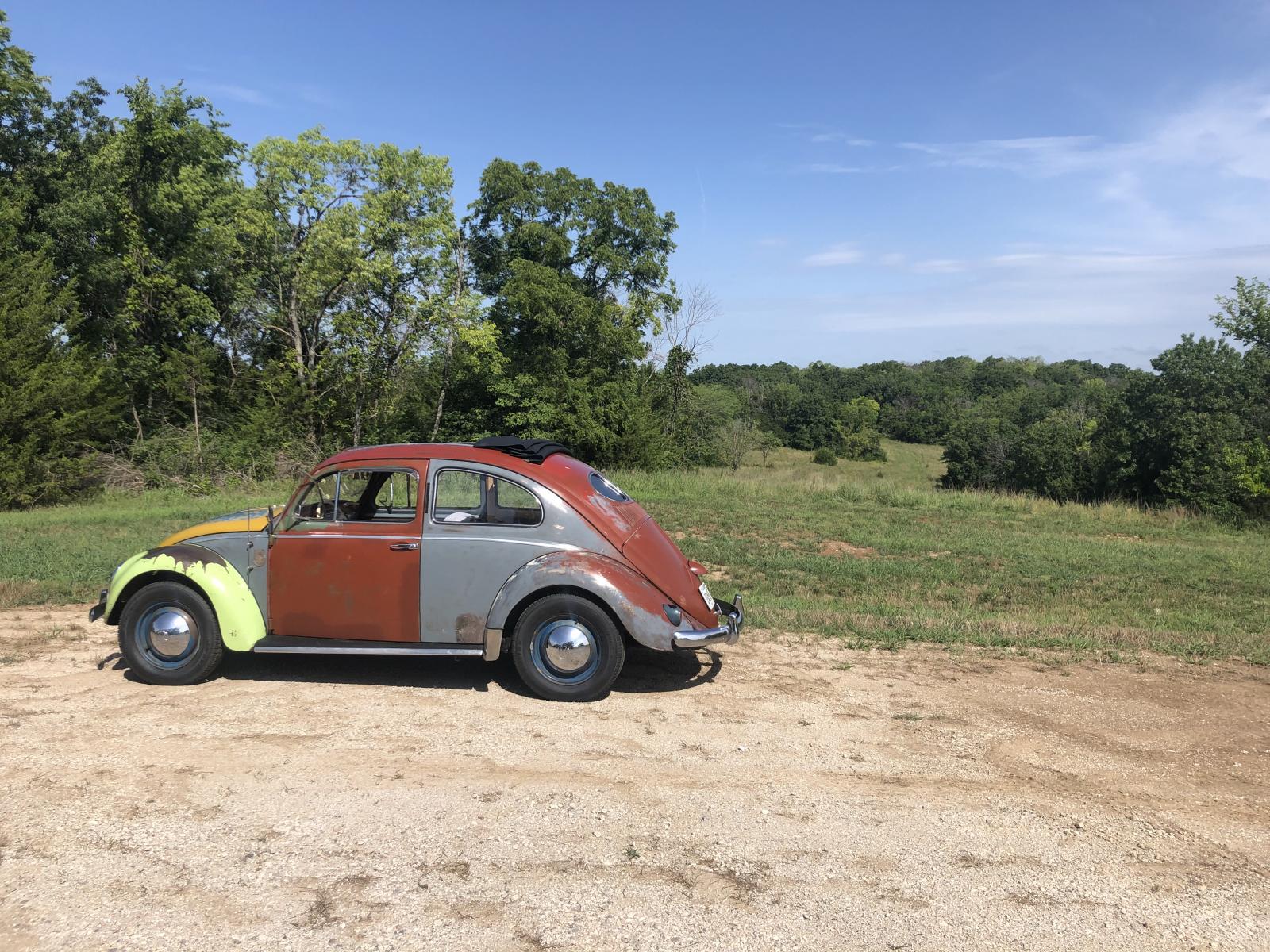

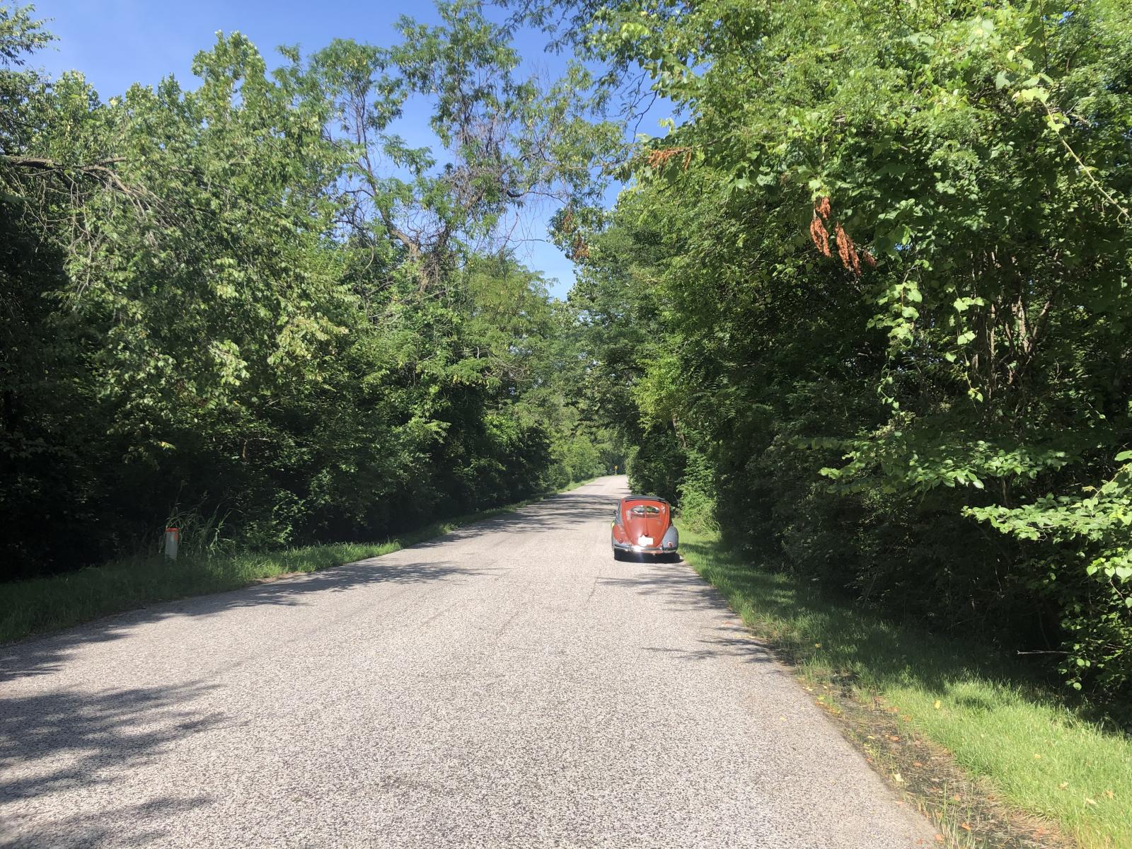

we took smiley on our first inter-state drive today. went to missouri. the state line is a street that runs through the middle of kansas city. makes 4 states that i know the car has been in (kansas, missouri, new york, and wyoming). im sure it has been to others but i dont have proof of any others at this time. the car had to go through either nebraska or colorado when it was brought to kansas from wyoming. additionally there are a lot of states between new york, where smiley was delivered, and wyoming where my dad bought him.
here we are by the alexander majors house. it was built in 1856 by one of the pony express dudes. one of 4 pre civil war buildings in the city.
took this neat pic
worked on the polishing and waxing a bit.
we threw together some temporary seat covers while we get the actual upholstery sorted out. it was a significant improvement to the seats feel. the vinyl pulls the springs together and makes everything more firm.
