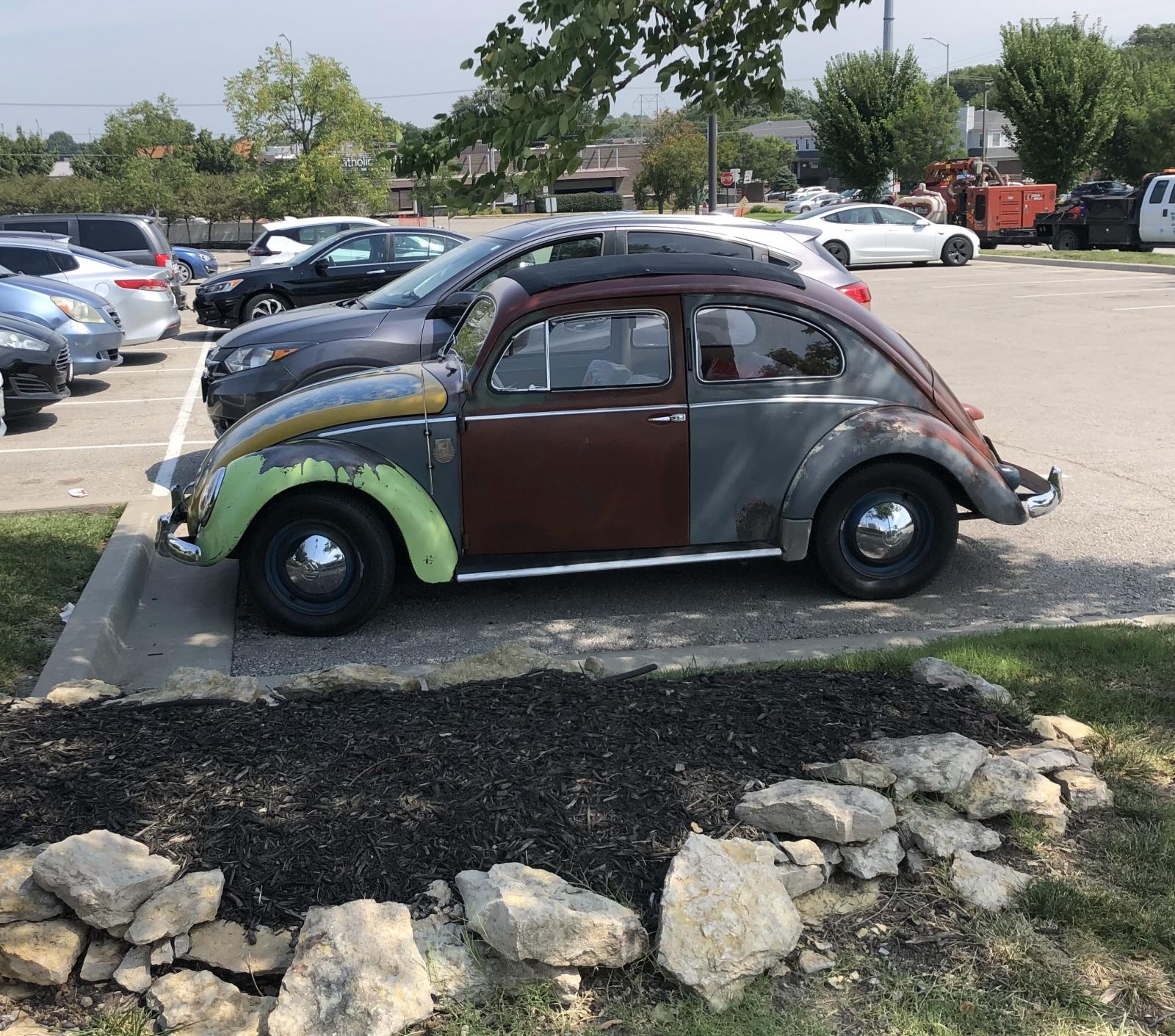

here are some pictures of smiley out in the wide world.

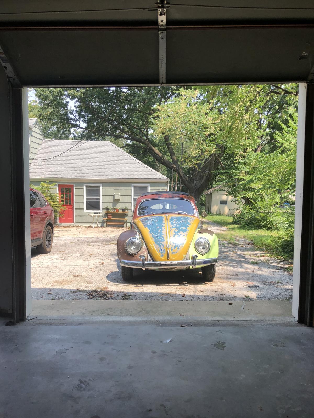

been doing some non-functional stuff for the first time in a while.

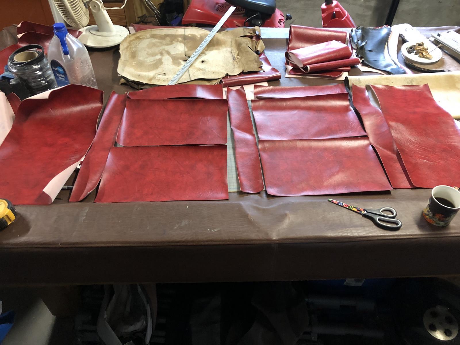

i have started making the upholstery. its slow going. not too shabby for my first time using a sewing machine. my local library haws a makers space with industrial sewing equipment. they just let me use it. i dont even need a library card.
still a lot of fine tuning to do and i need to double stitch some of the seams. im going for stock-ish layout with the remainder material i had on hand.

here are a couple more shots of making seat covers.

And to top that off. THEY LOOK AWESOME!
Very nice!!!!!
One small tip, when you go to install them for good. I have learned in doing seat covers. Actually anything that has a material that changes dimensionally by a visible amount. I allow the piece to fully warm up. Either in an oven or out in direct sunlight. After warmed up, install immediately and quickly. It drastically helps in the installation, as everything is more pliable; and it allows for a more taunt surface, after the piece has acclimated to the surrounding temperature. I use these techniques for laying up cabinet parts while laminating out in the field. Same with flooring, drywall, wood paneling, most everything that is hygroscopic. It all needs to acclimate!
DUDE! Truly inspiring! WOW!

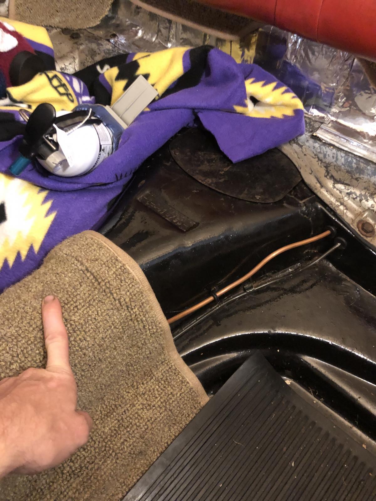

I love this build and it’s so great to see this beetle is back on the road!
Looking at your seat recovering pictures it doesn’t look like you have anything between the padding and the seat springs. If that’s the case I would recommend hand sewing some burlap or heavy upholstery fabric to the top of the springs. This keeps the springs from wearing through the padding. I don’t think VW did this but it will sure help maintain the padding. Here are some photos of what I did to the seat springs on my 58 Ghia project. I rolled the edges under and used some binder clips to keep the fabric taut while I hand sewed it with a curved needle and upholstery thread.
i had kinda rolled mine under as well. they started to come free from being used without the top layer. i didnt put anyting between the cocoa fiber and the seat frame. i get small rain of bits all the time.
a bit ago we were discussing the fuel line. here you can see where it runs in the back. my finder is where the rear bench rests. the line is towards the rear of the car from there so the seat cant hit it.
